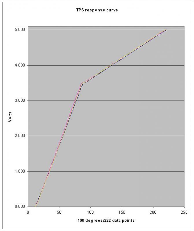

  4. Hi Guys
    O.k we have a graph of Streetfighter TPS that he sent me for test.
    Edit: comments added: This is 3 runs, a little offset from each other purely because of a small slop in the take up of the drive from my stepper motor. It may not be very clear in this graph ( i can provide a larger view if anyone wants it) but there is a flattened off area just after the change in angle. I dont know where this would appear in the rev range or whether it would be detectable as an issue at that point.
    Other than that this looks like a stable response.

  5. Top Bloke Desmoboy:upyeah:. Yep that's working by looks of it.
    Many thanks for your help.
  6. No Worries it'll be back in the post tomorrow.
    I have just had a look in more detail and the flat area is at most( trace 2) 4 data points which is 1.8 degrees of throttle movement. I would imagine this creates a bit of a dead spot where response to change of throttle has no effect. whether this is even noticeable and whether it has any bearing on what you are experiencing i have no idea.
    Having never yet traced a "perfect" TPS i dont know if its always there.
    I'm glad that we have the opportunity to draw on the brains of the dude in California for this idea and now have the means to do it should the need arise.

  8. Yes in a way but its so simple and rustic its not true. However the function is just as accurate.
    I have a stepper motor with a flexible adaptor to which you can fit a shaft in line with the motors shaft. I filed the end of an Ali shaft to key into what the TPS needs, in this case a 8mm x 4mm lozenge shape if you see what i mean.
    Fix the TPS so that it won't move, blue tac actually (to the side of my PC at work !) and run the stepper motor via an Arduino.
    The TPS has 3 wires, 5 volts, ground and the signal wire we are interested in.
    The arduino has a connection that can read the relevant wire on the TPS to 3 decimal places and as the motor moves so the value changes.
    I step the stepper motor a small amount, take a reading and repeat. 222 small steps of .45 degrees each gives a set of voltage readings. Export to excel and graph them,covering 100 degrees of throttle movement.
    Do this a number of times to make sure its all consistent and as you can see i did three runs in this case.
    As it happens i actually take 3 readings at each position (222 x 3 per graph) and average them to remove noise in the signal but i dont think its necessary.

  10. Rob have a read of post #19 in this thread. Parkinson's thought streetfighters TPS was duff as well and as you can see its good. I wonder what they have done to make that diagnosis.
    Is yours still connected to the bike and if so are you confident to remove and reset it?
    If so send it to me and i will let you know for certain whether its duff or not.
  11. Got my TPS back from topman Desmoboy today c/w printout, many thanks mate. Glen at Parkys checked the reading on mine and said he thought there was a bit of a jump in the voltage as the throttle was twisted slowly, he didn't say it was fkd, just suspect and would expect a slower change. He only spent 5 mins on the bike as a favour. Btw my bike has 40,000 miles on it. I bought a pattern fiat/alfa/renault tps ML19925 £25 from ebay. It is not adjustable position type so I filed the fixing holes into slots so it can be adjustable. When I tried to use it the female drive socket in the tps is too large so the male drive doesn't turn it. I was going to put heatshrink on the drive shaft to make it bigger to make it useable. When the bike is on the road next month I'm taking it to Proteam to get it checked out properly and will post the results.
