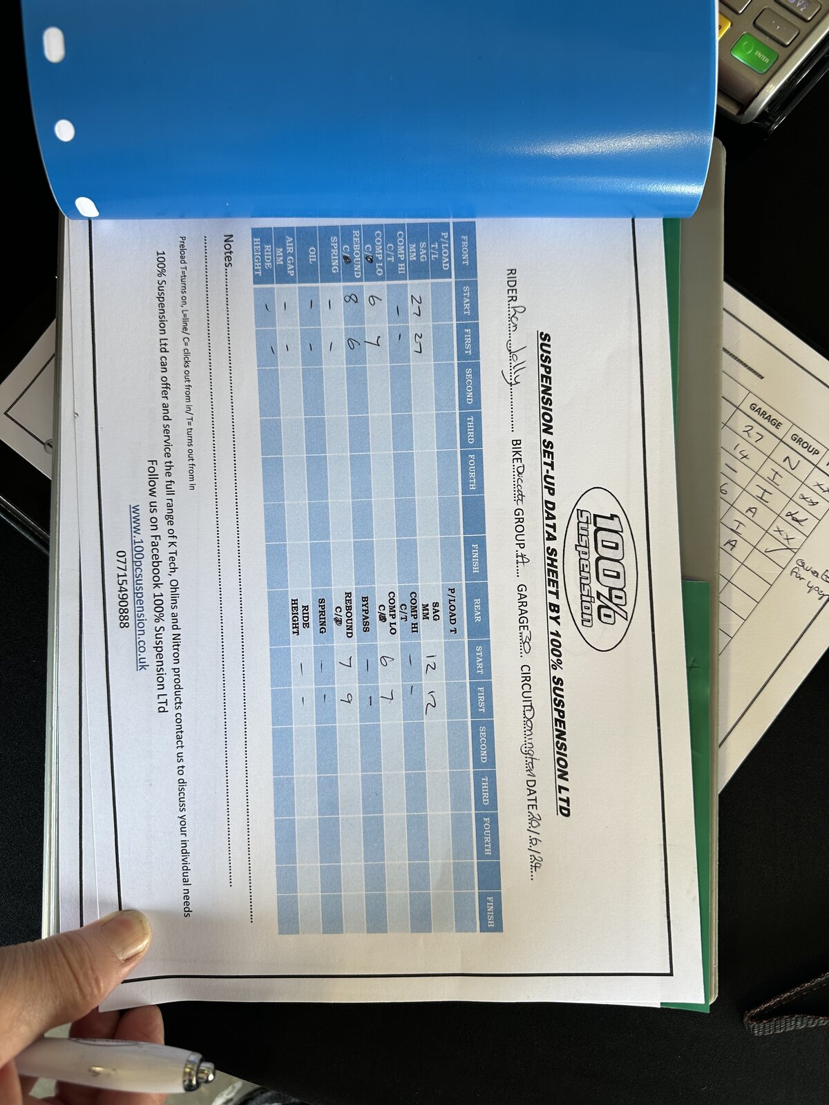

  3. The front will be too soft and the rear will be too hard. There will be some variance between bikes, however here is the setup 100% did on mine at Donington. Mine being a 2022 V4S. Not sure what year yours is, however I think they changed the forks from 2022…
