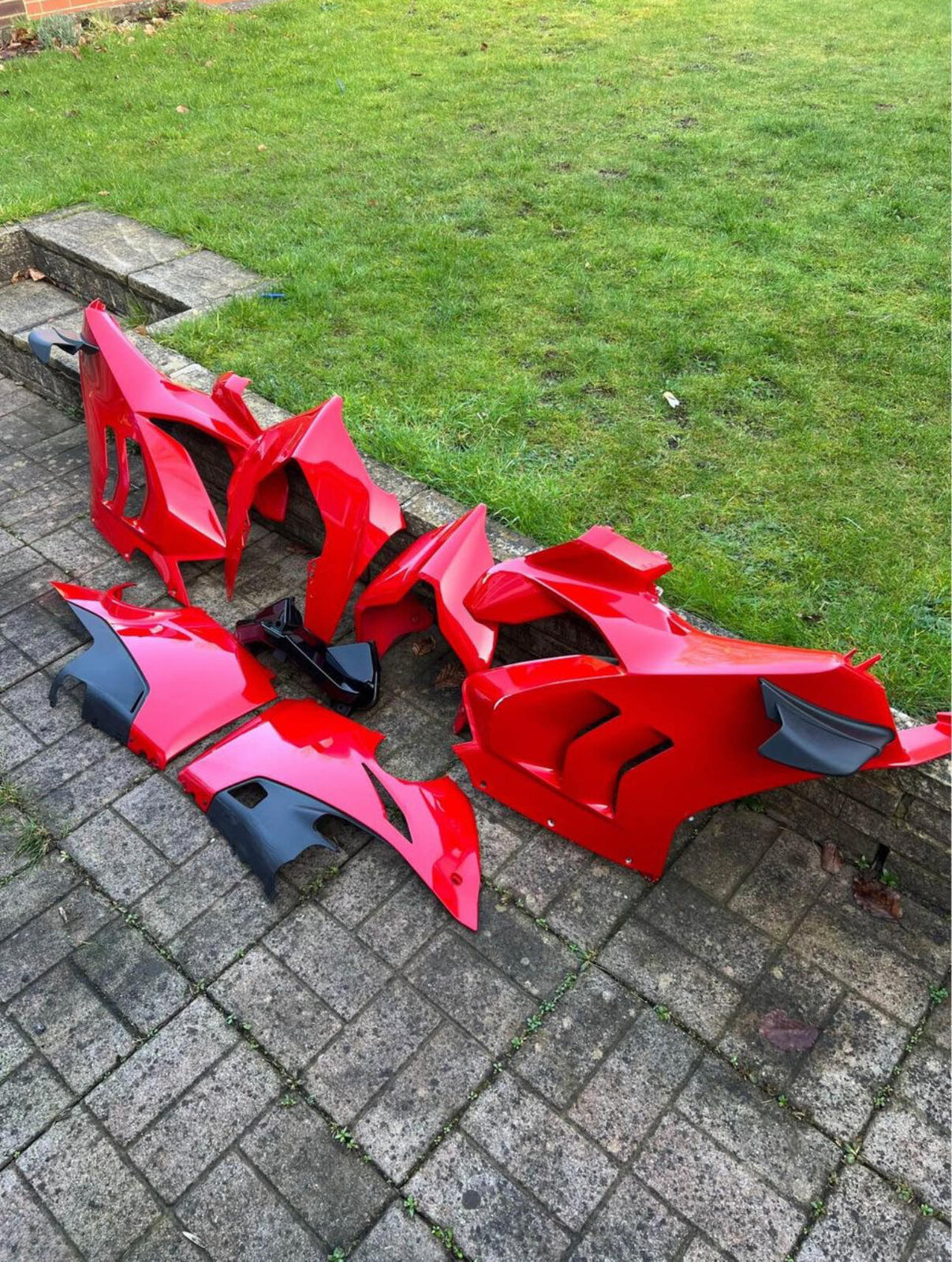

  10. Which is the better bike :D The first revision increased the rear ride height (which is easy to do) but smoothed the grunt rush out of the engine. The second revision went for a new chassis and software update that made it easier (and less engaging IMO) to ride. If you want wings, the first generation V4R track fairing fits but needs an extra fixing which cost about £3. Andy

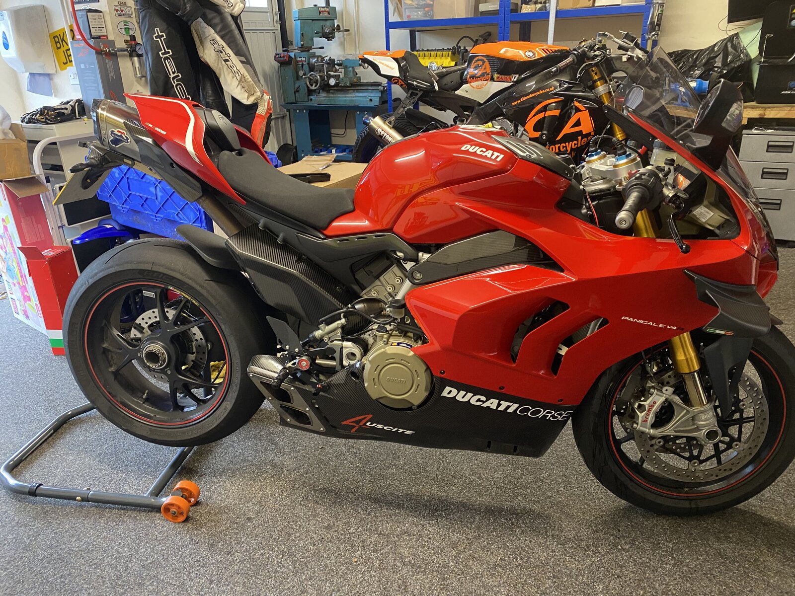

  11. Here’s a picture of it as is
    And I’ve bought these already to fit with the rest of the bits
  12. Excuse my ignorance mate, from what I can see, the front fork travel is 120mm and the rear 130mm and reading online, the total sag should be 25-33% (set to the lower side for track)? Going by those figures then you've only got roughly 10% in the rear and 20% in the front?
  13. set the ride height first...
    your bike looks low at the rear.... you can add the 135 tie bars (ie 2020 on) swapping out your std 140.... that'll raise the rear.
    but ultimately you need a ride height tool to get consistent numbers of the ride height then you can use the adjustable eye of the shock up or down the ride height to your requirement.
    then set the sag
    front rider sag circa 35-40
    rear rider sag circa 25-30
    then play with the comp rebound damping.
