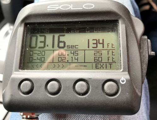

  7. I use one of these Aim Solo things. I've cross referenced the readings on trackdays while carrying an independent transponder and it's bang on. Dead easy to use and does what it says on the tin.... Does 0-60 too, this was after testing my car, he he he....
    It just Velcro's straight onto the top yoke. Easy peasy...
  8. I was gonna get one of those as they look pretty cool and have a lovely display but decided, after talking with a tech guy at AIM to go for the PZR as it's suits my purposes better. Just sayin...
