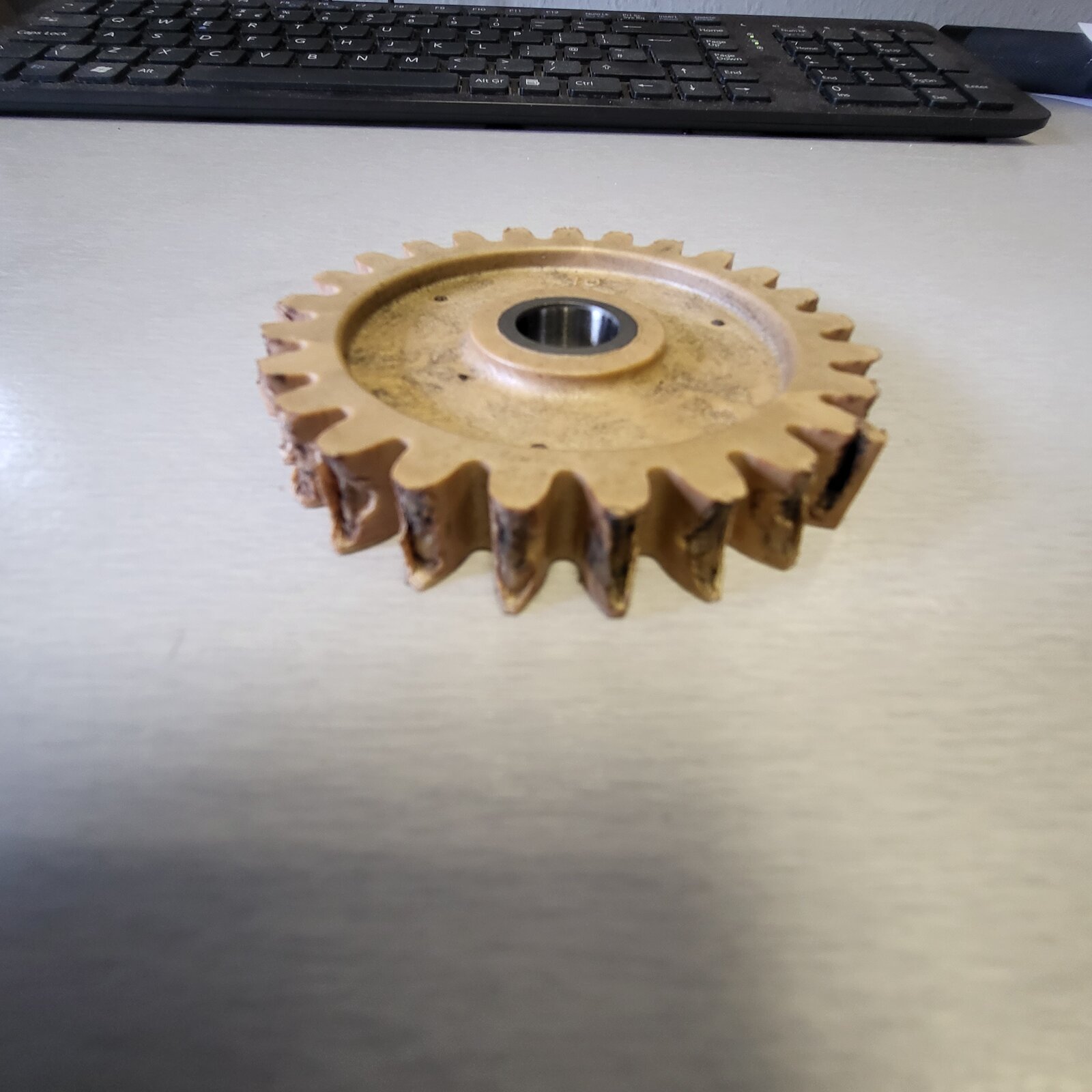

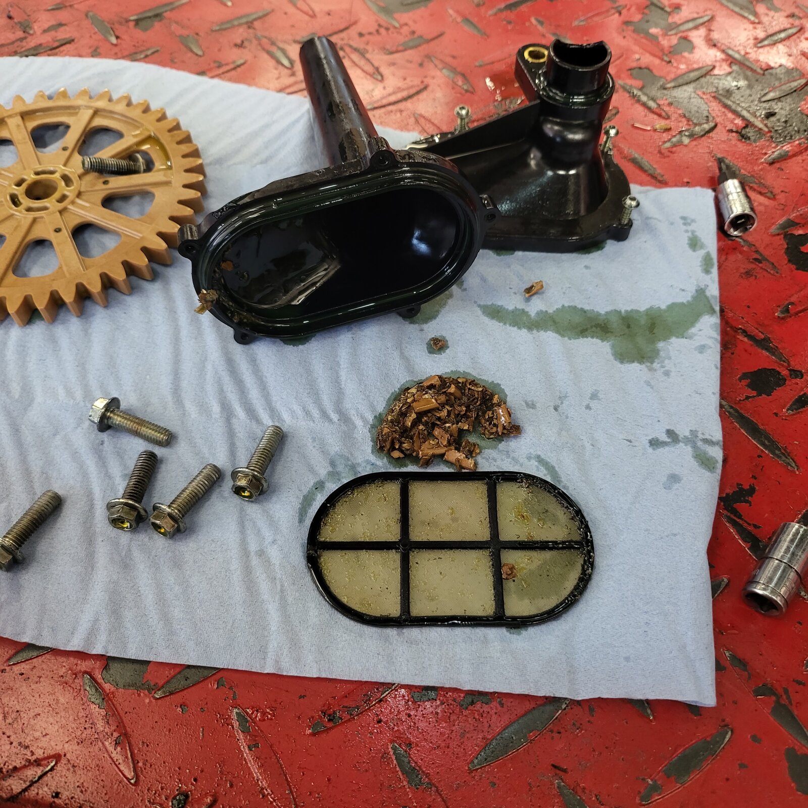

  1. Sorry if this is off topic slightly, but is that the result of something catastrophic, or just general build up? I assume something exploded from the size of the debris.
    When I changed the water pump on my 899 a few weeks ago, I drained the oil and put it back in as it was only ~600 miles old. However, it's not a track bike. The oil was left in the container (covered over) for about a week and I had a bit of orange dust at the bottom when I put it back in.
    https://photos.app.goo.gl/9XY2UsnJUZEVukxZ8
    I obviously didnt put that orange stuff that back in. The orange material wasn't magnetic and I assume its come from the orange cogs?! It didn't have a gritty texture either. I replaced my water pump and other gear with new plastic ones but see no obvious signs of wear just to be safe.
    EDIT: The sparkles are the overhead lights, nothing magnetic in the oil.
    I reckon they become damaged as there is no dampening on the train of gears. And contrary to Internet wisdom they aren't sacrificial if the water pump seizes......
  3. Did you replace like for like or is an upgrade available?
  4. A metal gear set is available, there is a thread on here about changing the gears

  6. Fwiw checked the suction strainer on my 959 this winter 7300 miles only 1 track day though
    All I found were pieces of three bond which they used to put the sump and other covers on with when assembling the engine oh for the days of gaskets
