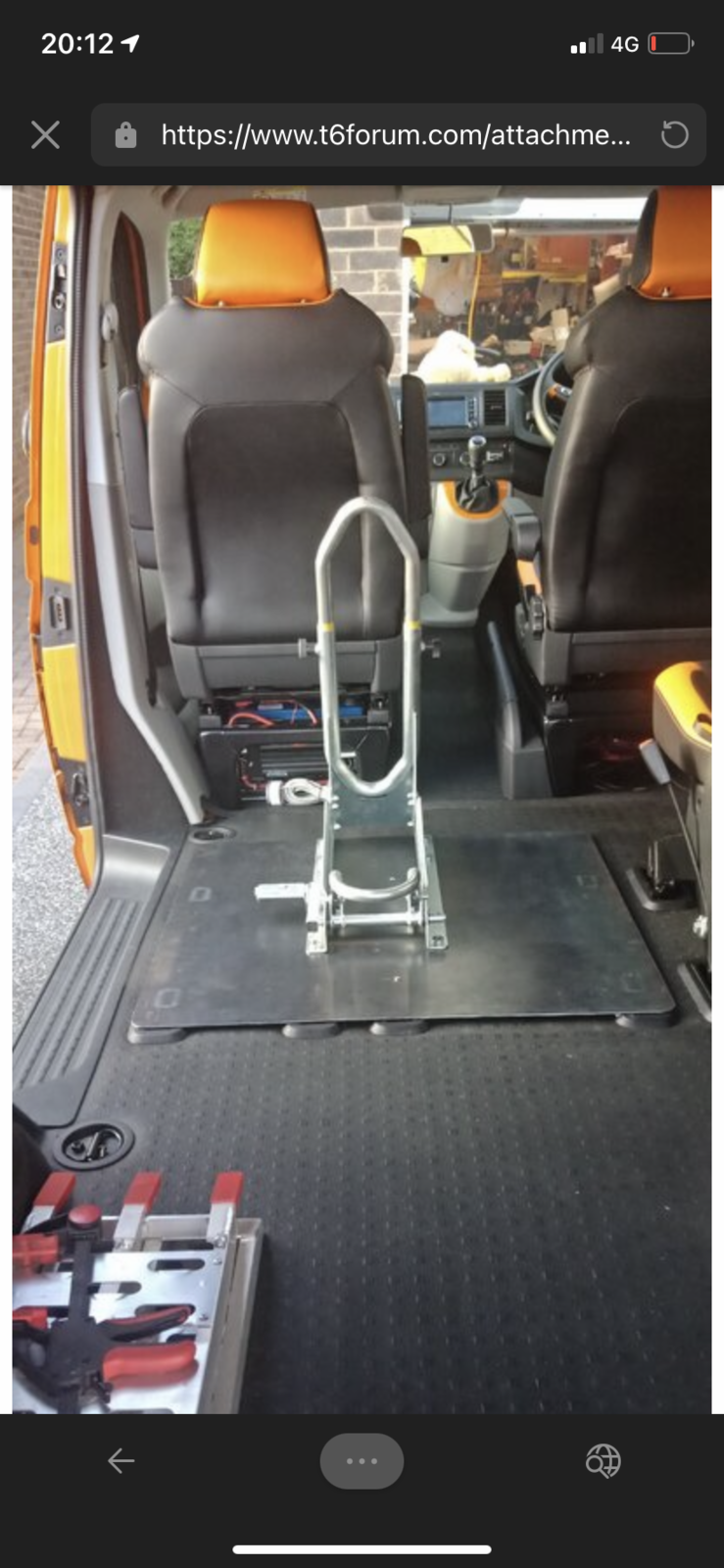

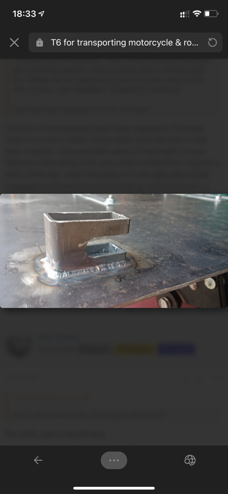

  3. I saw something on the T6 forum regarding securing bike chocks but wanted to open it up to some others here who have Vito and Transits to understand whether anyone has done similar?
    basically a guy has a really simple plate and box section steel that slots In where the rear seat mounts are and in effect locks the wheel chock so the bike can’t come forward, here are some pictures, anyone done similar?
  4. That’s feckin genius.
  5. It’s pretty simple isn’t it! And he just drops a bolt though which locks it like a disc lock
  6. I had a piece of plywood that I slotted in against the two front seats. I put some old carpet on the side that pushes against the seats and some blocks of wood where the front tyre sat to hold the front from moving. I also put four tie down points in the top corners on the side. I just used the VW tis down eyes and put a good rivnut into the panel, they come in so handy when securing bikes.

  15. Re the Heath Robinson plate, like Drinky I had some ply that I fastened the chock to when using rental vans and then pushed against bulkhead/seats and strapped from the middle or rear forward. Mostly worked ok
