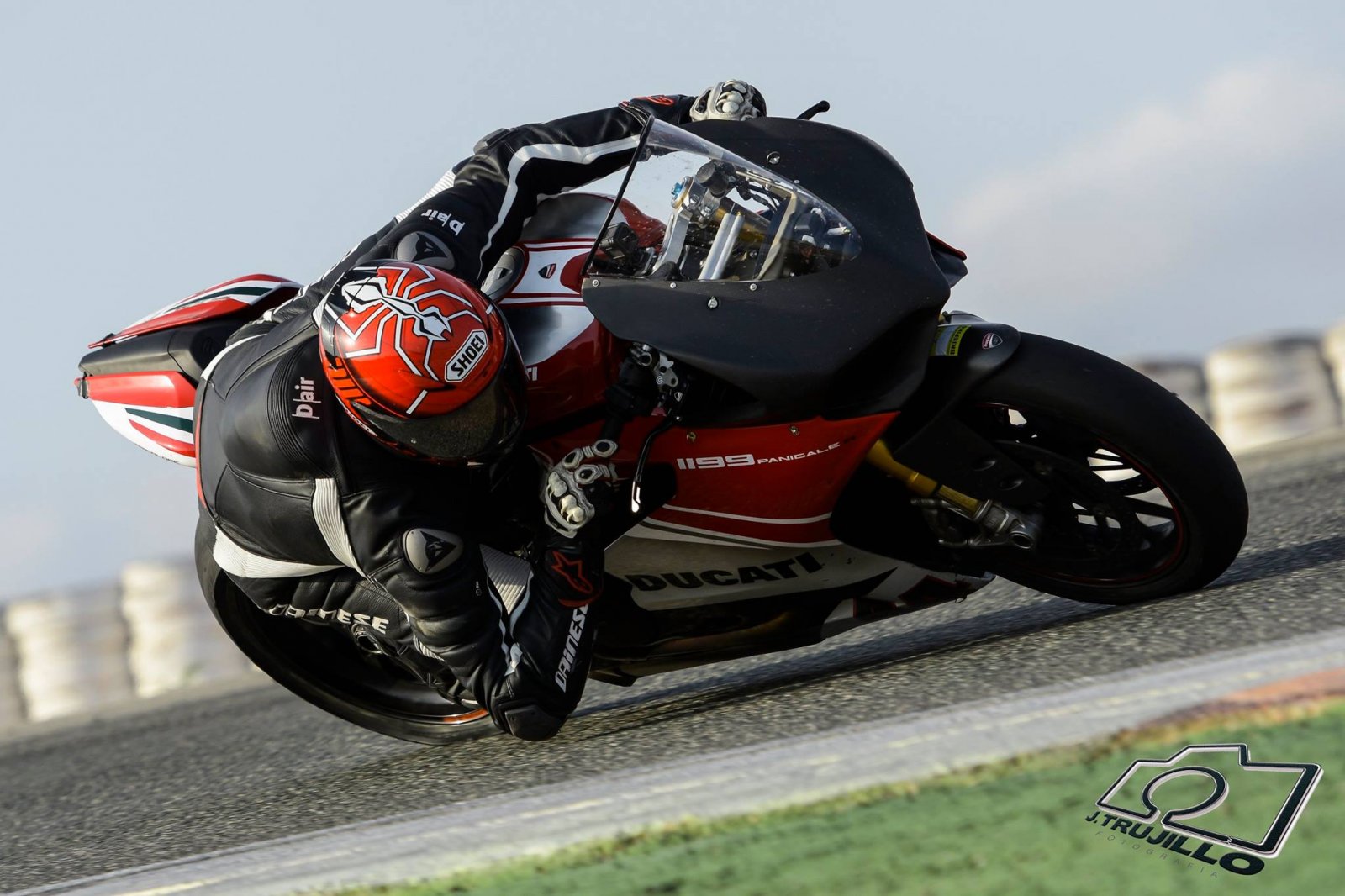

  14. What way is the front wheel turning half way through a corner? say you're at constant lean of 55 degrees in a long corner (and maybe doing some elbow heroics for good measure); is your front wheel in line at this point or still counter steering??
    It's weird because it seems that lean angle is proportional to countersteer when on the bike yet if you look at pictures you can't really see much counter steer?
  15. front wheel in that pic will be pointing to the right, just a tiny bit.

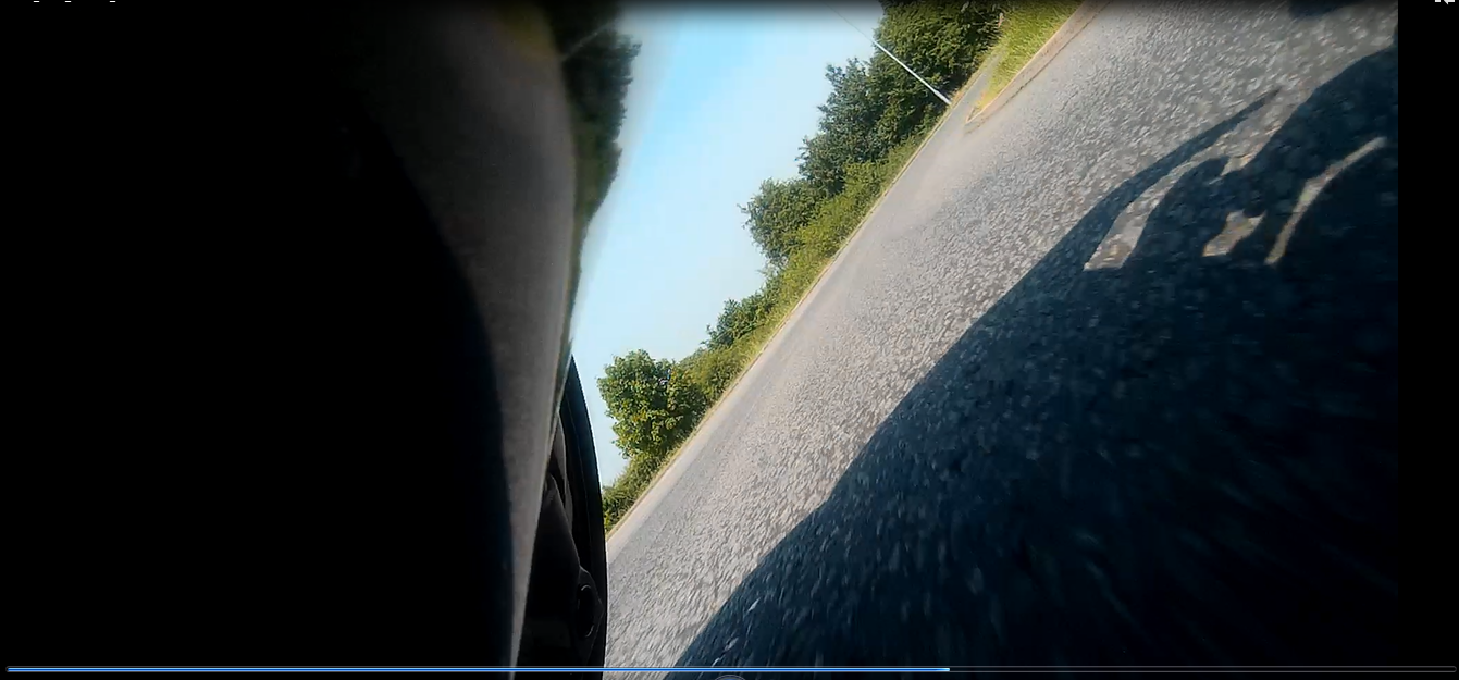

  16. So you're saying you counter steer to lean the bike and then when you stop changing lean angle then it goes the other way? I still can't get my head around that as it doesn't fell like it turns in towards the corner??
  17. Yep, mad isn't it. I mounted an action cam on my fairing at the bottom where it shows the front wheel and you can see it changing direction and pointing into the turn a very small amount.
  18. can just see it pointing in on this still.
  19. That is exactly what happens according to the scientists who've studied it. If you look at the track of the front wheel on the ground, you can see where it turns one way to initiate the lean, and then back the other way to actually make the turn.
