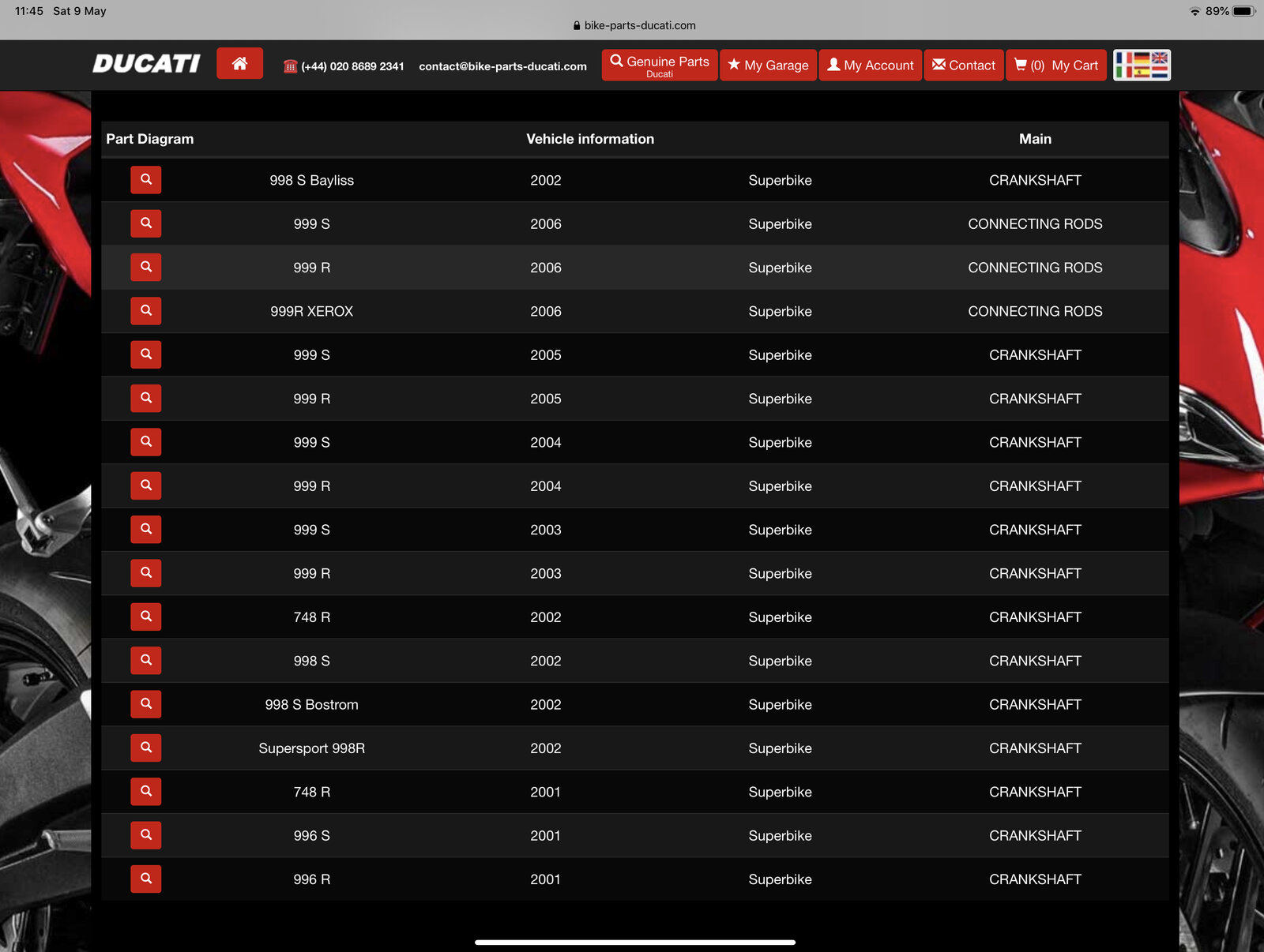

  9. Seeing as how those who say the con rods are Ti are basing their info on two different Falloon publications is it possible Ducati provided Falloon with duff info?

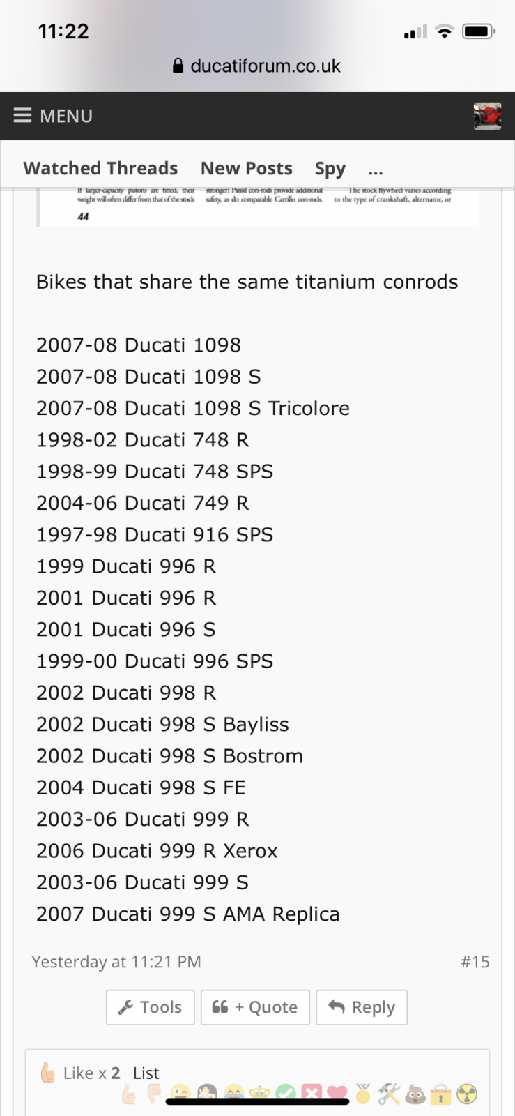

  10. Well this list says 1098s had Ti Rods. Which is categorically false! So wher does that leave all other info..
  11. The
    Given that all of the parts catalogue’s and multiple sources state that the bikes in question came with Titanium rods unless they were American spec I don’t think it likely that all of those sources are wrong.
    It is more likely that Ducati possibly used steel rods in some of the bikes, either by mistake - or Mario and Luigi ran out of Titanium parts occasionally when they had a production deadline to meet and grabbed some steel ones knowing it wouldn’t be noticed until years down the line when the engine was finally cracked open.
    I read on another forum that this kind of thing is far from unknown.
  12. Yeah - copy and paste error on that one - doesn’t mean that every single parts catalogue and multiple published sources are wrong.
  13. I believe Edgar Allen Poe...

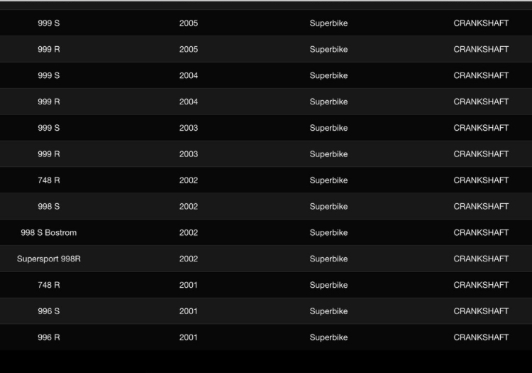

  14. I took a screenshot this time to avoid human error. These are the bikes that share the same conrods.
  15. but on that list it also says a 999r 749r etc etc share the same crank...which is wrong..
  16. And it’s not even the same con rod dimensions as some are .. but the 749r rod is longer..
