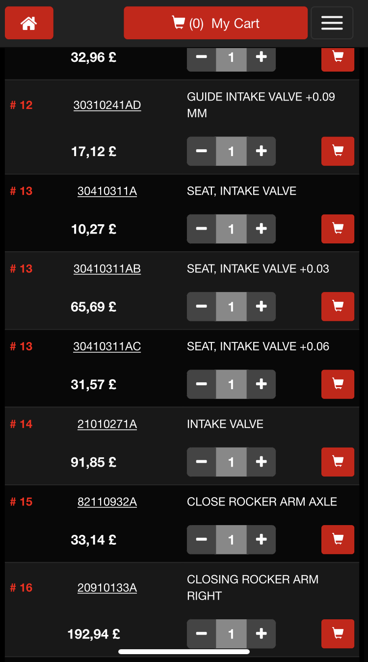

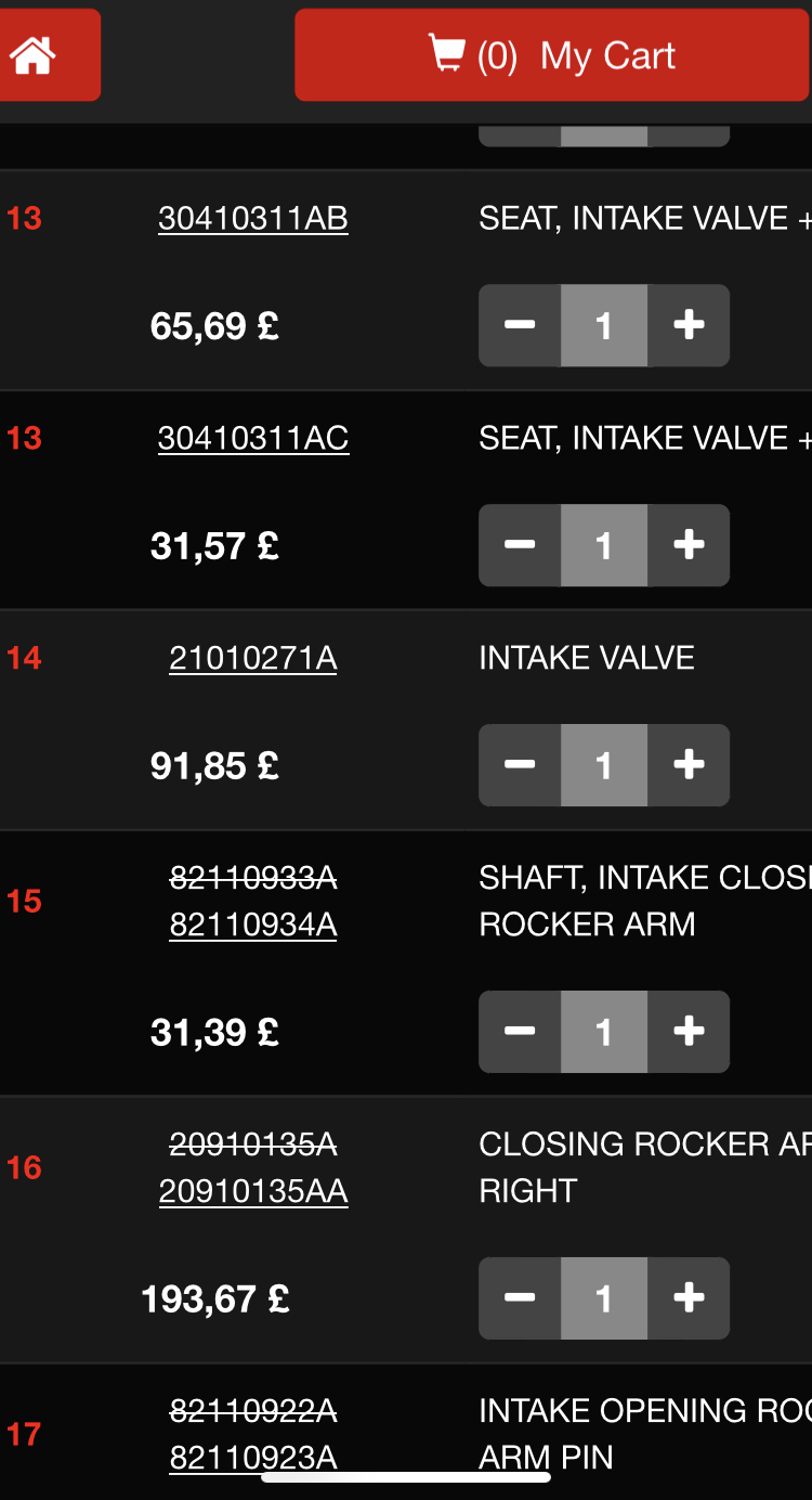

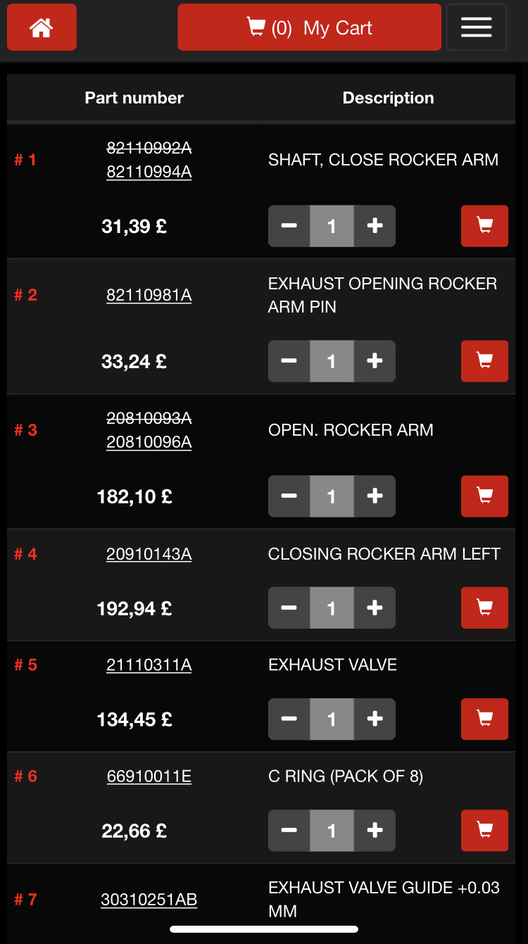

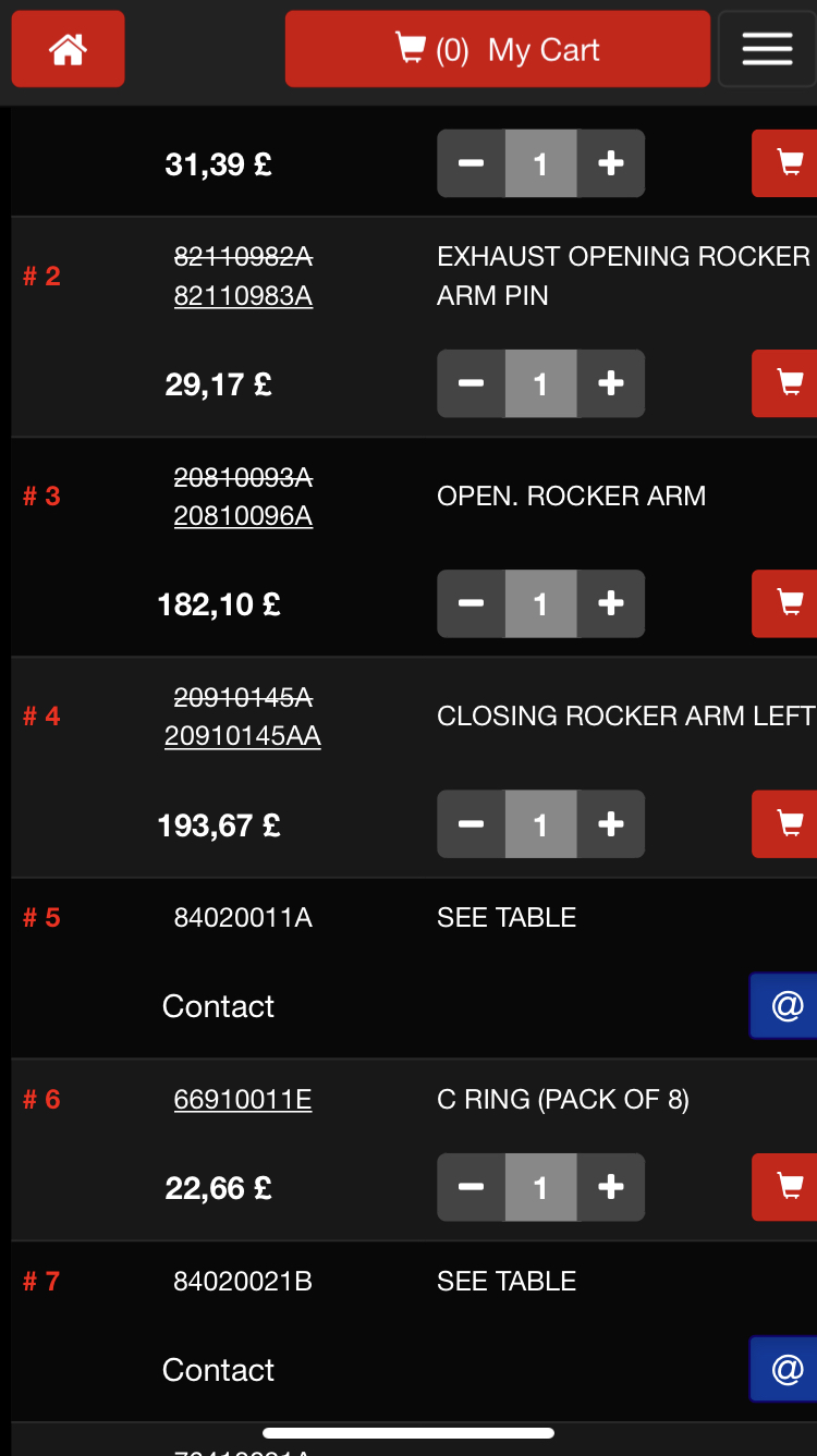

  8. Ti valves..
  9. So could it be correct that the 996R had Ti Valves, Ti Con Rods and Sand Cast Cases and the 998S didn't, apart from some that used up some spare 996R parts hanging around - like the first ones produced that went to the press? :thinkingface:
  10. RTFI... the valves are the same part numbers 996r 998s on that parts site ....same as the con rods!
  11. DED7FBC0-3D78-41A7-8D06-D1D8008FB9D5.jpeg C14086EC-F730-403A-9FA7-AD796E7EE9AF.jpeg
    top is 998s bottom is 996r... same valve part numbers from the trusted source....
  12. Must be ...or just another 996r myth...

    8D924A08-DE7C-4D66-9464-05D8B9DAA0FA.jpeg 39419ED5-39DC-40B2-9895-60C24B894DD1.jpeg
