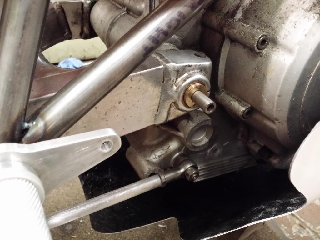

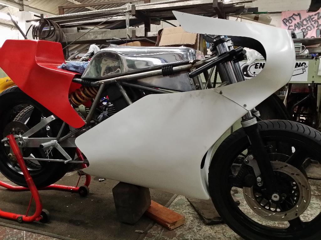

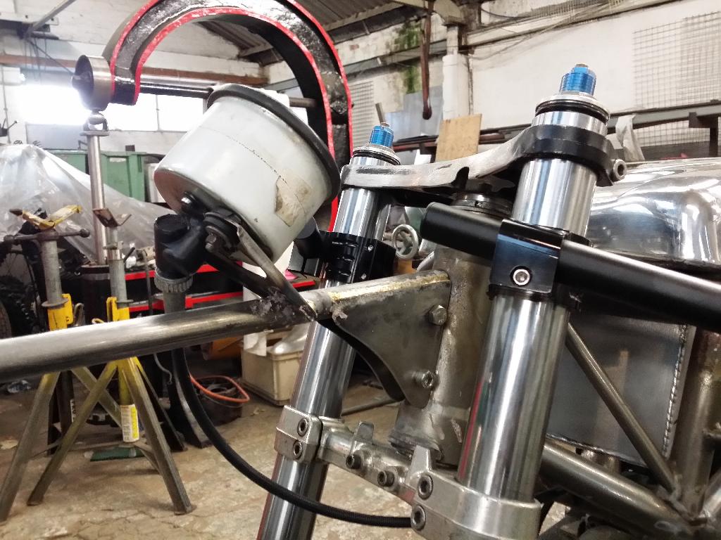

  4. We have made a bit more progress,fairing bracket is roughed out and the cross over shaft for the gear change is on its way. 20140408_181544_zps2quvkpdw.jpg 20140412_113107_zpssroomb6p.jpg 20140412_105359_zpsf5xbkaup.jpg

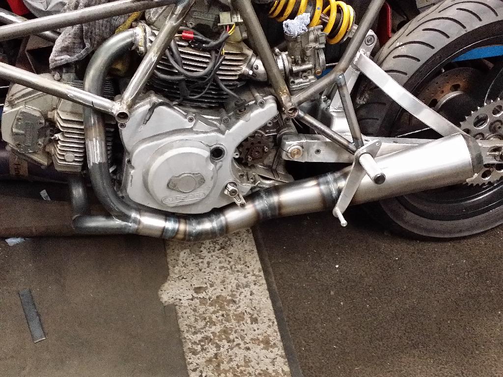

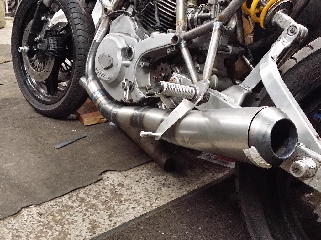

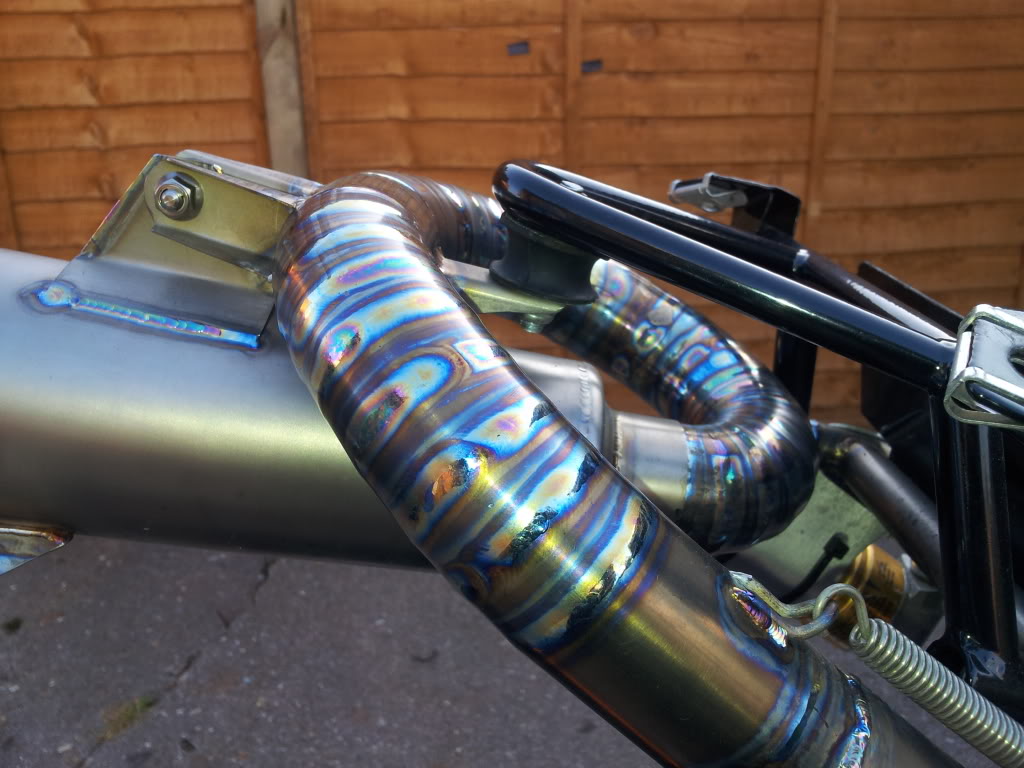

  10. I have the exhaust 90% done,just brackets baffle and spring hooks to put on,i forgot wot a pain in the arse exhausts like this are. 20140422_182632_zpscbt8vxac.jpg 20140422_182705_zps69cfojmp.jpg
  11. exhaust looks stunning - never seen someone take so much trouble getting the shape to follow the contours of the crankcase. Clearance on swingarm ok?
  12. Bloody hell that exhaust is a work of art!
  13. You couldn't just knock up a system for my Guzzi could you..?
