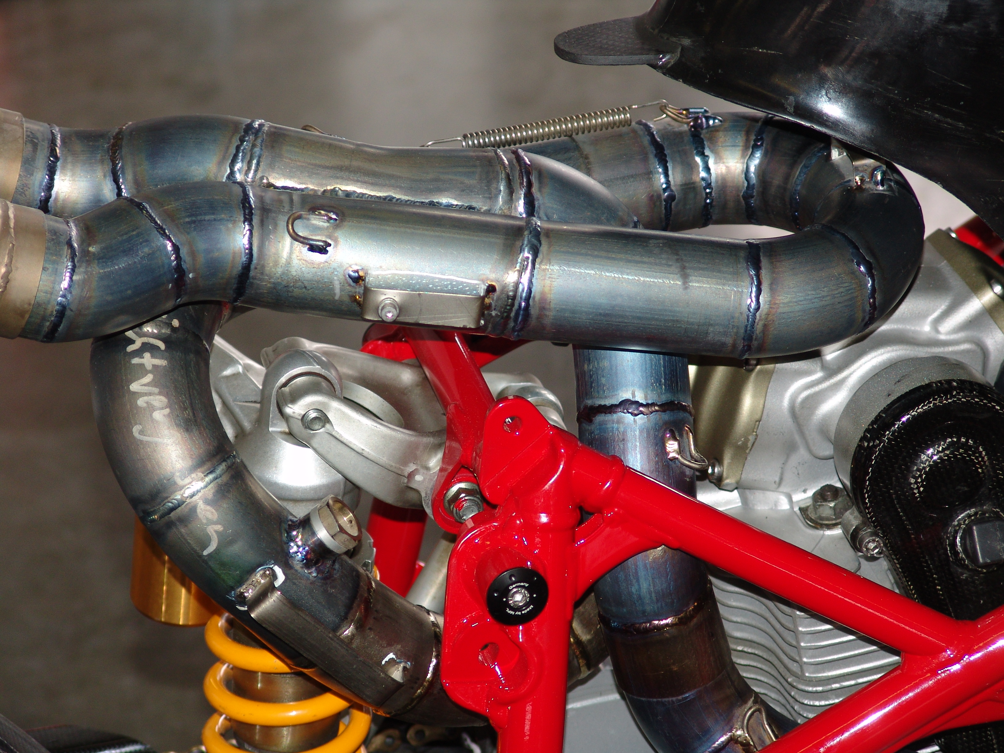

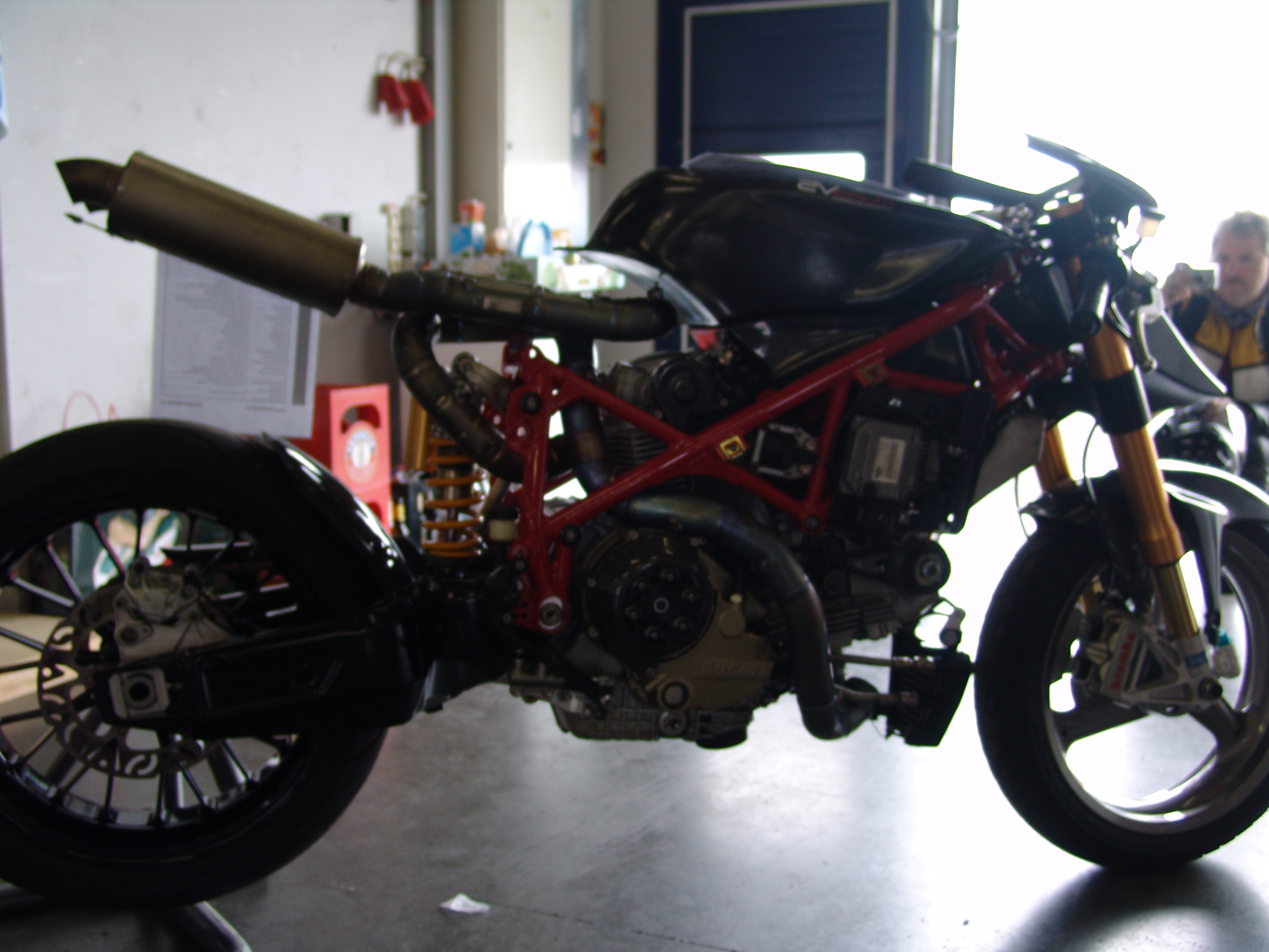

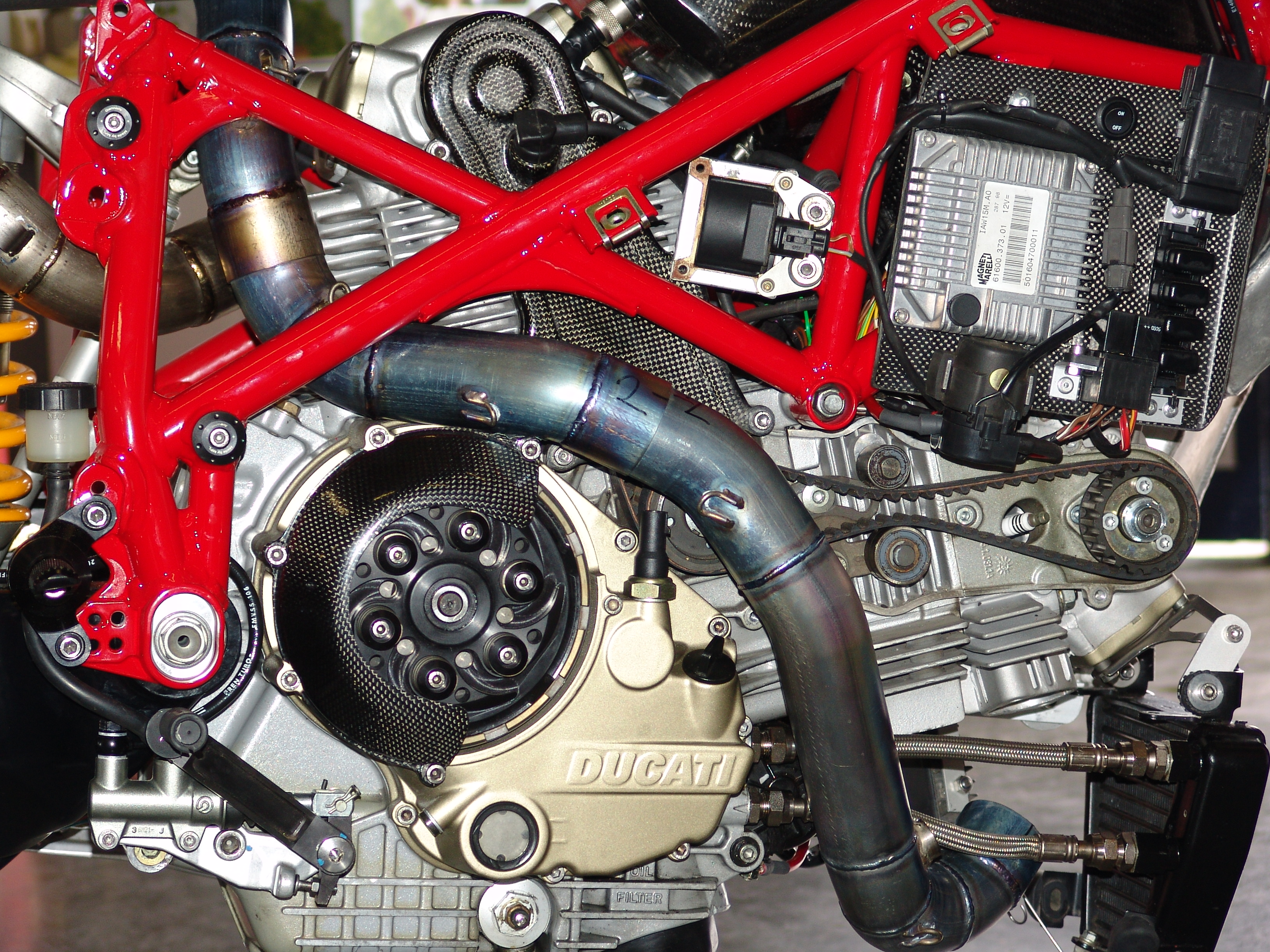

    Although not finished!
  4. it looks like there is a few systems chopped up to make that one.
  5. fair comment but at the end of the day if your going to build a special then it has to be just that not just a load of bolt on chinese cnc gold.

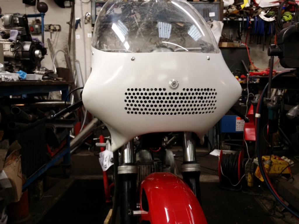

    1. 20140503_175536_zpswuzradt1.jpg 20140501_154154_zpsydvumqjf.jpg 20140507_185551_zps847rf1bb.jpg 20140507_185639_zps5uegftsp.jpg 20140430_173830_zpsjshjpdsy.jpg
  8. Looking very nice, love that tank. :upyeah:
  9. Chad that is awesome beautiful

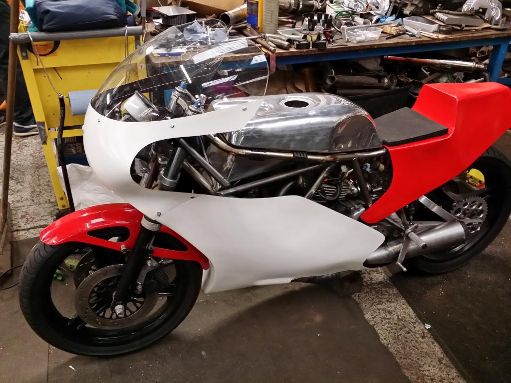

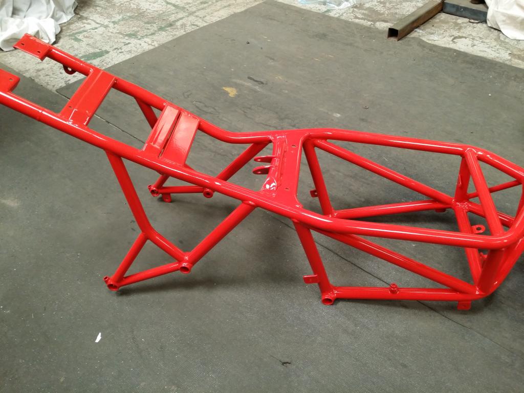

  10. Thanks for the compliments,this will be the last pic for a week or so untill the frame etc is powder coated,this is my std 750ss frame and the modded frame,now this bike is nearing completion i can crack on with mine. 20140508_150005_zps47ofrf4n.jpg

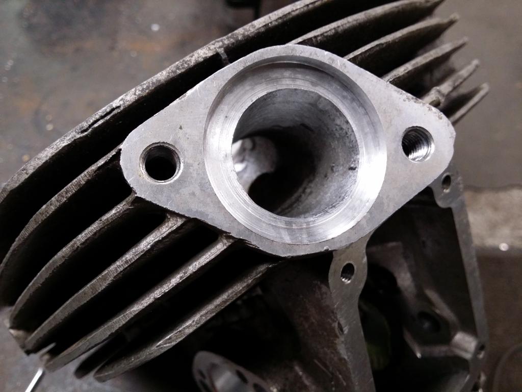

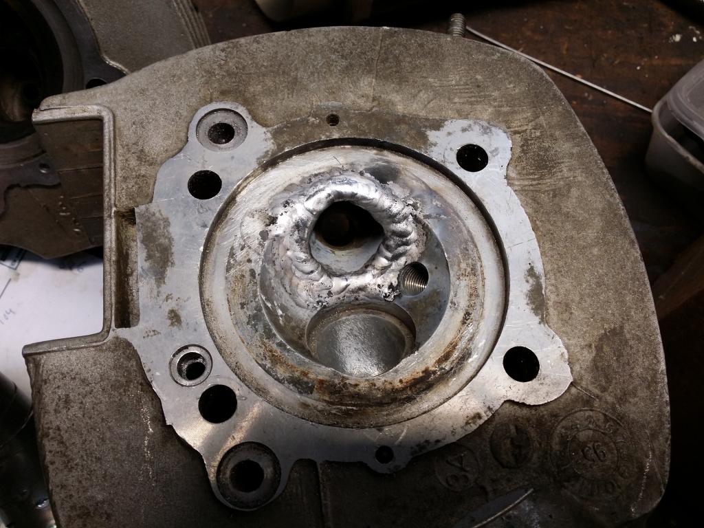

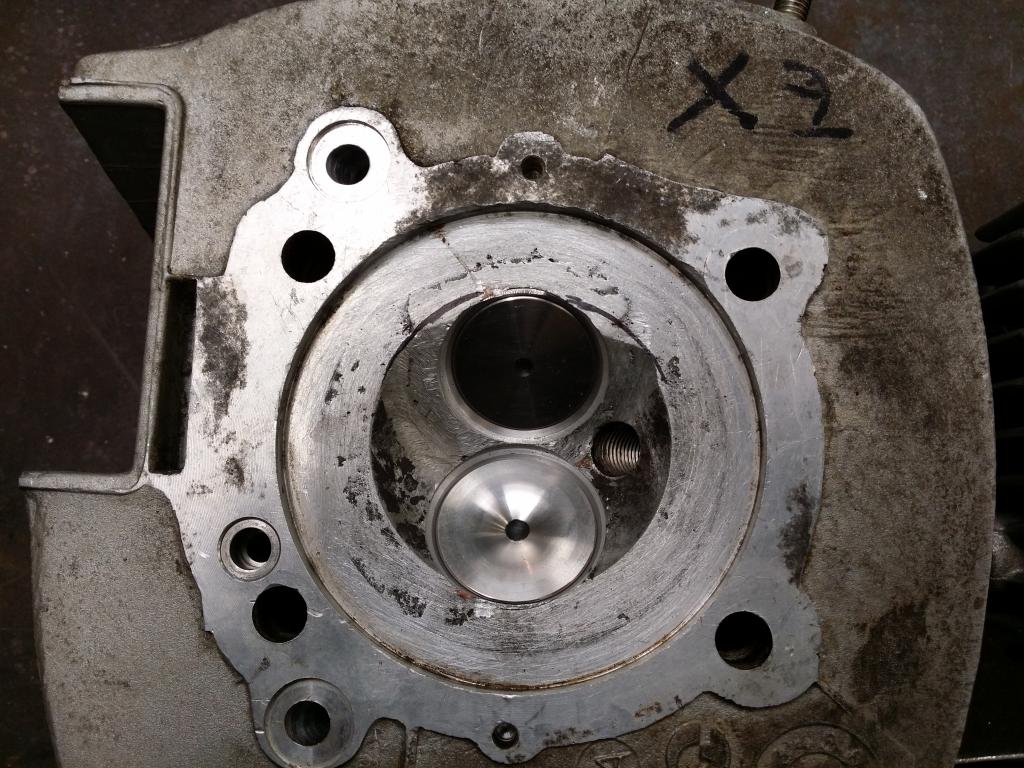

  11. firt part of the puzzel has come back,the new wrong way round valve seats have been done with success,that was the big worrie,i just have the front cylinder to finish porting,and a bit of cleaning up in the combustion chamber, 20140515_154344_zpsjr1cviks.jpg im hoping to pick the powder coat up before weekend.

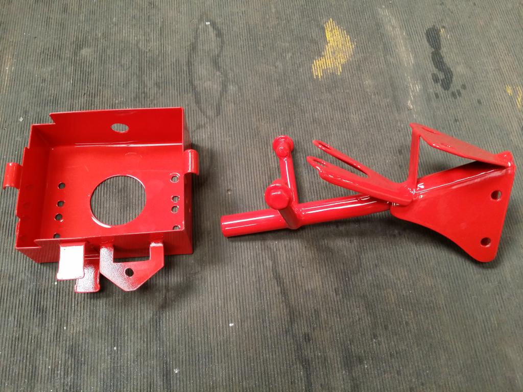

  12. Just got the powder coat back today...nice job,the photo doesnt do it justice. 20140517_122847_zpsdmvxi8jg.jpg 20140517_123156_zps6ogfkpzs.jpg

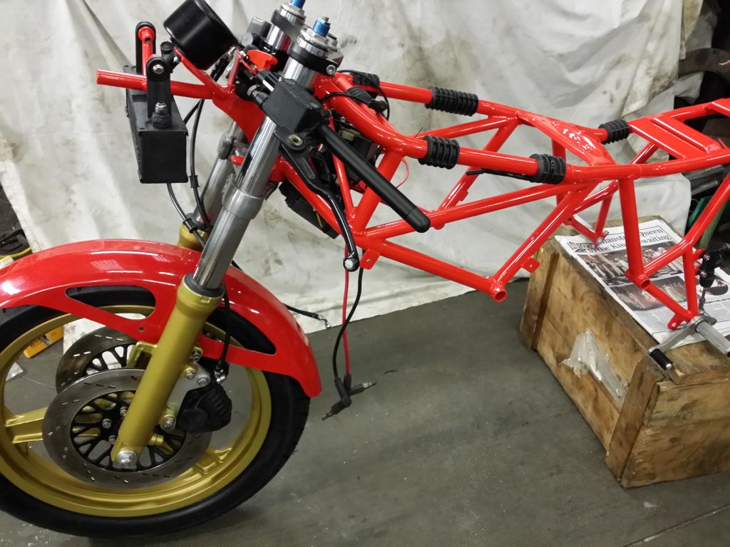

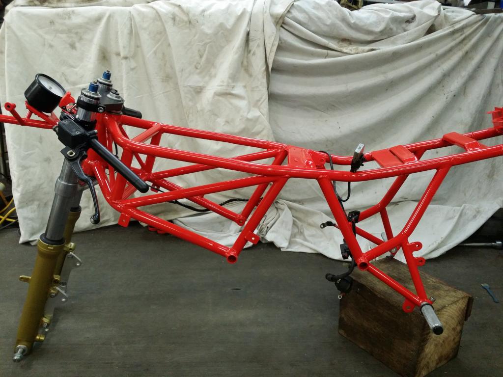

  14. This is where all the hard work pays off..
  15. This is where all the head scratching starts.

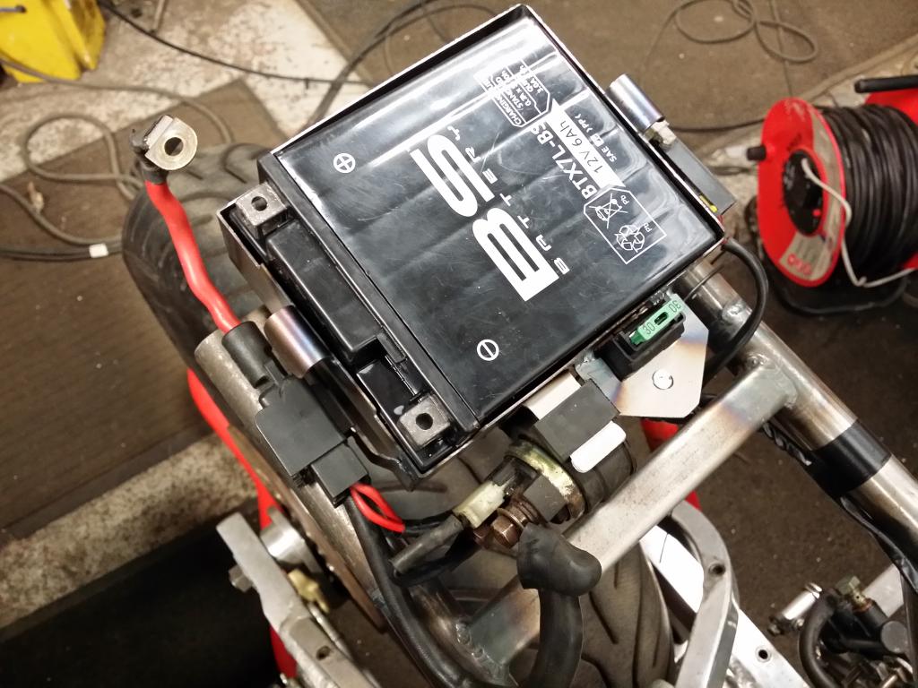

  16. the owner is taking over the build now,i have the motor to sort out,and the bike build should be fairly stright foward as it was a complete bike a week ago,the main concern is getting the automatic clutch from the usa in time,if we ont get it his firt parade on it will have to wait,i have to finish the fuel tank tomoro #2 so we can get everything to paint.

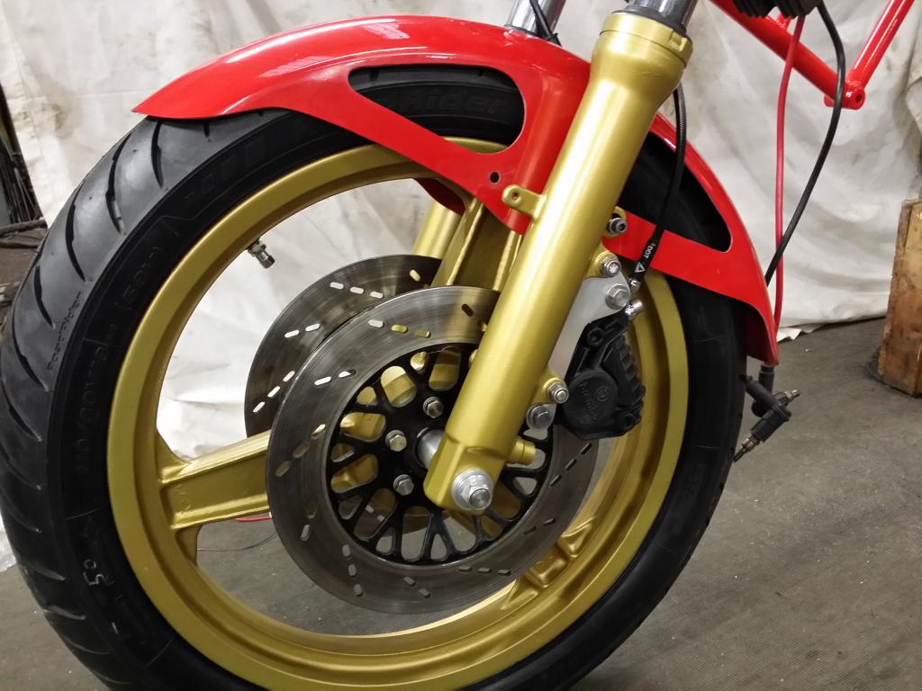

  17. No hi tech stuff here...disaster,the local bike shop orderd and fitted the wrong tyres and wrong size, 20140522_180858_zpsmxsmaktj.jpg 20140522_180937_zpsov7k4aqz.jpg so they have to go back....no much diffrance to AM22/23 track compound,on a plus side they would do 10,000 miles,nice finish on the wheels and forks finished with satin laquer,the paint is going to Clive at Rapier paintwork tomoro for his usuall top job.
  18. Stunning stunning and stunning I'm running out of superlatives for this. Loving your work

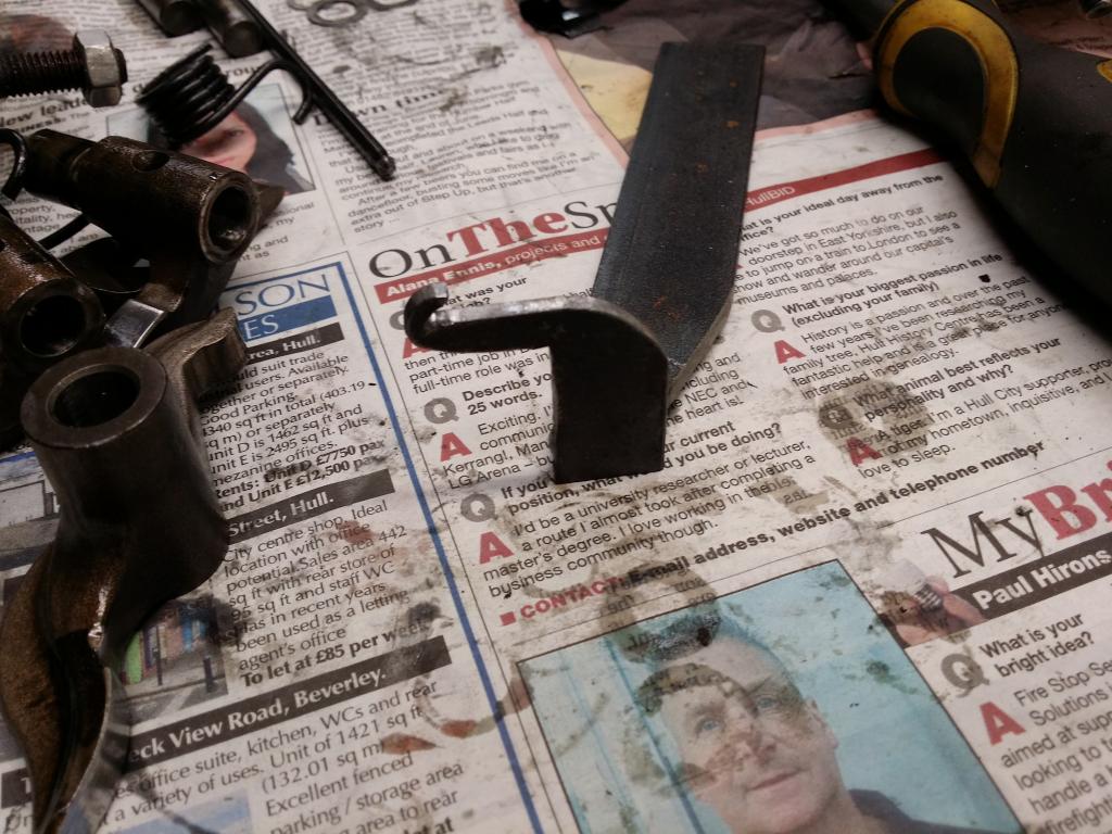

  19. just getting the cylinder head finished,recess for the exhaust gasket done in the new port,i spent most of today assembling the heads and shimming the valves,nasty job,thankfully its only a 2 valver,i had to make the useless spring holding tool,although it works ok when assisted with a cable tie,only 10 days to get if finished.
