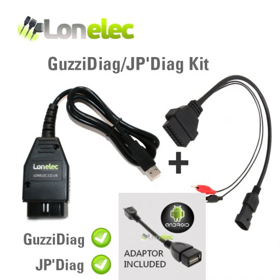

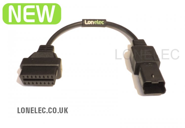

  4. Chris you will have to ignore my ignorance but looking at the complete package in your first link and comparing it to the 2nd link you provided, the lead far right of 1st picture looks similar to the lead in the second picture except the + & - lead attached
  5. The connector in the first picture uses a 3 way Superseal connector and two fly leads. It connects to the K Line and earth
    The connector in the second uses a 4 way Sigma Miniseal connector. It connects to +12v, -ve, Can H and Can L
    They are different as the ECUs use different protocols for the diagnostics
