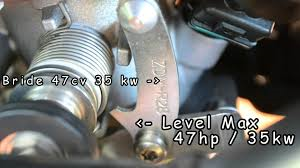

  2. Bob T, are you sure it is a different Map that limits the power? My experience of importing bikes into France is that they need a "Kit Bridage" which limits the mechanical movement of the throttle and the Map is not changed. (See pic of a similar bracket....)
    Maybe this is the same for the export market to France for most new +100HP bikes.
    My old Daytona 675 had this bracket fitted to the throttle body for the French HP limit. although, before all that, whilst still at full power, I had the 675 map changed to suit a race can at Triumph (UK) and they also said they had a "French" map listed.
    The Ducati 999 had the same style throttle limiting bracket for importation into France as did my mate's ST1050 Triumph.
    It will be interesting to see if yours is a Map change.

  3. Interesting! Now you have made me think. Perhaps I should go to the garage and start taking fairings off to see what I can see. Trouble is that I would not be sure what I was looking at. I had just assumed that the ECU would be the way that it was done. I looked at Ducati_Tune_list and noticed that there was a number there for an 848 EVO French version and that number was different to the UK or EU version, but then again all the numbers seem to be different as there are four 848 (non EVO) numbers, including a US one.
  4. Well Mr Dorset, (I was born in Dorset) it seems that you may be correct. I have just looked at the parts catalogue that I downloaded yesterday, and there seems that on page 68 there is are two items that might just be what you are talking about! Now to find them on the bike, I think they might be behind the right side fairing!
    What a great forum this is!
  5. Looks like those parts are on the throttle bodies so you may need the tank and airbox off.
  6. The limit bracket for the 999 was inside the airbox on the throttle body, secured with "snap off / anti tamper" screws.... Not a quick cuppa, run out and take a Butcher's in your slippers type of job.

  7. A quick way to check is just to see how far around the throttle twists (ideally against another bike the same) as it will be quite noticeable... Or maybe someone on here can do a quick rotation measure to compare - if they have the same bike.

  8. I'm back now. RH fairing off and the black bit below the seat on the LH side allowed me to see the bar that links the throttles. I can see no restriction and it seems to turn the butterflies about 90 degrees. I can't see from the parts catalogue where that bracket fits, but it is nowhere to be seen from the outside of the throttle bodies.
