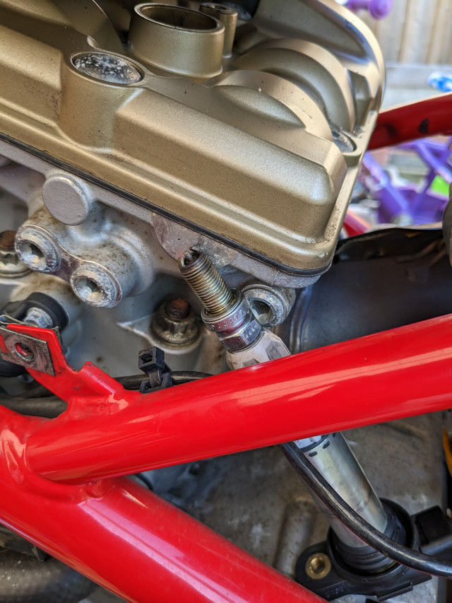

  11. Thank you all fore the suggestions so far.
    Pump is working during cranking as it spits out fuel when the spark plug is out from the hole.
    I really don't think its the Sprag as it doesn't sound like any of the sprag failure videos I watched - and it is not free wheeling.
    It is cranking quite fast, pushing air out the exhaust and fuel - you can smell it.
    I had both plugs out - neither spark
    both get 12V to the tip of the spark plug - as measured with the multimeter.
    I literally rode it 100 miles 4 weeks ago with no starting issues whatsoever , filled it to the brim with premium and put it in my garage. I don't see how the sprag would just die and not gradually get worse first.
    The only thing that's new on the dash is that the oil pressure light never comes on before you start the bike.
    No error codes.
    It has to be something electric - but what. - also tried the original ECU that came with the bike just for good measure - no difference.

  13. No spark on either cylinder,
    Had both out at the same time and tried still no spark.
    German Ducati forum suggested it might be the crank position sensor - I took it out and cleaned it - put it back in - still the same. - however it is cranking slower since I put it back in ?!
    Thing is - no error codes - as soon as I unplugged the crank position sensor it threw up the code.
    Don't know if it's worth changing the crank position sensor or throw in the towel.
