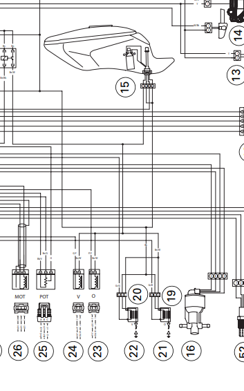

  1. Fuel pump and coils are both off the same supply through the relay. If the pump runs then it proves relay , but if you disconnect the fuel tank when trying a spark test it would route all the power through the coils . If 12v is ok and ground then it can only be the signal (or both coils , very unlikely)

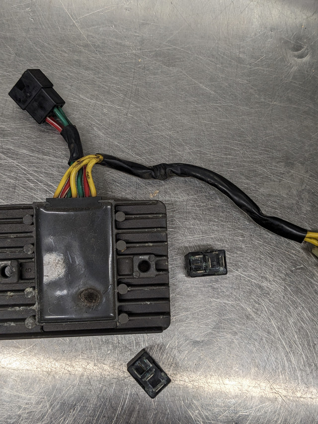

  11. Update: Just spoke to the specialist:
    Short in the rectifier/regulator caused no spark. - also caused the oil light not to come on on ignition on.
    • Like Like x 9
  12. Hmmm.... so does that mean the reg/rec popped after you finished your last ride and parked up? Latent heat from the engine, ambient air temperature & no air flow was enough to cook it? Or perhaps it popped during the ride but it had enough to get home.
    I must admit I've taken to switching on and directing the fan heater (set to cool) to the reg/rec when I park him up in the garage on these hot days.
