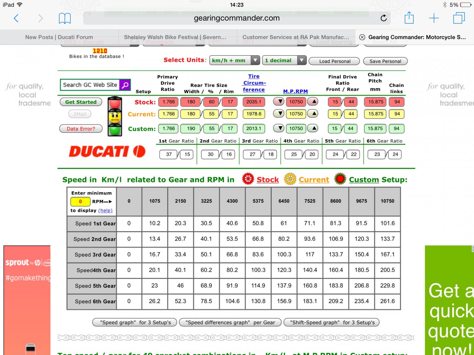

    Another thought: will it take a 190 rear? If so a 190/55 wont be massively different will it? Maths needeed to be sure

  4. Heres the alternative options in circumfrance
  5. Running a 190/55 reduces tyre height from 25.5" with the 180/60 to 25.23" so IMO you would notice very little difference overall but it would give you a wider choice of tyre. I ran a 50 profile instead of a 55 profile on my Multistrada and it just brought the revs up a smidge at the same speed which was great at 30mmph. Sadly the tyre occasionally rubbed my aftermarket end can so had to go. If you do consider the 190/55 I can whole heartedly recommend the Metzler Racetech Interact K3 but not in heavy rain. Andy

  8. ? For the same wheel speed you are actually going fractionally slower so in reality when the speedo says 30 you are actually doing 29 ish. Andy
  9. Suspect the dtc is profiled for a circumference of a specific brand so may be a factor. In after market you can prog your own in. But that could also apply for sticking Dunlop 180/60 on. Didn't Ducati say ONLY the Pirelli would work on the panigale?! ;)
