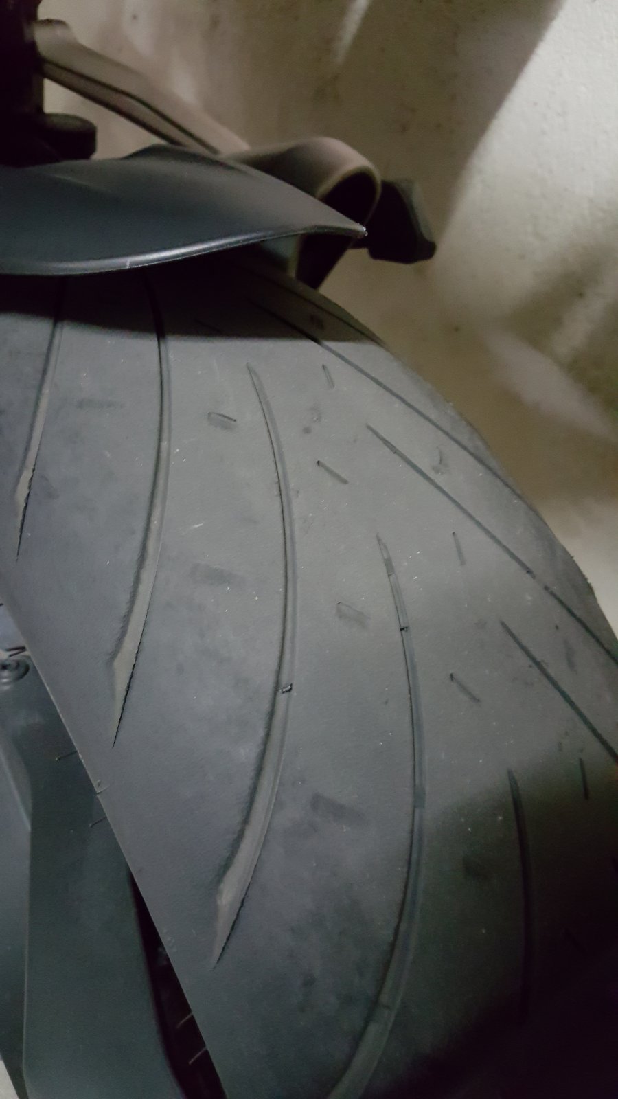

  2. 3300 miles and my scorpion 2 rear is on its way out, now showing the beginning of a flat spott

  5. I see you what John means. Out Thursday and anything other than straight on overbanding and it unsettled the bike a little. Felt like it was sliding, suspect because it's fit quite a flat spot

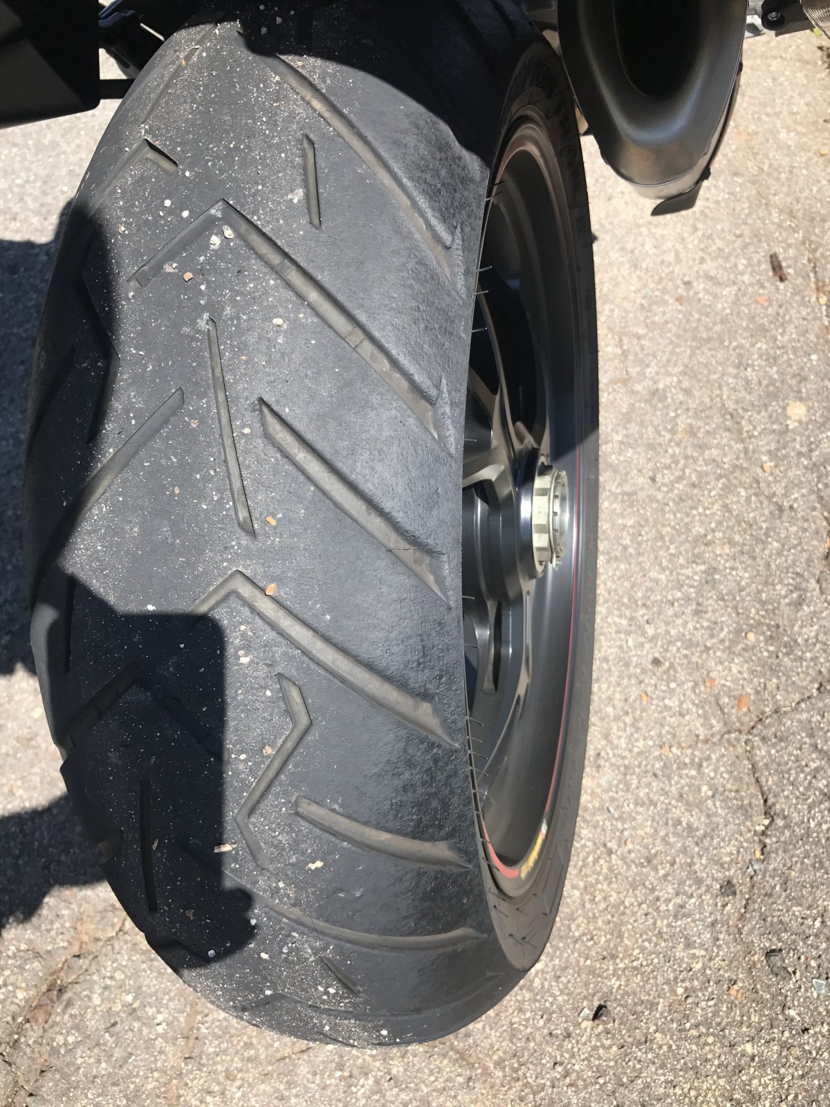

  15. I just changed mine Scorpion IMG_2397.JPG trail II's 6200 odd - still some to go but doing some off-roading next week on an away trip so a slightly early change. Note the wear patterns - this is from rebound settings being too soft - I believe ...
