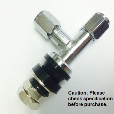

    I have steelmate type TPMS but havnt got it fully working yet as have to adjust the valves as mine hit the calipers, have ordered these from my-fobo.com
    The twin seem good for the front as pressure monitor can go on top and can still access side valve for refilling.
    Rear will probably need to be angled one, it’s a straight at moment.

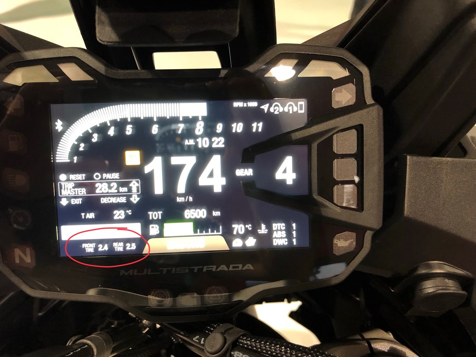

  14. I saw the new 1260 at the Long Beach Moto show today and it looks like it has TPM standard. This is a (really bad) photo that I took while the dash was running through a demo loop. It only showed the tire pressure when in Enduro mode, but I'd imagine that if it definitely has it, it would be possible to show it in any mode. IMG_0051.jpg
  15. Wow, well spotted, fingers crossed :upyeah::cool:
    I suspect though that they might have designed it in but not fitting the sensors and receiver module just yet, or else surely they would have announced it.
