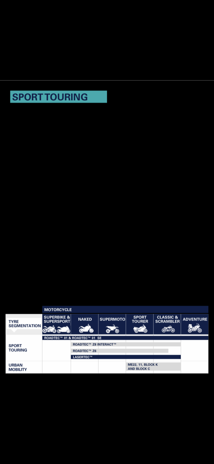

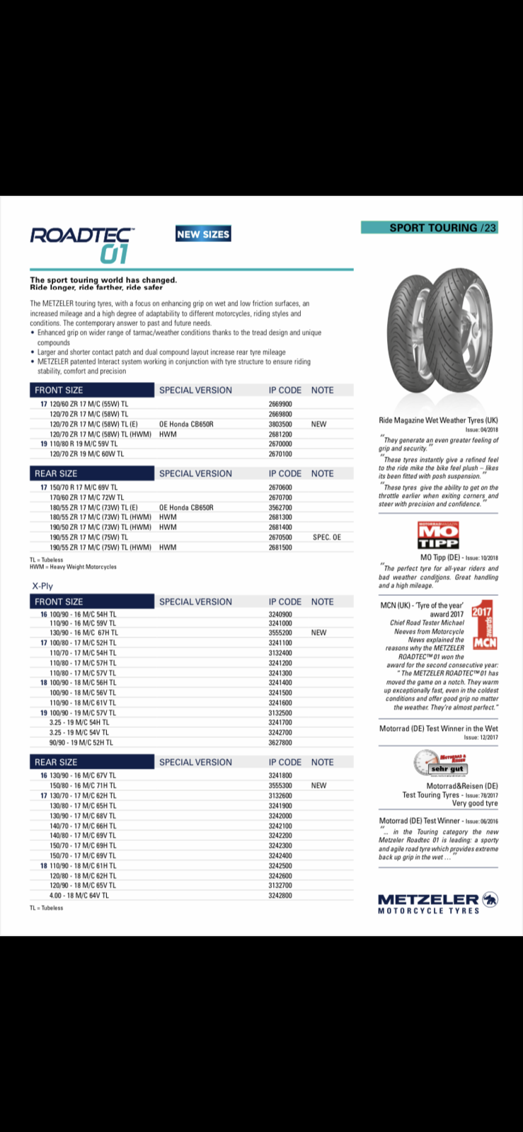

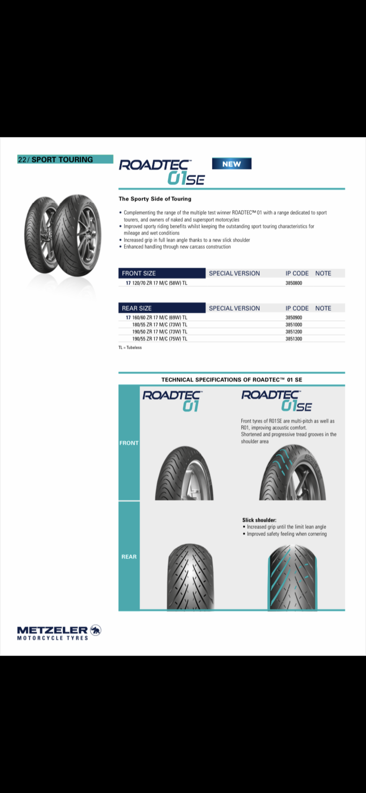

  12. Here’s the applications for Roadtec 01 and R1SE
