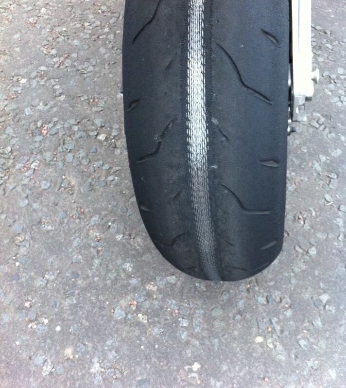

  2. Yep. Straight to a local tyre place ASAP. I'd say thats's about to go.
    I've had mine let go like that during a ride exposing the belts. A dual compound Michelin with plenty of life left in it that had an issue (from memory I'd not done many miles at all) and a Pirelli through too much wear. The Pirelli went v quickly too however. The steel banding, almost needless to say, is v slippery. To get home I deflated the tyre quite a bit to get a bigger contact patch but it didn't help much and wasn't very nice.
    I think this is the Michelin that failed.
  3. Looks more like a Bridgestone does that??
    But it does illustrate the fact that once they get down a bit, its not long before they are through to the belts!
