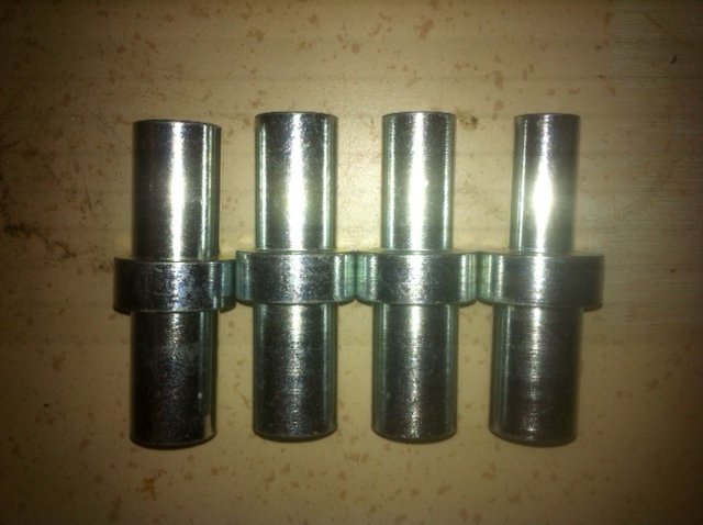

  1. are they off your batman utlity belt ;-)
  2. might be............i bought a front stand from italy although the importers were 2 miles from work..........you got a box of these with it to suit a variety of fixes........i think the small one is for the 848,.........
  3. I had about 8 came with mine headstock and none actually fit properly, its a large hole from memory

    My experiences are more like Bradders - they foul the fairing, and the pins (13mm - 19mm inc) are all miles too small. I need to stick a vernier caliper on it to see what size the hole actually is, but I am away from home on hols at the moment so can't check.

  7. I had the same problem on a Gsxr 750 so I used a long reach socket that fitted the hole. then found the pin that fitted that the best put that pin on the stand and then put the socket over that I think I used a spark plugs socket ( a bit of a bodge I know ) but it worked had it on the stand for two weeks

  9. Guys,

    if you can measure the size of the hole (use a socket to find a snug fit) i will measure the bits to see if they supply one to fit your 848

  13. Ian, I've got a stand from proBike that has the same selection of pins as Andy has posted. When you're back, pop round and borrow it if you want. The (small diameter) one that was supplied was a little too long, so I had a local buddy take a couple of cm off it on his lathe.
