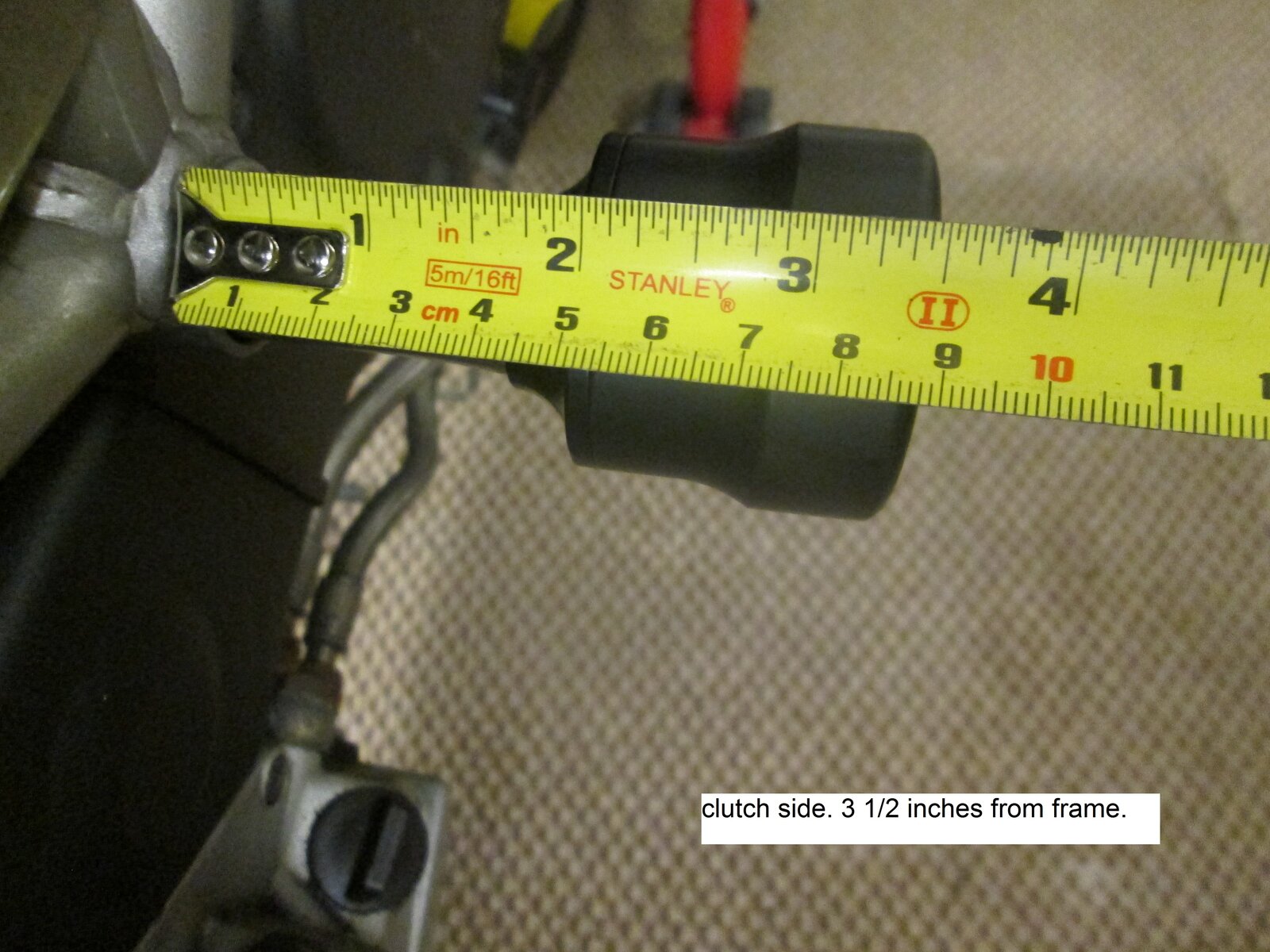

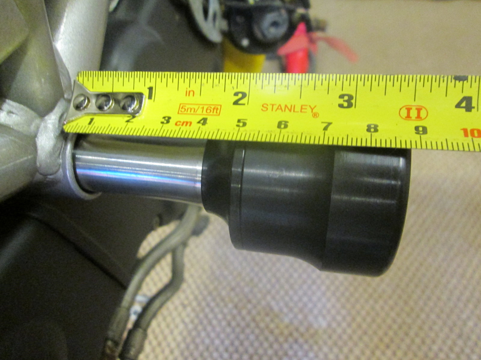

    Modifying the join and fastener on the fairing won`t work. Just measured the sliders I have and they measure 90mm from the frame boss. Bloody things.
    I`ll email Motowheels with this, they did say to keep them informed.

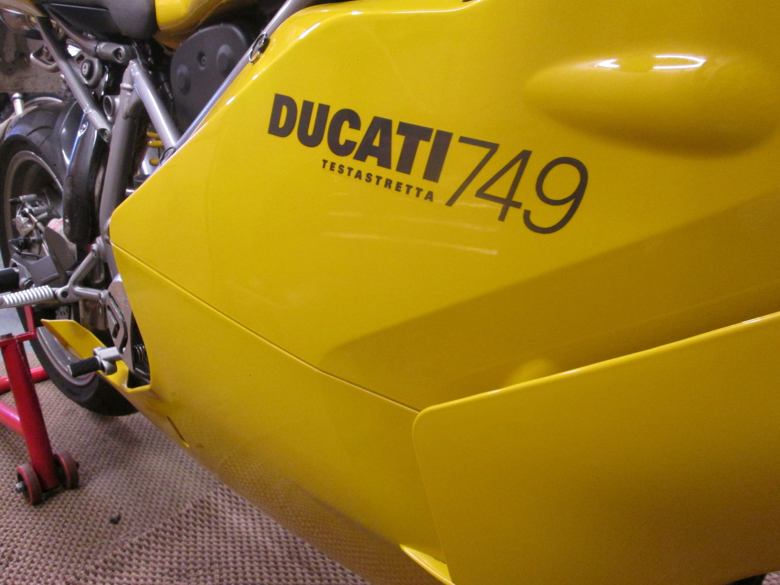

  2. As you can see from my avatar, I have the R&G through-fairing sliders because the bike came that way. The bike is much admired and no-one has ever said a word about the sliders - no-one.
  3. The sliders look like shit.
    :joy:

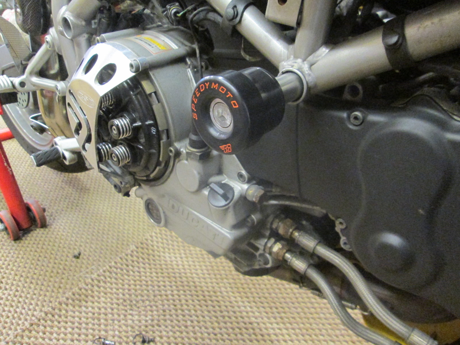

    Now you don`t.
    Finally got them to fit.
    I had to shorten the rods by 10mm and fettle the caphead bolt and sleeve for the puck, the sleeve was gold anodized so removing that wasn`t such a bad thing.
    These block shaped pucks are the second generation design, the mushroom shaped ones are now discontinued.
    It`s a bit annoying that they didn`t fit out the box, but got there in the end.
    A big thanks to RickyX, once I re-read his reply and found the magic 78mm measurement, it was no problem.

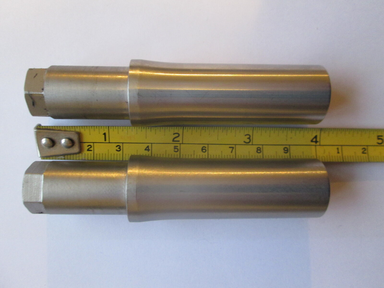

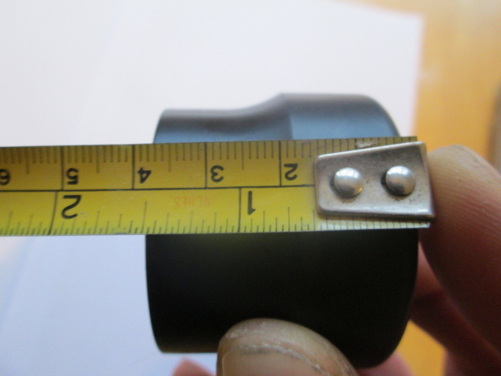

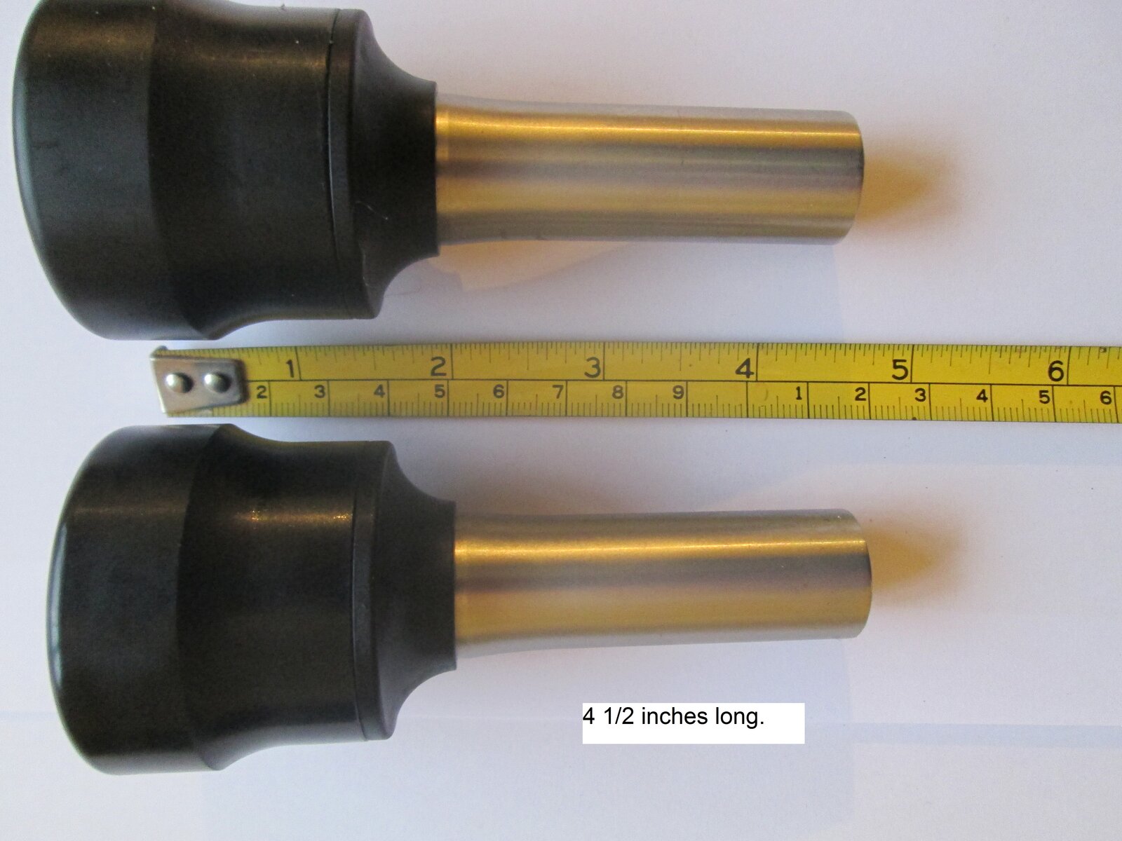

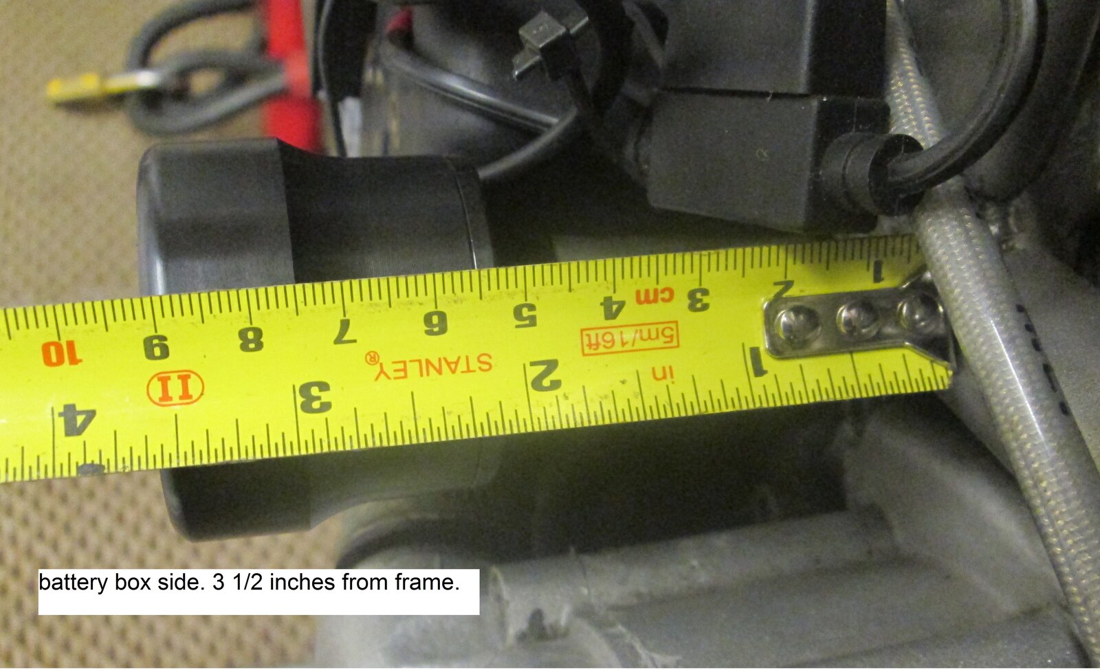

  12. These are the standard out the box measurements, will probably be ok with one piece fairings. The engine "bolt" has 12mm threads which screw into the slider rods.

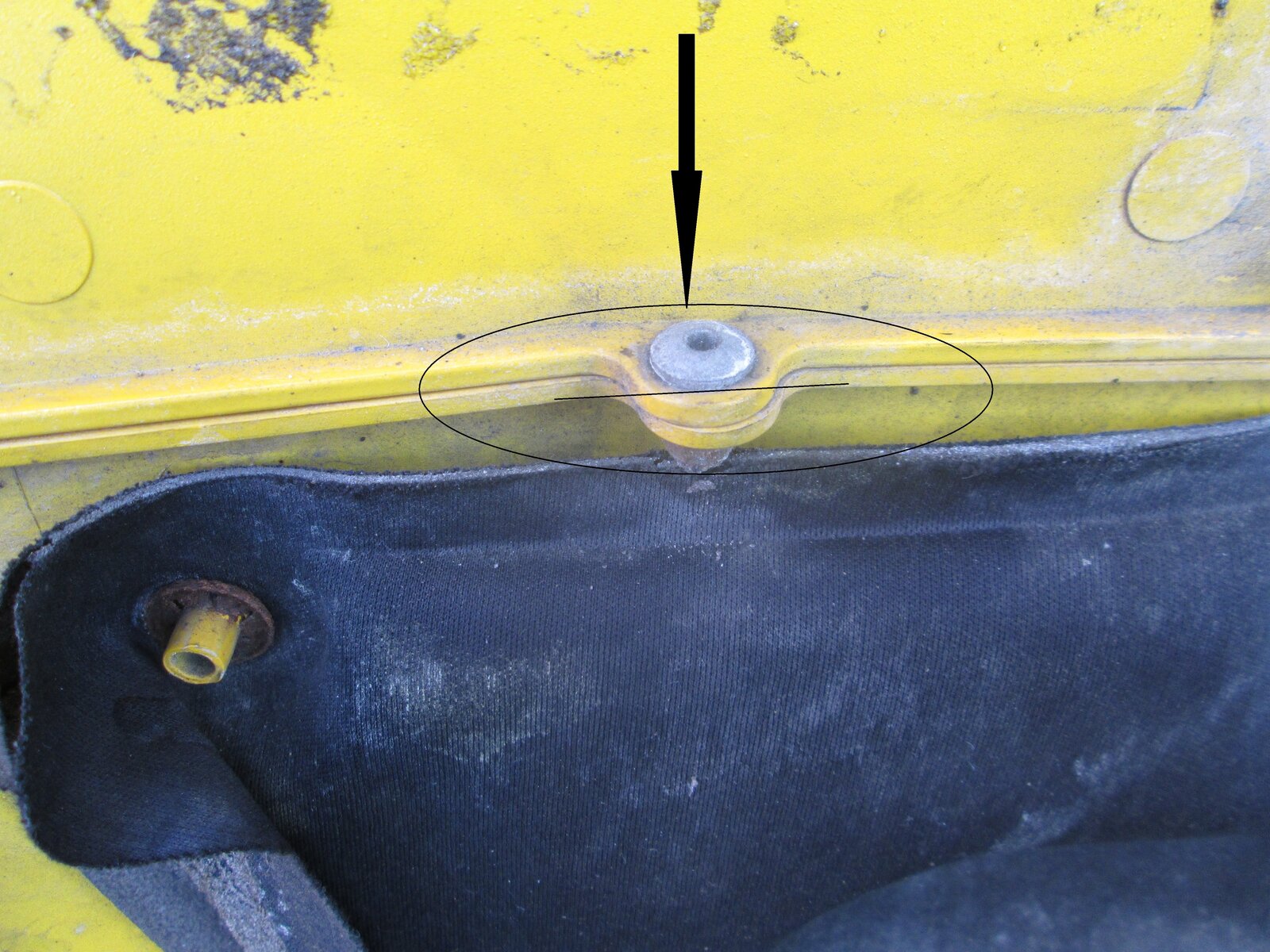

  13. This is what I had to modify to make them fit standard two piece Ducati fairings, 2003. I think I removed just under 10mm from the slider rods, removed 1-2mm from the caphead bolts, removed the same from the spacer sleeve and removed a small amount of material from the fairing fastener.
    Quite a bit of work to make them fit with standard fairings, my mate is an engineer so bread and butter for him.
    If you have to shorten them be careful or they won`t do their job, which is to support the fairing and stop it collapsing on to the expensive bits underneath.
