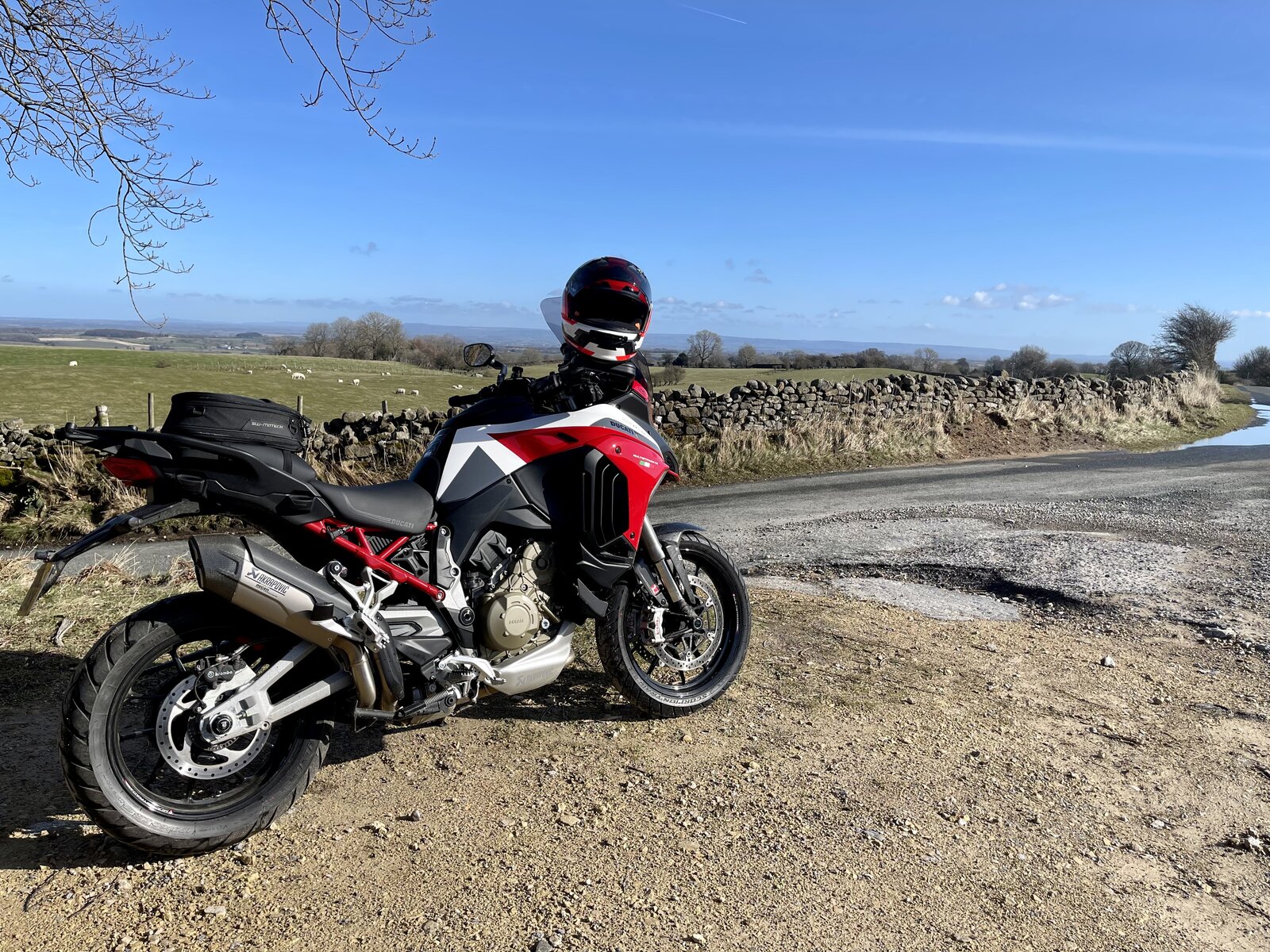

  8. So went for a 130 mile blat around the Yorkshire Dales (lovely day and snowy over tops) today before heading to Leeds Ducati for the software update this afternoon. Took about an hour to complete and just makes the system much more usable…
    - Can control headset volume for Intercom, Navigation and music directly via the joypad.
    - No more faffing in sub menus for heated grips. Simply push button on bar once, twice or three times for the setting needed.
    - Option to keep connect alive for 20 mins when bike is switched off (big improvement!)
    - Minimum suspension preload works well and is quite noticeable - works up to 65/70 mph then automatically goes into the preset height mode selected. It doesn’t return back to minimum height automatically. Need to hold the suspension button down to engage minimum height et (at less than 70mph)…
    Overall good updates and well worth having.
    What a bike on those roads! Full Akra makes such a difference as does fitting a lighter 1kg Shido battery!!

  12. Thanks for update, hopefully pick my V4S up next week which will have all the updates already installed..
    Is the R&G no: plate hanger easy to fit and are you pleased with the quality ? Personally think it looks good in the photo.
  13. You’ll love it
    Putting the R&G plate hanger on was the first thing I did… really not a fan of the OEM one. I contemplated the CNC tail tidy but opted for the R&G as a stop gap until Evotech launch theirs for sale shortly.
    It is pretty straightforward to fit. Release four bolts on underside of rear subframe and the a number of smaller black hex bolts on the underside of the mudguard. I will say it is pretty expensive for what it is but is well made and definitely better than OEM.
