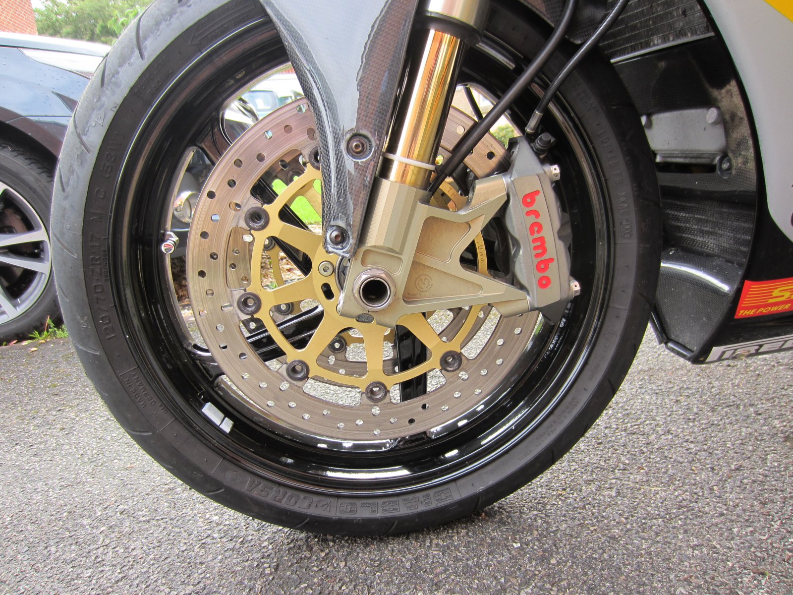

  1. Be careful what you wish for, I started down the brake upgrade route with 'just' a radial master cylinder but then got a little carried away;
    Must learn some restraint!
    Bloody good brakes though... ;)

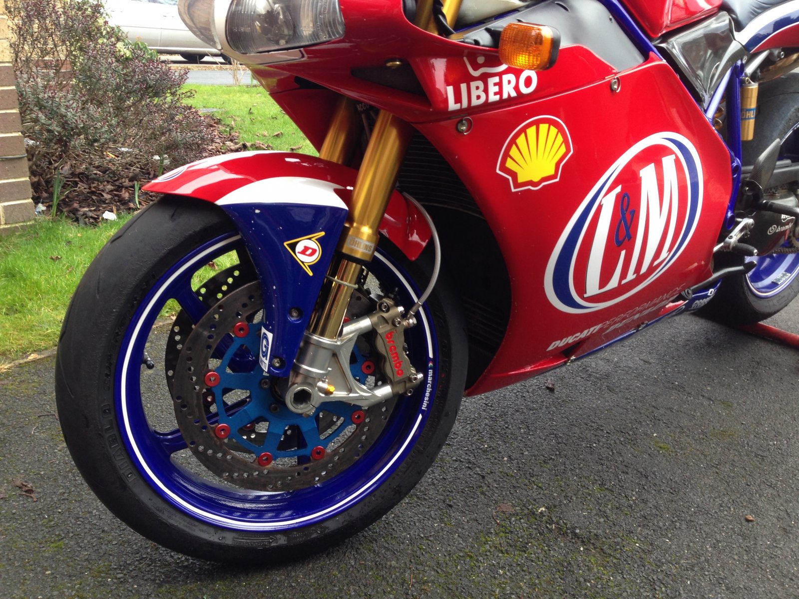

  2. As Andy said they should be fine, stick some decent sintered pads in, I use either Brembo or Ferodo's, if you need more grab and stopping power you'll need to go down the master cylinder & iron disc route.
    As Tim says though it's easy to get carried away :D

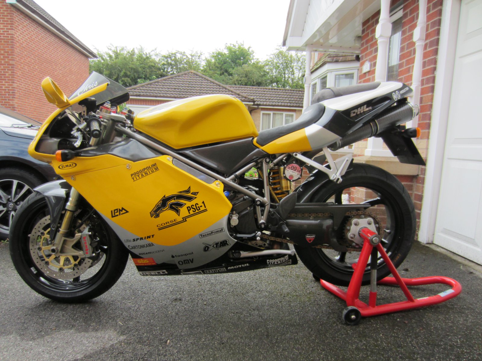

  3. Nice one, good to see I'm not the only one who can resist anything, except temptation... :upyeah:

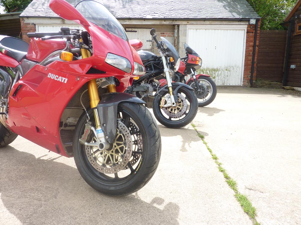

  4. I upgraded the brakes on my 996 to the brembo p4 ones the other year. That and new fluid/pads made a world of difference. Those brembos came on a variety of bikes, such as aprillas and ktm superdukes and so dont just search for the ducati ones which tend to make more money. I think I paid £130 for my set, but they tend to go for between £150 and £200. They bolt straight on, although I also took the opportunity to replace the hoses with the 748R setup whilst I was at it. All bolt on stuff.
