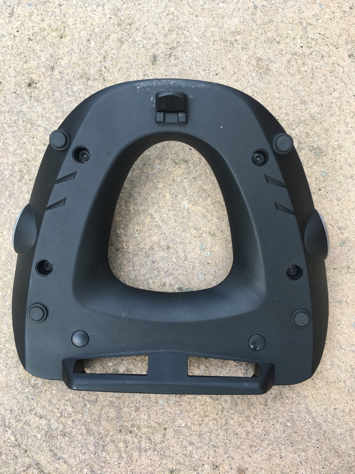

  9. [​IMG]
    Yes it's a monolock Base plate (see photo above from earlier in thread) . Two lugs at the front and triangular lug at the back. Ducati topbox has a nice embossed cushion which my missus likes so happy with it and er.....the price lol.

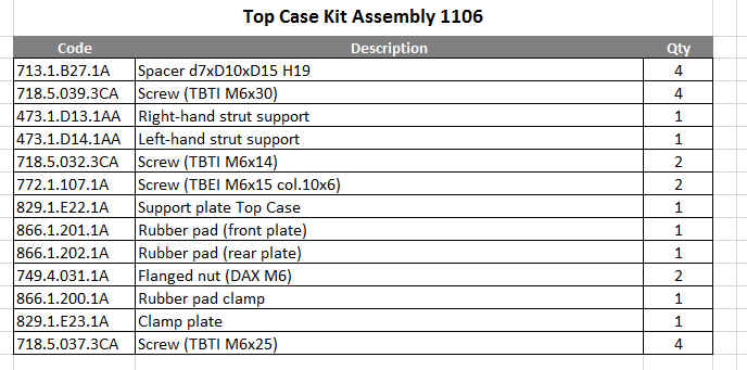

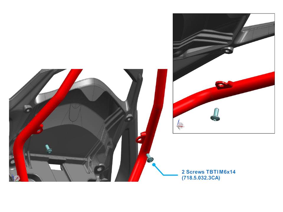

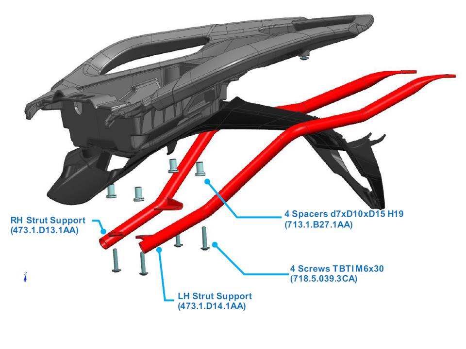

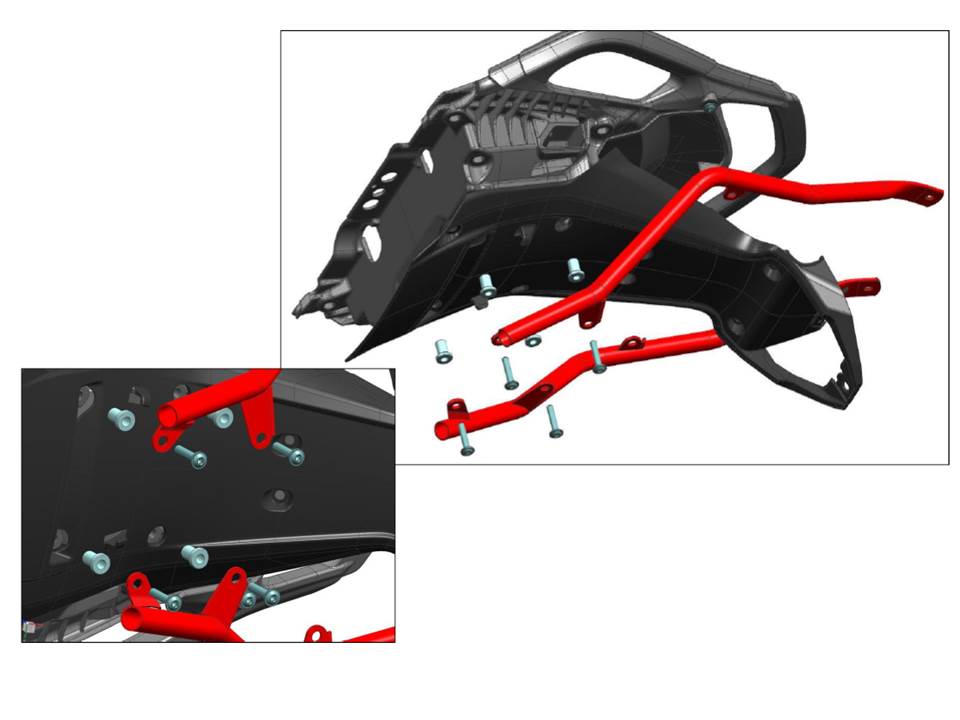

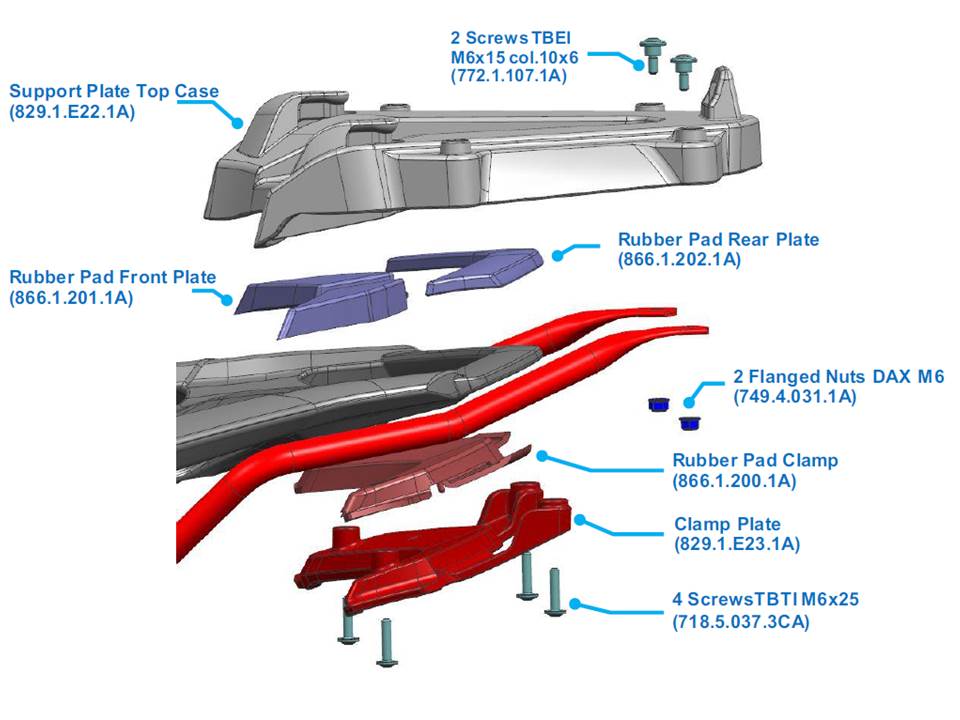

  10. Thanks to @Andrew G and an assembly PDF I found on t'internet, I've managed to pull a list of the parts together to make a topbox mount.
    I've only ordered the bits today, so I can't guarantee everything is spot on, but it should be. JHP have kept my spreadsheet for future reference anyway.
    The parts in total came to £200 incl. VAT, so it's not necessarily a cheap option - I just didn't want to pay £446 for the box and the rack when the box is too big for what I want. I'm sure I can get a decent GIVI monokey topbox for under £150 - so going this route I should still save around £100 I guess.
    The only thing left to order is 4 GIVI screw covers for the top of the rack when there's no box on. You can get those on eBay separately for a couple of quid.
    I've attached the sheet in case it's of any use to anyone.

  12. Would anyone know if you can fit a monolock or monokey givi topbox plate the underseat rack that ducati sell ? I have a monolock plate and case which I used for 4 years on my mts 2010 without a problem and would like to use on the dvt
    so basically i'm wanting to order all parts in this list apart from the support plate and then just fit my plate and box if this is possible ?

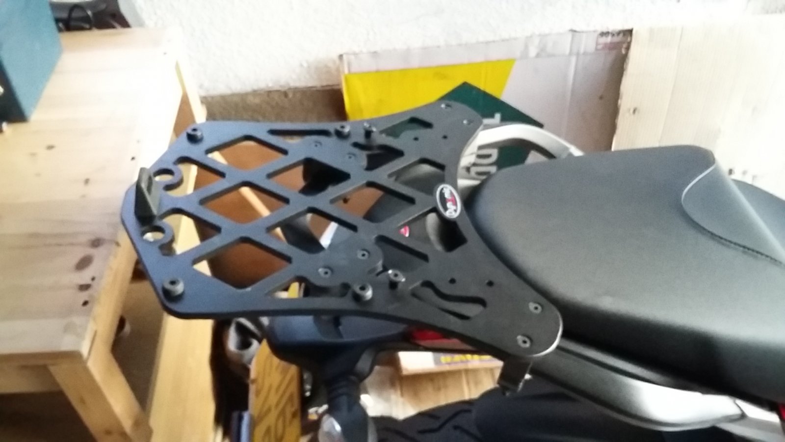

  17. I had a similar problem and found that there was no way to afix my old Givi top plate to the MS DVT. So, I bought a specific rack from Dynamic in the US which also takes the Givi monokey topboxes. It cost 120 quid but it meant that I could use my old 47 litre topbox rather than spening loads of dosh for a new Ducati topbox. Here's a photo....... 20160714_204311.jpg

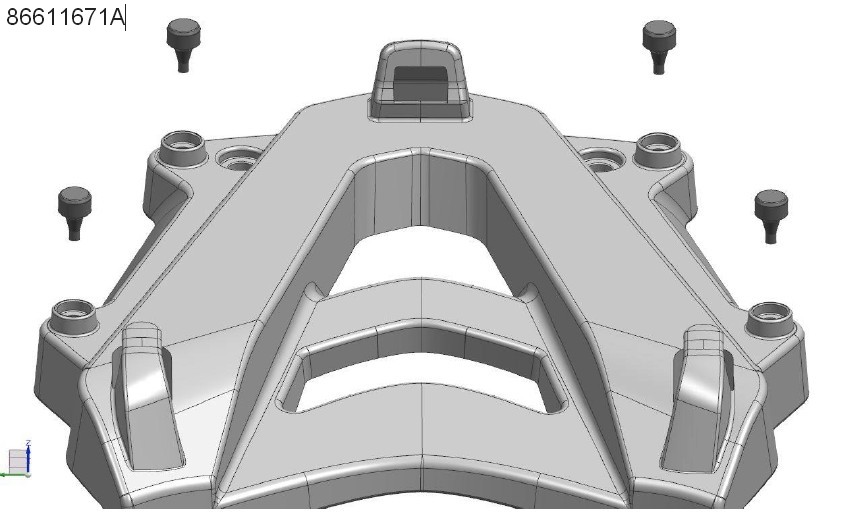

  18. I've just collected and fitted the rack assembly from the guys at Moto Rapido in Winchester. They identified the parts collection just for the box mounting from the urban pack. As already mentioned no instructions but to be fair it was really simple and only took about 20 mins.
    I too had the older Givi mounting plate but you can't use this on the DVT, you need the rubber plates that sit perfectly into the resesses of the rear carrier frame. I'm using my old Givi Trekker top box, 52 Ltrs and doesn't look out of place at all.
    The Givi plate was only about £27 of the bill so worth sticking with the correct one. Total bill was only £200 so only a little more than some of the flat German plate adapters you see on EBay.
