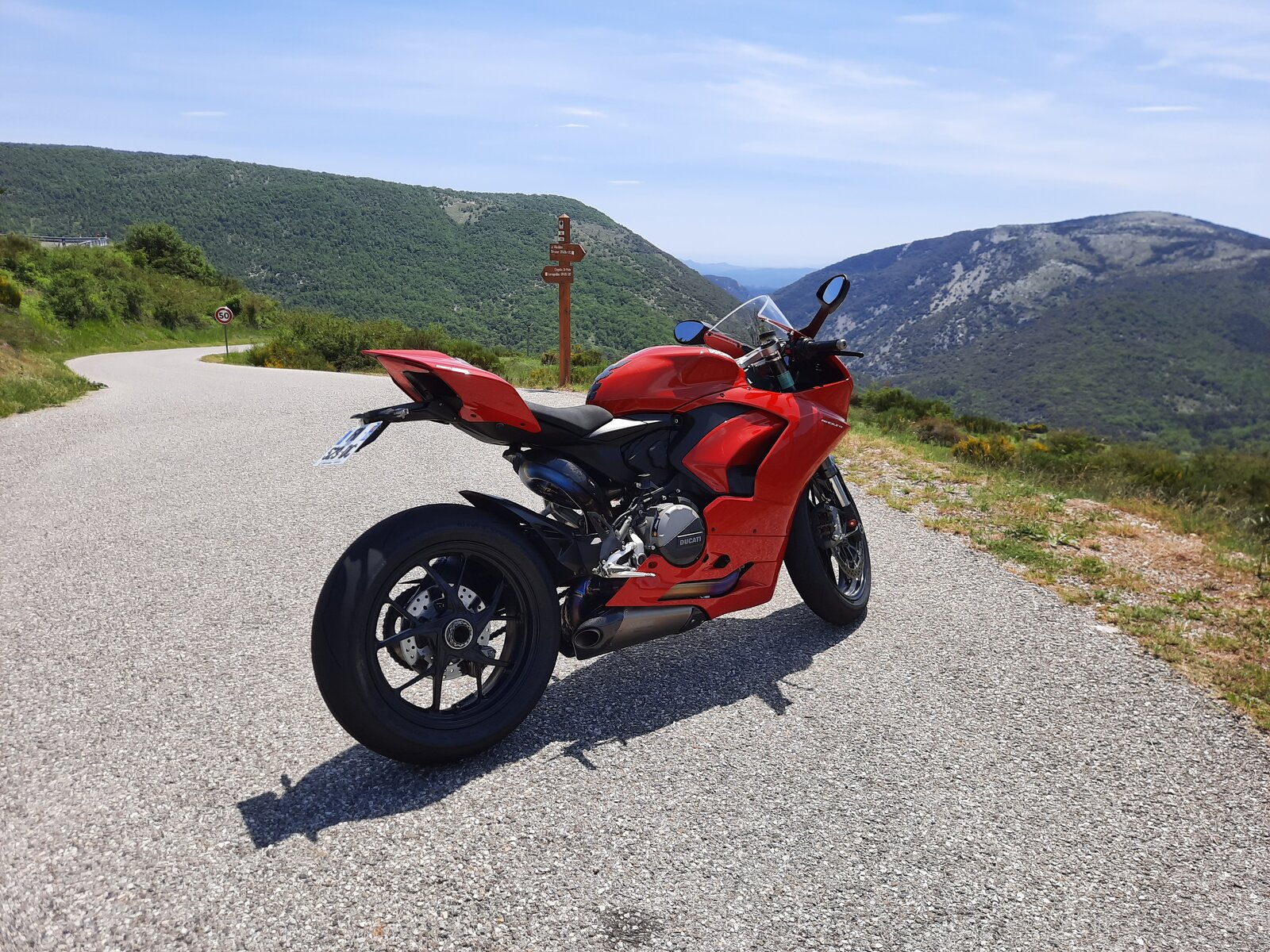

    Great bike, just had 1st service. Exhaust has made a difference. Happy days.
