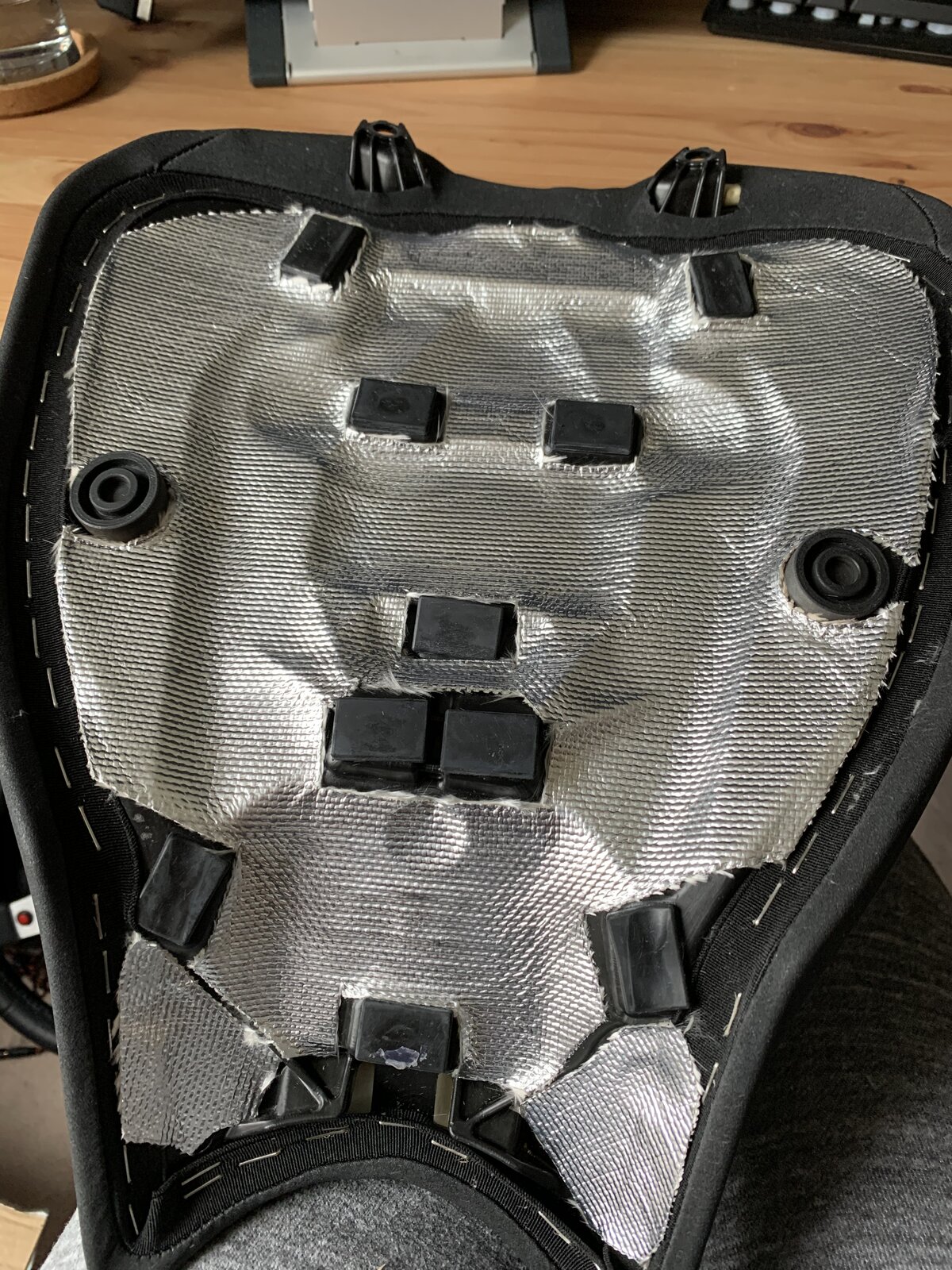

  15. Step 1 completed, doesn’t look pretty but I’ve kept it as one sheet without too many cuts, and it’s proper heat Matt that can take 2000 degrees so might help the heat soak through the foam.
  16. Looks like you’ve done a great job. Let us know when you’ve had a test ride? :)
  17. I will do, I noticed that the plastic heat shield that goes around the rear cylinder exhaust pipe has some of this in it already but there is another metal shield in there and I’m considering putting this on the inside of that shield also, which would be good but is going to be a big job
