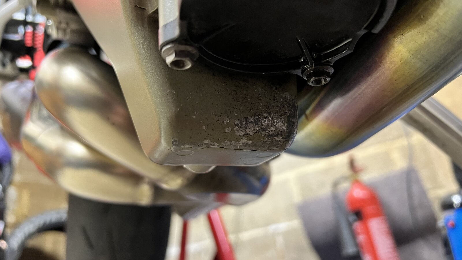

  1. Agreed!
  2. It looks like hell, so I'd be giving Ducati some in return if they don't agree & resolve it immediately.
  3. Not doubting your word at all Tony H but that looks like it’s done a lot of miles on salty roads?
    Even the flange around the exhaust to the right hand side looks as rusty as F !!
    My 899 is coming up for 26,000 miles and it’s as clean as a whistle, ok most of it is covered by fairing but there’s nothing anywhere near as bad as that on all of the bike.

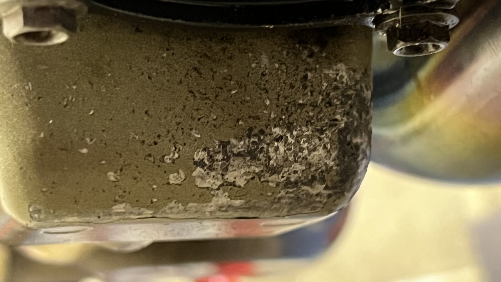

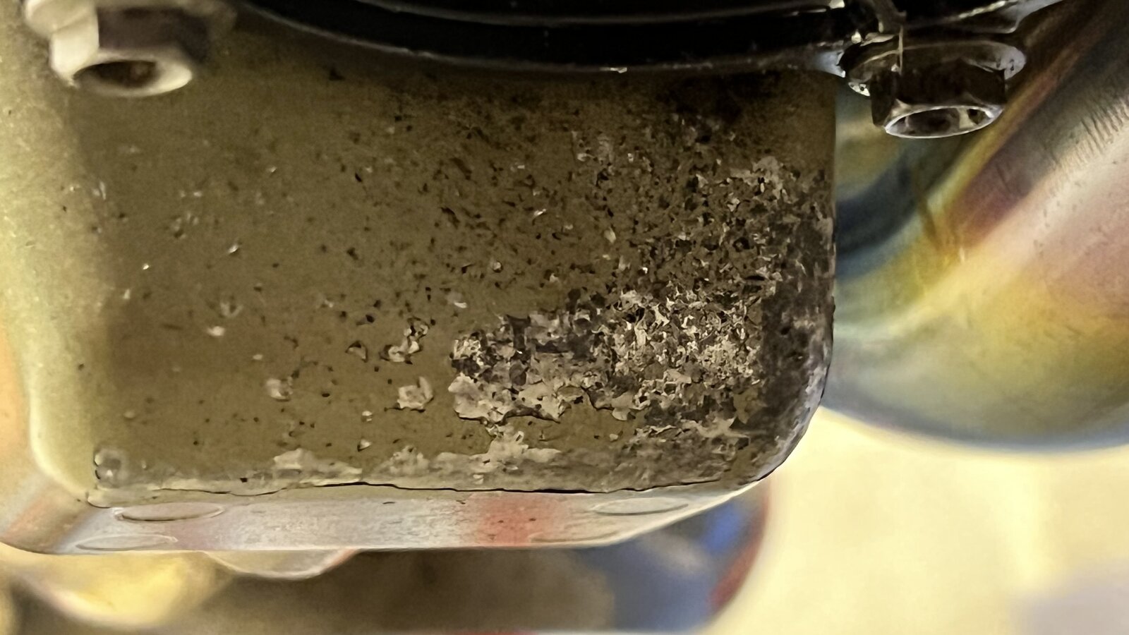

    As far as your engine casing goes, in my working life I was New project tooling manager for a few consumer manufacturing companies and bought and developed quite a lot of die casting tools, with my troubleshooting head on it looks as though it could be one of three problems with the production of this casting
    A short shot - this is when the cast part is not fully filled in the die during initial production, basically the full amount of Aluminium has not been forced into the die and this area was the last to fill and has not been fully made up, However it has been painted over at one stage so something has been there and then dropped off so it’s probably not this.
    More likely to be porosity, this happens once again when the die is initially filled with molten aluminium, the Aluminium is flowing at about 780 deg c and gives off gases that need to be vented out of the tool through tiny ( 3-4 thou ) vents ground in at the extremities of the fill pattern, ie the last places the aluminium will reach, these vents can easily become clogged and not do their job and you get an effect a bit like when you put your thumb on the end of a bike pump,... you can’t release the gas so that area doesn’t fill as good, the grain structure of the material in that area becomes a bit like an Aero chocolate bar and therefore is not as strong and likely to break or crack.
    Also if said vents are not cleaned on a regular basis they can leave a kind of ash deposit at that area that the casting will pick up, looks like a full casting once it’s painted but mechanical strength wise it’s no where near.
    Definitely a problem with the original casting, but as I said earlier that exhaust header looks really rusty for the mileage you’ve done on the bike, makes me wonder about where it was stored after manufacture and shipping?
    Go back to your dealer and give them hell, very disappointing considering what you’ve paid for the bike, good luck mate

  5. Thanks for the info. I also think there is an issue with the casting/material

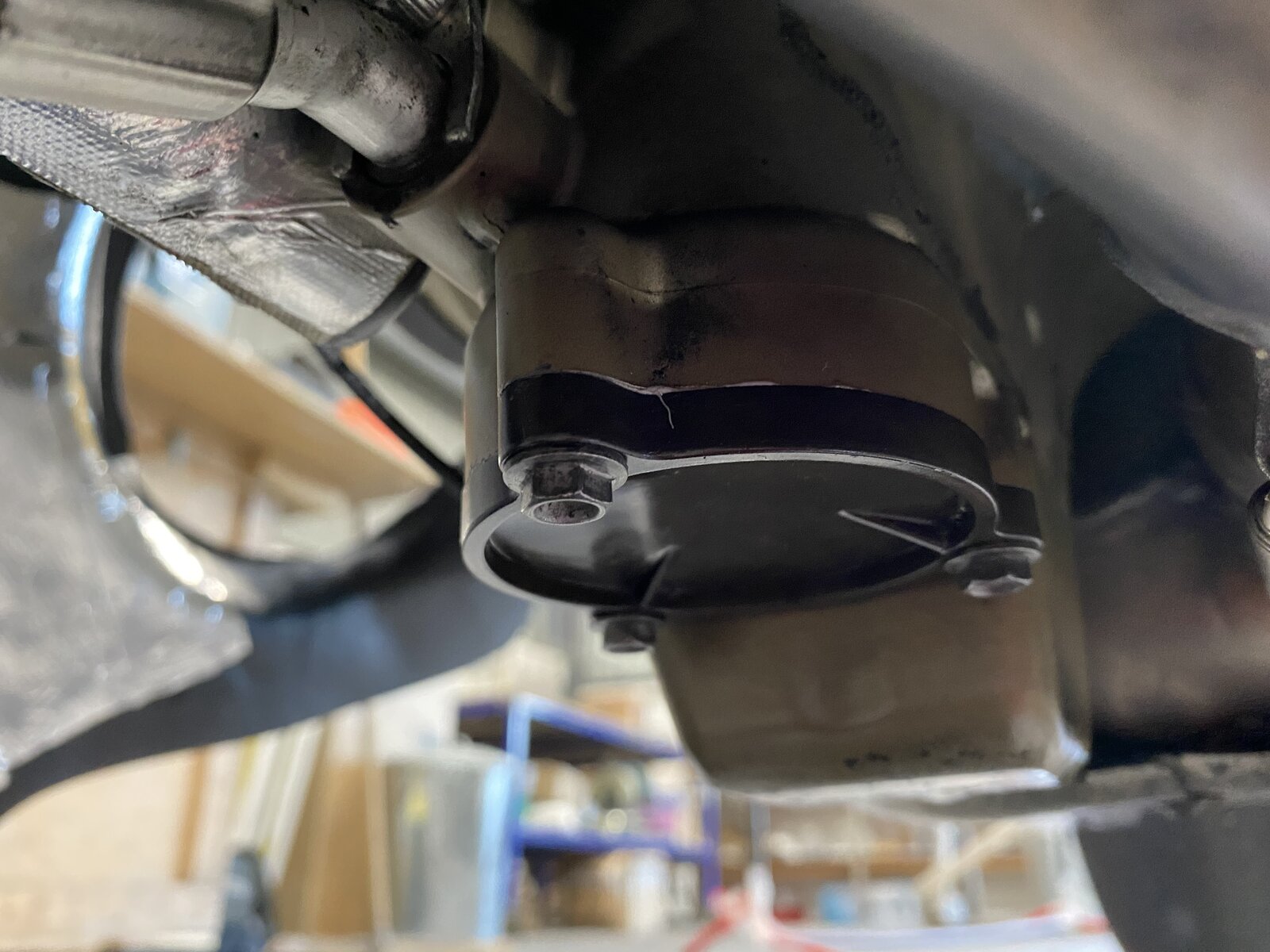

  6. For reference I took a photo of mine today when I was under the bike. 2019 bike that’s done 4100 miles, mostly on track in the dry but has seen the odd shower on the road.
    The grey is a small amount of sealant after changing the filter, not missing material.

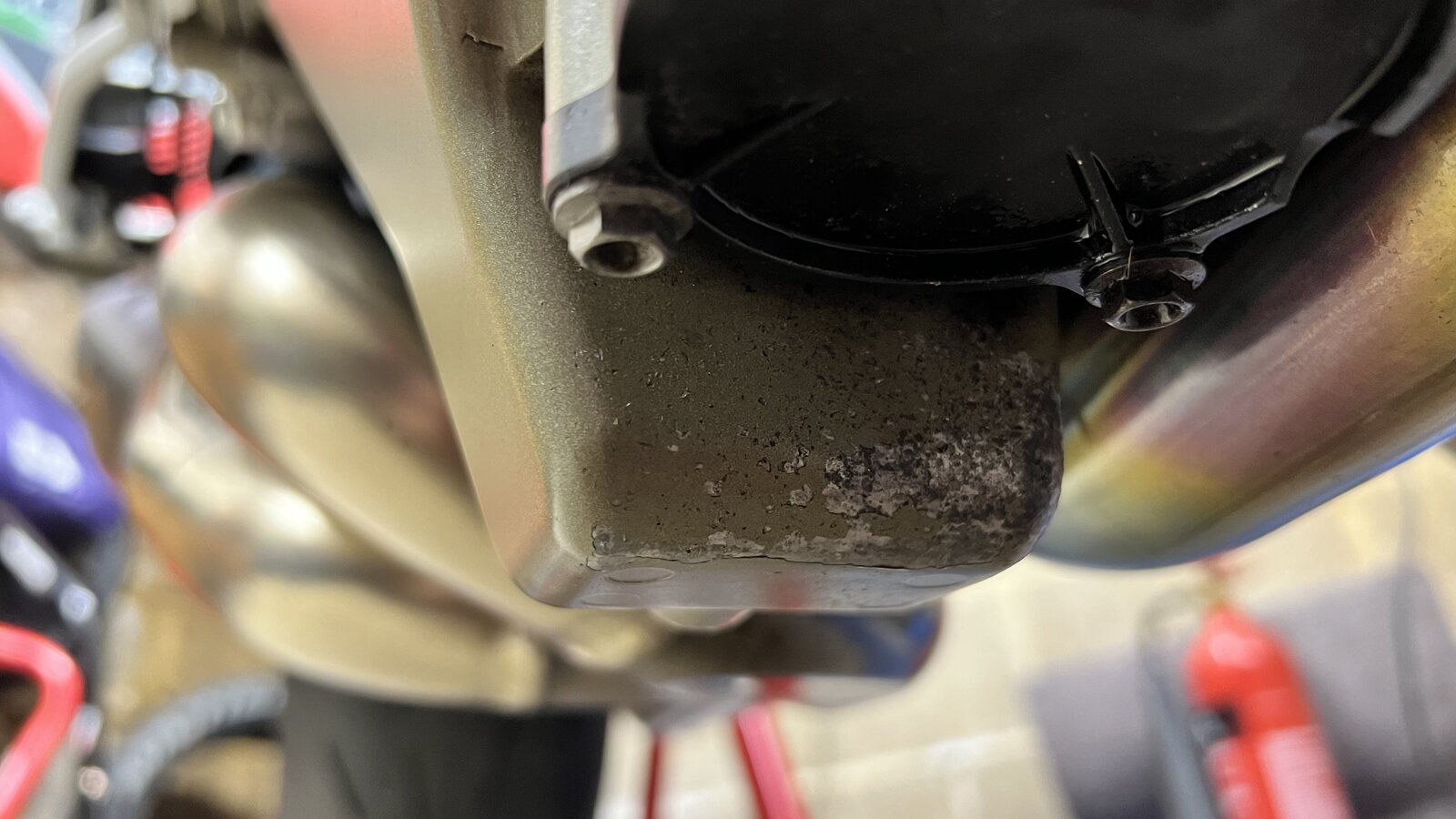

  14. FF97C8A9-2B4B-49A8-8FB0-5011096CDA0A.jpeg D6DEFC7F-8B72-4F4A-8ACE-C50F75150546.jpeg 01AF7ABC-9D2C-48D8-A3C6-54AC4D687316.jpeg 8E795B47-2CEE-4F15-BD52-12C79CE65B50.jpeg Mines done the same, have logged it with the dealer who are putting it to Ducati.
    Hopefully they’ll replace under warranty.

  16. Looks as though most of the corrosion seen has probably been caused by initial impact damage from debris thrown up from the front wheel or directly from the road, as opposed to the sump casing simply falling apart. A large enough rock can do a lot of damage when propelled towards the surface of a casting at high velocity. Certainly enough to expose the underlying material, opening the door to invite corosion in.
