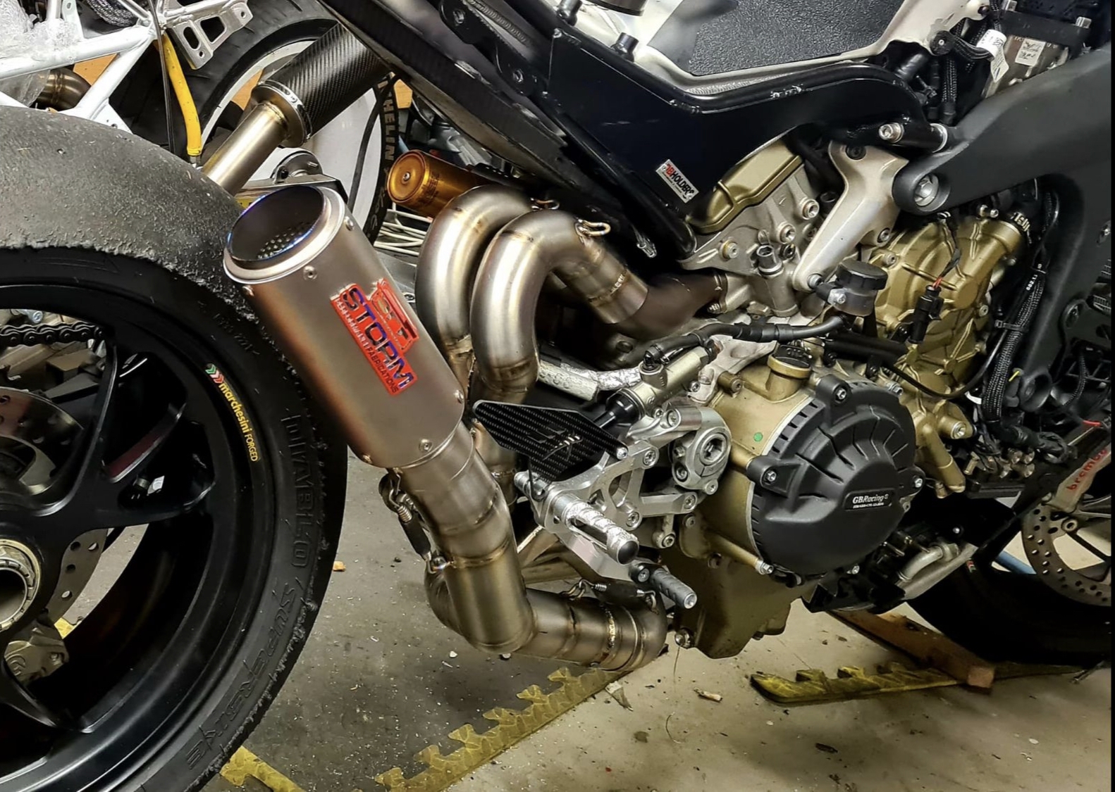

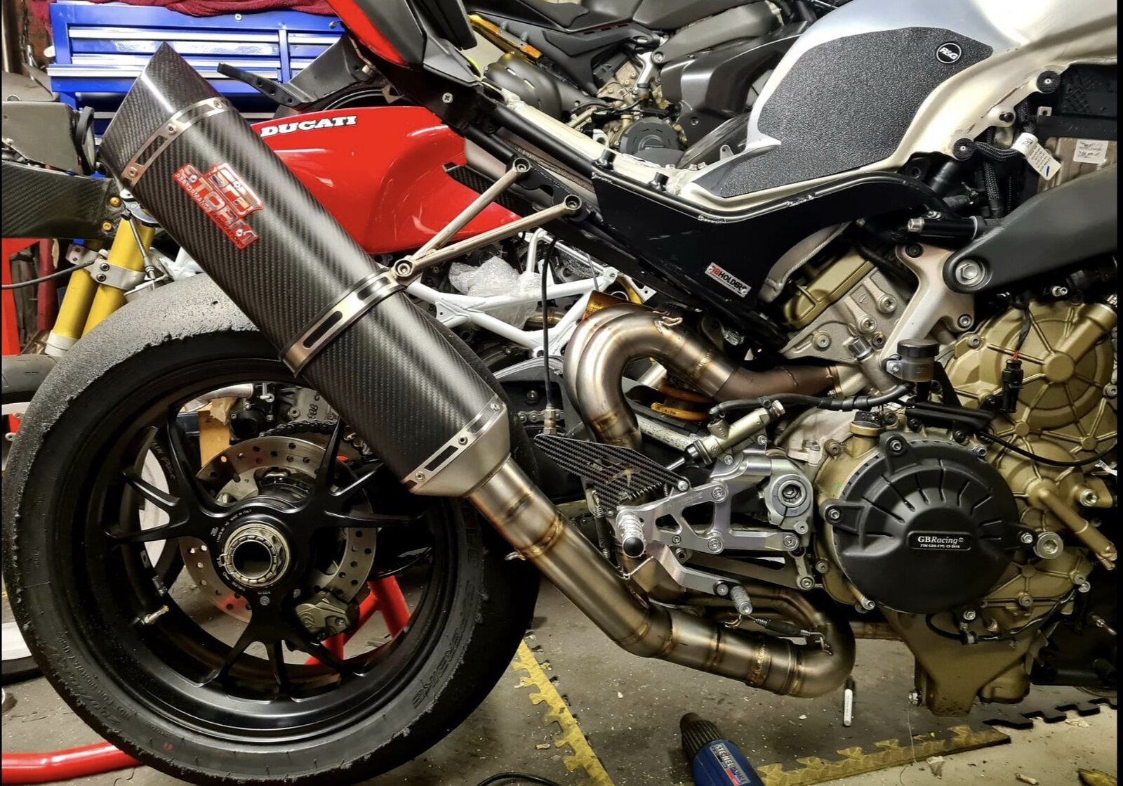

  6. My mate races a V4R, he's really struggled getting through noise testing (105dB static) at a few circuits this year with the Uscite system even with the most restrictive of baffles in so he has had a system manufactured by Phil at Storm Performance complete with a little stubby for our Euro jollies :p
  7. That bazooka looks awful…
  8. Agreed it's not the prettiest of things :laughing: but it'll get him on track without issues
  9. @Mary Hinge isn’t pretty either and he can get on track (but he is loud).
