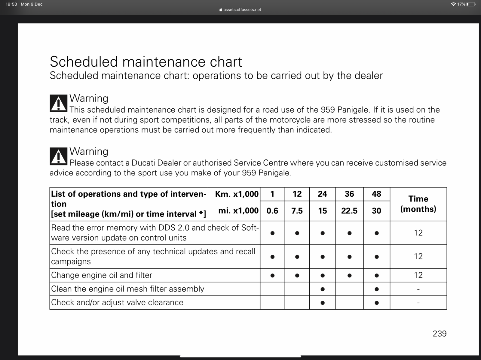

  10. Has anyone asked for the race service schedule for other Ducati’s?
    All of the owners manuals state the same thing - even the humble 959:

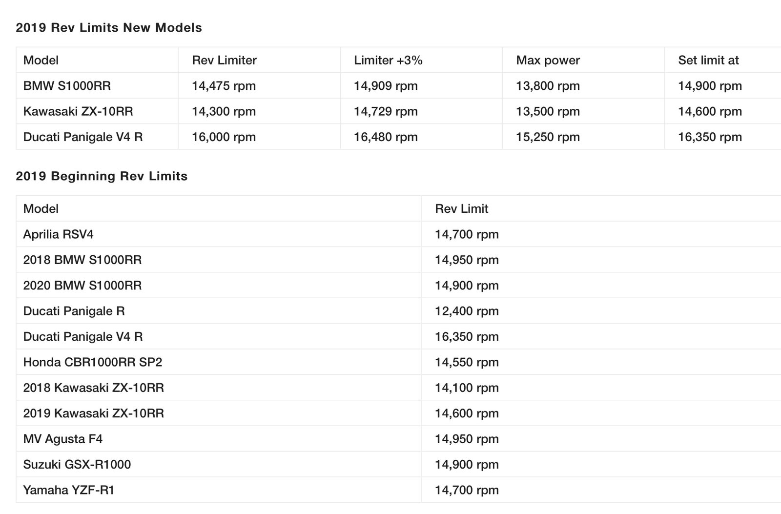

  11. World Superbike Rev limits — V4R stands out a bit!

  13. If WSBK had played by their own rules, the V4RS could have revved to 17,000. Andy

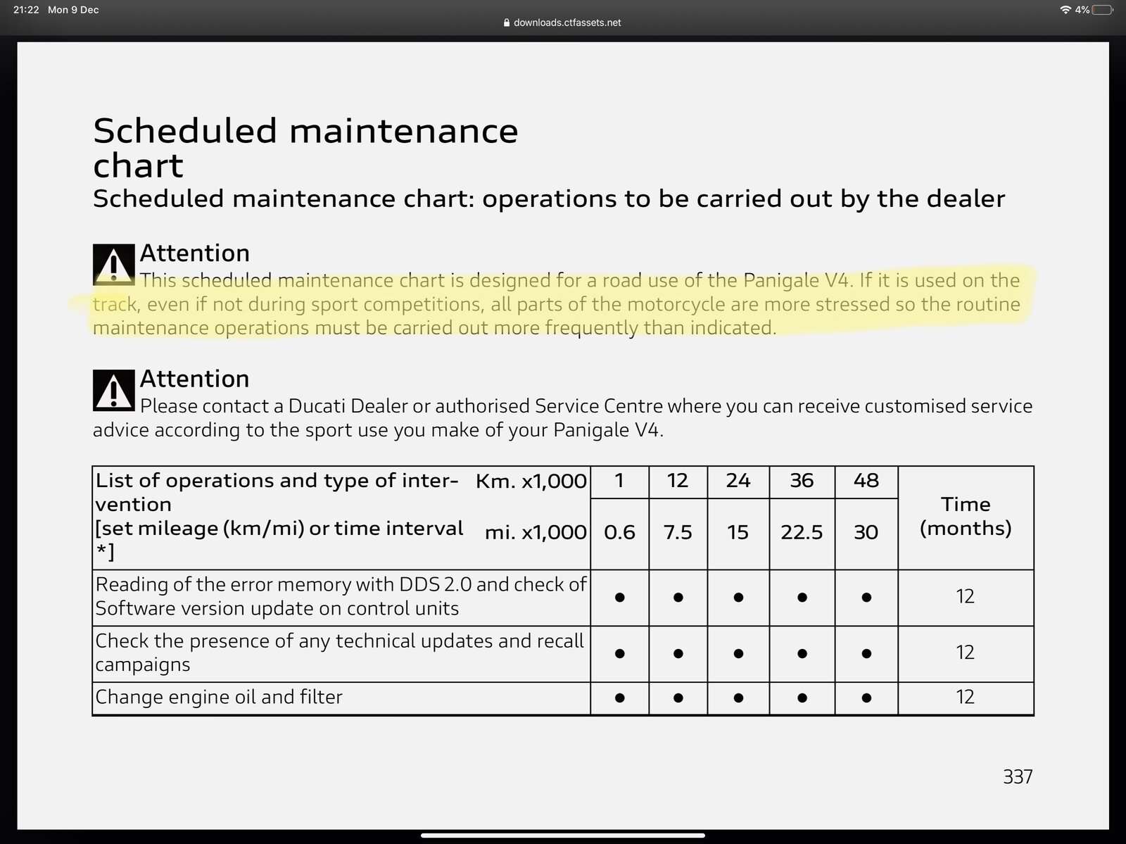

    If you read the article you will see than engine designers use this as gauge of reliability - it also explains why the V4 and the V4R would both have the same service schedule. If you check the user manual for both bikes the road use schedule is the same and no different from any other panigale. They all state clearly that the schedule would be different for race use.
    If anyone has a copy of the race service schedule for a 959 I for one would be very interested!
