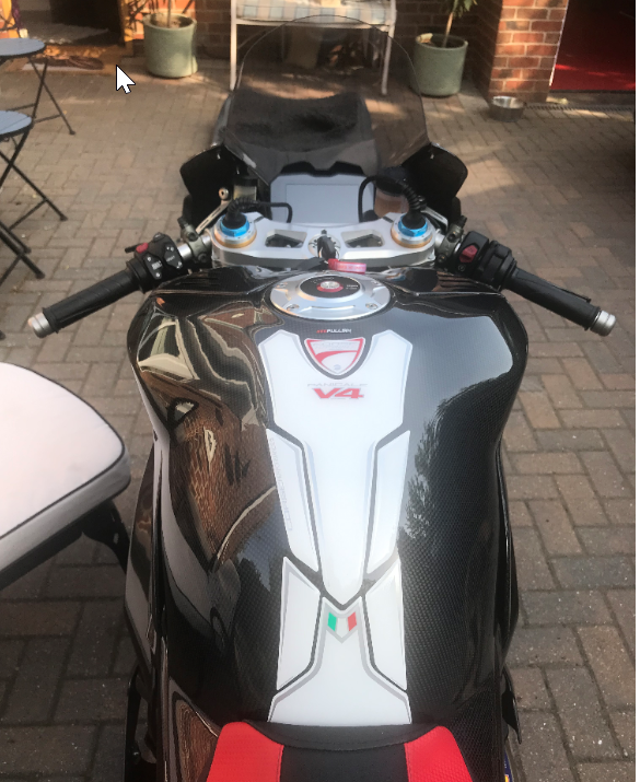

  17. Don't think the Rizoma DP cap will resolve anything but it'll certainly look cooler. Here's mine....
  18. Rizoma cap looks spot on! :D
    Not sure what the answer is?! Petrol obviously sloshes about in a petrol tank so the seal in the inner neck should stop fuel coming up past it! Never had this with the v4s! :(
  19. The two 10mm hoses that run down the clutch side of the tank, I think one is a vent and the other an overflow. Strip out your cap assembly and have a butchers. There's a rubber gasket at the bottom. Just check its not out of position over the vent and drain orifice. There's also an o-ring encompassing the cap. There's not much else to it.
