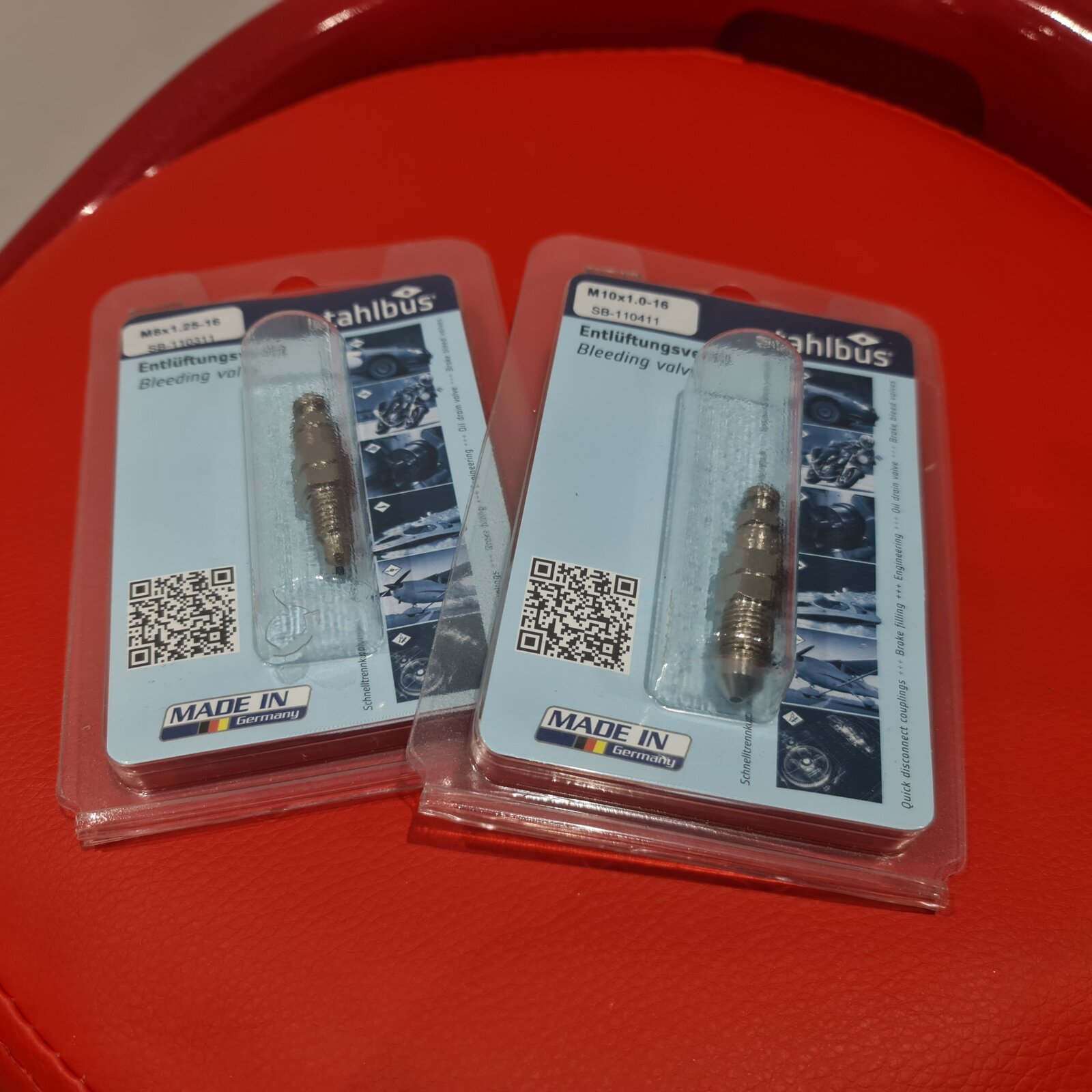

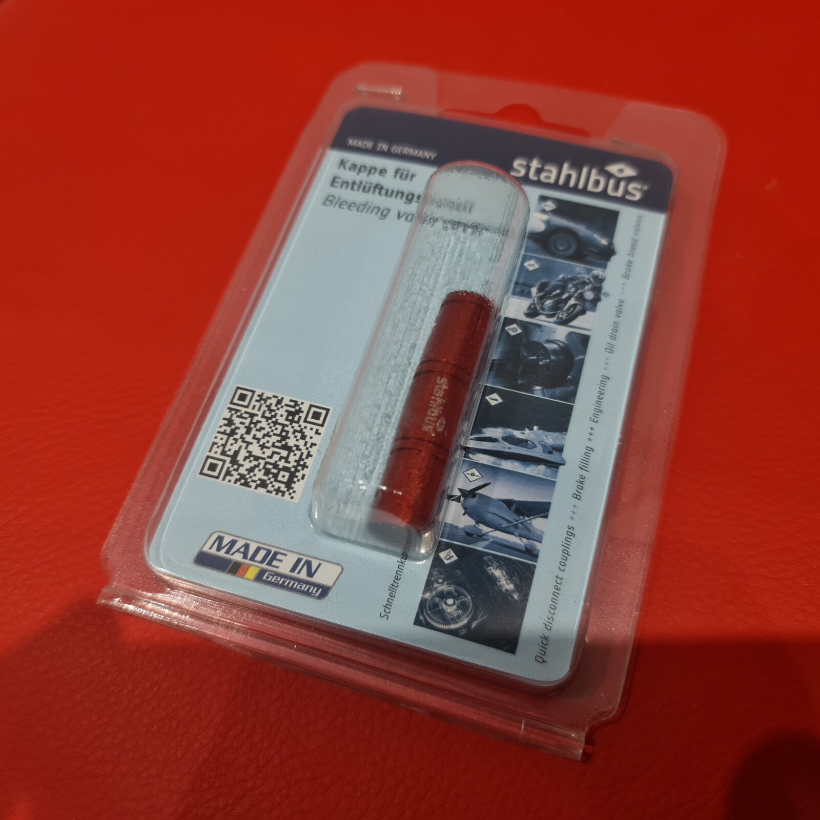

  5. Ordered some Stahlbus bleeder valves from Germany to replace the stock items. Clutch slave cylinder, both front calipers and rear caliper. Ingenious system that let's you reverse fill the system by opening the upper half of the nipple assembly by two turns. Once full, you simply close it again then reopen it by half a turn and just pump the lever to bleed any air out. Once done you close the bleeder upper half and job done. Spring and ball valve prevent air bring drawn back in to the system when you release the clutch or brake lever while bleeding the system. They are not cheap but worth it for the ease of use. I also purchased the Stahlbus anodized dust caps.

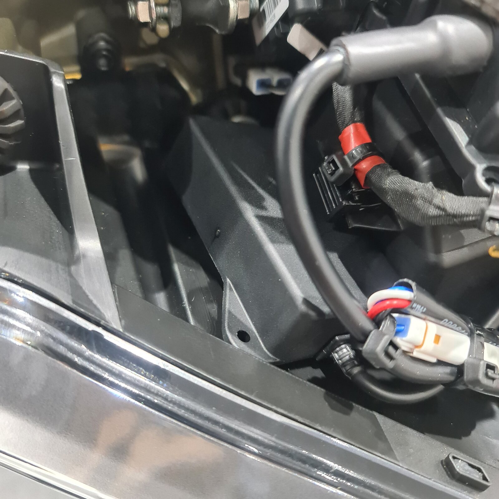

  6. Fitted the Bluetooth DMS module tonight. Five min job but ended up using genuine 3M Dual Lock, as the adhesive pads supplied as part of the fitting kit were just not man enough to really secure the module securely. It's rock solid now. It's also a tiny part barely much bigger than a matchbox which is comforting as space around the headlight assembly is at a premium.

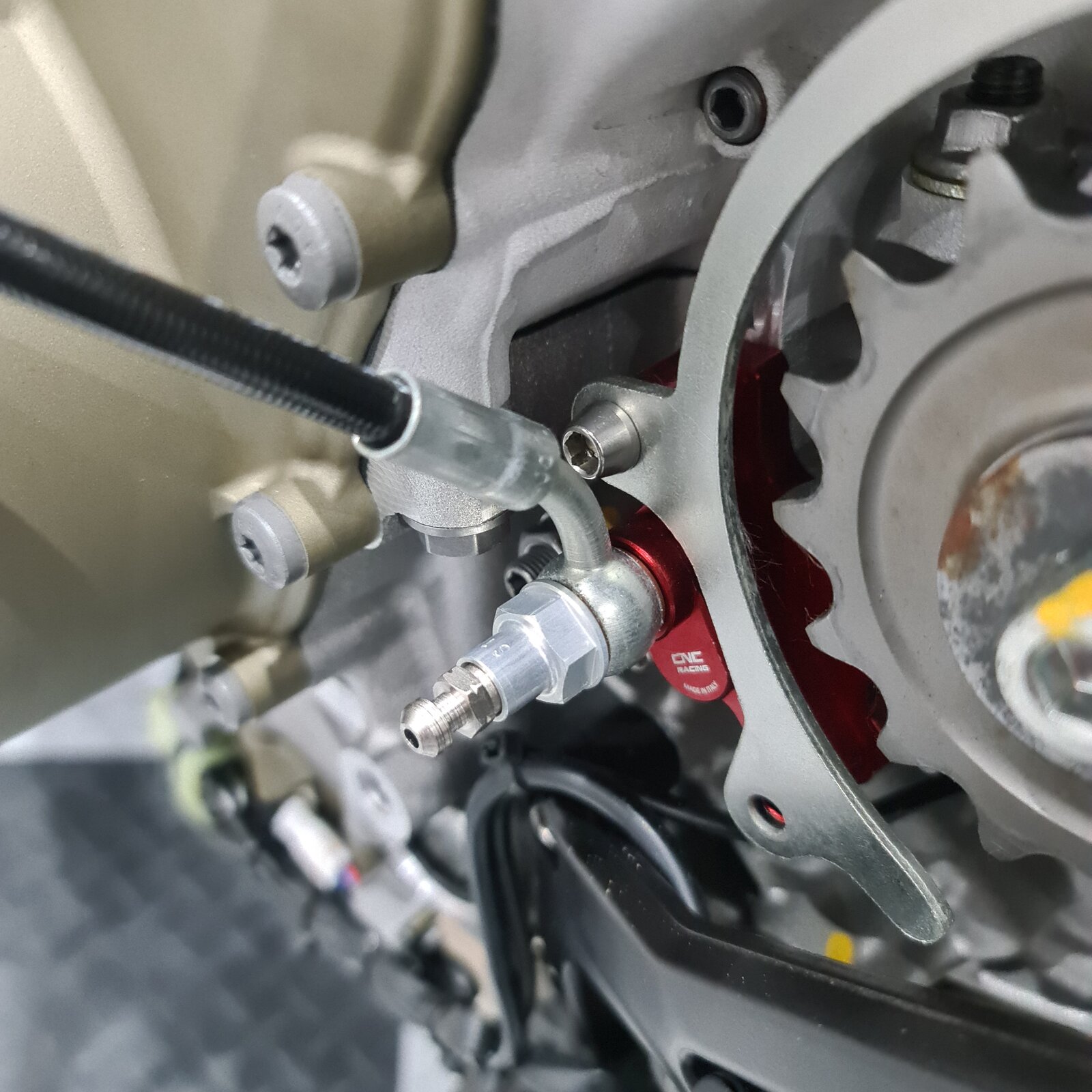

  11. No they are a little longer but they clear the spokes of the alloy wheels just fine. I'm running Oz Gass wheels as opposed to stock so I can't speak for the OEM wheels.

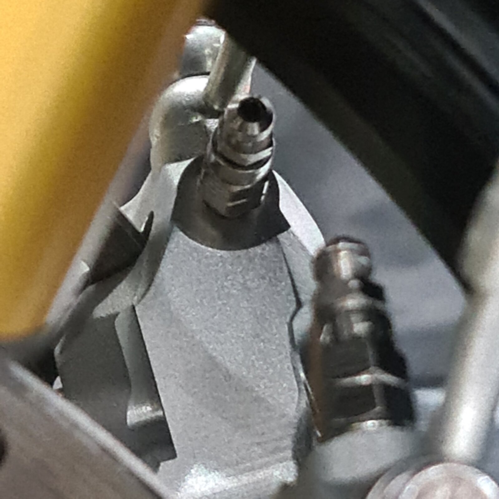

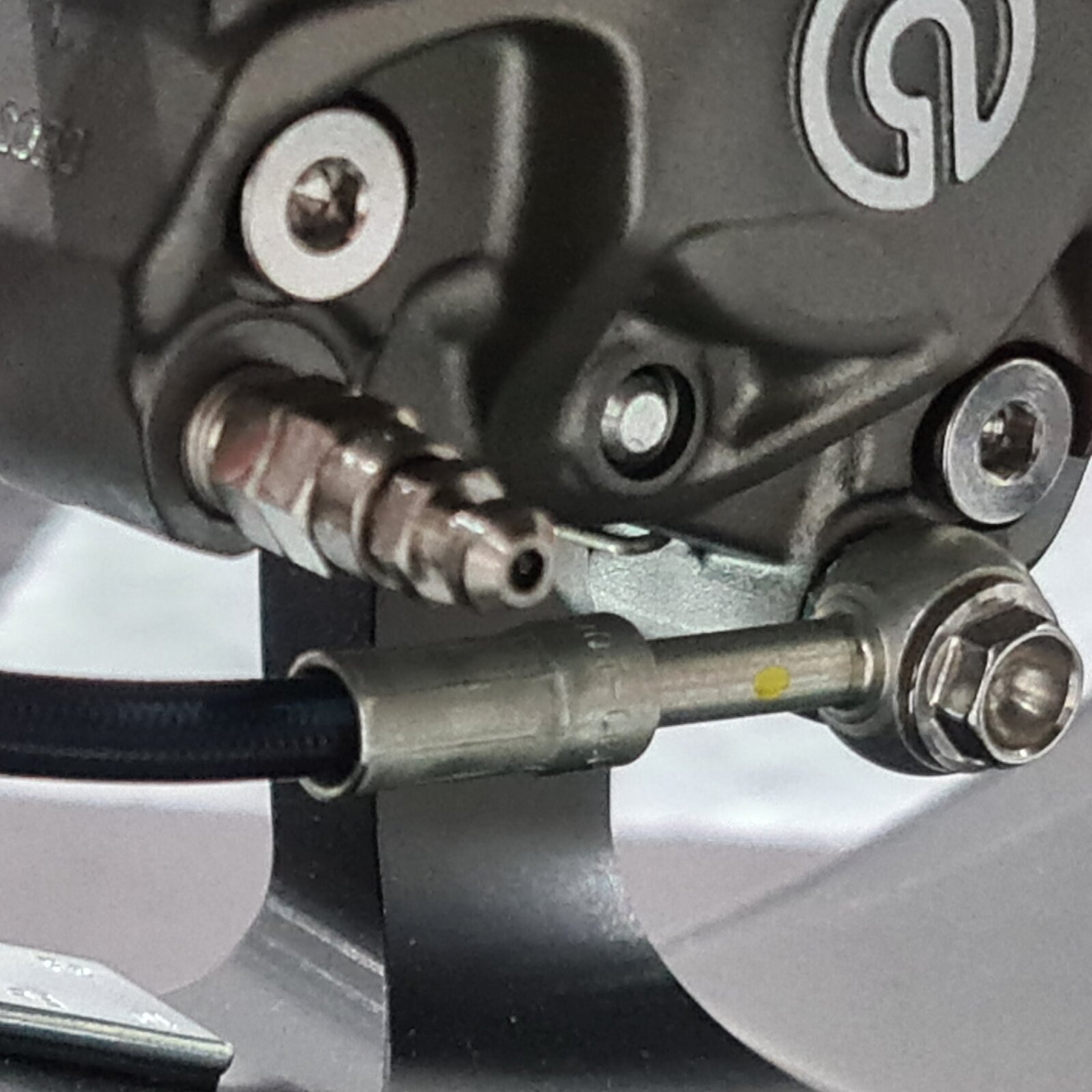

  12. Front and rear Stahlbus bleeder valves fitted. Dust caps will go on once I've bled the system.

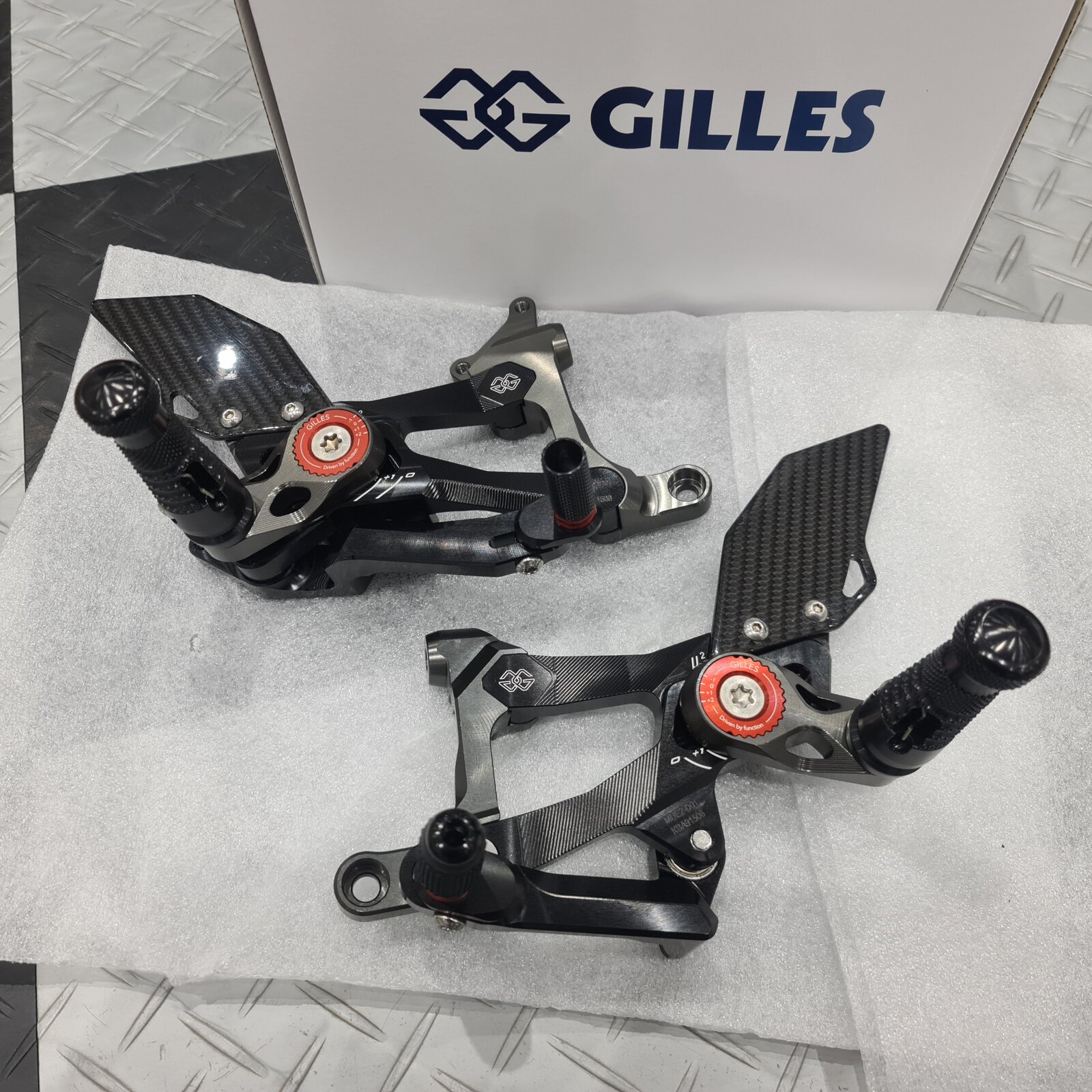

  13. Decided after much deliberation to go in a different direction from the original rearsets I chose and went with these Gilles Tooling MUE2 ones instead. Highly configurable and utilize a much simpler adjustment system without the usual plethora of mounting points. I'll post up pics of them fitted tomorrow.
    As a result I'm now selling the Bonamici rearsets, which were trial fitted to the bike but never actually used, since its not yet been ridden on the road. More info will be in the for sale section probably by the weekend for anyone interested in them.

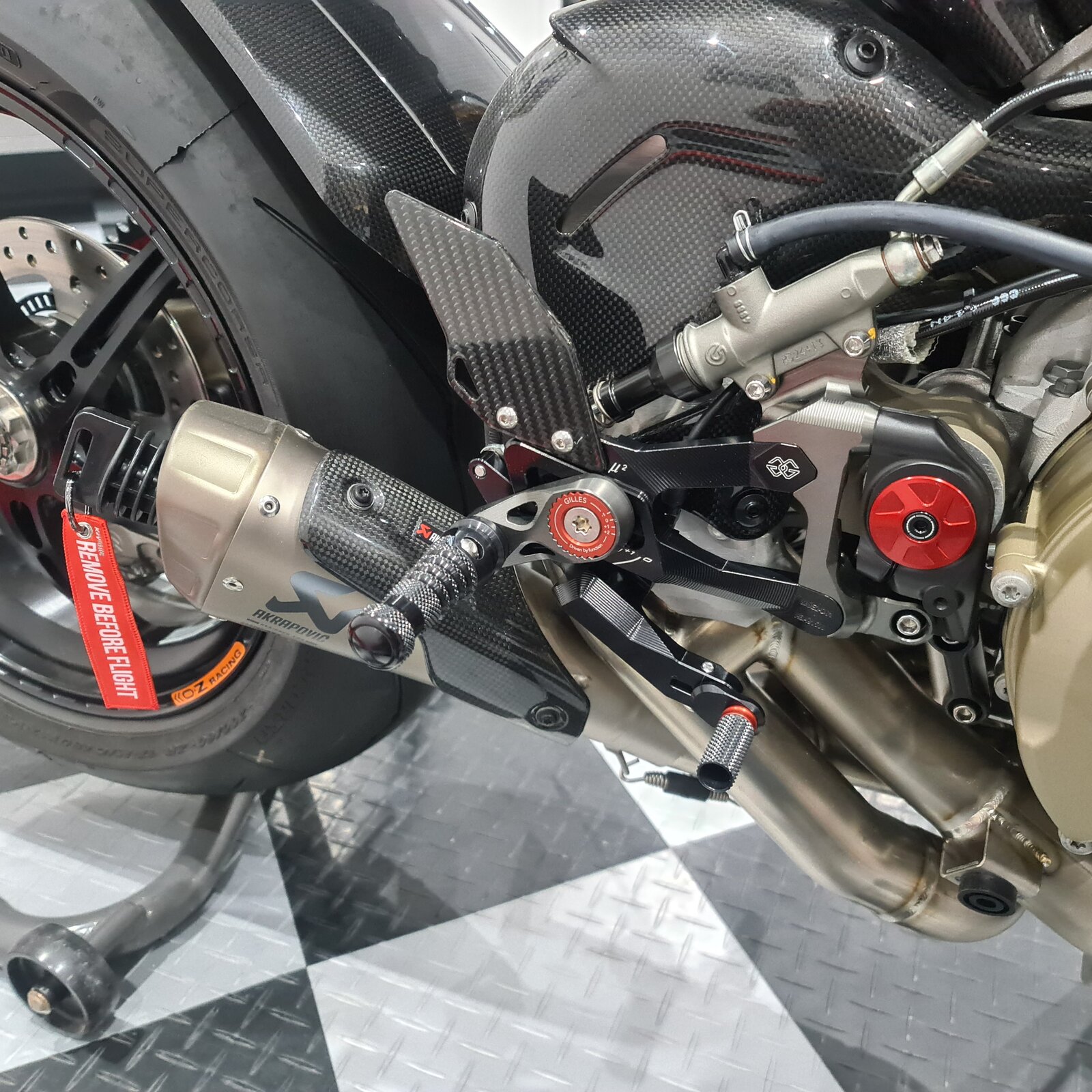

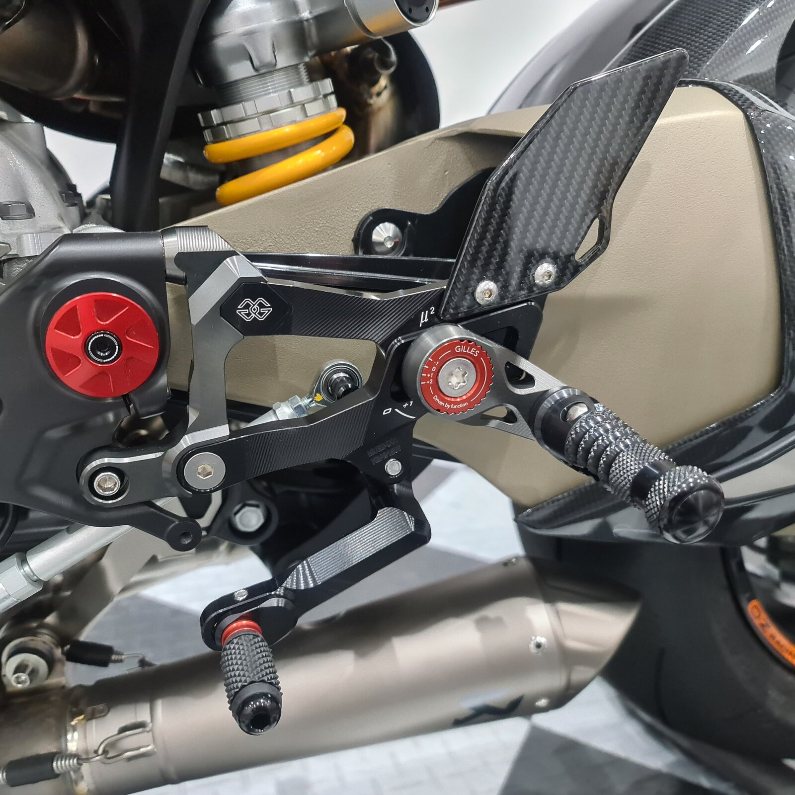

  14. Finally completed fitting the new rearsets. Doubtless they will need adjusting to suit me but that will wait until the bike hits the road. Very pleased with the end result however.

  15. Stahlbus clutch bleeder valve fitted. Was going to reverse bleed all the brake systems but running out of time now as I'm heading back to Blackpool tomorrow morning for another 12 day stint at work, so that's it for short while.
  16. How do you like the bleeders? Have been planning on getting them for some time so really interested in hearing the opinions of it from someone not pushing them as a vendor. :laughing:
  17. Can't say for sure yet as I have yet to fill/bleed the system but from listening to others who've bought and fitted them, it just the ease of use that appealed to me and that you dont need to faff around with messy and often ineffective vacuum bleeders. I'll post up my own findings in due course.
