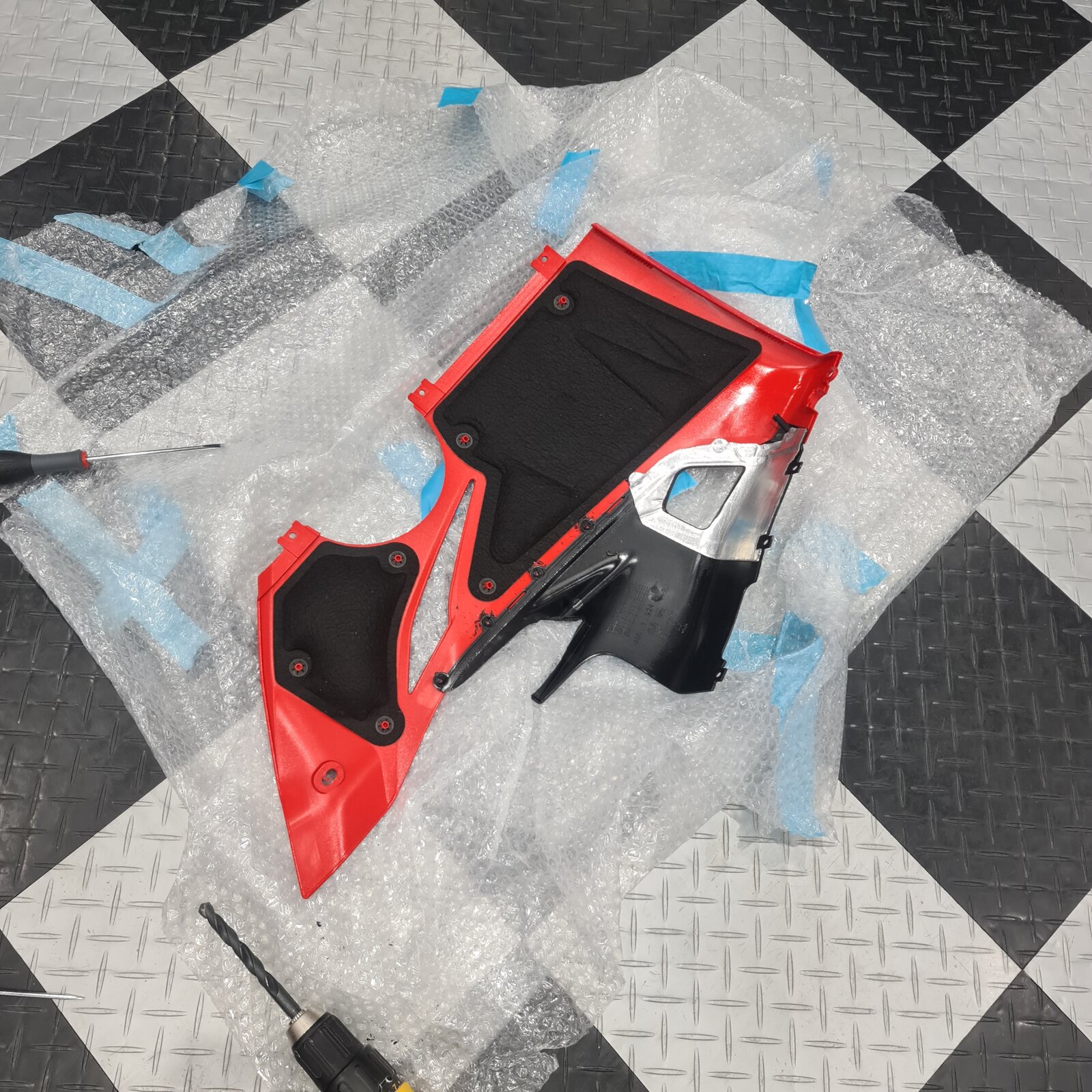

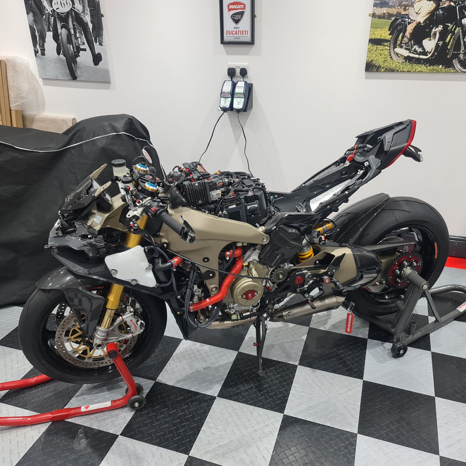

  15. Another stint in Blackpool and what always seems like a fleeting few days at home. However managed to get a lot done this time around. Removed (for the last time) all the bodywork, including the fuel tank (which was stripped of all it's fittings, pipes, brackets, riveted and stuck on dual lock pads and cap) and dropped all the parts off at the paint shop. Spent a good couple of hours going through the design with them and ensuring we were both on the same page. Should be around three weeks until the preliminary work is complete. A few items need to be set "on the bike" so they are bringing over some of the parts after the intial colour is laid down, to check alignment between panels in situ. I also managed to drop of my seat which is being reupholstered wth a Tappezzerria Italia cover. The coachtrimmers I use are very reasonable and always deliver when it comes to the quality of their work. They had a ground up restoration of an old 1974 Porsche 911 while I was in the workshop. Stunning leather work. I also had to split the lower fairings, to get rid of the hideously cheap and nasty bellypan sections which are being replaced with LiebSpeed carbon ones. These are joined to the lower fairing by means of frequency welding at severals points. A little nerve racking but with patience not a problem.
    Next up will be the Bonamici generator and clutch cover billet alloy guards and a few other billet alloy accessories and carbon parts to complete the build bar the bodwork.
    Bodywork removed for the very last time, including tank, for a trip to the paintshop.

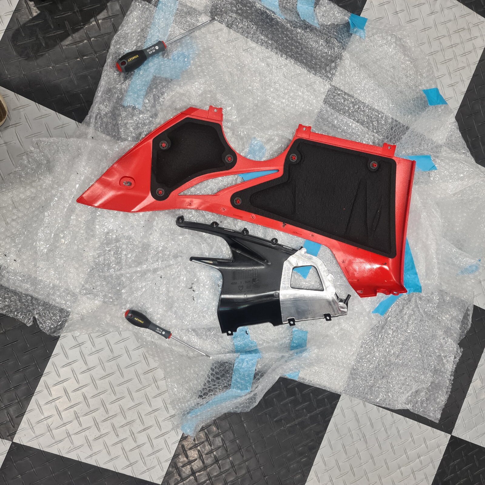

    In order to fit the Lieb Speed carbon lower fairing bellypan sections, meant drilling out and then prising clear the cheap and flimsy OEM sections first, which are frequency welded to the upper half. You only have to drill out enough material to see a hint of the red panel underneath, then it is just a case of levering the black section away at these points. A little dremelling afterwards to clear up the proud lumps left behind and the carbon panels are ready to fit once the red sections return from the paint shop. Fitting of the Lieb Speed panels will be covered at a later date.
    Panel before splitting into two. Frequency welds hold the two sections together. Pretty woeful heat protection as standard.
    The two sections now separated. Now onto the other side.

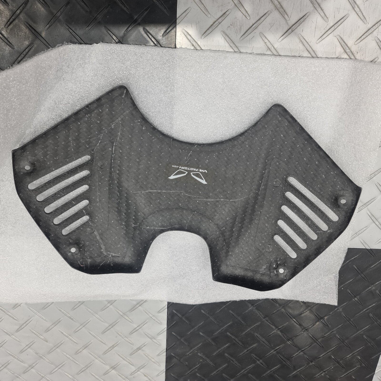

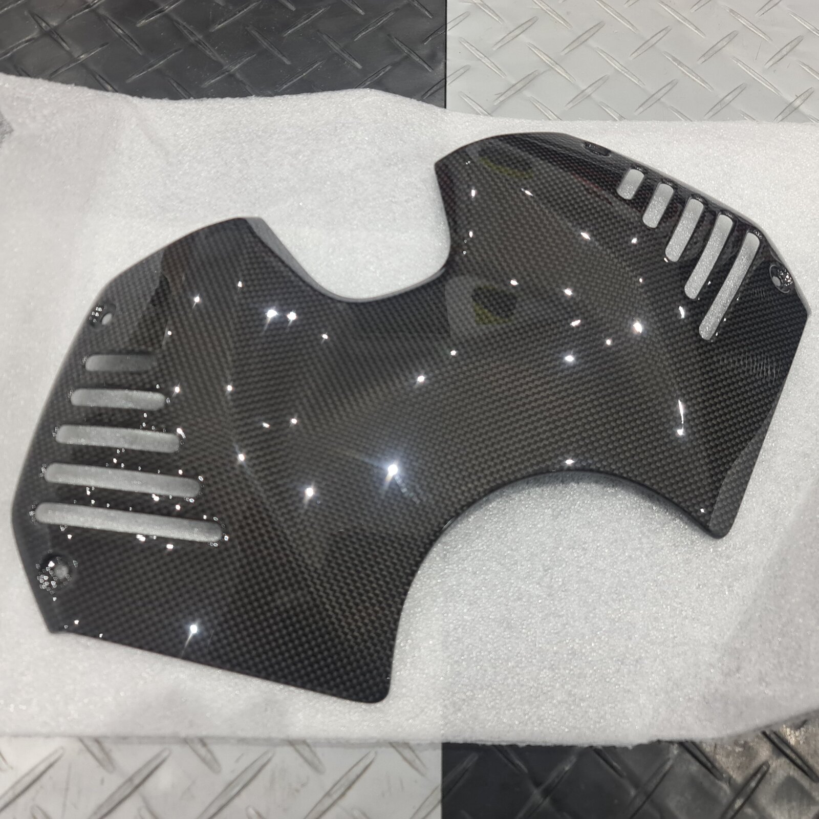

    Sound deadening panels wil be removed prior to any paintwork. Here is the LiebSpeed battery cover. This will be unrecognizable in a few short weeks. After paintwork it is going back to Germany for Peter to fit the grilles.
    As always, sublime quality from LiebSpeed.

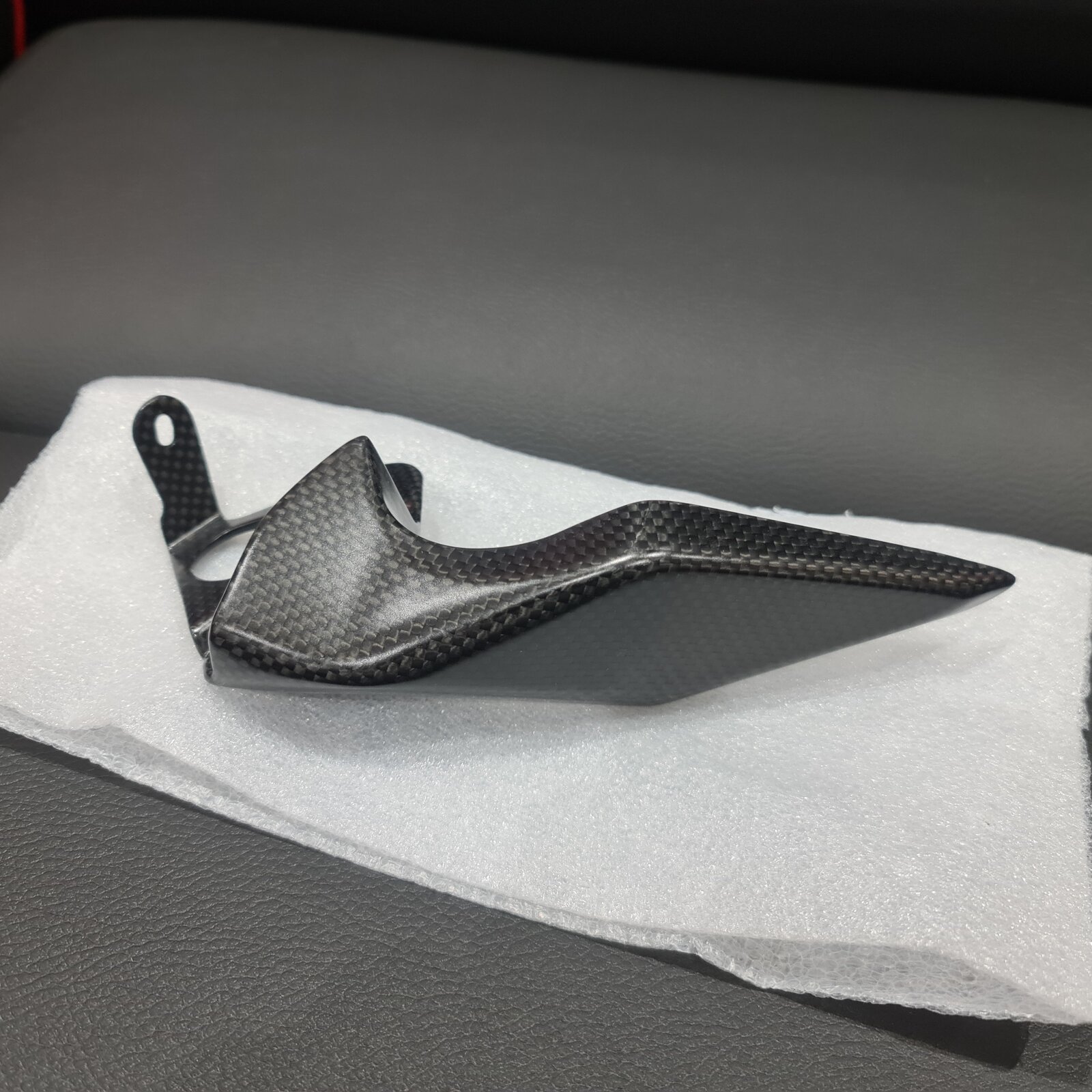

  16. One other late addition. DP lower chain guard. This will be clear coated prior to fitting.
