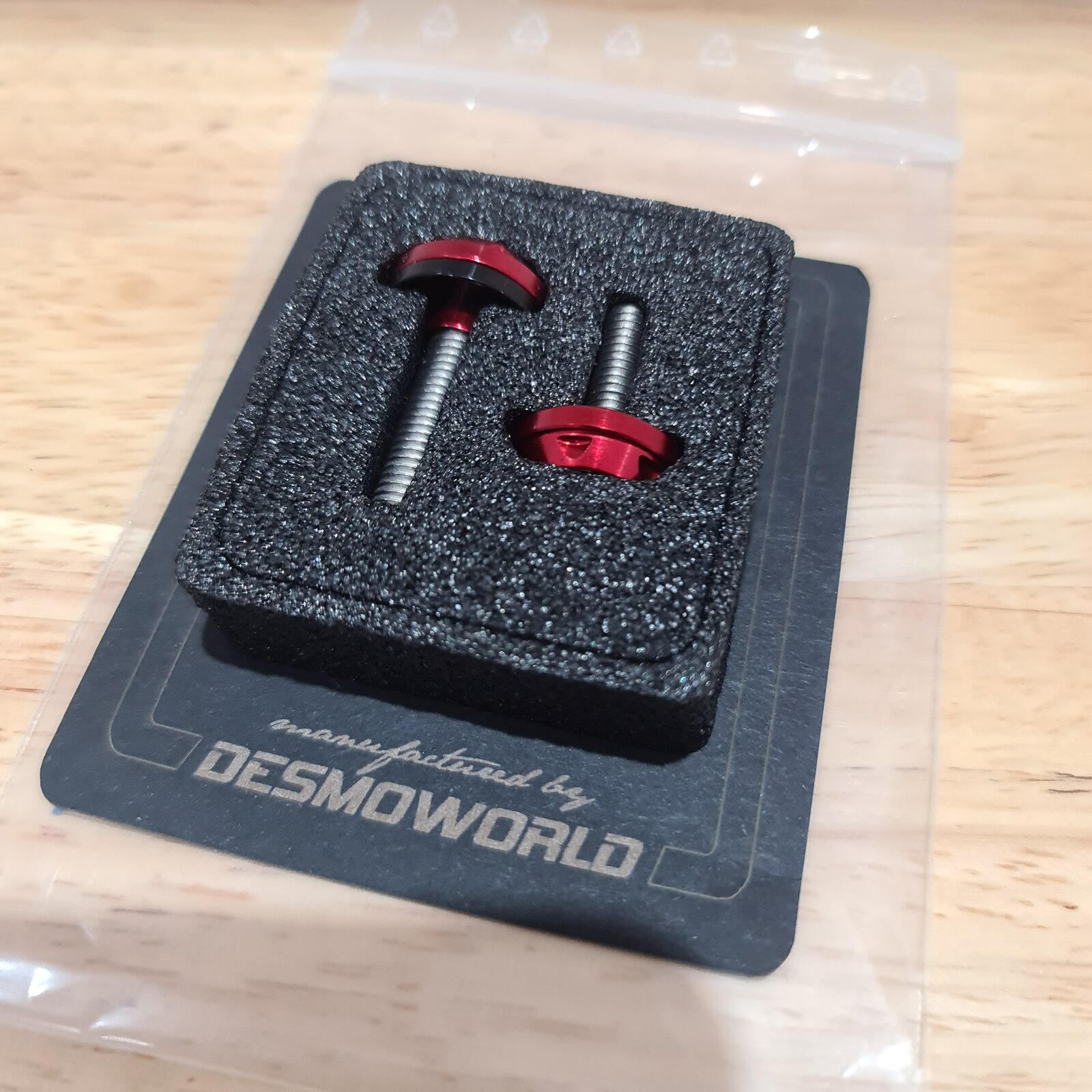

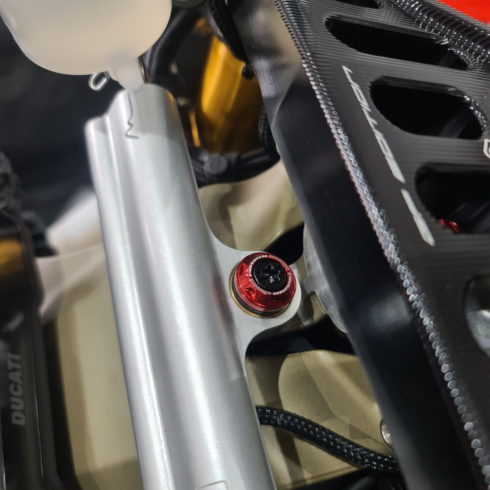

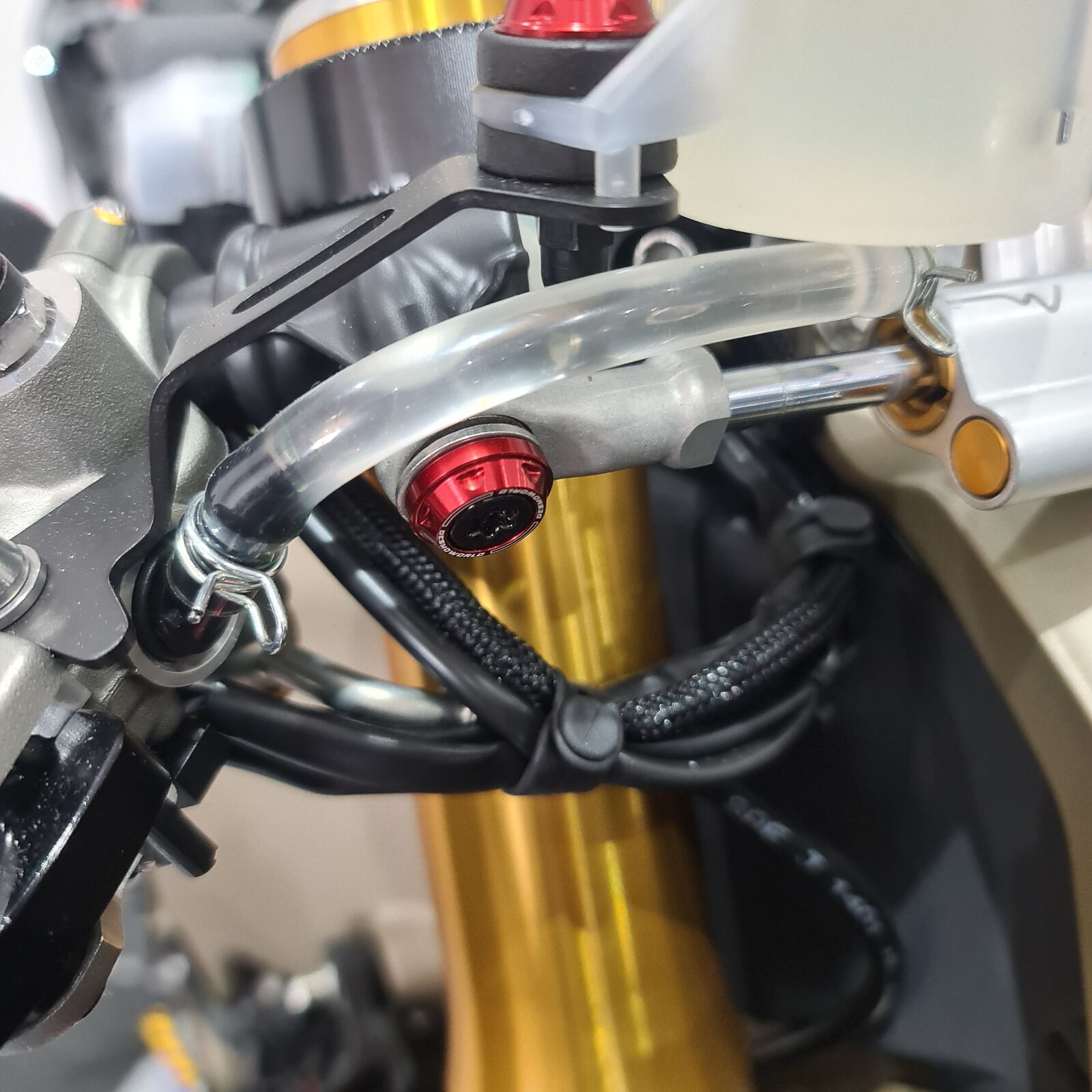

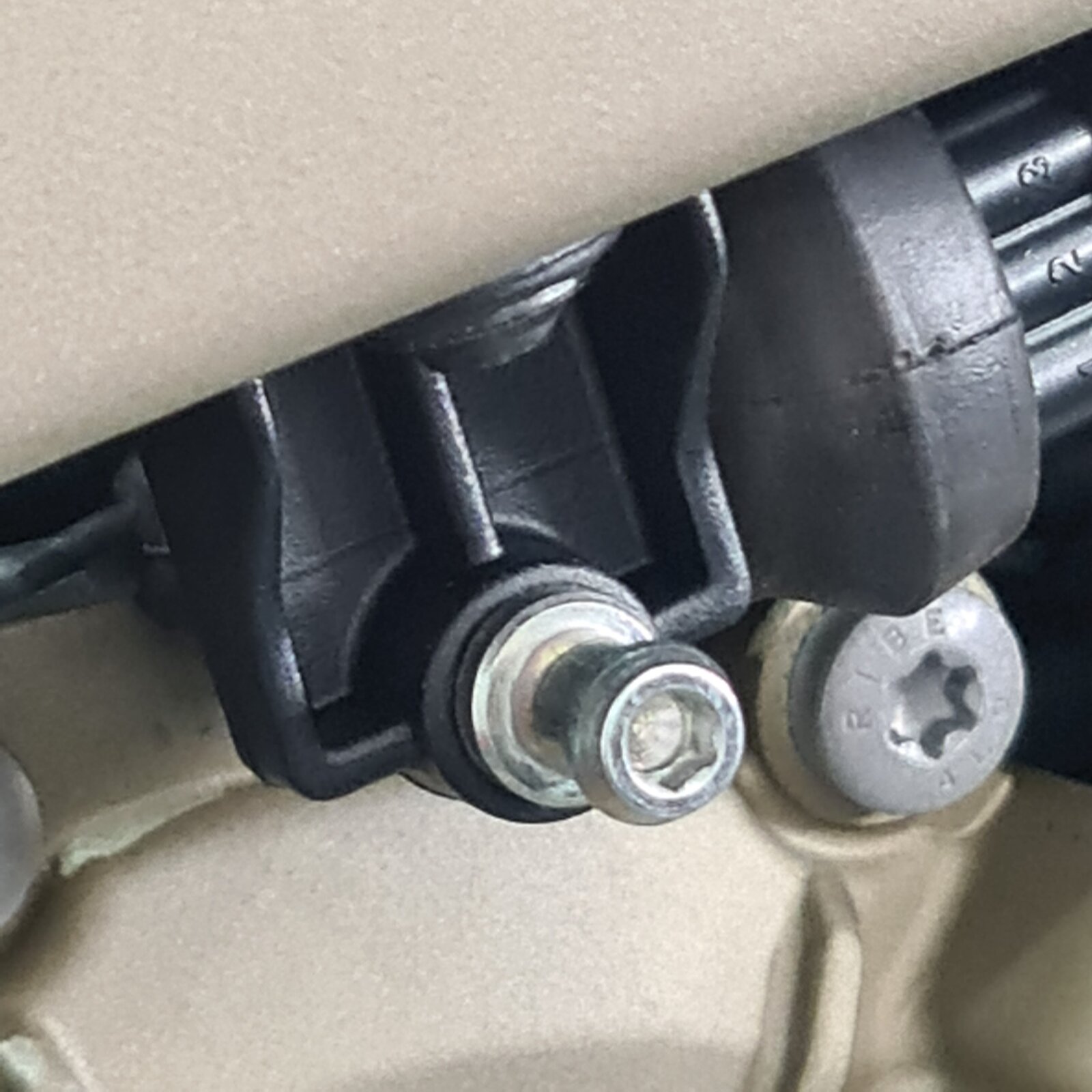

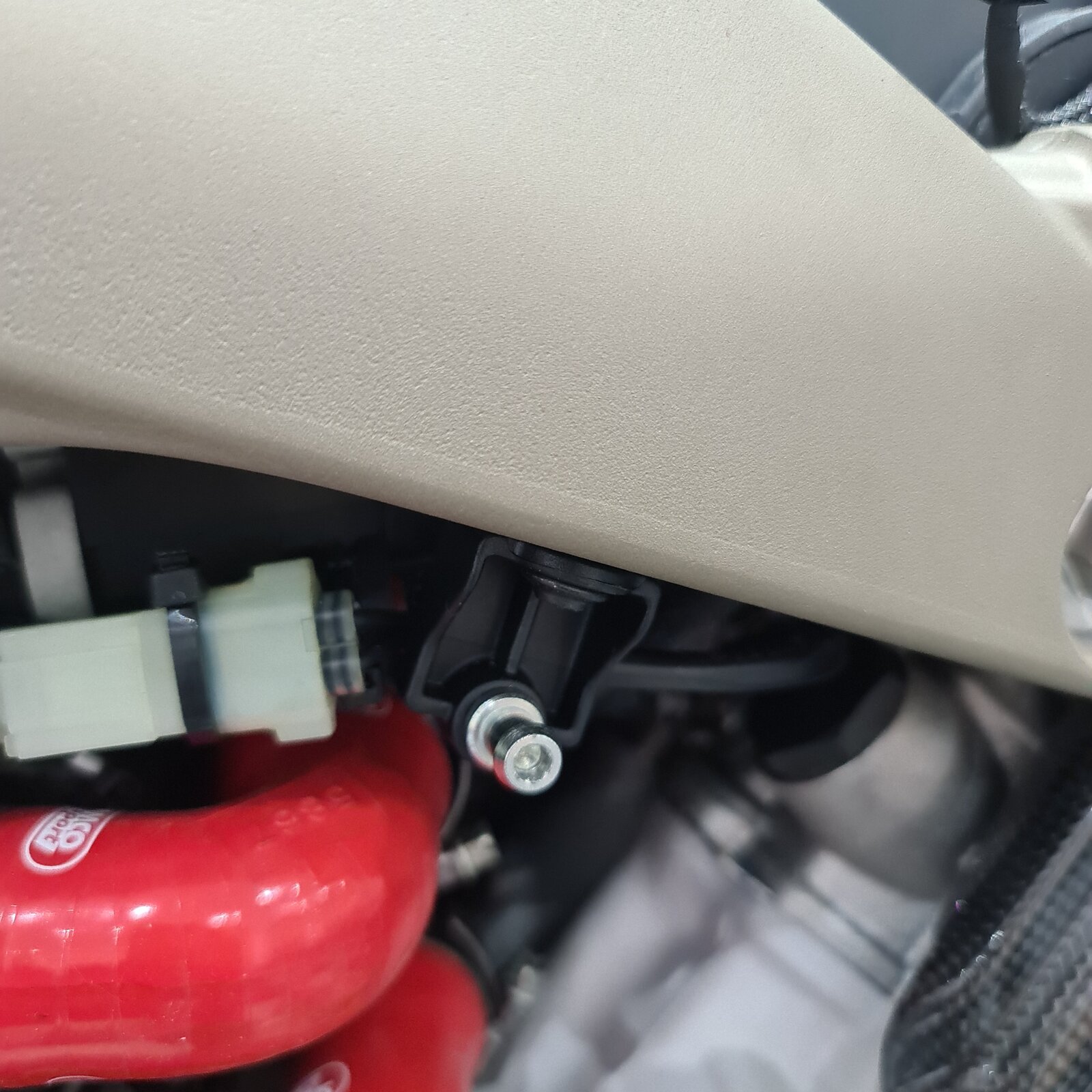

    Desmoworld steering damper bolts. As always beautifully machined parts from Chris in Germany. Believe it or not I actually had these shipped to the hotel in Finland before returning to the UK as they no longer offer postage directly to the UK due to Brexit (FFS!)
    Next up I mounted the two new fairing 90 degree brackets and pins, to accept the new upper/mid panels.

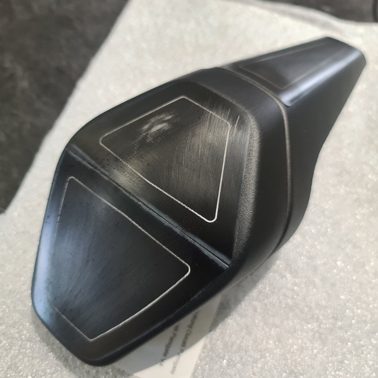

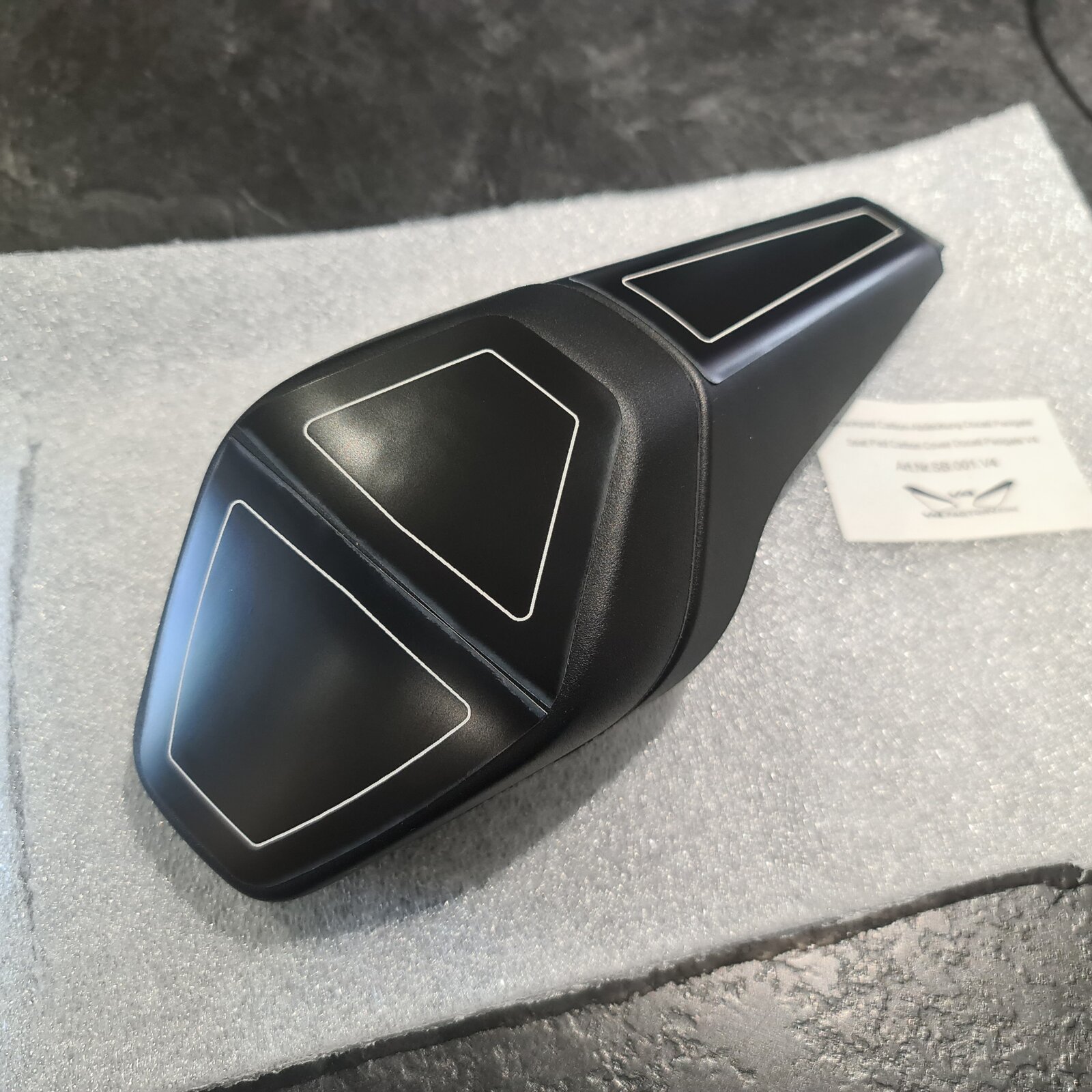

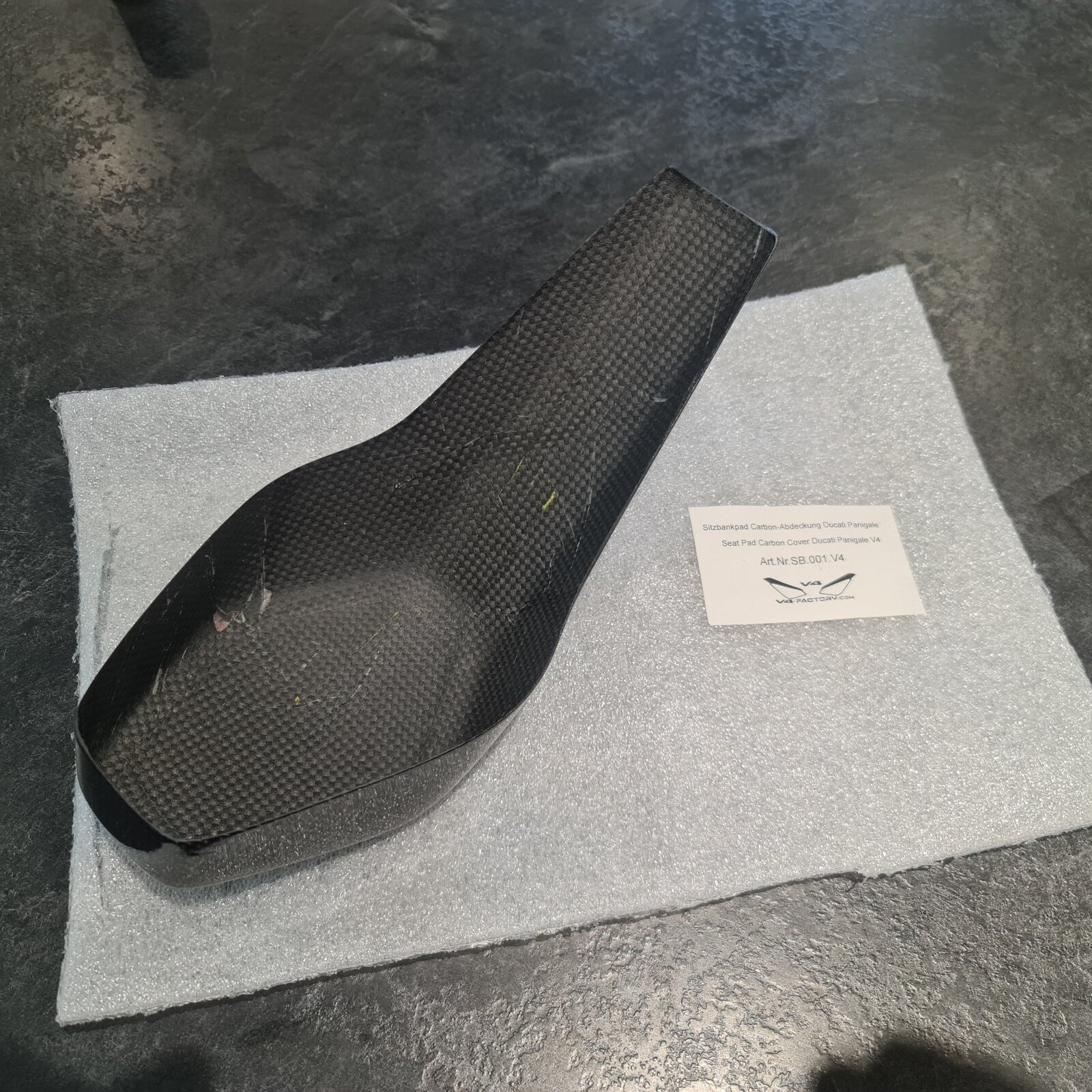

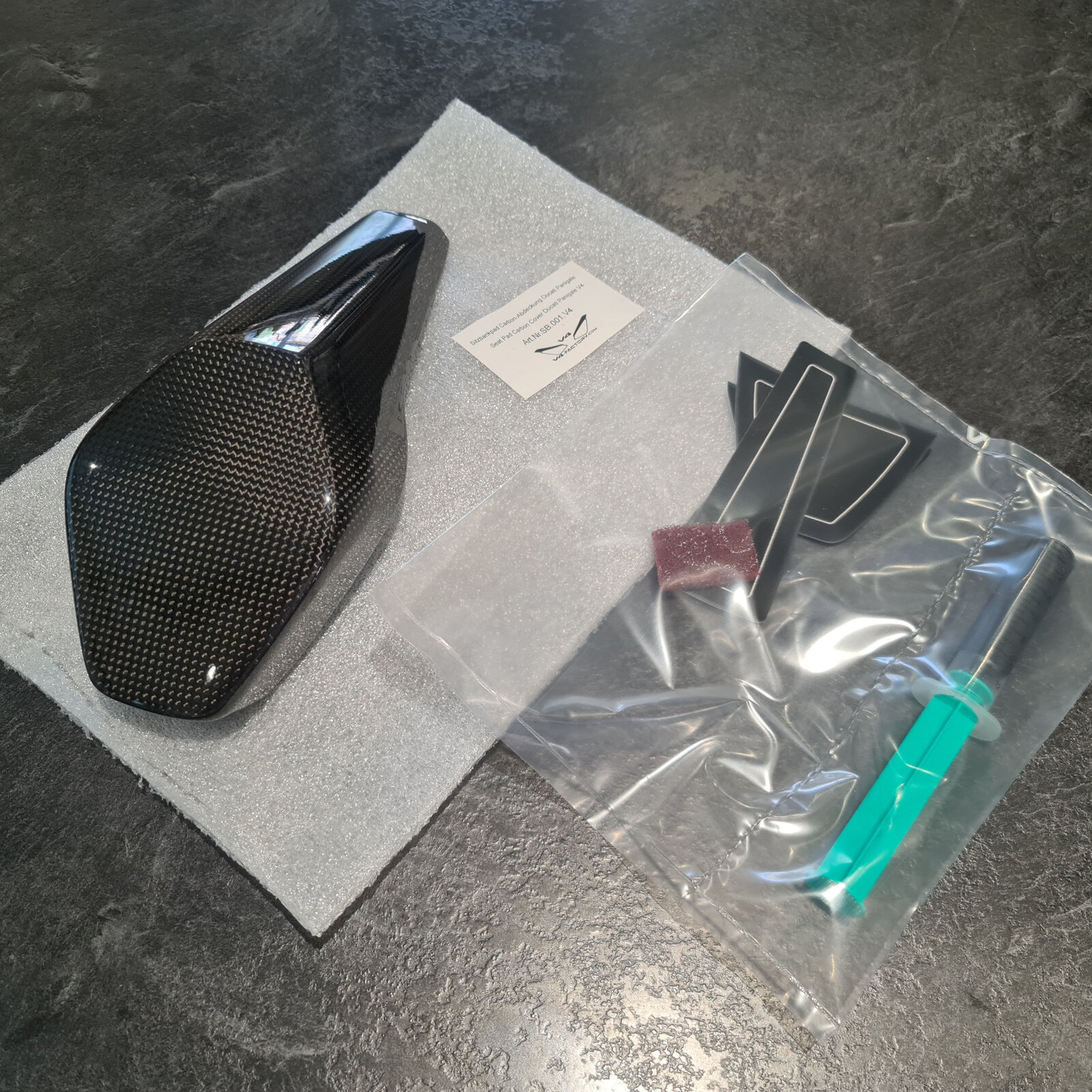

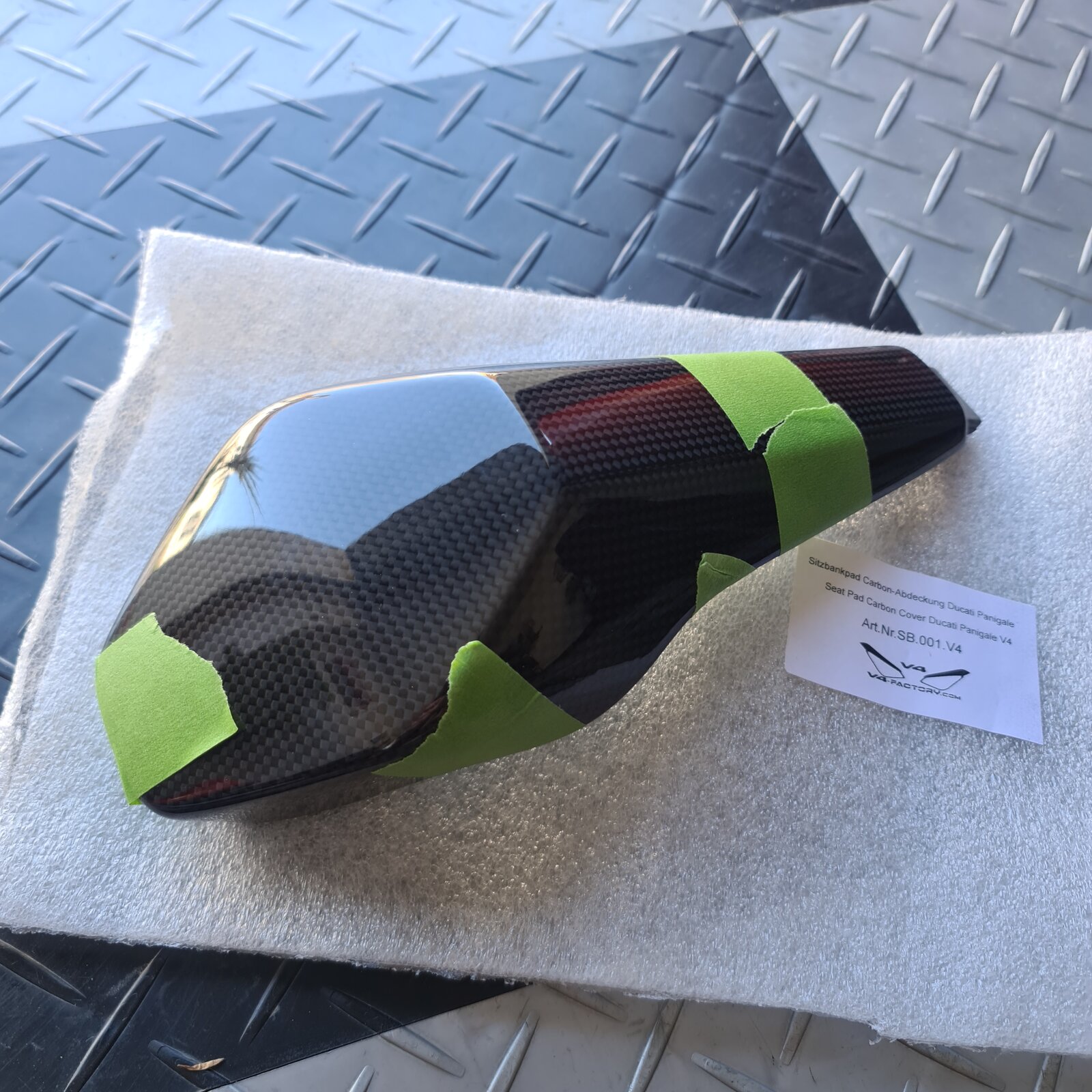

  8. As I patiently wait for the bodywork to arrive, though even mine is being tested right now (given it was supposed to be here last weekend) I have been adding a few more mods to the bike and sorting out some work in the man cave (more on that elsewhere). After sitting in a box for over 18 months, I was sorting through some of the carbon parts I bought from Peter Lieb, one of which was the seat pad cover. Unfortunately given the box had been stored for so long the supplied adhesive had cured. No problem and my own fault, so a quick email to Peter and he gave me the spec of the adhesive he uses and I managed to get some via Amazon. Sorted. I will also have plenty left over for the belly panels which I have yet to fit to the lowers (which are, you guessed it, still at the paintshop).

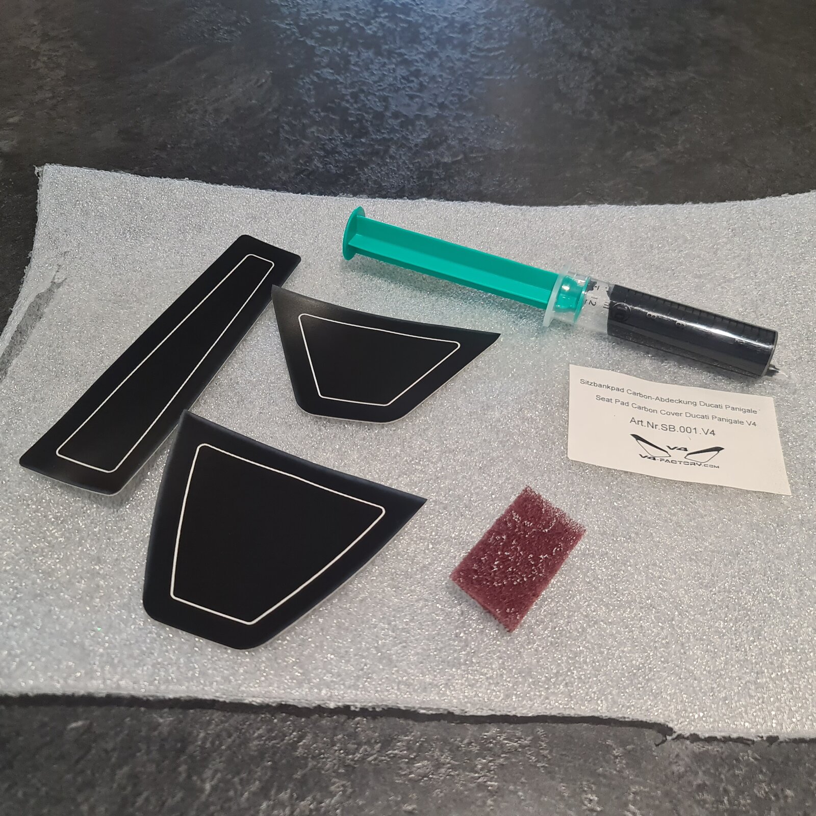

    Here's the kit.

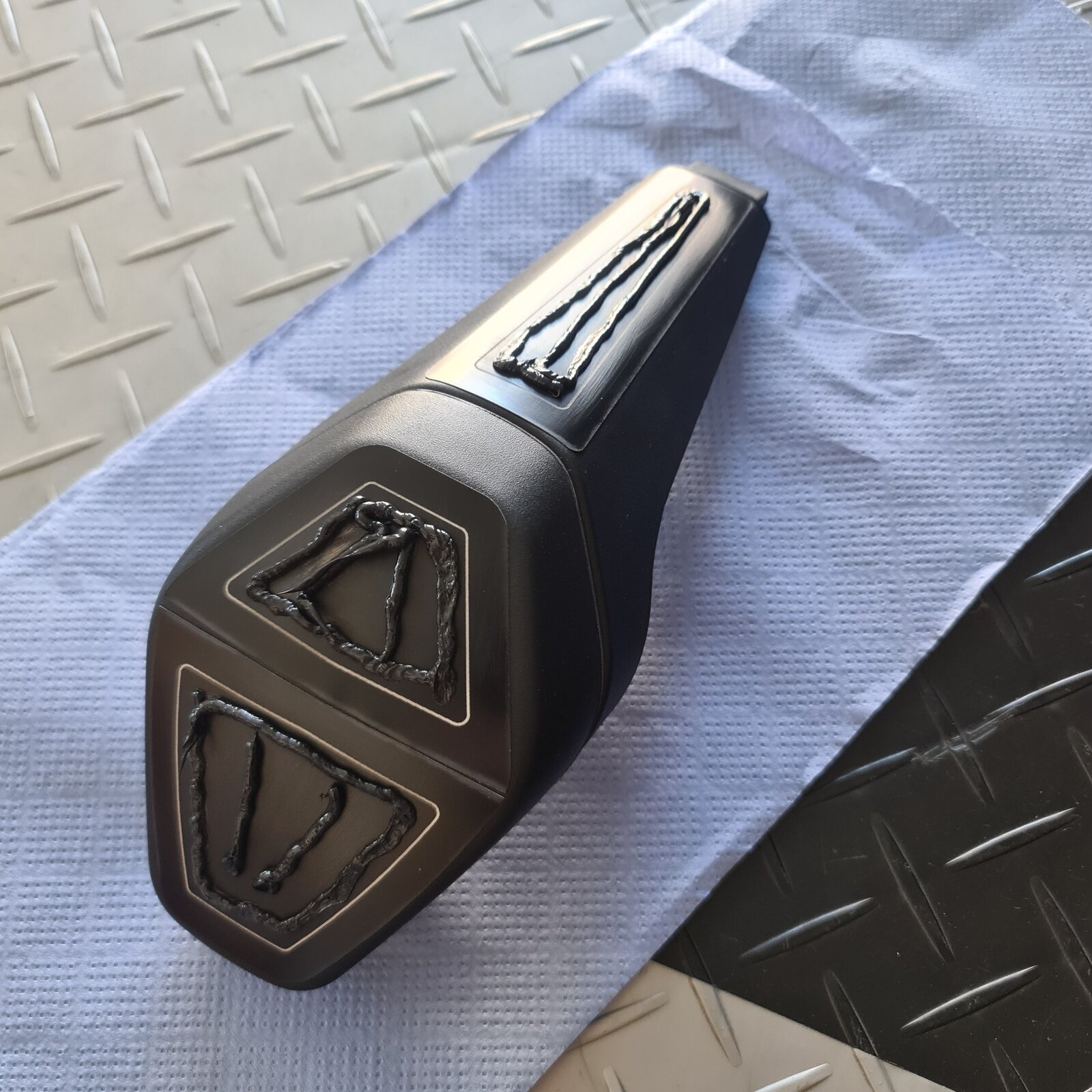

    First step is to ensure the OEM seat pad is clean and free of any grease. A quick wipe over with isopropyl alcohol does the trick. The next step is to apply the adhesive foil panels to the seat pad, as per Peter's instructions. These allow you to remove the carbon cover (should you ever want to), as the adhesive is applied to these foil panels and not directly to the pad itself.
    Next, you scuff the areas inside the lines with the supplied ScotchBrite pad, to give the adhesive a good key.
    Then it is on with the adhesive, which you apply inside the marked lines.
    Finally you can then fit the carbon cover over the pad and secure it with masking tape for 24 hours until the adhesive has fully cured.
    Peter also produces another seat pad with the Ducati Corse emblem inset into it, but this was a recent addition to his range of V4 parts and is the seat pad itself as opposed to a cover like mine, so perhaps a better option, but I am happy with this version plus I don't want yet another corse badge on the bike, given there is already one on the instrument cover.

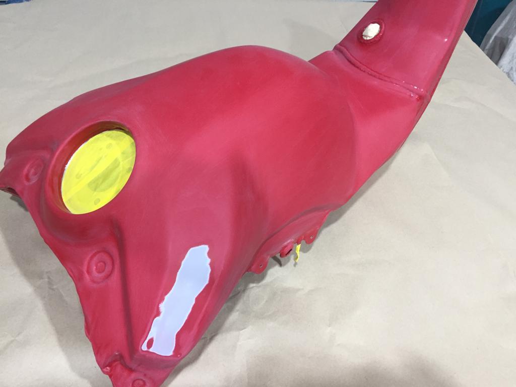

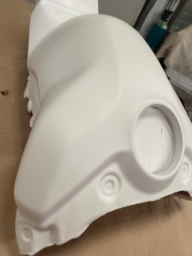

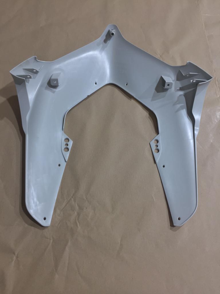

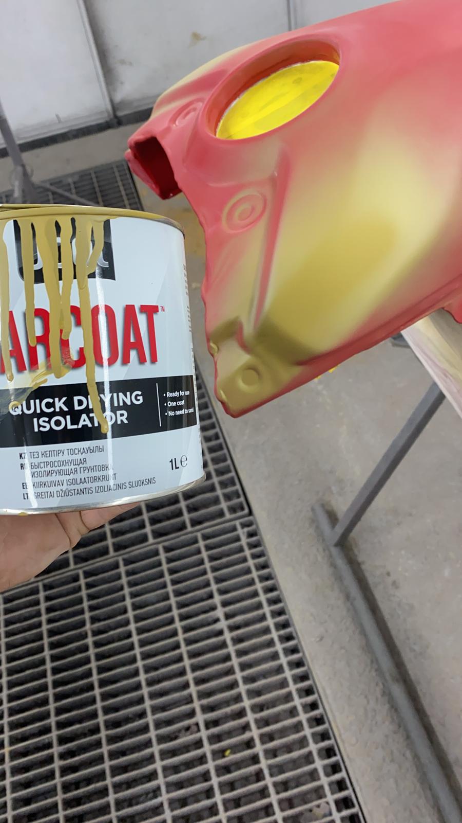

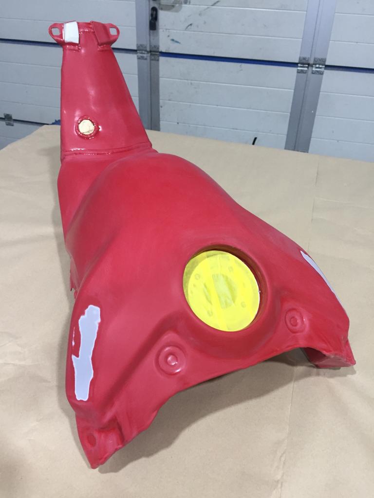

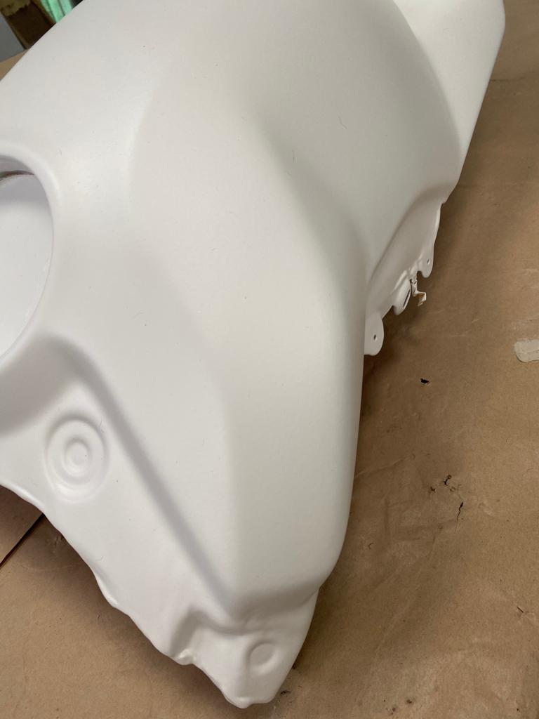

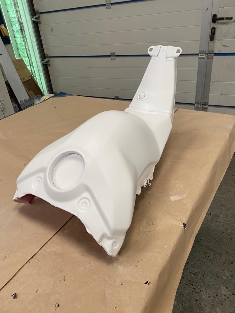

  9. Bodywork is coming along nicely in my absence. Hoping to pick up the side fairings, nose cone and seat next week. Tank and battery cover will need trial fitting to align paintwork, then will go back to paintshop to be completed.
    Tank rubbed down and decals removed, ready for primer.
    Primer applied
    WhatsApp Image 2021-06-21 at 14.40.23.jpeg WhatsApp Image 2021-06-21 at 14.40.24 (5).jpeg WhatsApp Image 2021-06-21 at 14.40.24 (4).jpeg WhatsApp Image 2021-06-21 at 14.40.24 (3).jpeg

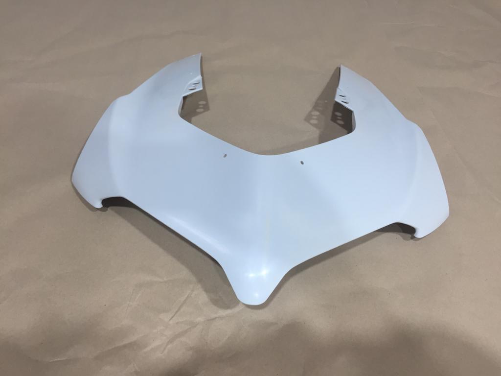

    Nose cone will need to be sanded ready for primer

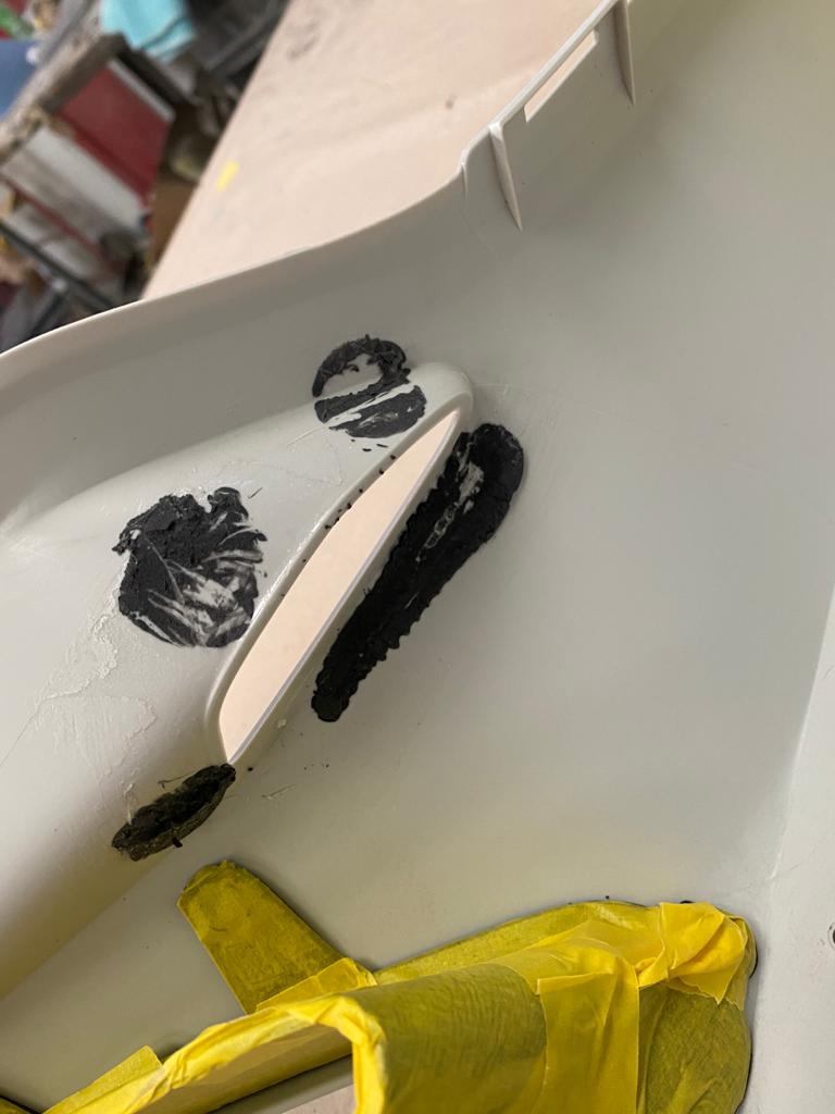

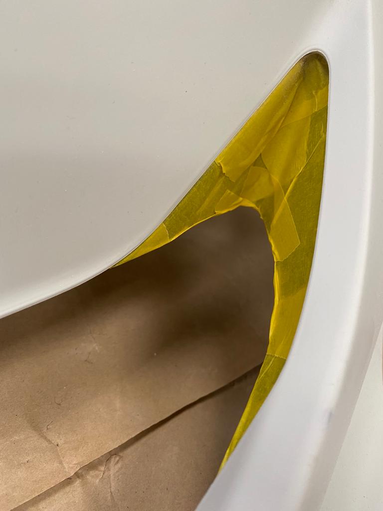

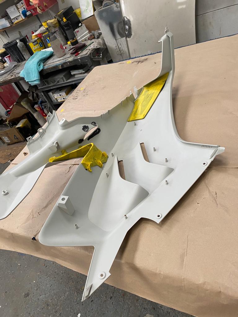

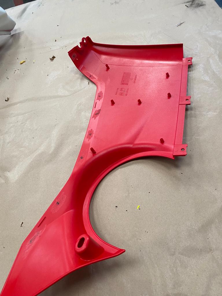

  10. Side fairings awaiting prep after masking. Grilles removed for painting. Adhesive will be rubbed down and removed.
    WhatsApp Image 2021-06-21 at 14.40.23 (3).jpeg .

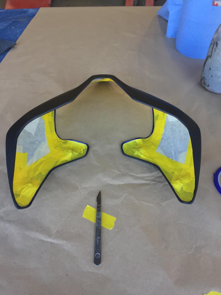

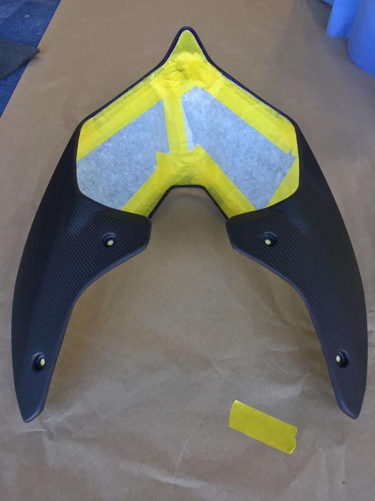

  11. Seat unit masked up for paint.
    WhatsApp Image 2021-06-23 at 16.10.54 (3).jpeg WhatsApp Image 2021-06-23 at 16.10.54 (2).jpeg WhatsApp Image 2021-06-23 at 16.10.54 (1).jpeg WhatsApp Image 2021-06-23 at 16.10.54.jpeg

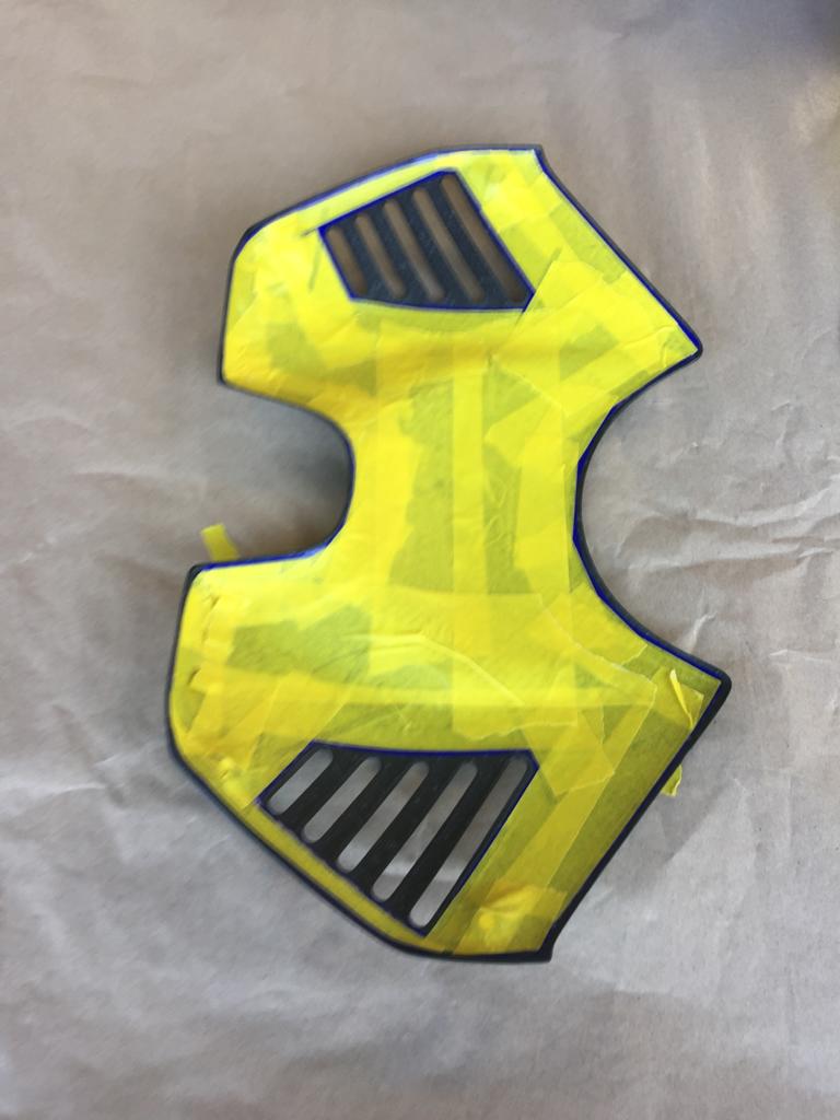

  12. Battery cover masked up for paint. Once painted, this will go back to Germany for Peter Lieb to fit the grilles and posts.
