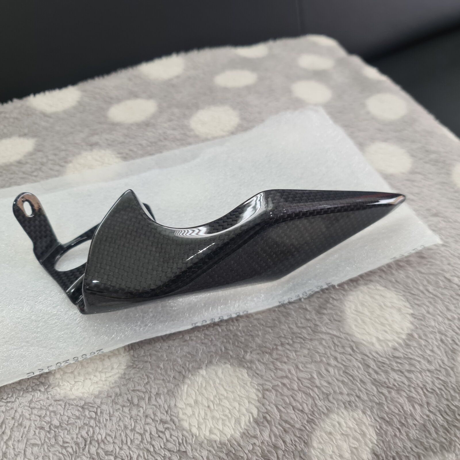

  1. Shark fin guard now clear coated. Matte be gone. This part is a little tricky to fit, as it requires a small hole to be drilled and tapped in the underside of the swing arm to accept one of the two fixing screws. The other fixing point (top left of the guard in this picture) utilizes the existing brake line P-clip bolt . Given this is a job that could easily go very wrong, say like snapping a hardened tap off in the swing arm! :-o, I am going to leave this one to my local guru Carl Harrison to fit. The rear wheel also needs to come off as well, so not a 5 minute job.
  2. Good for you. Exactly what these machines were designed for after all. There's always a little trepidation MH, as with anything you have spent time and money on, in case you launch it down the road, but it is there to be ridden and it was never intended to be a garage queen, so at some point I just have to put those thoughts to one side, get out and enjoy it, which I am planning to do at the earliest opportunity. Much as I like looking at it, I really want to ride the damn thing.
  3. Incredible build, your attention to detail is outstanding. Love your garage/workshop too, if you can call it that!!

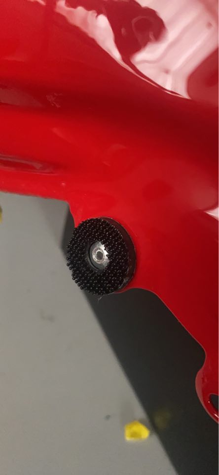

  4. New tank dual-lock pad (one of 4 in total) riveted back on. This was done before the clear coat was applied (masked over pad) to ensure no damage to the final finish when the rivet was compressed.
