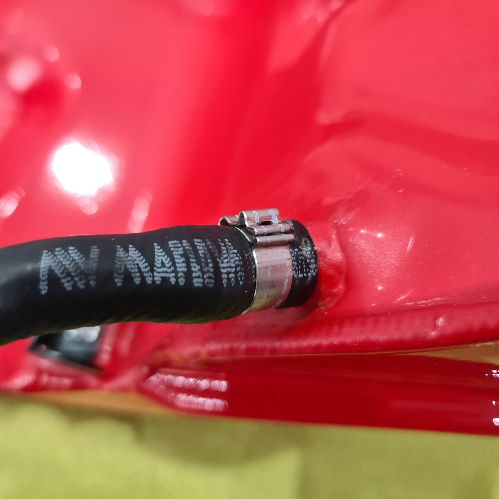

    Main fuel line feed pipe went on first. New "Norma" clamp ensures a leak free seal. The only thing to watch out for here is that you orientate the angle of the pipe correctly, else it is a PIA to connect it to the airbox fuel inlet

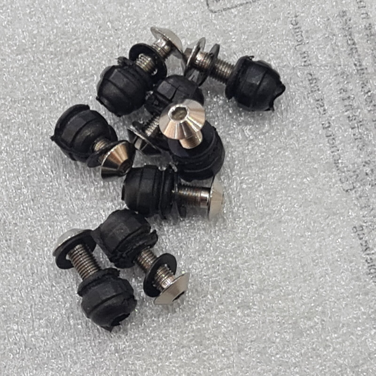

    That done, next up were the support brackets, Swiss cheese original bolts replaced with A2 stainless items. Locktited and torqued as per factory spec.

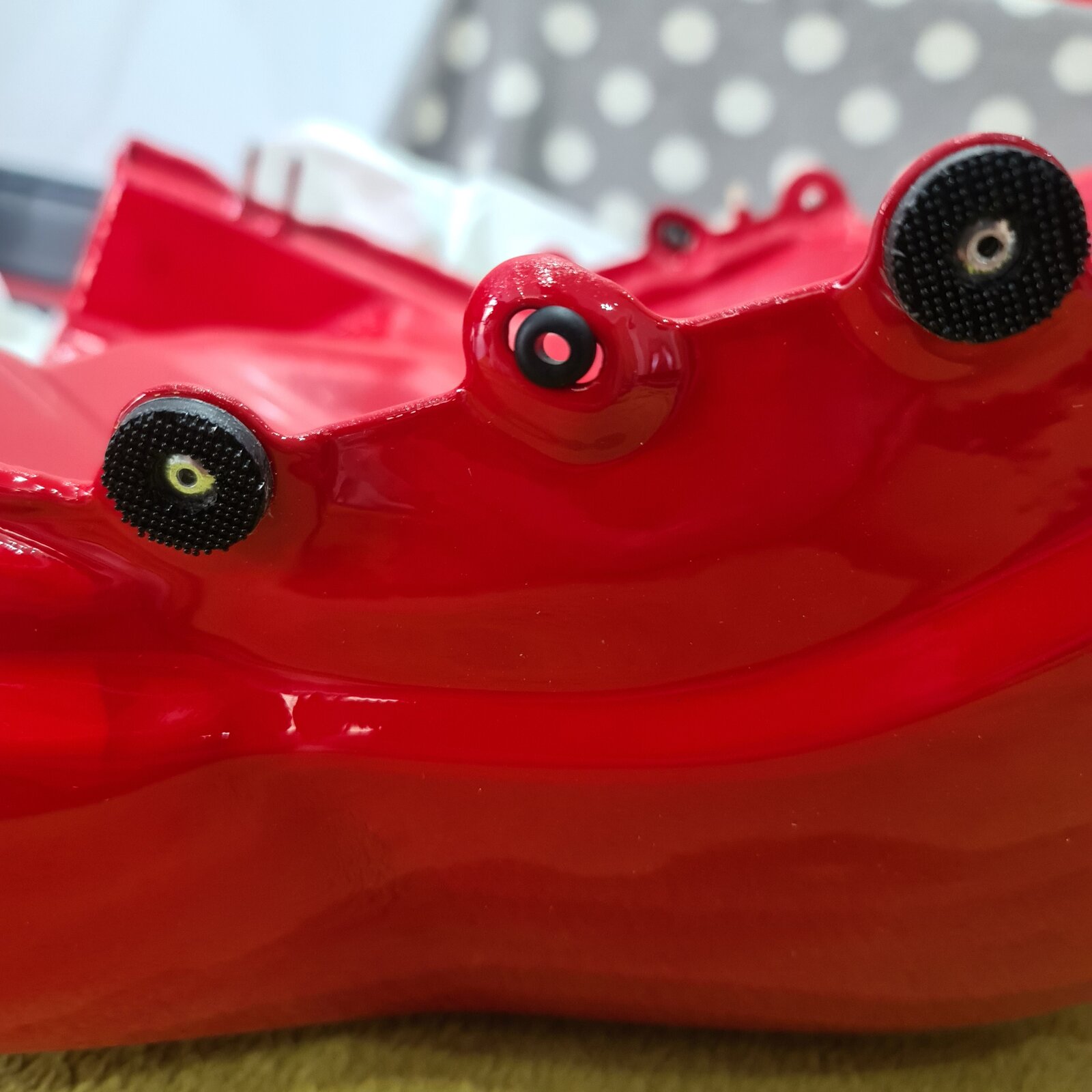

    Dual lock pads and new fairing grommets in place on each side. Instead of the goop OEM white lithium grease, I bought some red rubber grease which will prevent these grommets from being pushed out when the fairing pins pass through them.

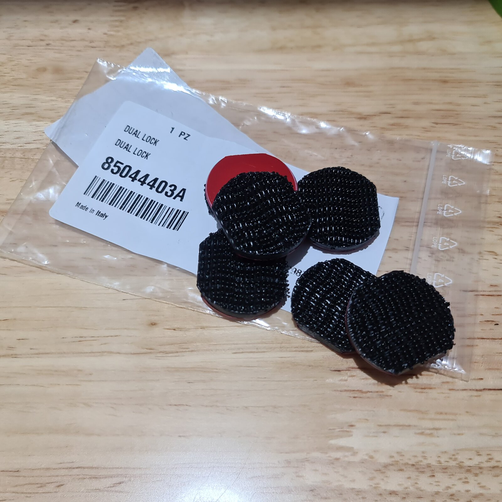

    New dual locks for atop the tank. The backing on these is a total mare to remove, so I slit them with a surgical blade in order to peel it off. Once on the bike they aint moving, so you need to ensure you position them accurately before you commit.
    Once the rear grommets were fitted (where the tank bolts to the rear subframe), all that remained was to offer it up to the bike, reconnect the earth lead, fuel pump electrical connector and breather lines, then bolt it back into place. Next up was the underseat bracket, fuel inlet hose clamp where it attached to the airbox inlet feed and fuel filler assembly.

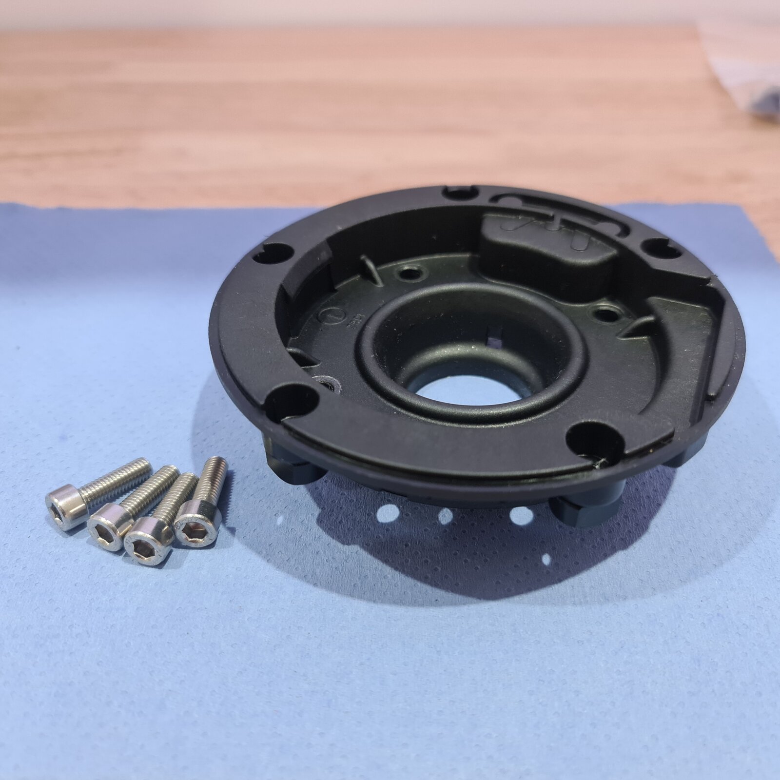

    The filler plate is held on with four bolts, so again these were replaced with stainless items. The plate is orientated in such a way that you need to ensure the two bleed holes line up correctly, to allow the venting system to work. before bolting it down. Finally the DP filler cap went on next and job done.

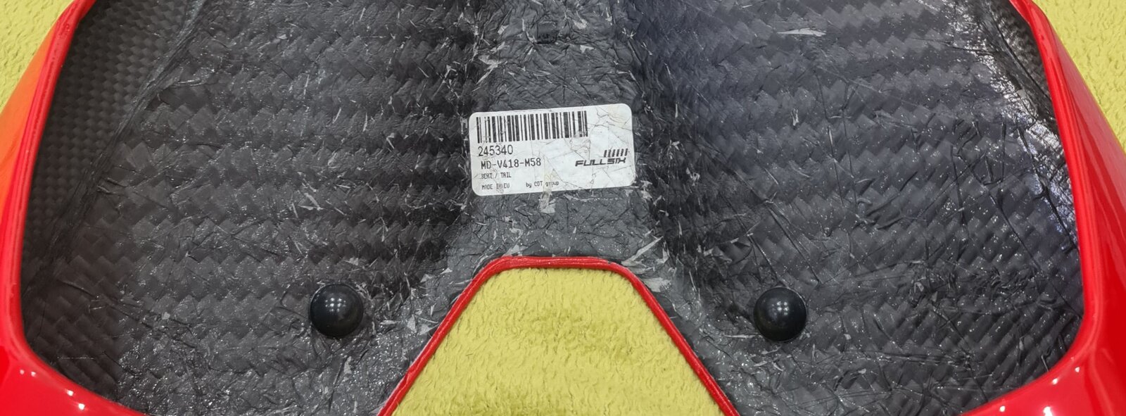

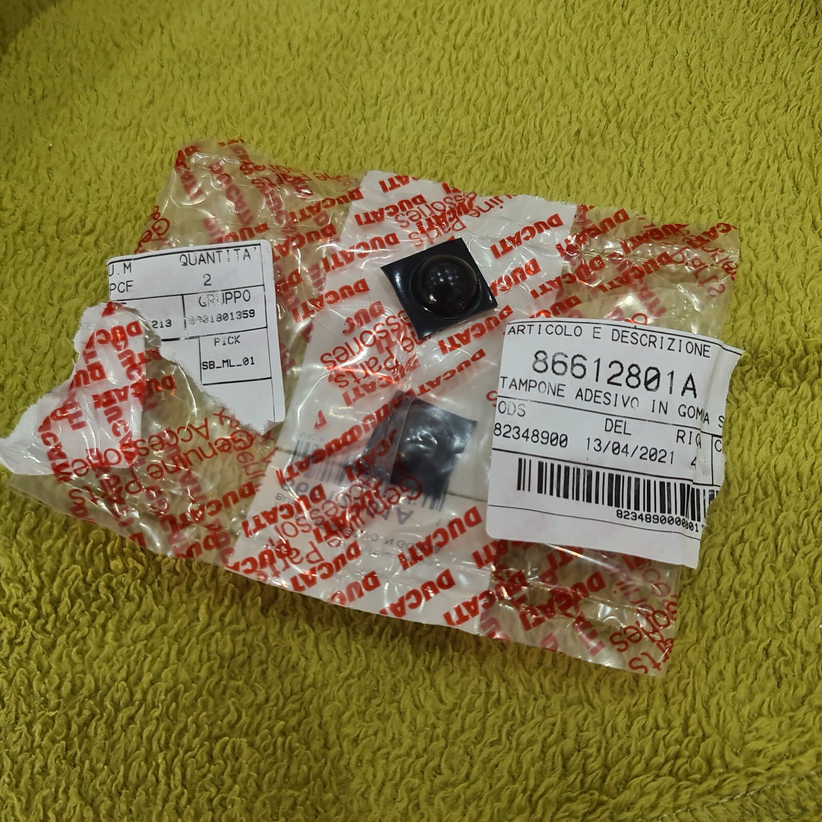

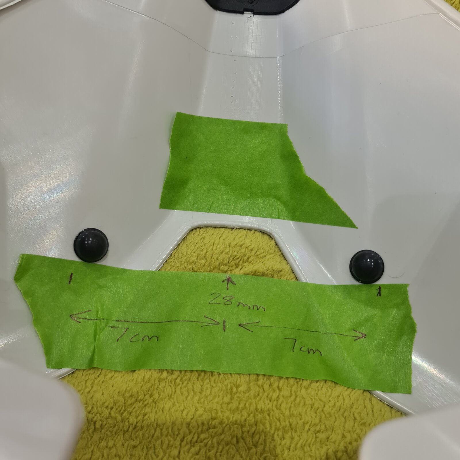

  2. Refitting the seat fairing involved marking out the position of the rubber pads that rest on the underseat compartment and whose purpose is to space the panel correctly. They need to line up with two corresponding points, so positioning them accurately is vital.
    Here I used a track fairing seat panel to measure the position of the pads and translated this across to the painted version.
    Stuck in position
    Last up was the rubber grommet, that locates the panel by sliding over the tail compartment "nib" at the rear. Silicone spray makes this a lot easier to fit than attempting it dry as it's a pig to get in otherwise. Once fitted and four bolts later, the rear of the bike is now complete (save for a number plate).

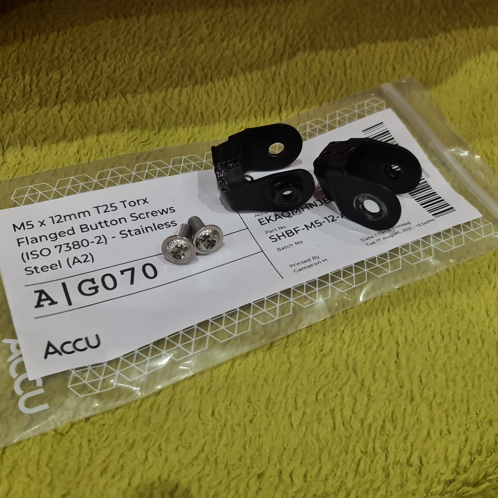

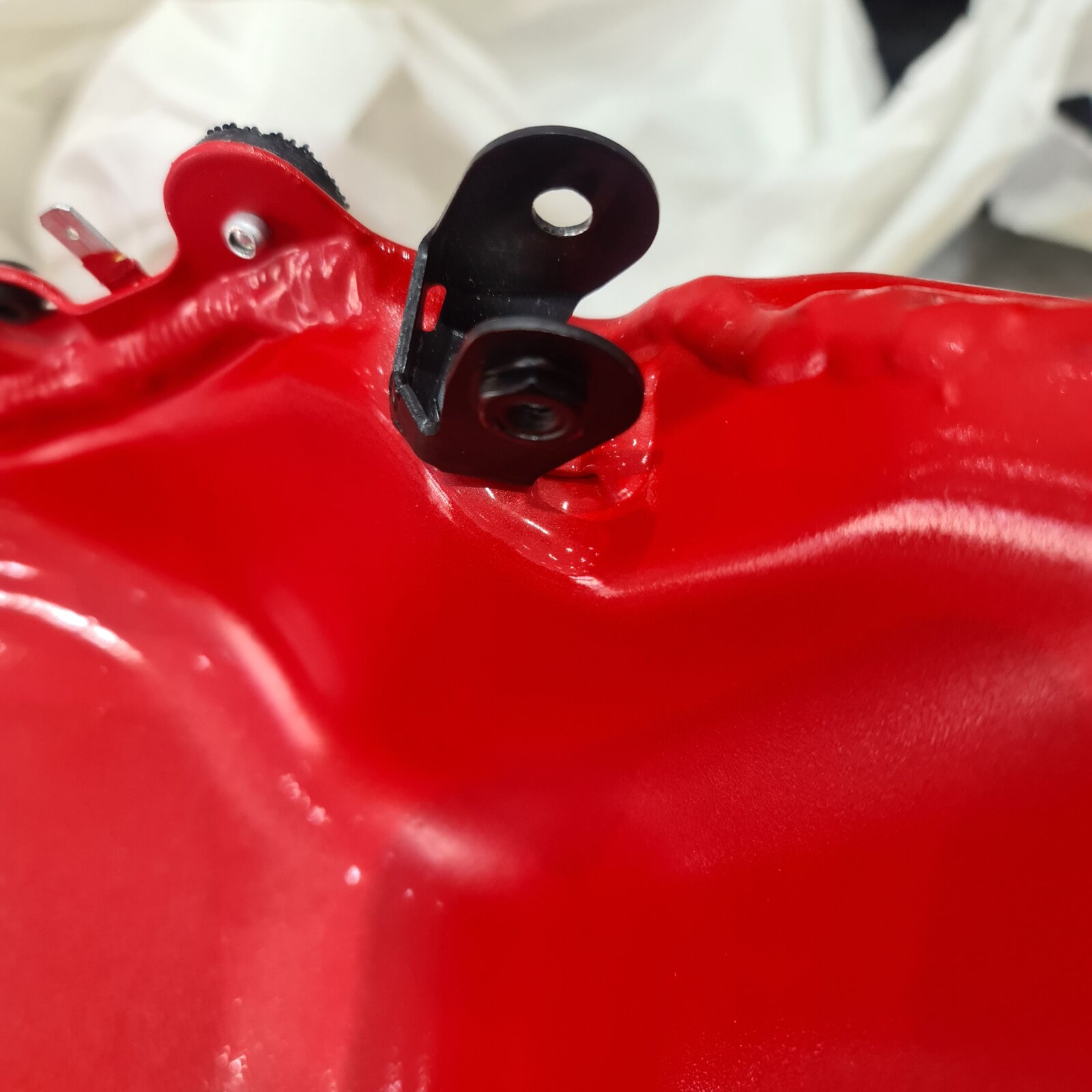

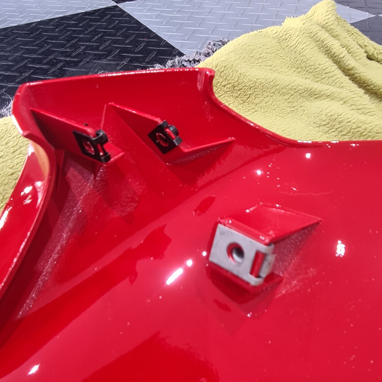

  3. Nose fairing fittings back on and titanium bolt kit ready to attach the new screen. The fairing itself utiliises two mounting bolts recessed into the instrument surround, that pass through the front subrame, which were replaced with stainless items when fitted back to the bike. I found it useful to apply a small piece of masking tape to the end of a T-bar to prevent them falling into the abyss inside and thereby avoid having to fish around trying to retreive them.
    Unfortunately the Lightech mirror block off plates are slightly different on the later fairing, so I had to order a replacement set which should have arrived by the time I am next home. As of now the upper side fairings, nose fairing, screen, tank, seat and seat panel are all back on. Just the lowers and battery cover to go now.

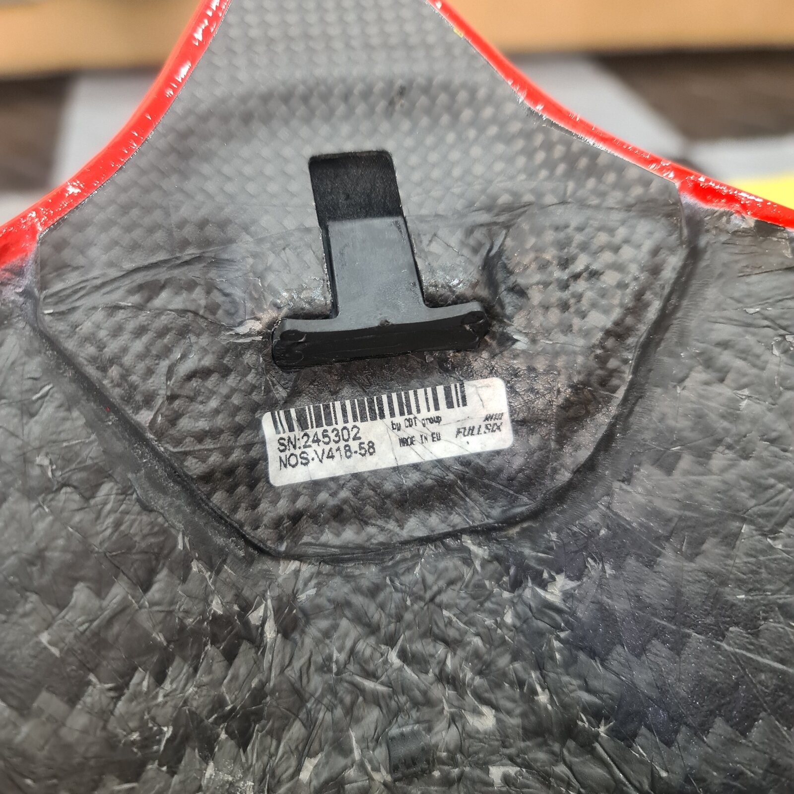

  7. As I’m on fuel tank number 3, the first two had problems, this brought back memories :) I settled on a FullSix carbon fibre number. Very nice too… :D
