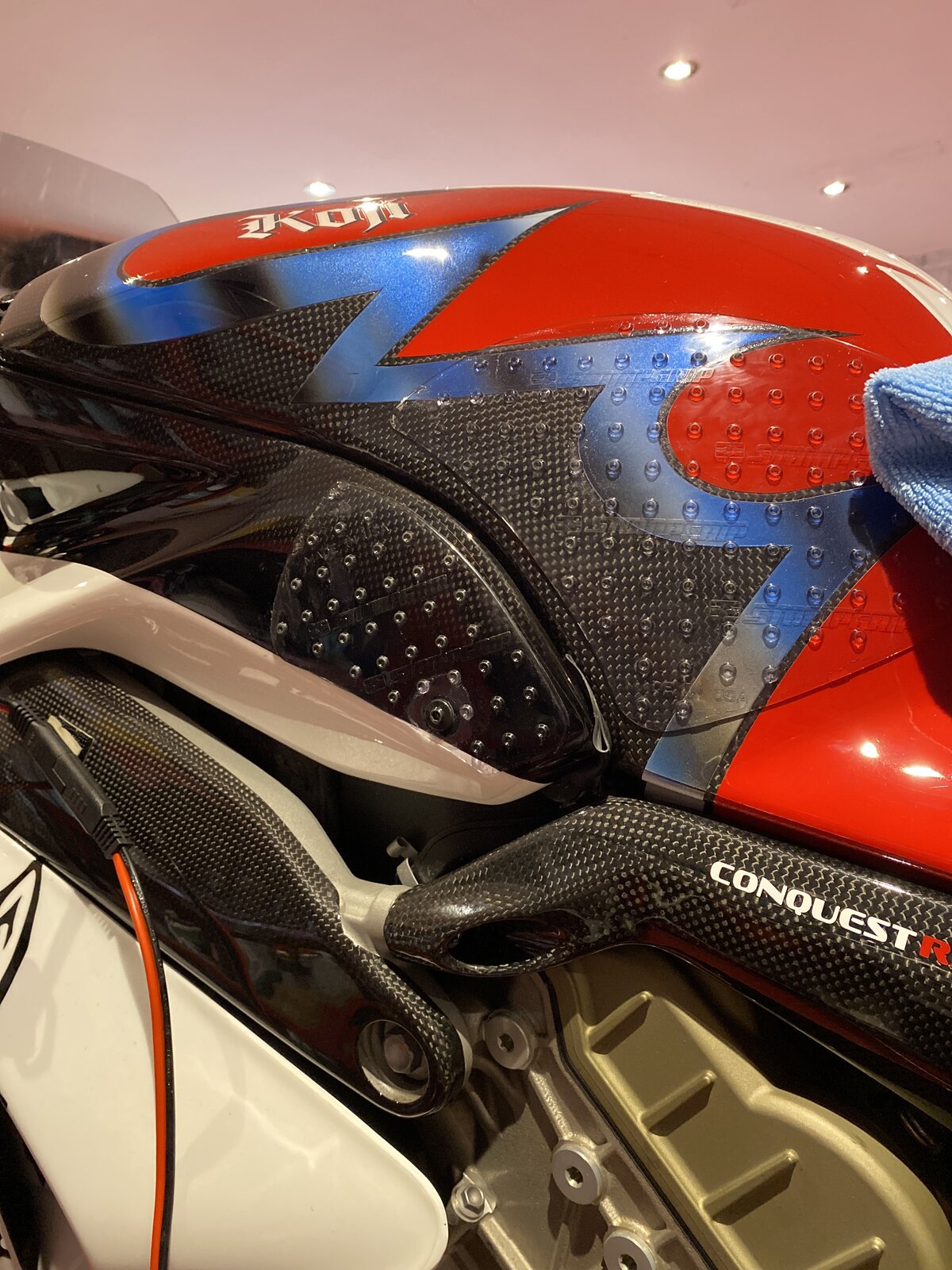

  1. One of the mods I like and replicated on my own 2018 V4S, was the anchoring bolt on the upper section of side panel. The bolt (or zeus fastener) that basically replaces the Velcro arrangement. I found the Velcro would often release and that section would spring out a bit from the tank. Wasn’t a good look and irritated me a tad. Anyhow, out came the drill and fasteners. Very happy with it now. *Drilling accuracy is key here :)
  2. Be interested to see what you did there. Any pics FC? (BTW call me mad but I've seen an offer on the full titanium 4 Uscite system that is very tempting. Still not 100% sold on the looks (the OCD in me is particularly concerned over the central alignment of the rear silencer relative to the tail light) BUT I much prefer the deeper boom it delivers over the Akra. I know you have been an exponent of it for some time, so I fear I may be teetering on the edge of a change...possibly)
  3. Can you spot it? I like the way it hugs in the upper side fairing section. I’ve inserted a piece of cycling inner tube but that’s just for winter storage. I may make something more permanent for track riding and the associated vibration.

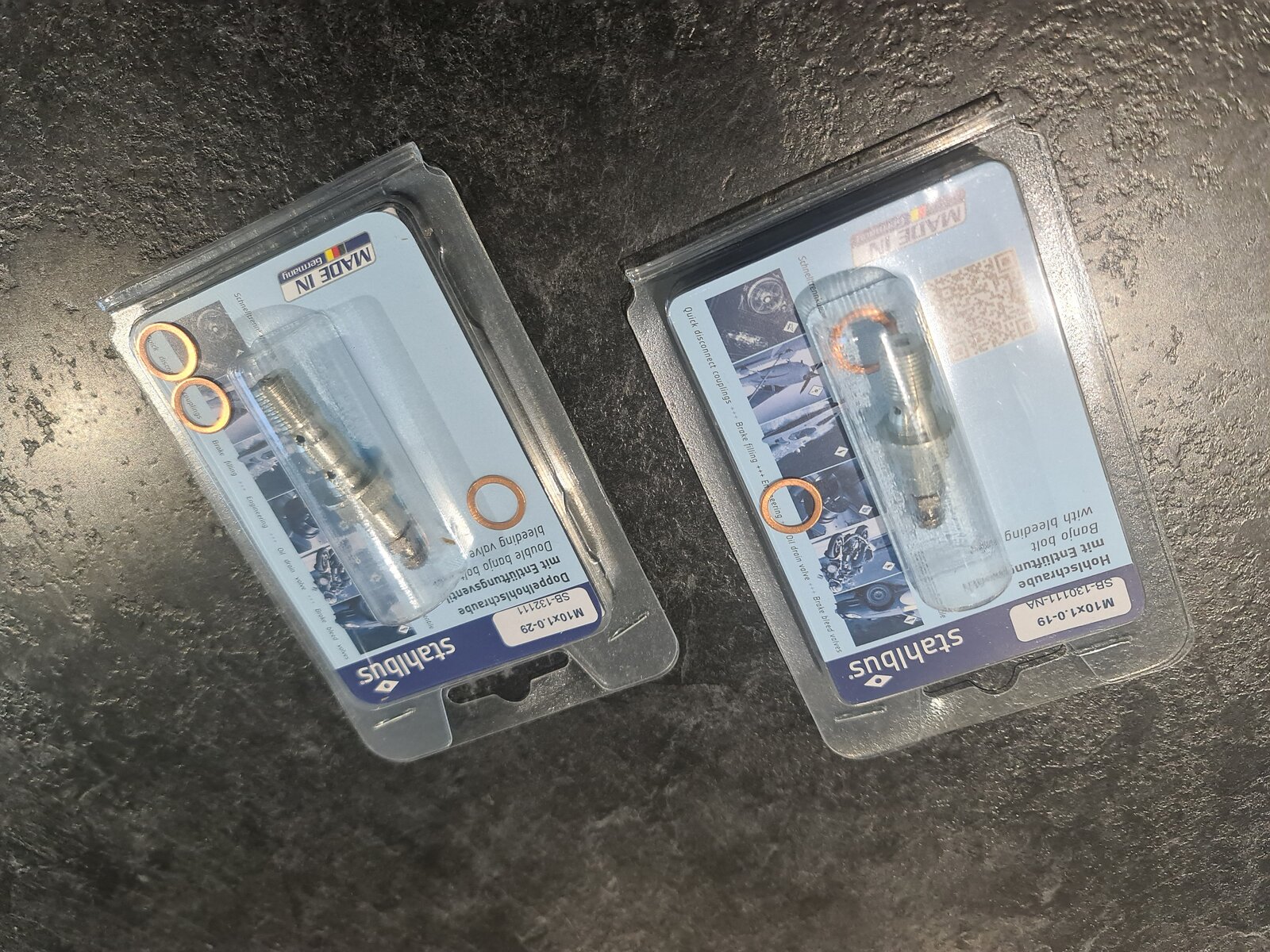

  4. Couldn't resist a small mod. Realised that placing the Stahlbus bleeders on the inside of the front calipers as per the position of the original bleed nipples is totally unnecessary and they are quite awkward to get to due to their extra length and attaching tubing for bleeding, as I discovered. To that end, I've bought single and double Stahlbus banjo bleeder bolts and will remove the current bleeders and refit the stainless bleed nipples I had on the calipers originally. Bleeding from the outer banjo points will be 10 times easier, plus a lot more clearance than the current setup, when removing calipers if you need to take off the front wheel for any reason.

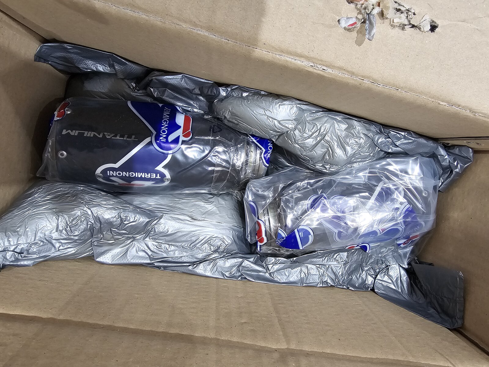

  5. After what's been a utterly miserable year for me, I decided to cheer myself up and bought something a little fruity as a side-project.
    These were "extra" and will probably make me deeply unpopular with the neighbours.

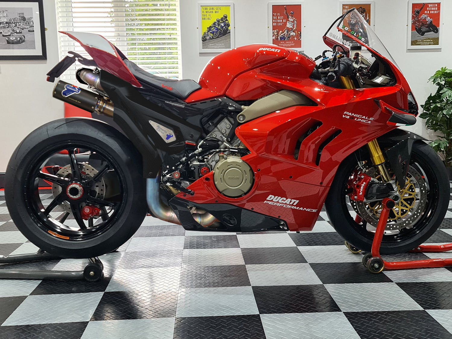

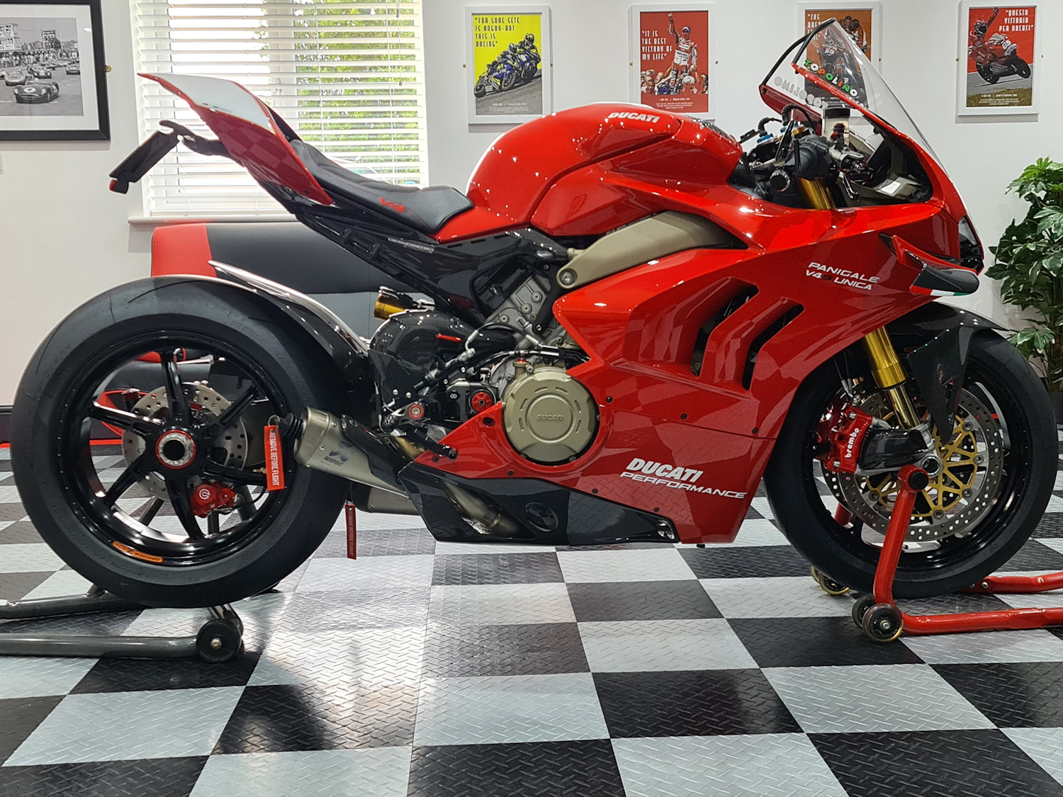

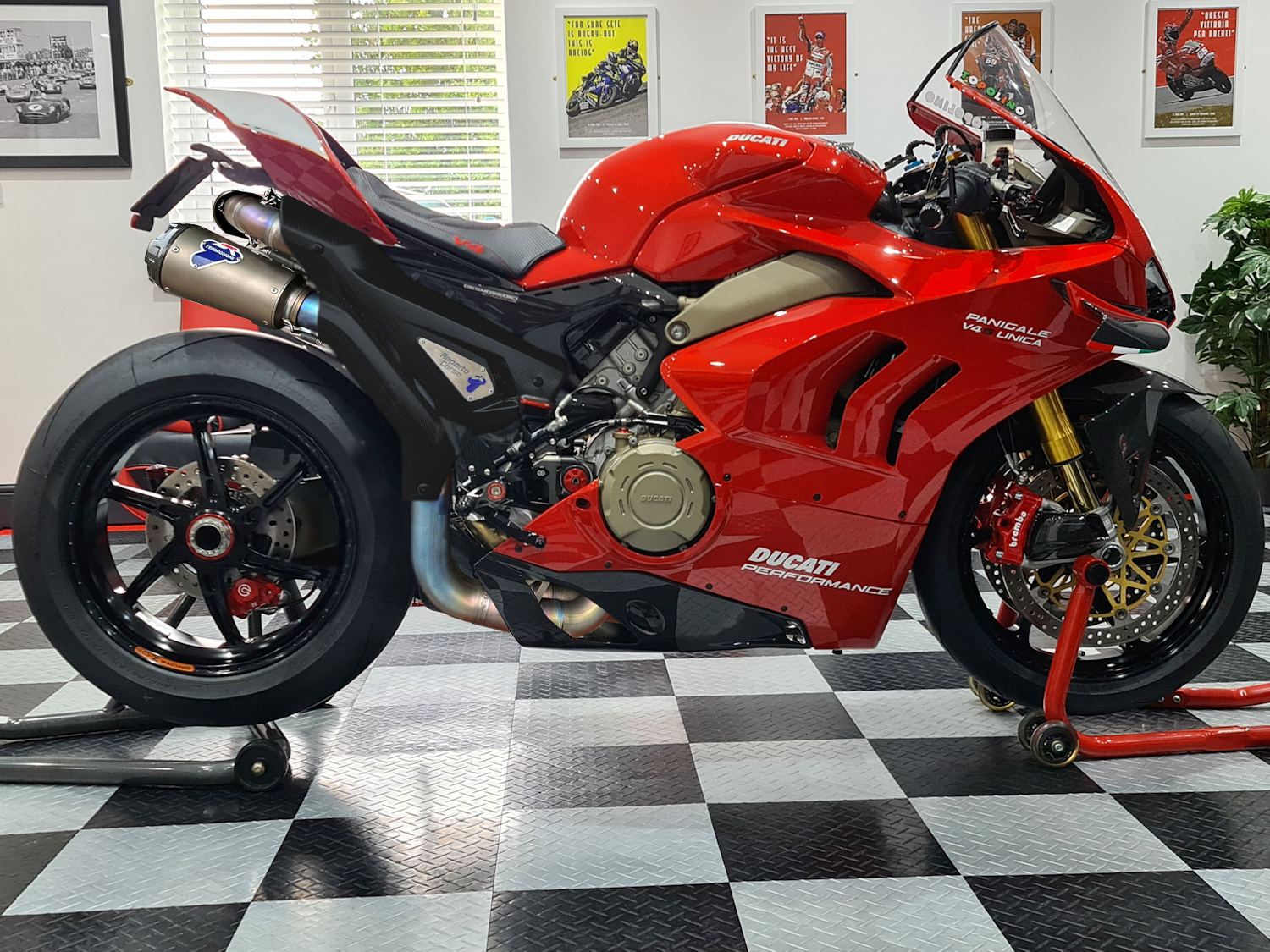

  13. Had an hour to kill this morning so mocked up the D200 system on the bike with both silencer options. Angles may be off, as I lifted the system from another image, so it's not really representative of how it would actually look fitted, but for now it just gives me an idea of what to expect. I'm leaning towards the latter option. Still trying to find a way to integrate the rear bracket with the Evotech tail tidy, so I've approached a local engineering company for some guidance.
    Current Set Up
    "Standard" Termi silencers (baffles can be removed if required)
    "Ear Bleeders"
    #493 Topolino, Mar 29, 2024
  14. Middle one for me….jeez I wish I could still ride a sports bike….beautiful!
  15. Well the bonus with the silencers is there's only 2 retaining springs holding them on, so I can always swap them over as and when I fancy a change.
  16. Is the carbon shroud really needed ? I Appreciate if you're wearing denim.. But in leathers do they get so hot it needs all that coverage ? Just think they kinda ruin the lines of the bike, and it would be nicer to show the pipework off. I know the AKRO does this too. So maybe it IS essential.
  17. You definitely wouldn't ride it without the heat shield. It's much closer to your leg than the Akra system, which sits a lot lower. I agree that the Termi system is not perhaps as elegant as the Akra system which looks a lot more compact and minimal but I still dislike the assymmetric pipes.
    #497 Topolino, Mar 29, 2024
  18. I think all 3 look great! I’m not helping am I?:D
  19. FWIW, top one for me. But they all look good...
  20. I really disliked the Akrapovic system when it first came out. But over time they’ve grown on me…
