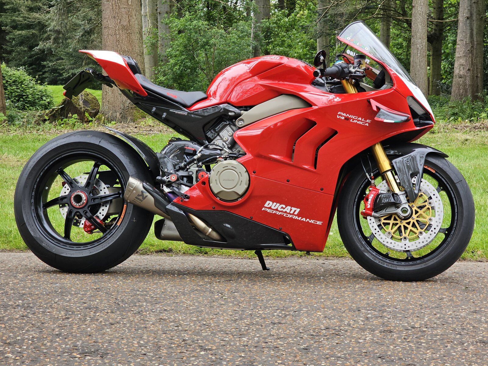

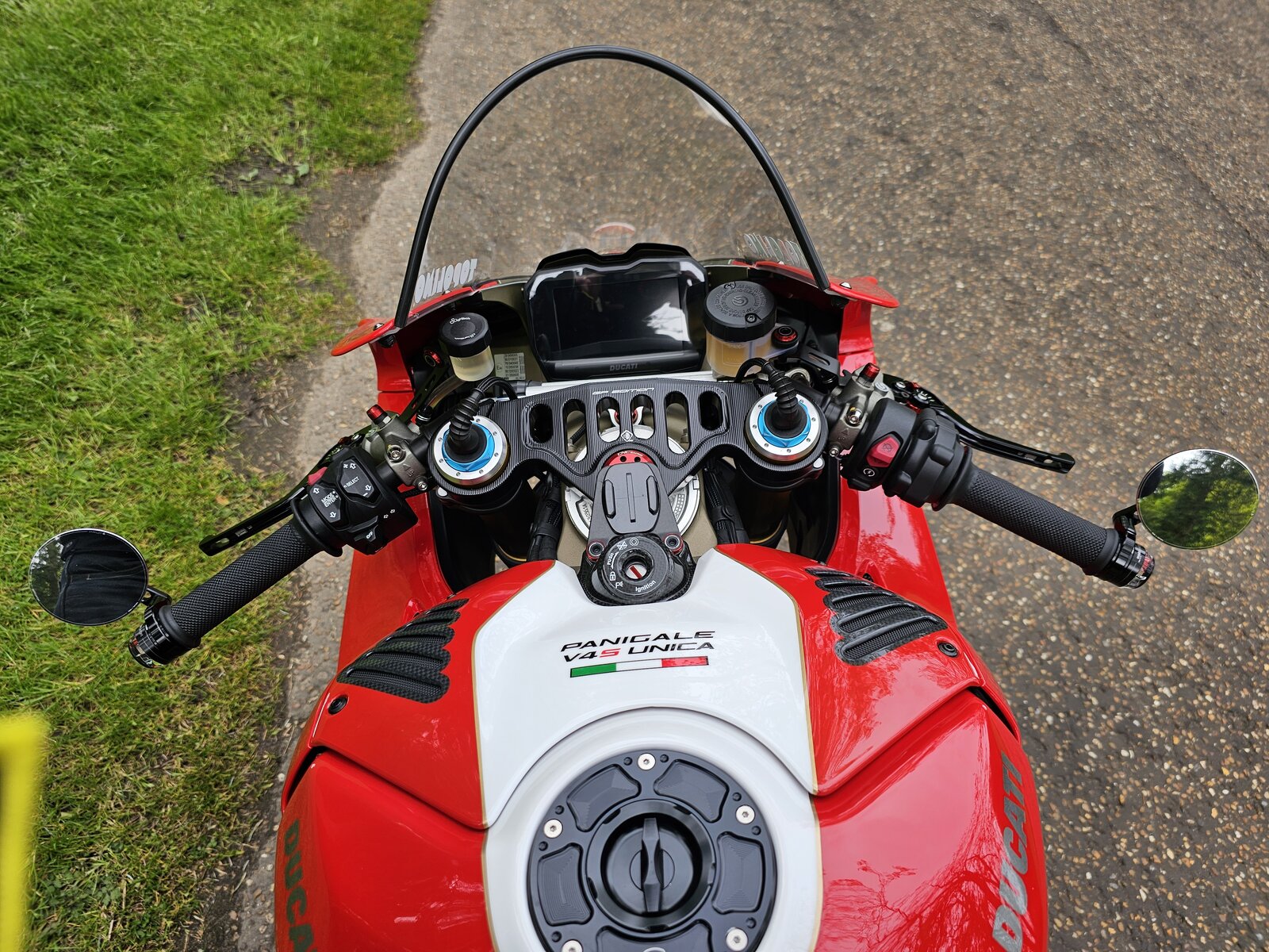

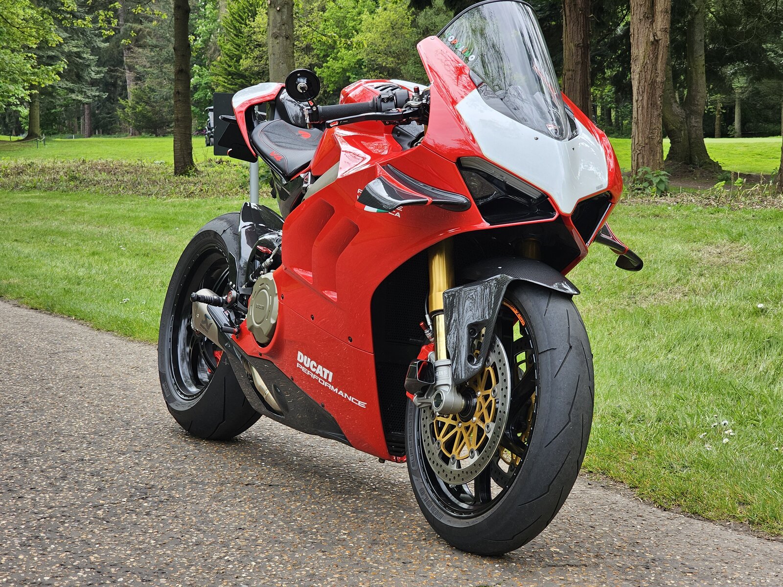

  10. Finally got around to taking some photos whilst out on a ride recently. As bizarre as it may seem, I have been thinking about the residuals on this bike, given it's age and currently very low mileage and if it would make more sense to change it for a new bike, before the resale value takes a further dive. I am looking at a new MY2024 S and have also (for pure comparison) got a test ride booked on one as well as on a Diavel V4 (just to satisfy my curiosity for a different style of bike, after 24 years of owning nothing but sports orientated models from the brand, apart from one year on a Monster S4RS). Either way I won't be looking to change (if I do) until after WDW, so that any replacement will have the work done to it over the coming Autumn/Winter. If I do end up on another Panigale, I will be transferring all the parts across to the new bike, save for the exhaust which will be sold separately (or will remain on the current bike for the new owner if desired).
    The only parts that will accompany the current bike will be all the Cerakoted parts, such as the frame, swing arm, radiator, oil cooler, clip-ons, handlebars, suspension linkages and shock mounts, footrest hangers, radiator fans bracket etc, the carbon fibre seat unit, carbon winglets, carbon lower fairings and battery cover (these last two being unobtainable any more, now that Peter Lieb has retired) and the custom bodywork and tank, everything else will be returned to standard, including the wheels. The bodywork has also been fitted with a full PPF film kit.
    Not sure what the current bike would be worth without or with the Akra system fitted but figures between 15-17K respectively, have been mooted by a couple of dealers. Naturally I could just sell it as is, but I would unsurprisingly lose way too much on the parts fitted, of which there are a lot, unless I was to receive a sensible offer.
