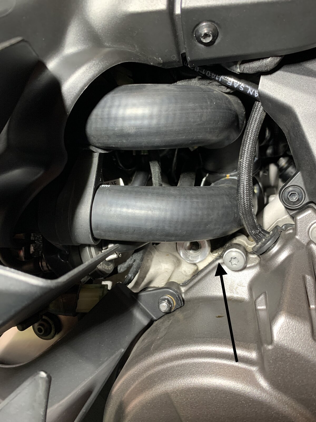

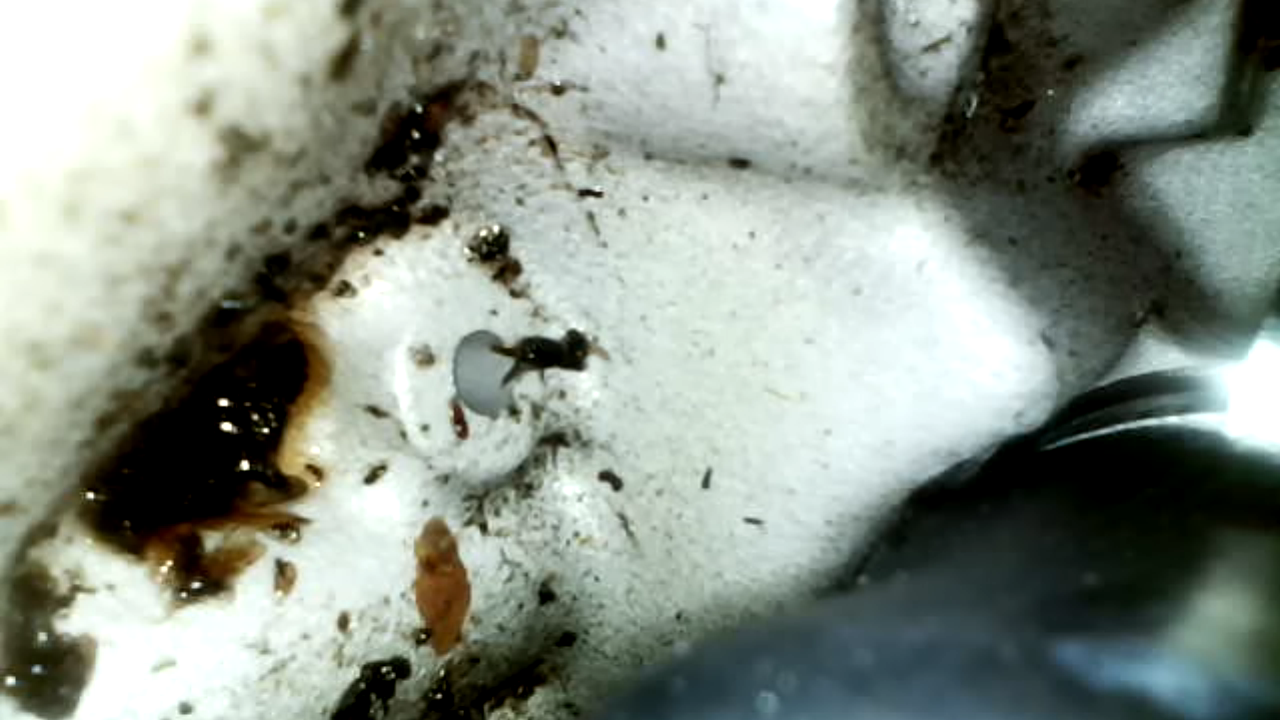

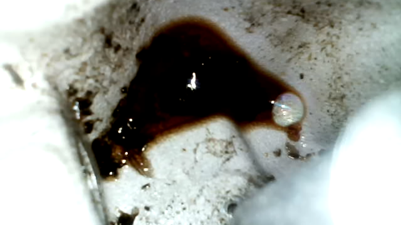

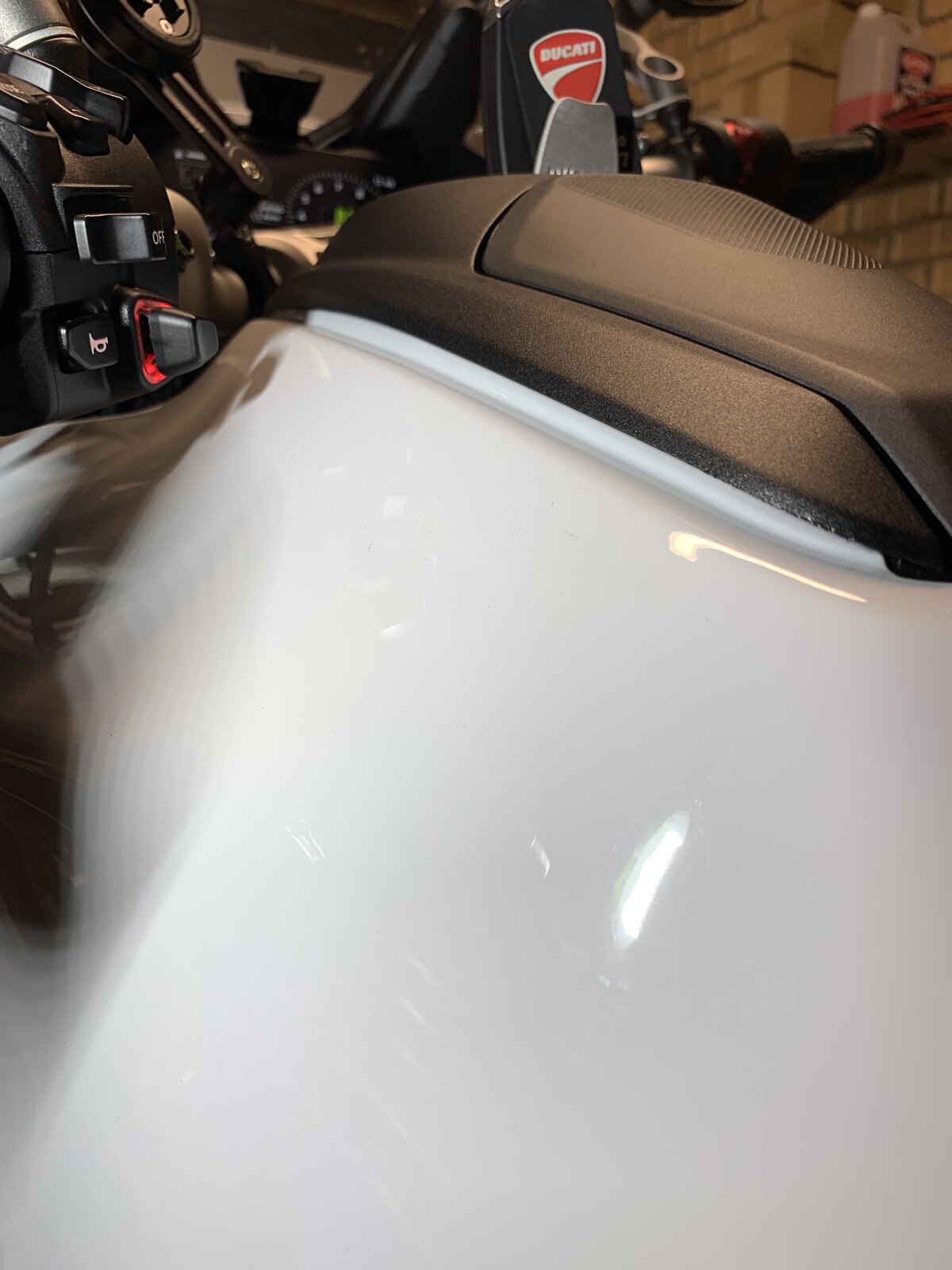

  10. Just been reading this thread. This is what I found on my 2 month old 3300 mile V4S Multi yesterday. Noticed a small weep on the LH engine cover (had this before on my V4 Streetfighter and it turned out to be water pump) further investigation with my bore scope revealed oil and debris in the "V" between the cylinders, it only came back on Friday after spending 2 weeks at the dealers trying to get the evap canister / tank breather sorted (after it blew fuel out of the fuel cap riding back from Italy) and the poorly fitting tank panels / fuel cap panel which happened during World Ducati Week trip. Not a happy bunny at the moment. 42532F2D-5B73-4236-A28D-16553EEF6103.jpeg 805C8FC4-CAE7-4545-99CD-4289867BB021.png 2DAFCA61-51EC-4054-80A1-6054BAAC0FFC.png 4AFB6410-DDB0-48D9-9FFD-8F1FE0D398DE_1_201_a.jpeg

  17. Just wanted to let people know that I've had this oil leak from my V4PP. Seems it's rare, but it's definitely a thing. Dealer has done 3 or 4 others with this (across all V4 engines I think, not MTS only). It also seems like Ducati know what this is as rather than throwing the kitchen sink at it like they did with @Gothrick above, it was straight away identified as the water pump and an issue with the seal/liquid gaskets used on the pump and also something within the pump. My leak's location looked exactly like @Edward Hitler above.
    First thing I noticed is that the bike went from using no oil to suddenly needing a topup. Anyway, hopefully have the bike back soon and that's the end of it.
