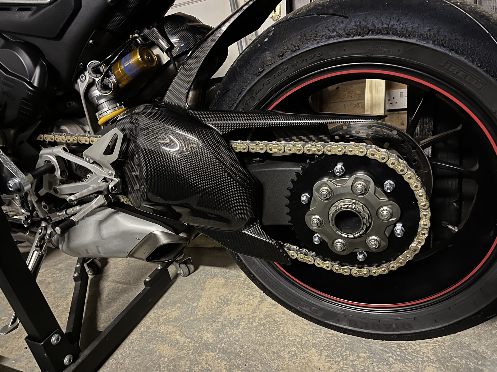

  8. Now the weather is looking up it’s time to get a few jobs done and the bike ready to go again. So this week I’ve been fitted a new chain and sprockets, +2 on the rear for a little bit more go so I can avoid first gear on slower corners.
    Next up the bike will be built back up to road spec. I’m going to risk it on track so I can use it for a few summer rides and enjoy it a little more.

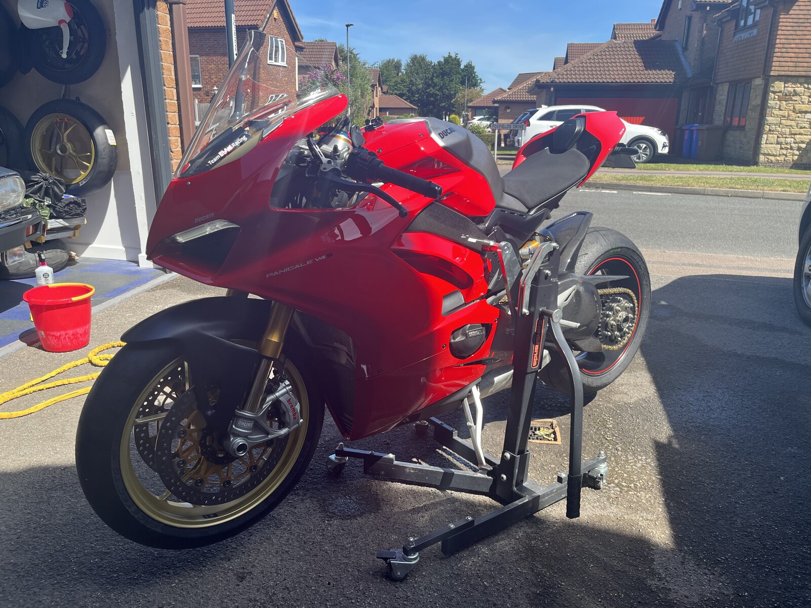

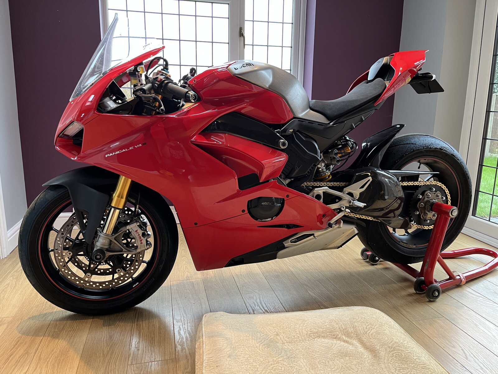

  13. A few hours and back to looking pretty again. I’ll tax it from 1st March and looking forward to going out on it again!
    Got 7 trackdays booked so far this year, can’t wait to give the new gearing a run out and see how it feels.

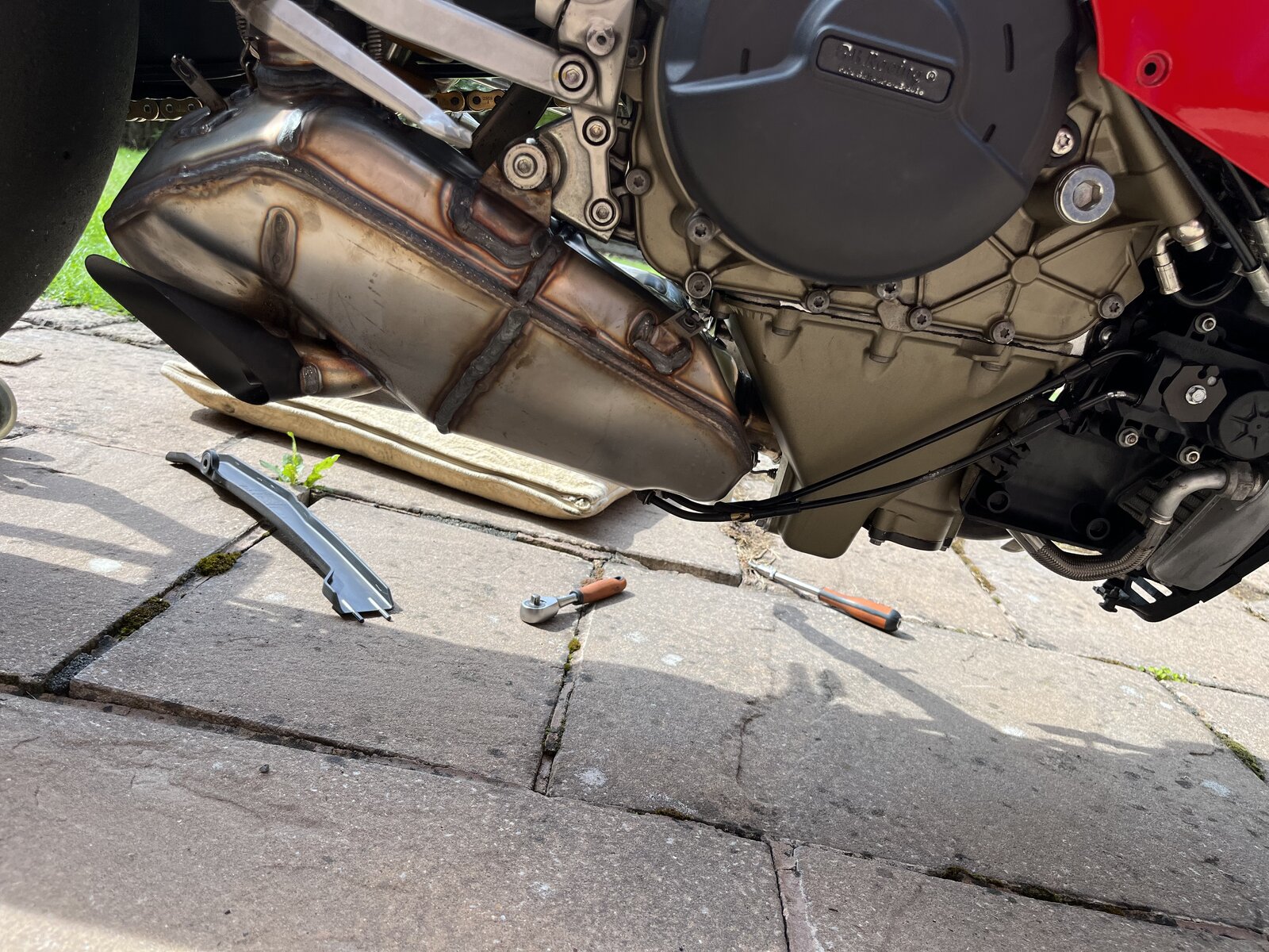

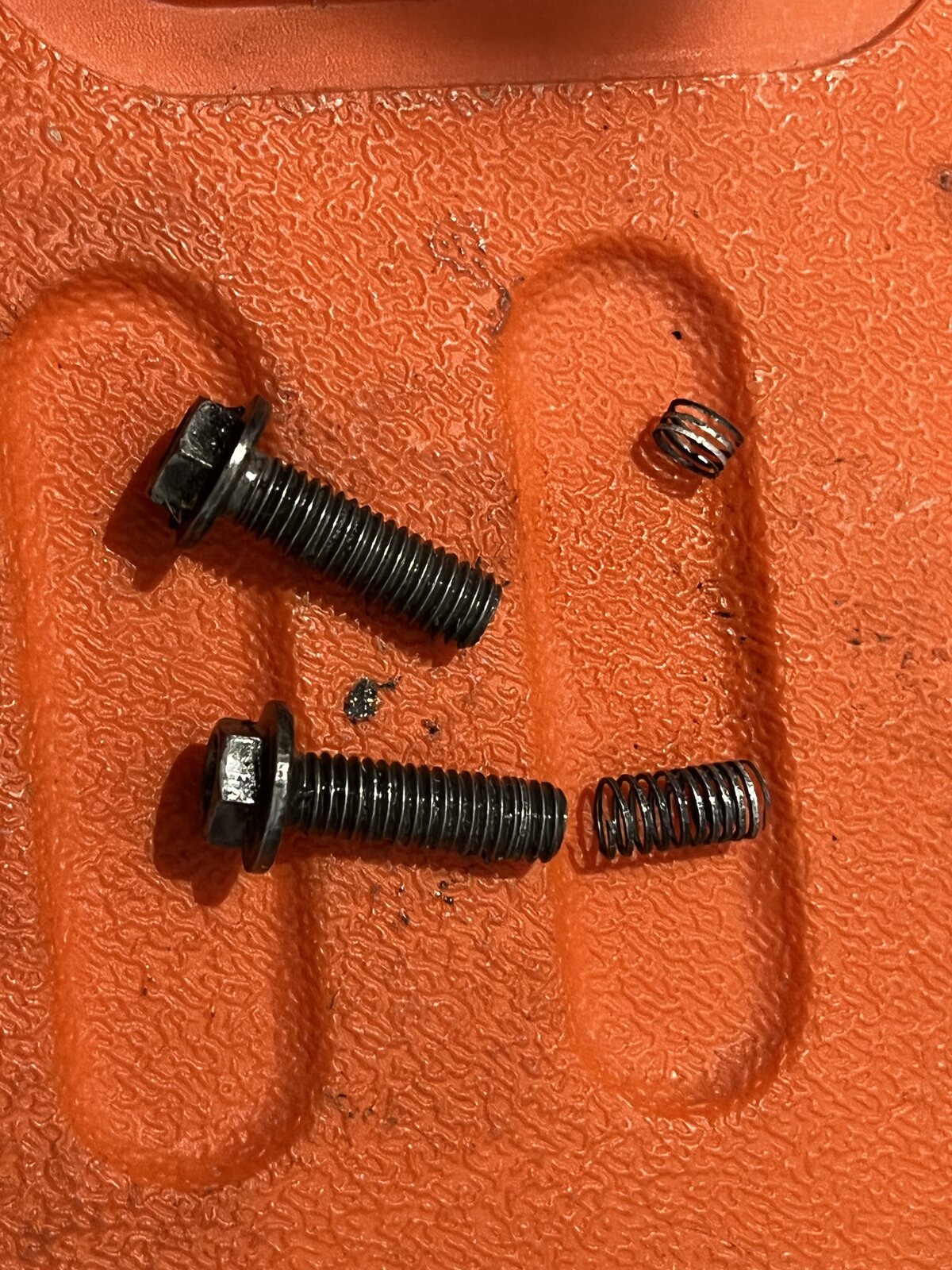

  16. So I dropped the oil last Friday and the sump threads decided to come out too, smashing.
    Bike went back into Cornerspeed for what turned out to be a new sump and new exhaust as the welds had blown along with the valve on the bottom.
    Gave it a good clean up today, new pads, new front slick and general check over to make sure it’s all ready for Portimao in a few weeks.
    I’ll sort the old sump out and keep as a spare, I guess it needs to be treated as a consumable when there’s so many oil changes being done so I’ll probably swap them out every 2 years now.

  17. That looks like a Helicoil insert that has come out?
    Had to Helicoil the dry sump on a KTM 990 I once had, right faff on!
    Either way I would Helicoil your old sump, the steel Helicoil shouldn’t strip out again and it’ll be stronger than the original alloy.
  18. I thought helicoil first but it’s not, the complete thread has sheared off.
    Yep will helicoil the old one, or timesert. Such a shit design from Ducati, but in fairness I’ve done more oil changes than a road bike would have in about 15 years.
  19. I think they’re the filter bolts, right? The torque setting on those is ~9nm IIRC. Which is fuck all. Just by tapping the the sump wall with a fingernail gives me a sense of tinfoil thickness. It’s all rather fragile down there… o_O Be careful kids…

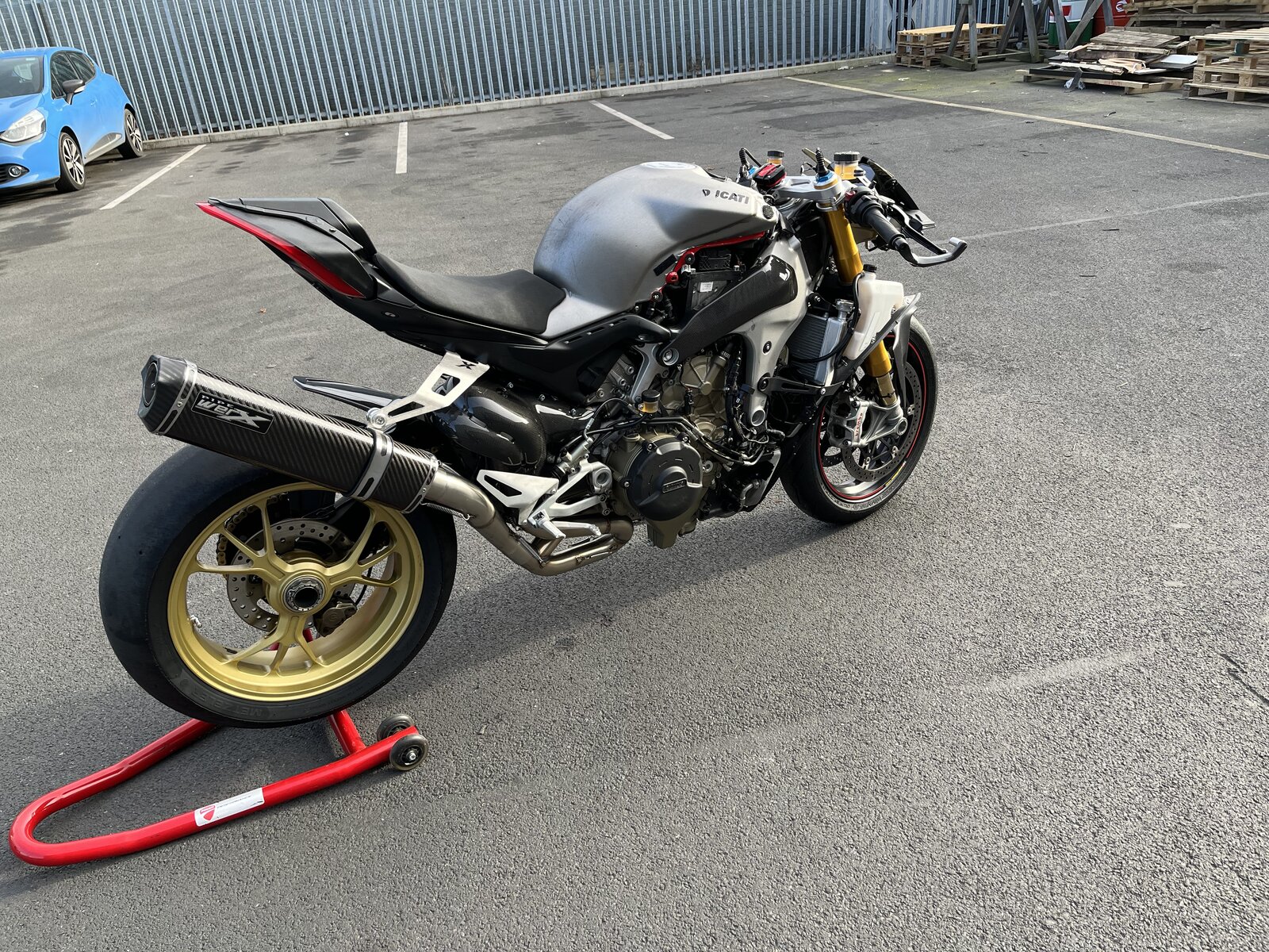

  20. So another year and a bit more money spent on the bike. After using it on the road once all last year I decided it will go back to the CRC fairings and be truly relegated to track only.

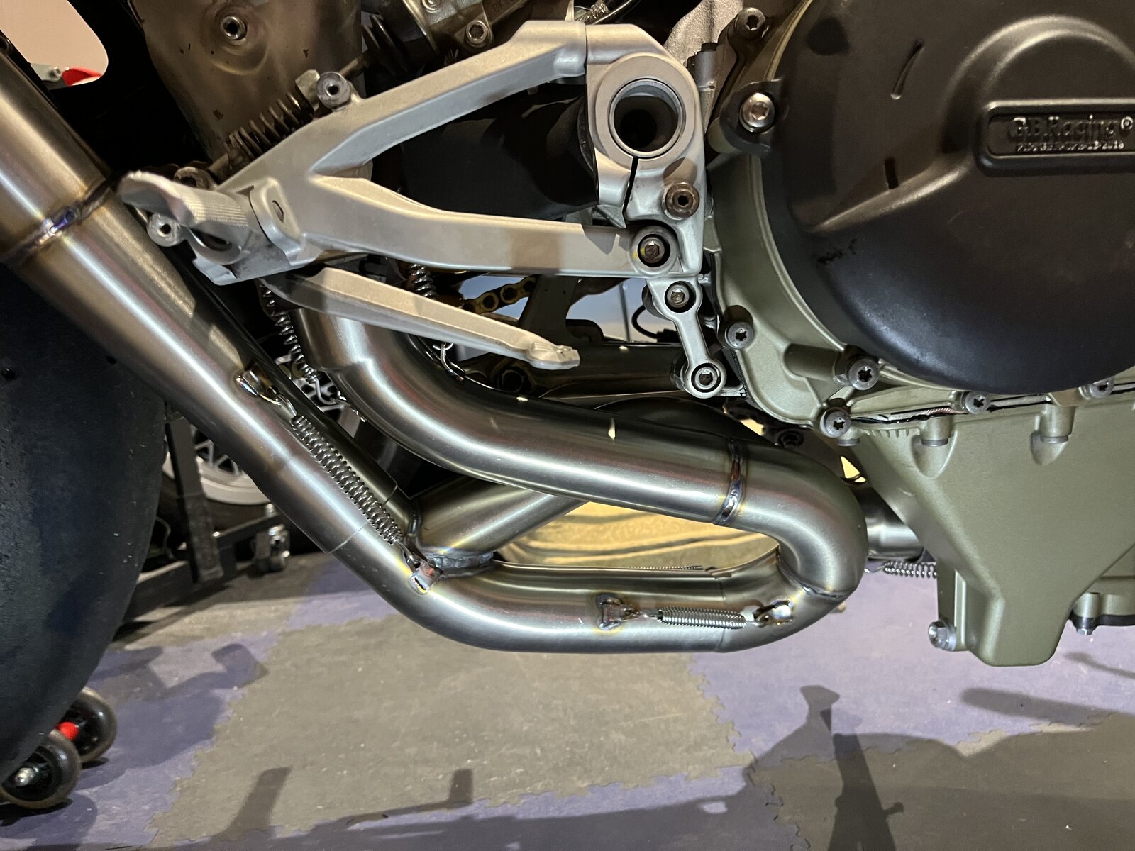

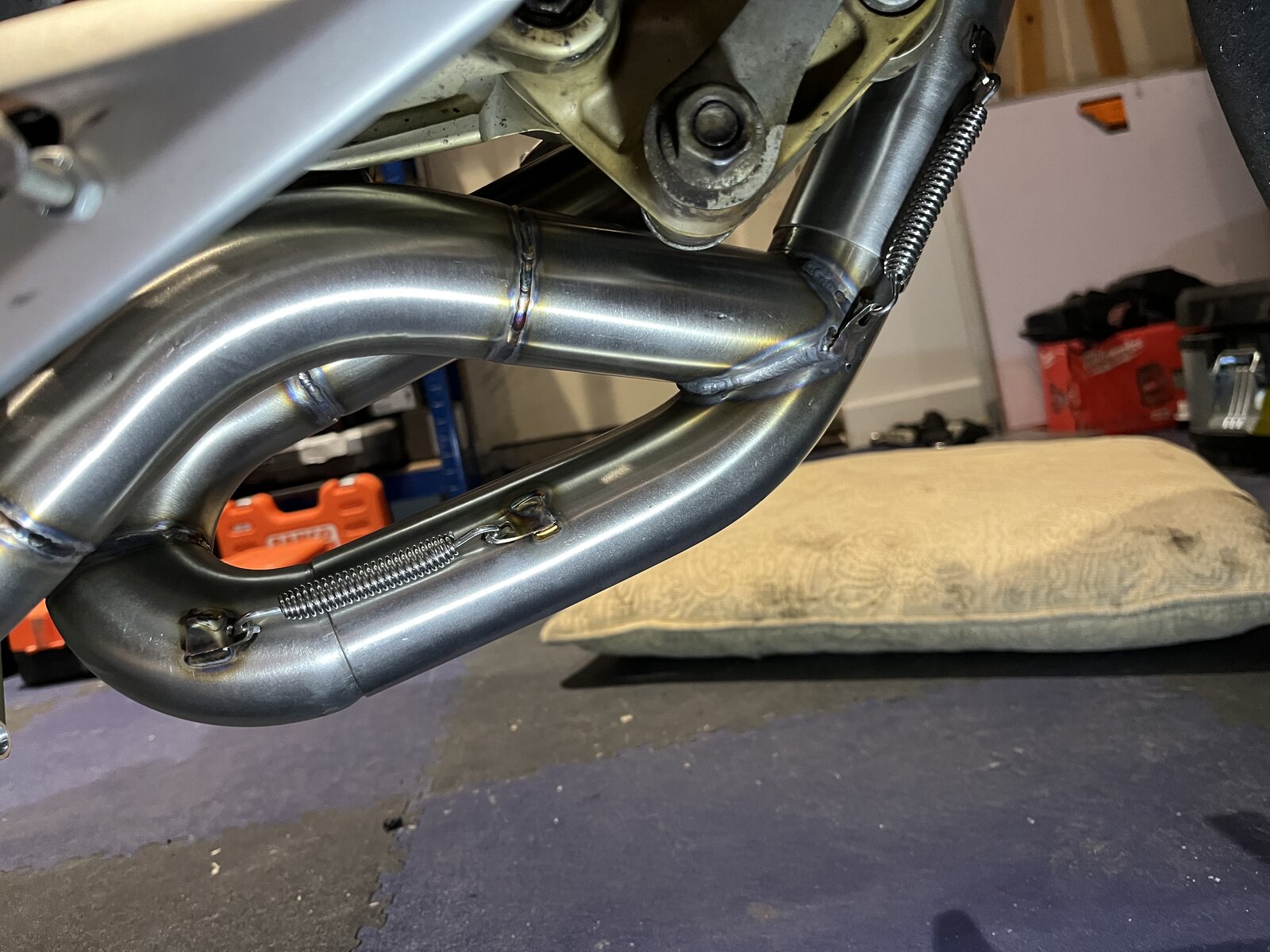

    Bought a Pipewerx half system with the longest can possible for quietness which will be more than good enough for Uk tracks, then I’ll treat myself to a stubbier one for when I can get away with a bit more noise. Gave it a good run today to bed in and I’m happy with it. 4.7kg saving from the standard lump of pig iron and according to their dynos should be +11bhp from around 8k onwards which will be nice.
    Im well aware it looks a bit silly in the photos but not quite as bad in person, but either way form over function works for me.
    Dropping it to see Nelly next weekend for a coolant and brake fluid change, and a quick look at a small oil leak from the sump then it’s all set to trundle out to Almeria for 4 days in March. Can’t wait.
