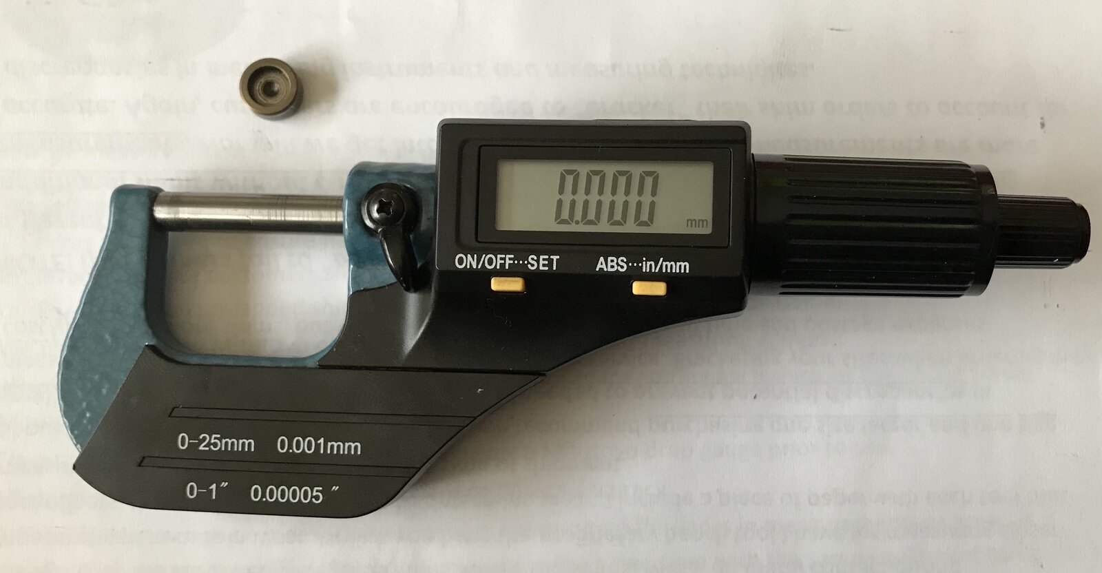

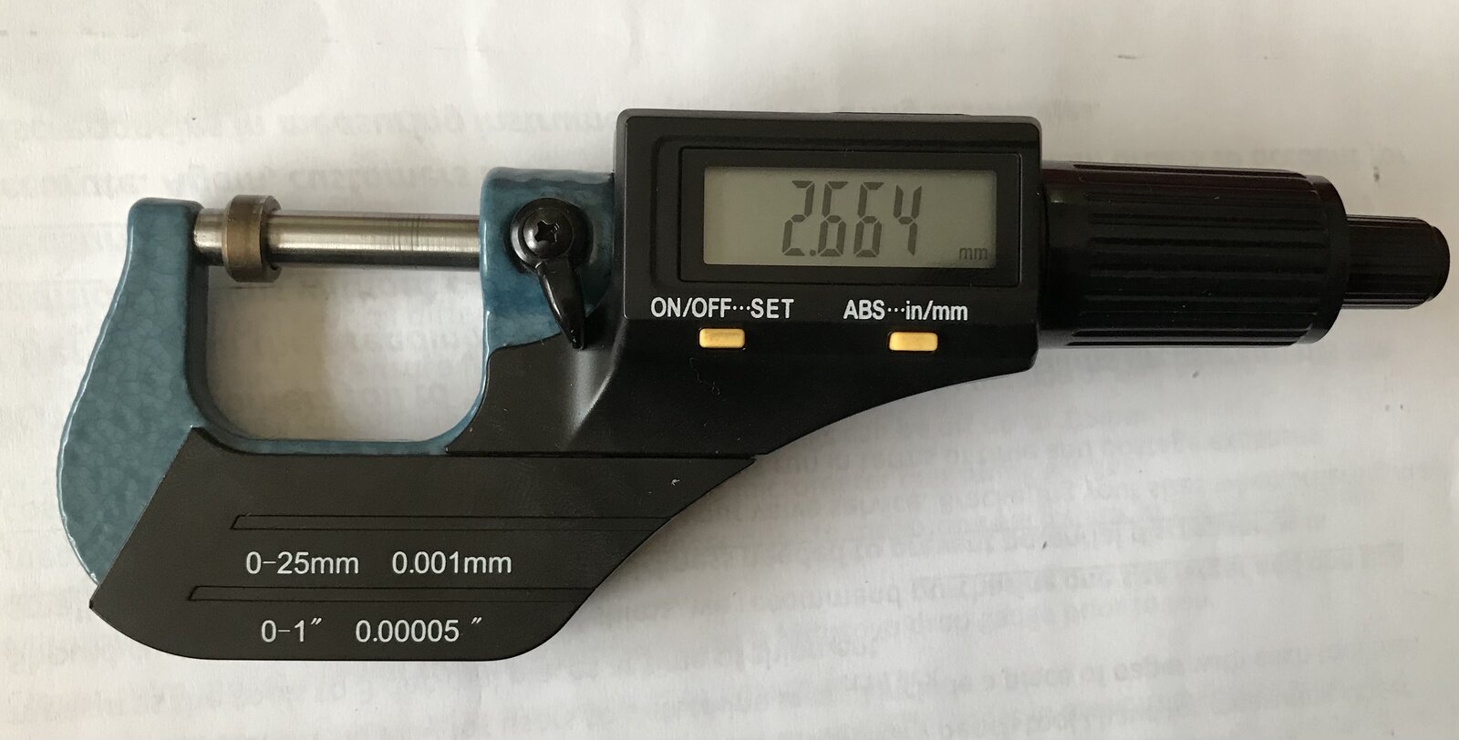

    Zero-in your tool.
    And measure a dry/clean shim. This one was out out the 2.65mm box, so only 0.014 off. Not bad at all.

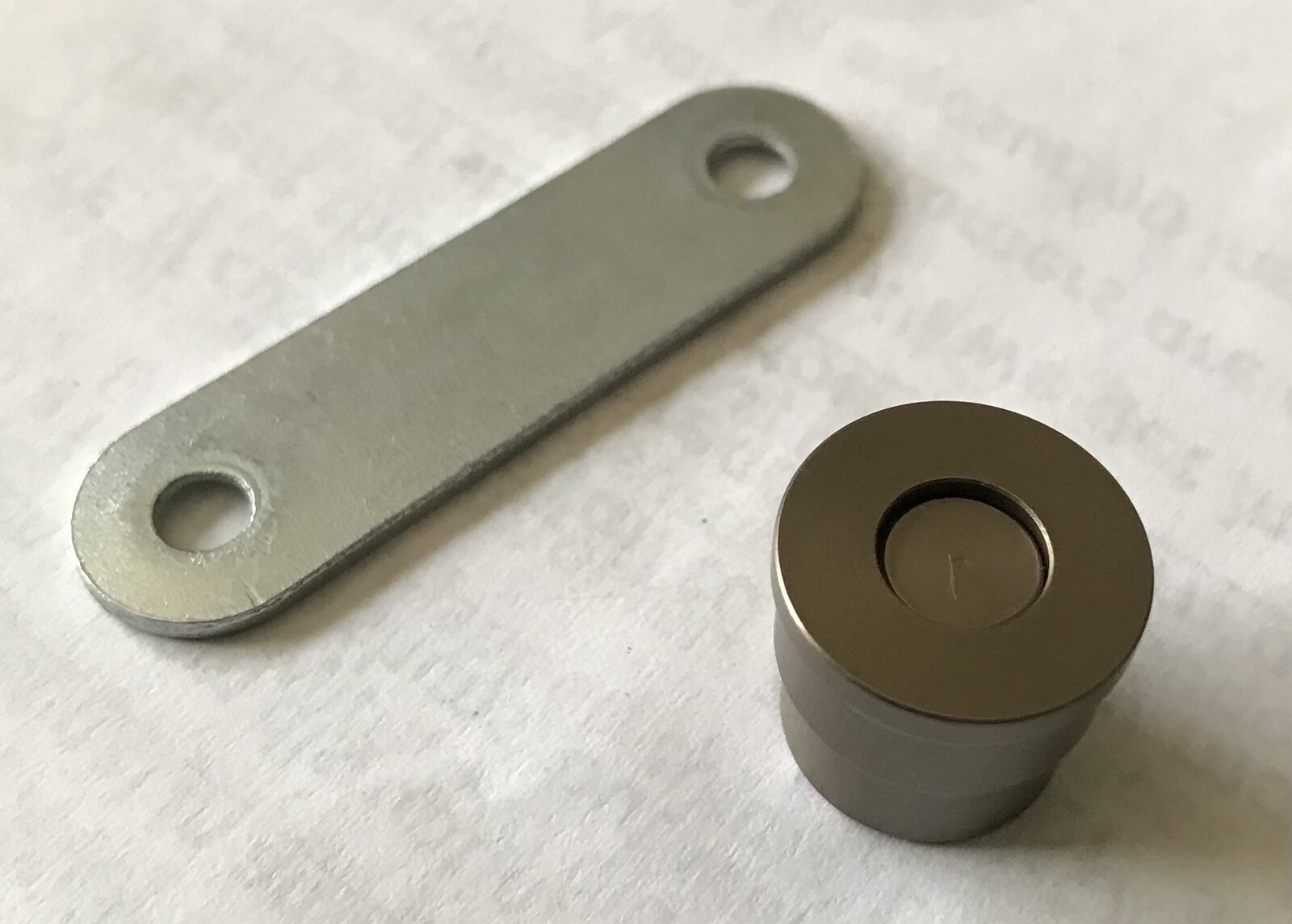

    Closers are hollow. And lay on half rings located somewhere on the valve stem. Measuring them to get the clearance you need/want is a little trickier.

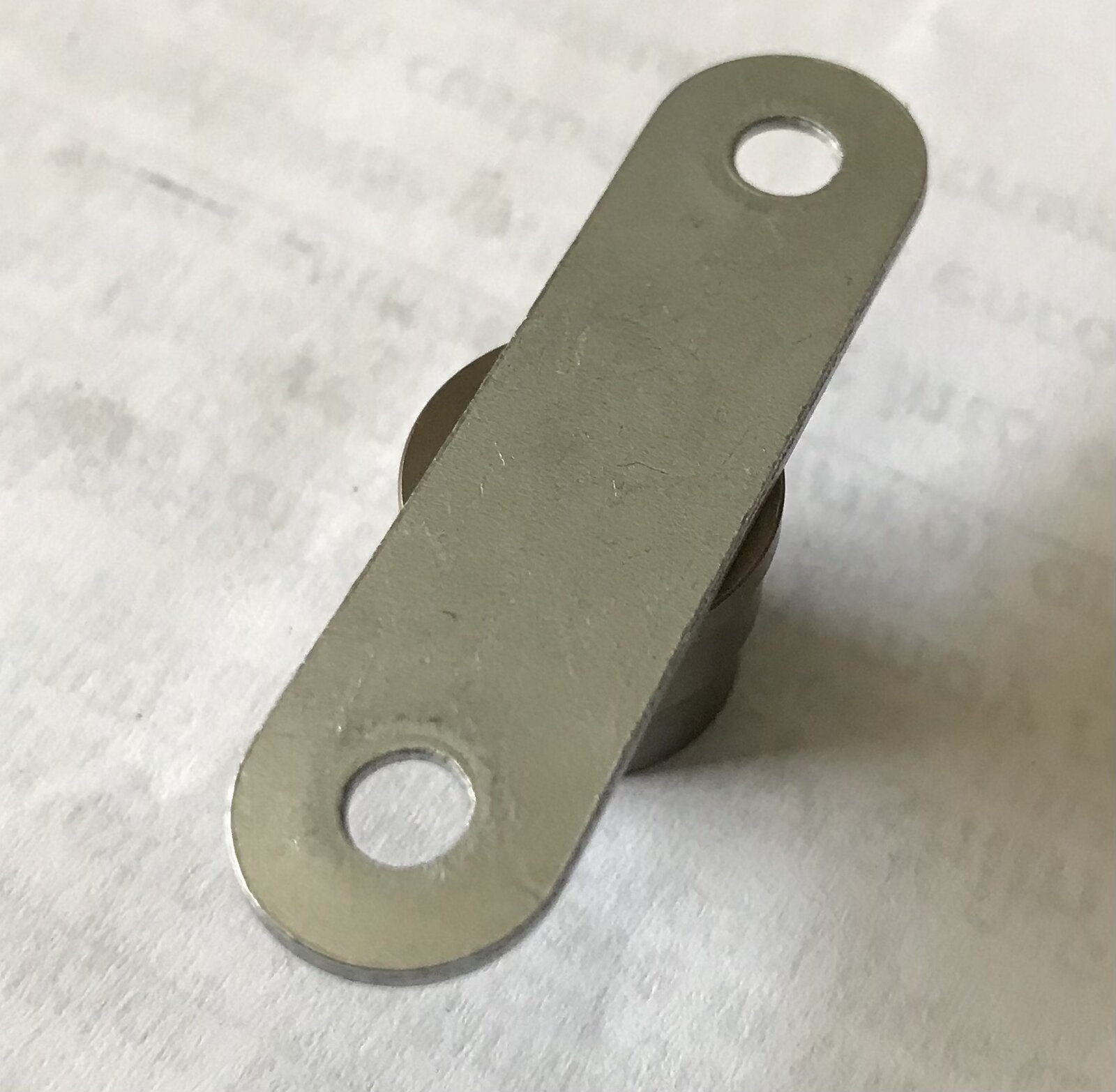

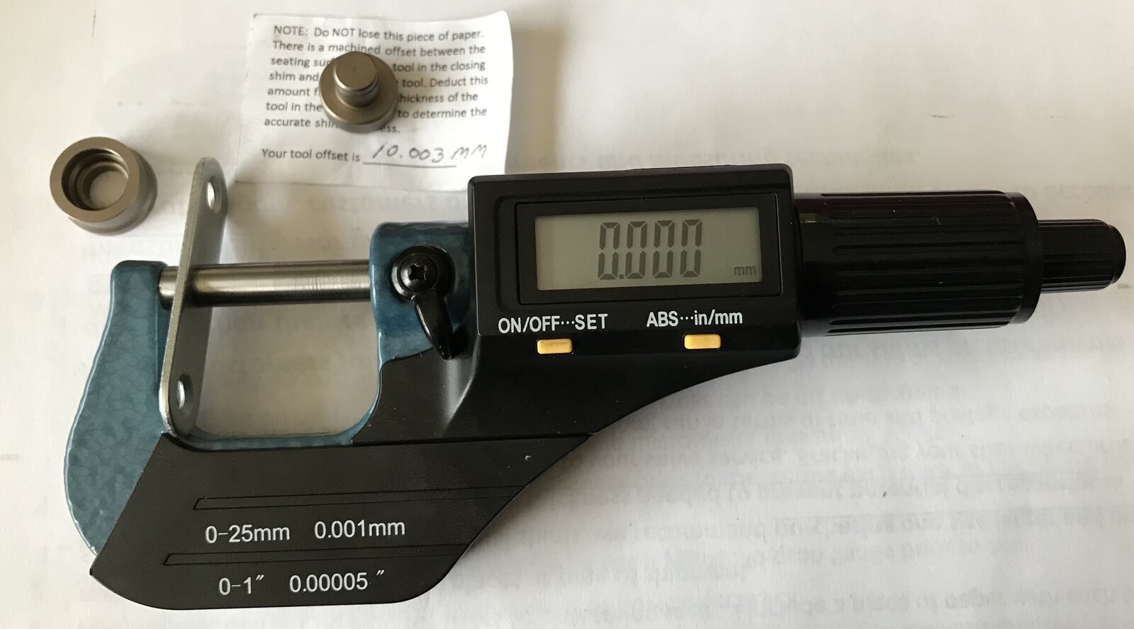

    First, you need a piece of flat metal to solve the « hollowness » problem when using a micrometer. Zero-in the micrometer on it. 1st problem solved. 0560FAF2-CA54-43B8-87FC-967E21C3C71E.jpeg F2ABF313-6CDB-43AE-A97B-E774CFBAAE86.jpeg 9F54101C-6539-4F22-B0A4-25B712689808.jpeg

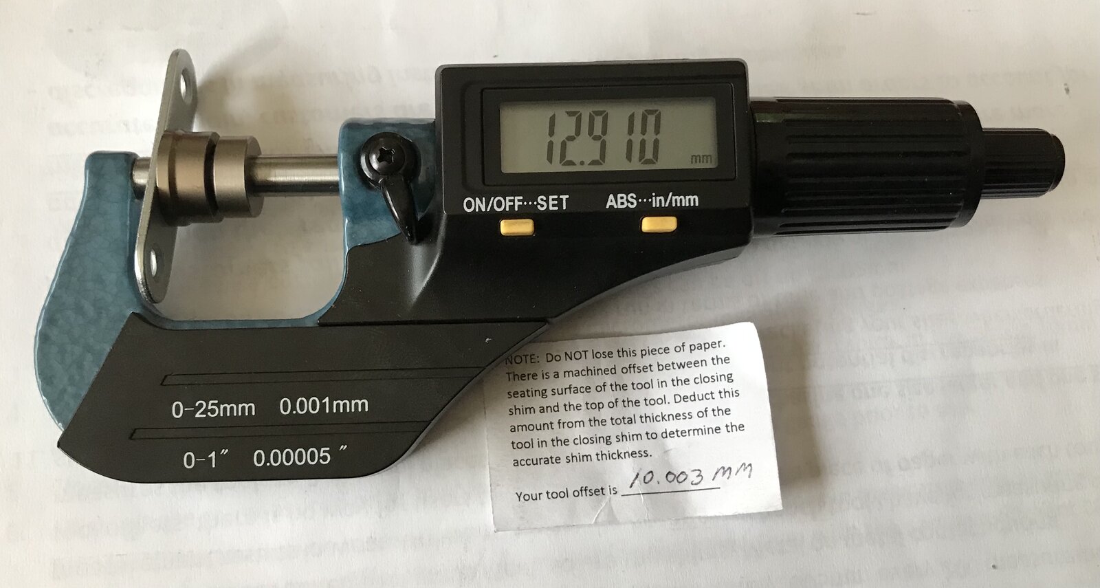

    Then you need a « measuring tool » which offset is known (and certified) to the 1/1000th of millimeter (we’re talking micrometers now…) to measure only from the half ring groove inside the closer. That tool replicates your valve stem with the half-rings in. This is how you use it. AFF68538-27F4-4377-9DE9-8AD531E23C41.jpeg
    This shim is measured at 12.910-10.003 = 2.907mm. I call it a 2.91. And it’s coming out of the 2.95mm closer box. That’s 0.04mm off, which is a lot. In the end that’s the difference between a 0.10 and 0.06 closing valve clearance, for example.
