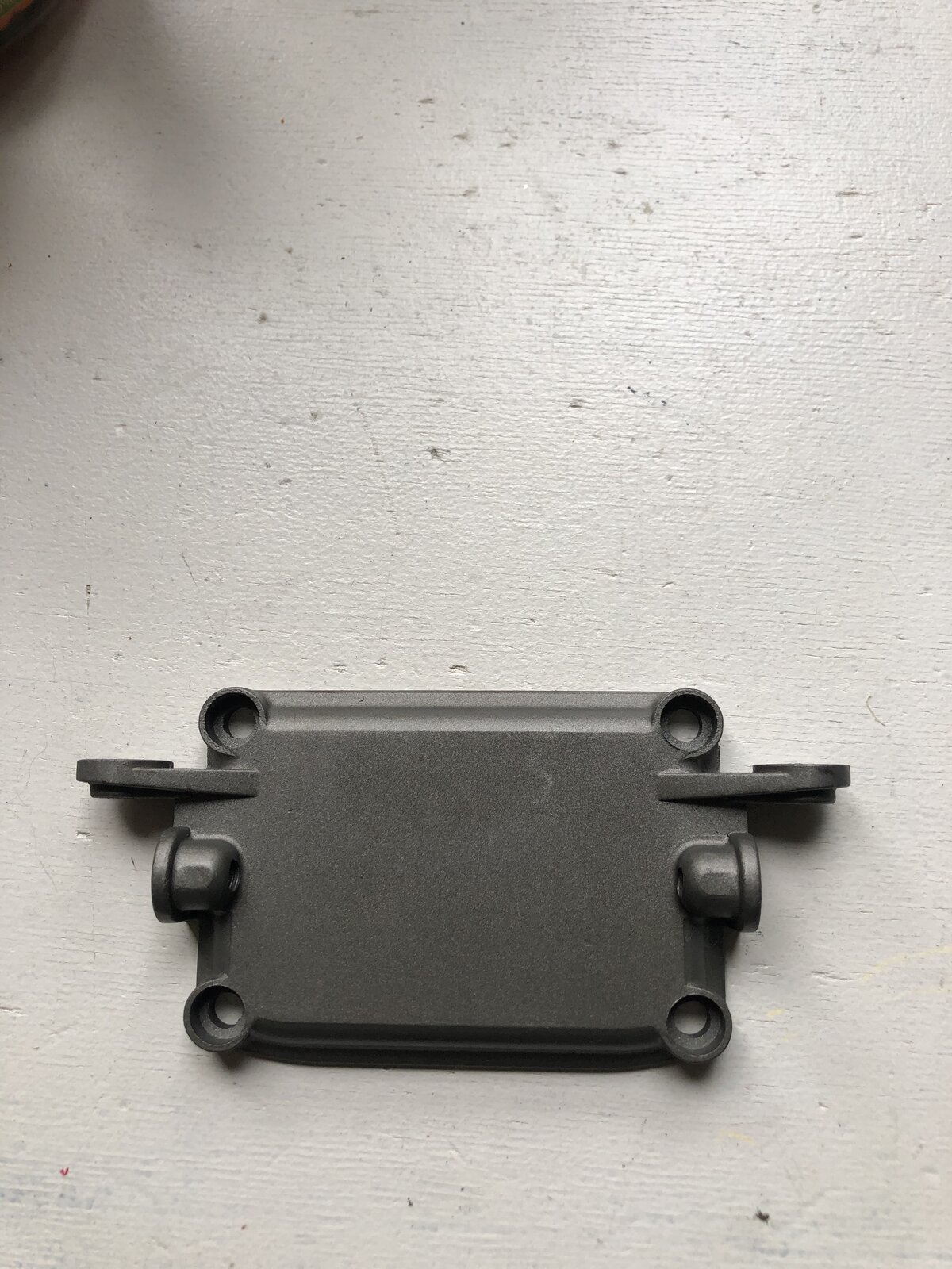

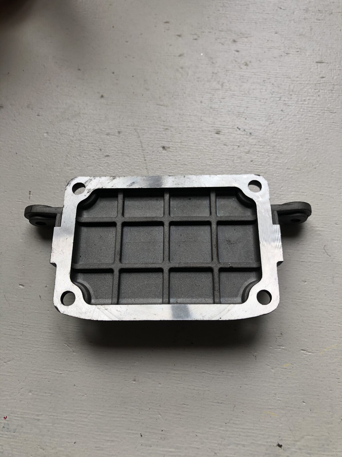

  15. Ok I bought it in the under standing it’s a 748R part. Never needed because they replaced it with maintenance. But again show me how a 748R one looks like.....

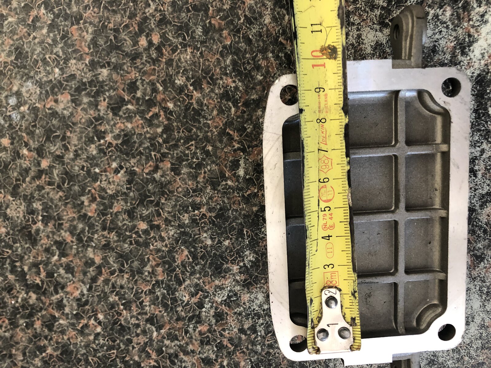

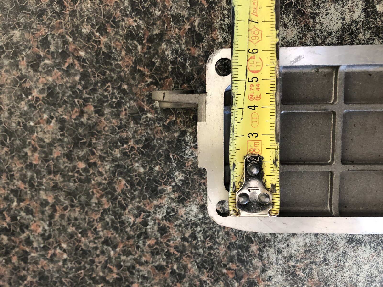

  16. Nick,
    I don't have a picture of the 748R cover but I had my friend (where my bike is at the moment) take a look at the dimensions for the cover. The holes in the inspection cover (exhaust) should measure approx. 90 mm apart (width) and 45 mm (hight). I think you should be able to check your cover with these numbers
  17. Here you go. 55 and 90.
    cheers

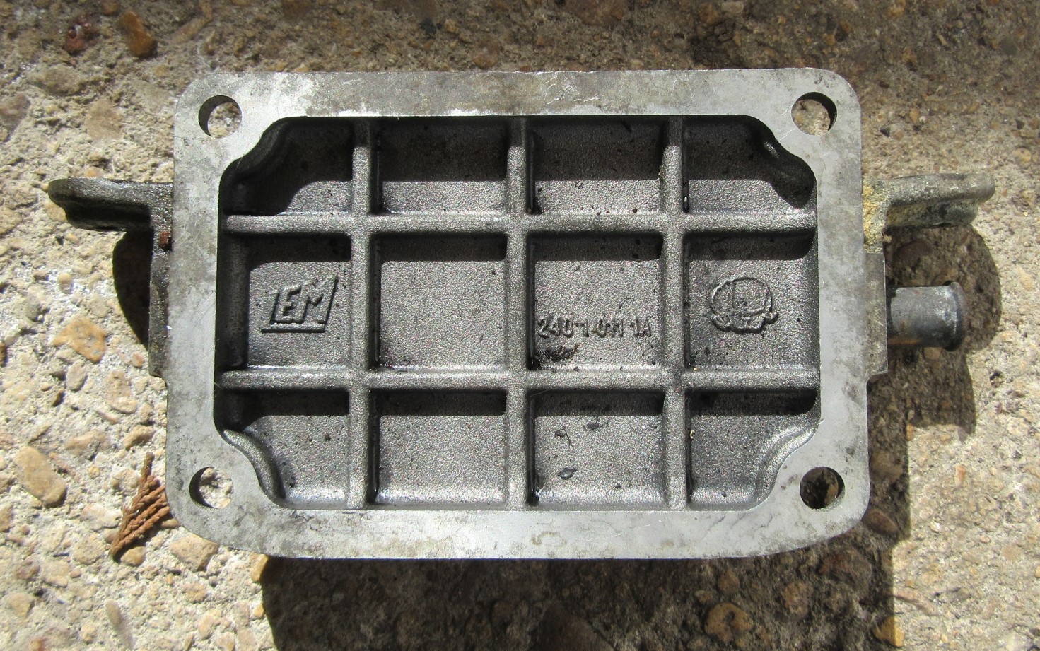

  18. If it helps here is an earlier style Cagiva one with part number visible which I don't think is the one you want, your part number ending 015AA looks correct for the later ones, not sure the ones in Nick's pics are the ones you need IMG_0003 (2).JPG
  19. Hi Nick, Steve, Denzil,
    I think Steve was right on the money when he looked at the pictures of Nick's cover.
    The needed part for the 748R head has the same width but less hight (45 mm in stead of 55).
    Nick, no use sending me this part as it won't fit my head. Thanks for the offer though.

  20. Without any measuring of the covers that Denzil and Mark have posted, I can tell/see that those covers are for a 916 because of the position of the mounts for the oil cooler.
    It probably helps that I've got both 916 and 748R covers sitting here in front of me.
