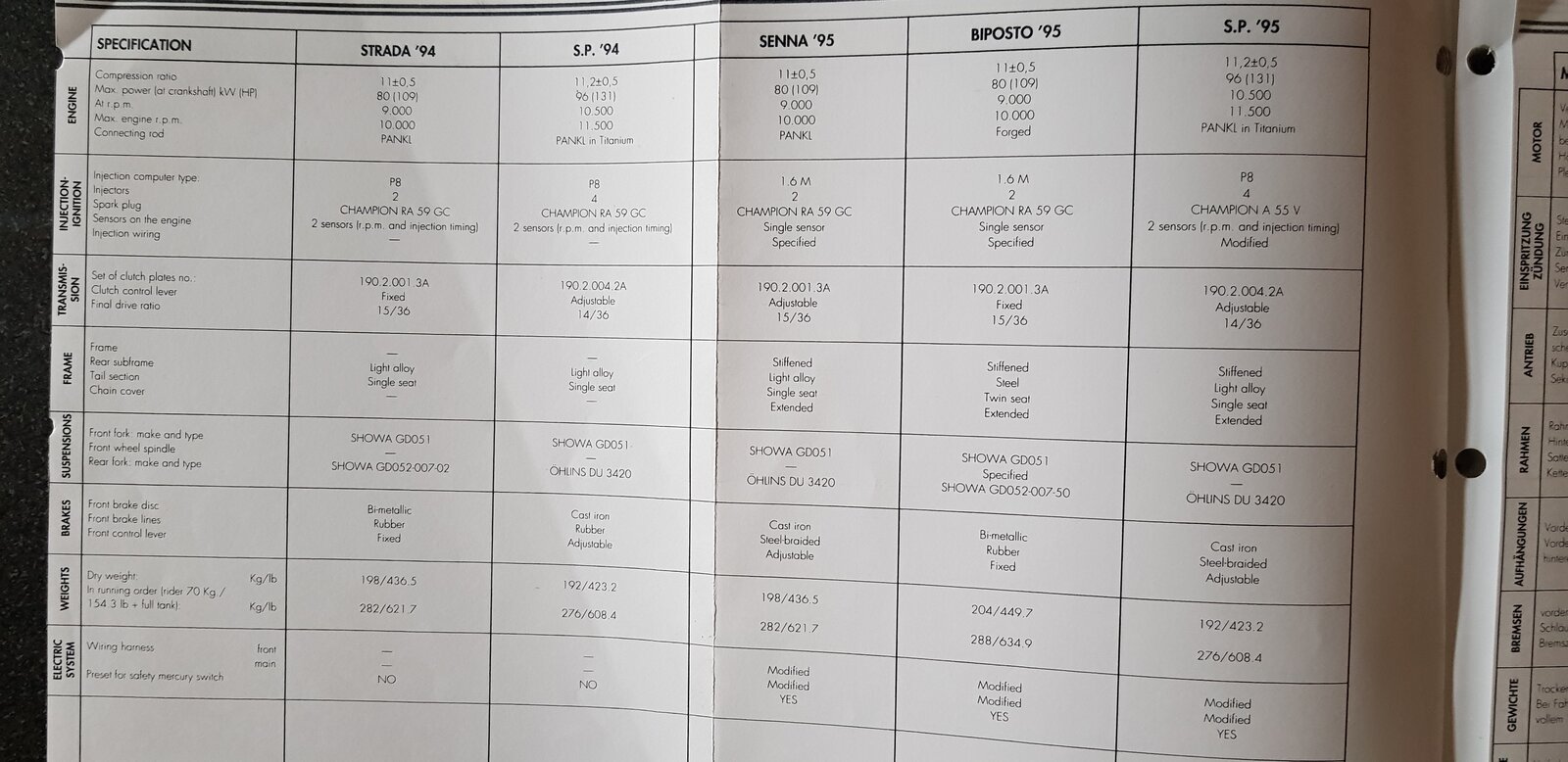

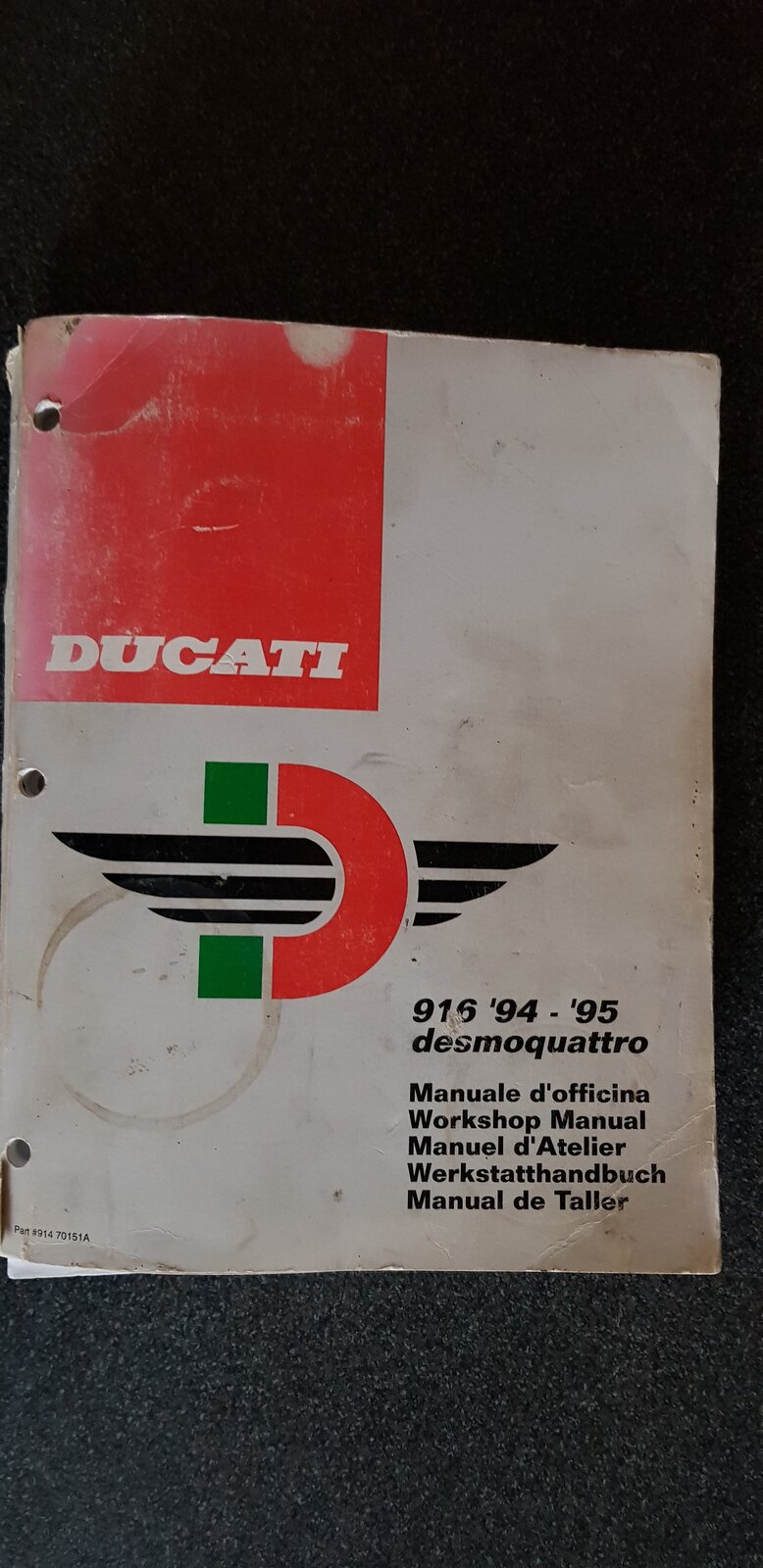

  16. This is a great post because I'm under the impression that some 916 production restarted back at the Bologna plant in August 1994 (told to me by a bloke who is looking at starting his own Ducati 916 vintage race team and has factory connections).
    Part of the Varese story is the P8 ECU, Pankl rods and fairing rivets fitted to early bikes, and going by my 94-95 Ducati workshop manual we can see the 95 Biposto (made in Bologna and Varese ?) was not fitted with either, thus alluding to the fact only Varese mono bikes had these parts.
    If anyone has the Official Ducati 916 Workshop Manual for the 96-97 bikes showing what ECU's and con rods were fitted it should give us an idea if this is true. If P8 ECU's and Pankl rods were fitted to the Bologna mono bikes then the only real difference between Varese and Bologna 916's may be the fairing rivets on the very first bikes off the production line at Varese.
