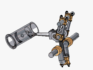

  1. I would guess that there are some efficiency gains to be made with this design in extracting more energy from the expanding gasses.
    Ever heard of a triple expansion internal combustion engine ?
  2. Indeed, a longer expansion stroke enables efficiency gains to be made. Another way of doing it is to keep the inlet valve open until part way up the compression stroke, so that the effective compression ratio is less than the geometric ratio; the power stroke uses the full length. Some engines in current production actually use this approach.
    Double or triple expansion is essential in a steam engine to obtain reasonable efficiency, but difficult to arrange in an internal combustion engine. The hot, high-pressure gases would tend to lose much of their energy in the process of transferring them from the small cylinder to the large one. A better idea is to extract the residual energy in the exhaust gases by means of a turbocharger. Many designs for doing this exist, including current Formula 1 car engines.
