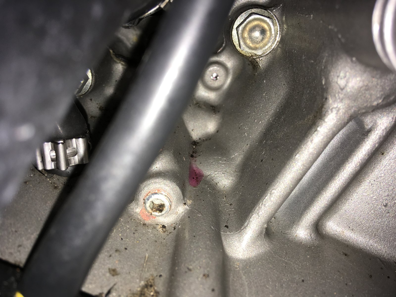

  16. Mine just started today
    Bike has sat for a couple of weeks which is normal for me stared up and ran up to temp till fan kicked in and put it away and noticed this,
    The dealer said they will inspect and replace it if I want but in all likelihood will happen again even with a new pump
    He said it’s quite a big job to replace the water pump.
    Not sure if it’s worth doing. If it’s only a slight weep from time to time then I could live with that.
    I’ll keep my eye on it for now but it’s about to be put away for the winter so it’s annoying!
    Also spoke to corner speed, DMC and motorapido and they all said it was normal and unless excessively leaking out then its not a paroblem
    #77 flatstick959, Oct 19, 2017
  17. Ran it up to temp again today and while warming up a tiny drip Came out then no more
    Maybe at about 60 degrees cooling temp.
    Seems that the seal passes slightly when warming up.
    Unless it’s left over fluid from last time as it only came out when I leaned the bike right over to try and encourage it.
    If it stays like this I’ll be happy to live with and all the dealers I spoke to said it’s ‘normal’ and a new pump May be no better...
