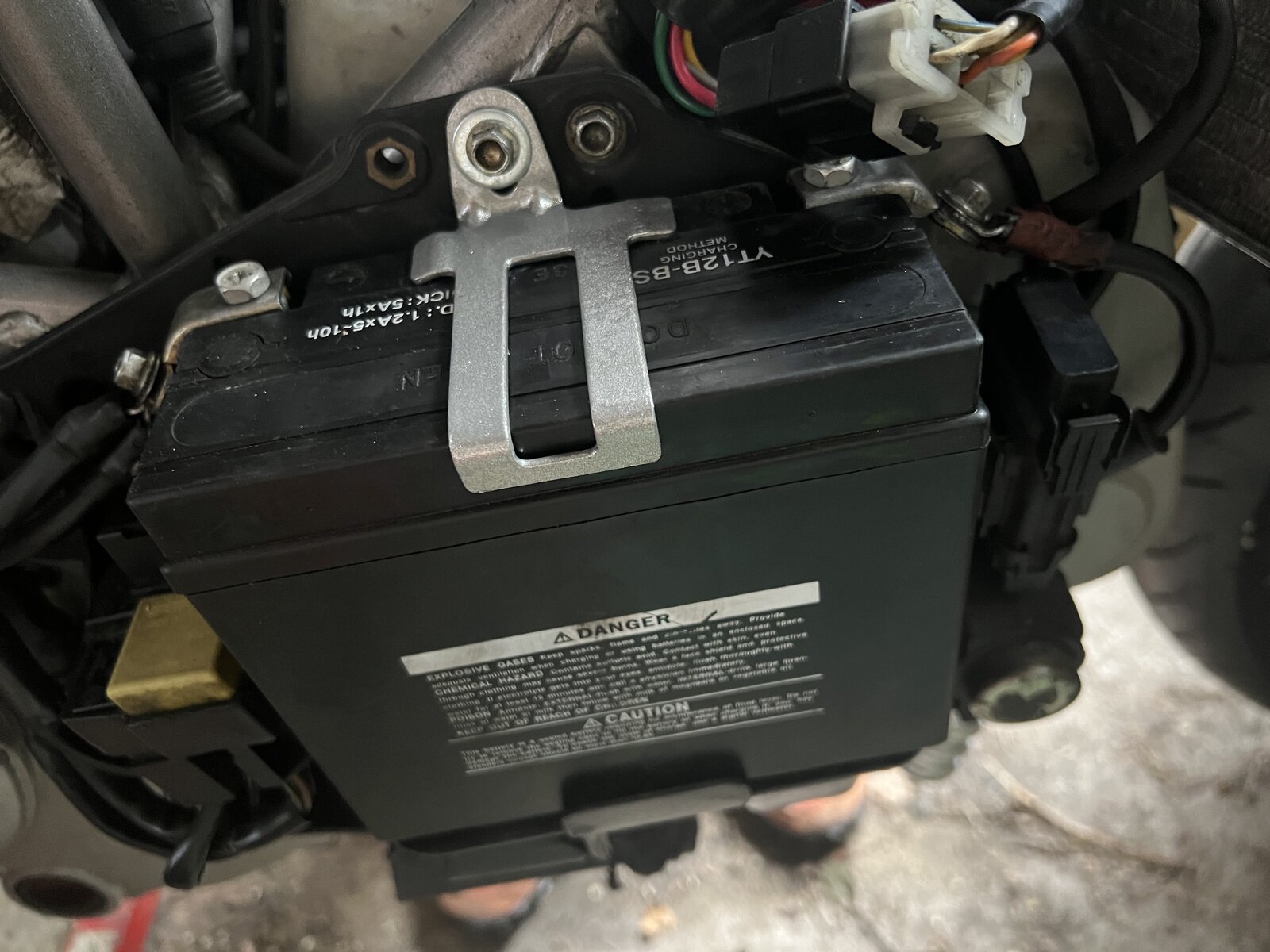

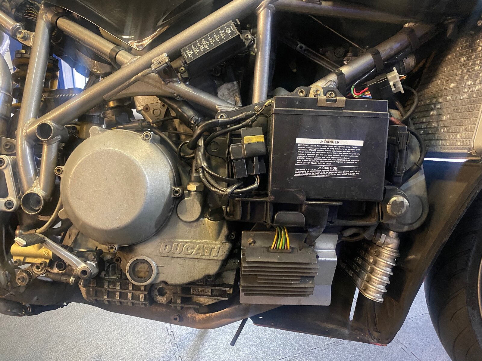

  4. Here is a short video on how to change the voltage regulator/rectifier.

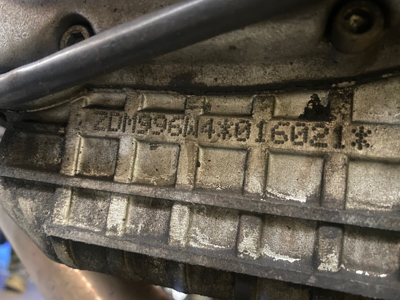

  6. A relatively easy way to tell a 996S should be that it has x4 injector throttle bodies and a 1.6 ECU.
    The 996S UK bikes were said to be SPS motor (titanium rods and T1 cams, I believe sandcast cases too, though not 100% on that - those look painted).
    They had x4 injectors but they were fired simultaneously therefore running on 1.6 and not on P8 (that has sequential firing). The wiring of the subinjector loom uses less pins as well since the same signal goes to both injectors. Some people did conversions to run on single injectors which appeared smoother without starvation.
    If it is a genuine UK S bike, it is quite a bargain at this price.
    You see some advertised around the £10k and one was on this forum was for £8.5k (quite a bargain and looked very much mint). Though, you have a lot of work to bring this one back to the standard you would expect from such a bike. For starter I would not leave the engine in this condition and it means going right back.
    Careful it is a US import. The US S bikes where numbered with some bits of carbon but they did not have anything special engine wise.
    With SPS cams, you want to check rockers and clearances as well, because they are harsh on the rockers.

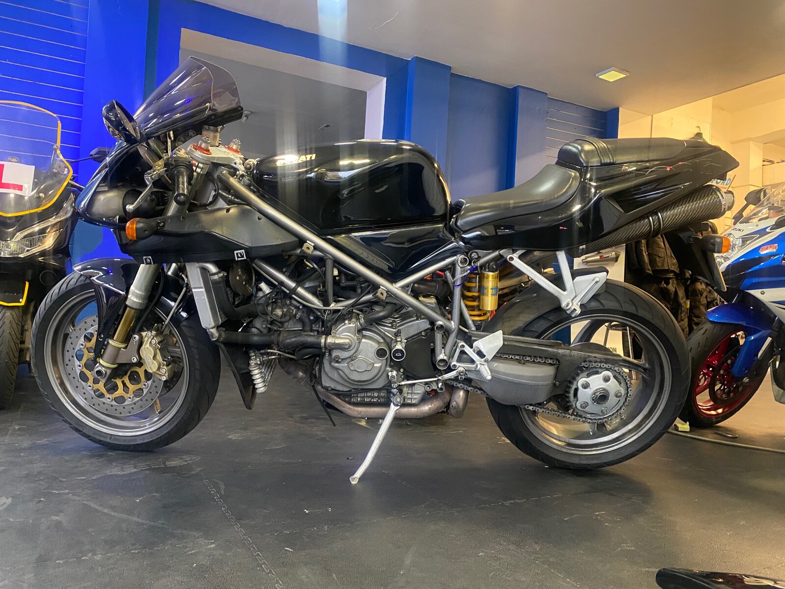

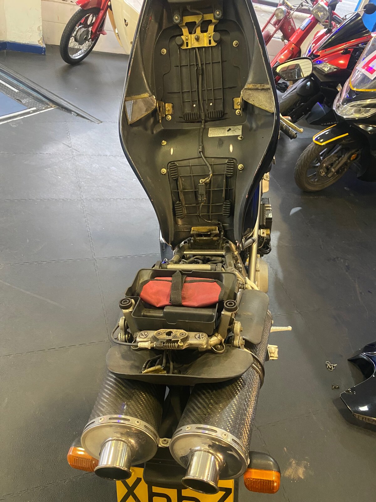

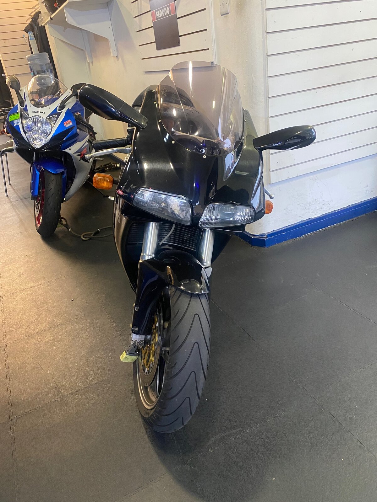

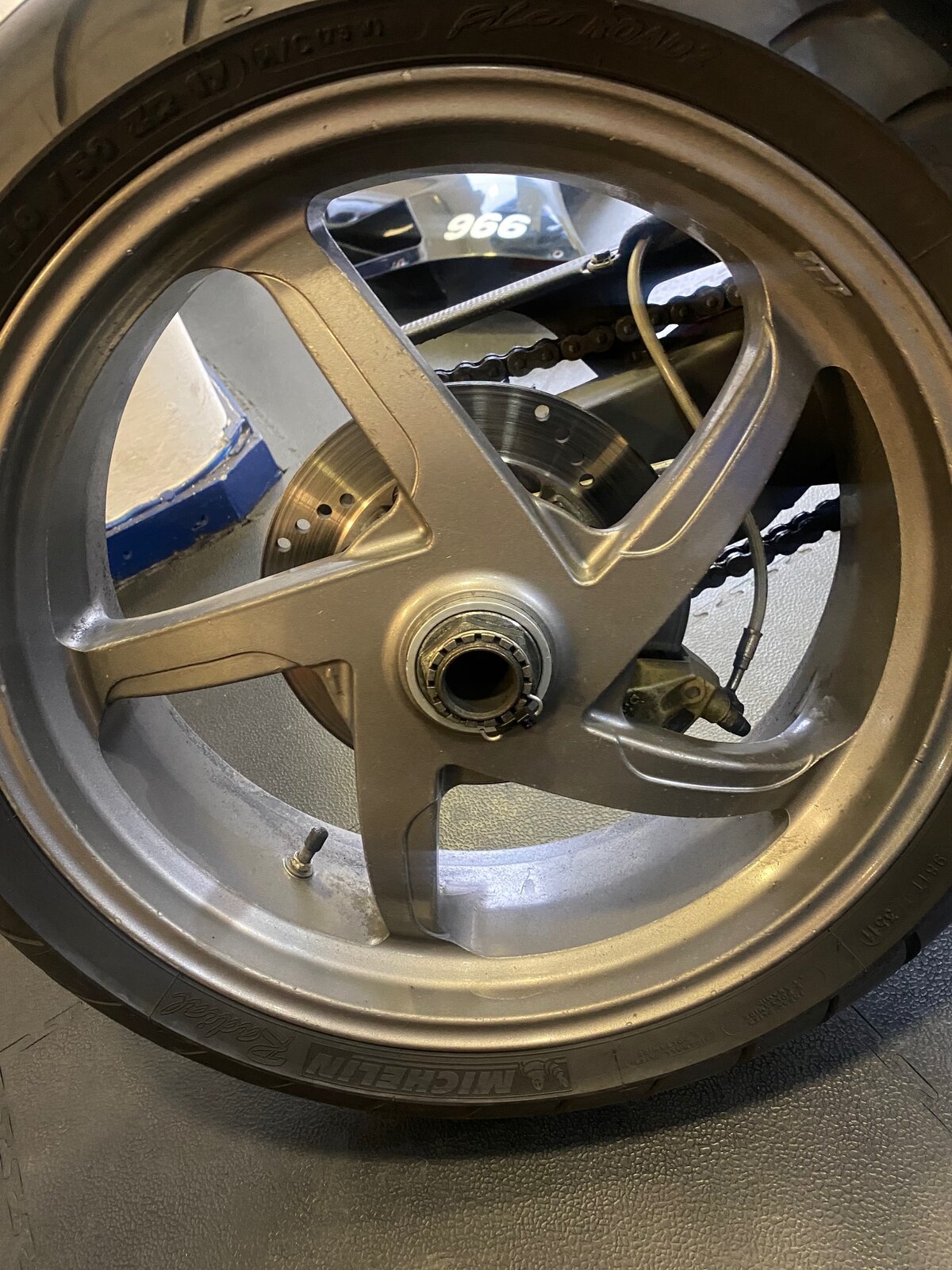

  7. Thanks - super helpful. I know it's a UK bike from new as I've got the original dealer stamps in the Ducati service book. Book also says 996S (it was an ex-demonstrator) - as does all the paperwork on subsequent dealer sales. So I'm optimistic that it is! I can also check by emailing Ducati with the VIN apparently?
    I'll keep this thread updated with progress, but I've already got the following jobs on the go:
    New engine oil & filter (15W-50 Motul semi synth)
    Brake fluid change
    Clutch fluid change
    New Fork seals and oil
    New fuel filter
    Investigate oil leak
    MOT
    Bike runs well and starts on the button (hadn't realised there was the raise rev button for cold starts!) but full service on the cards as it's been 3+ years since the last one. Tyres I'm probably going to go with 180/55 & 120/70 Metzeler M9RR. Toyed with 190/55 but then it stretches gearing even more.
    Have got new belts, trying to line up a garage that can do the change for me as I don't fancy it.
    Then I'll be starting on the cosmetic jobs, starting with pulling the rear shock out and sending it off for refurbishment.
    Think I'm going to respray the wheels too whilst I'm getting the tyres changed. Any advice on that front? Will colour match to the original finish.

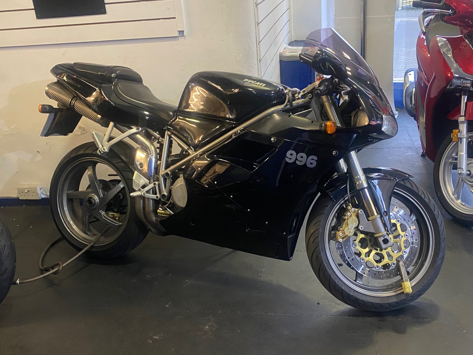

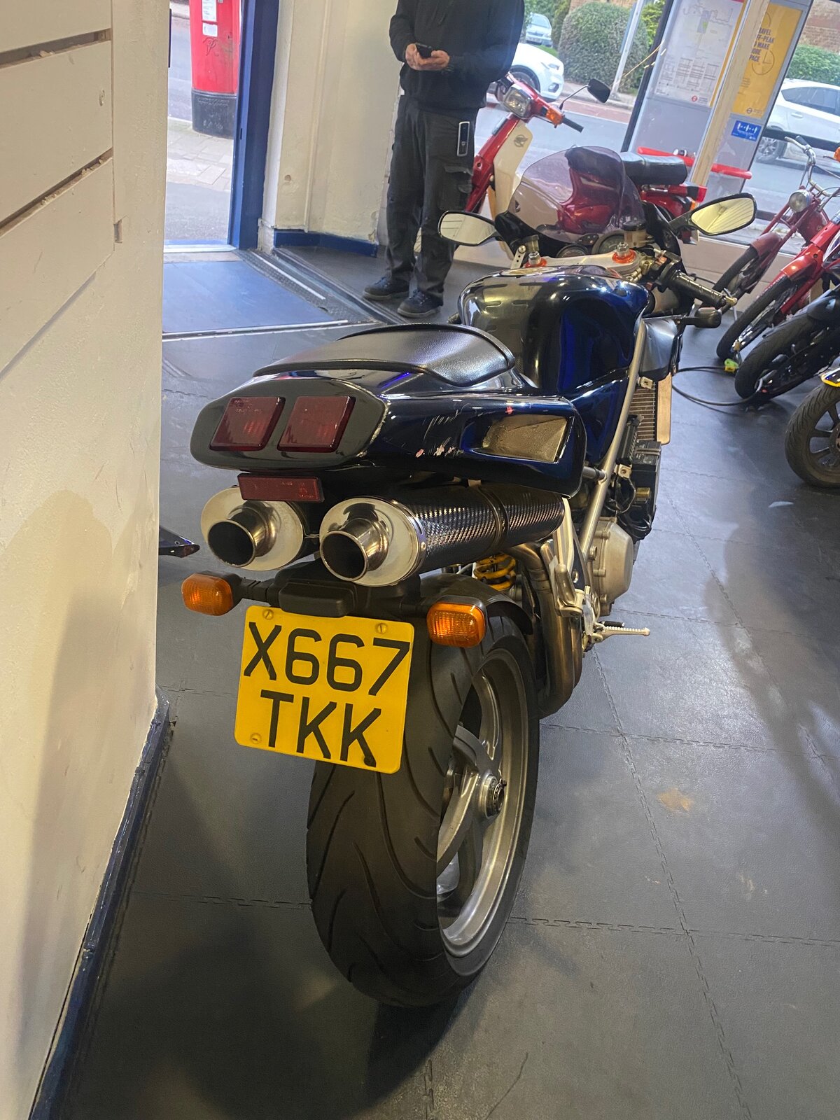

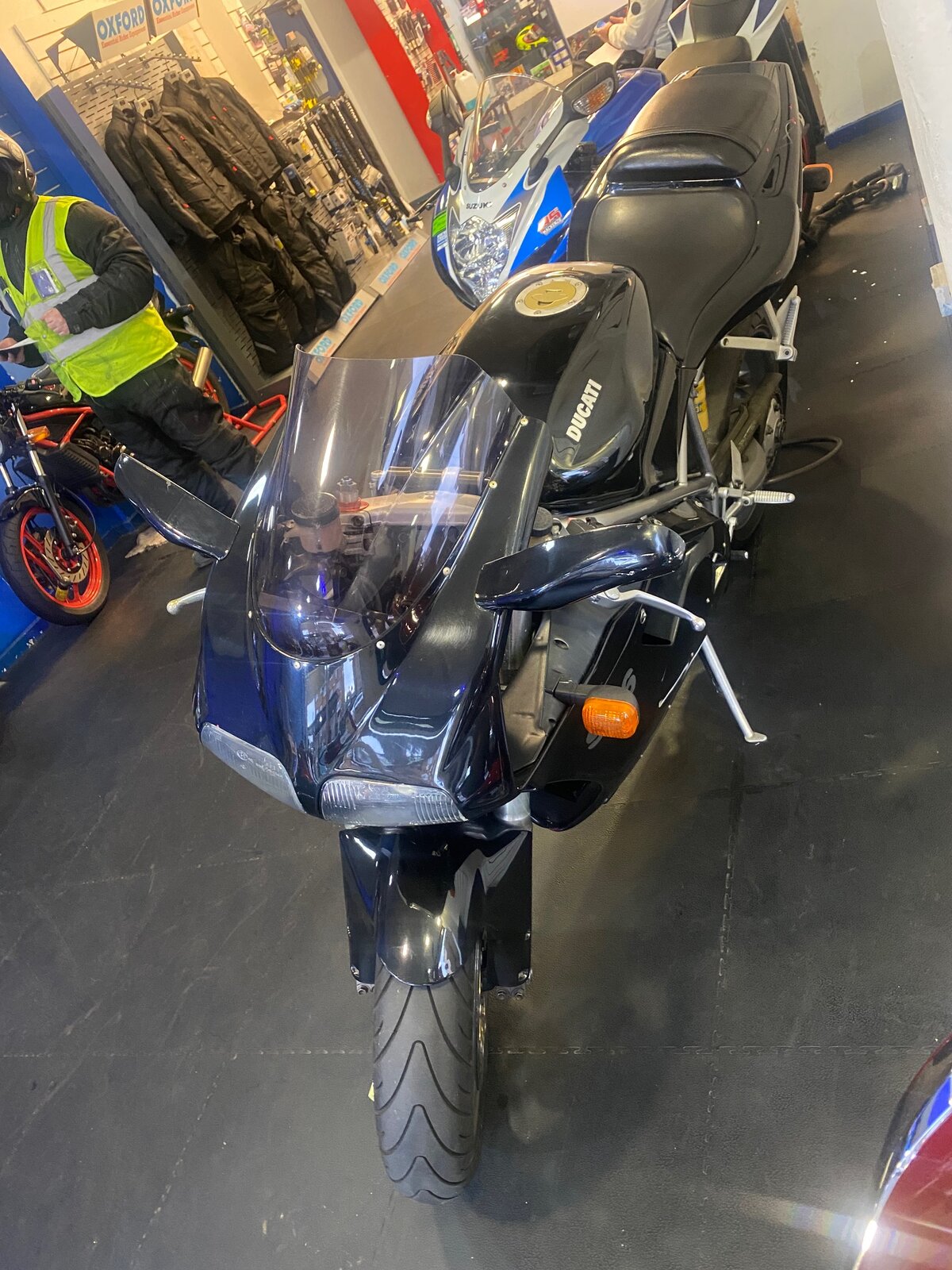

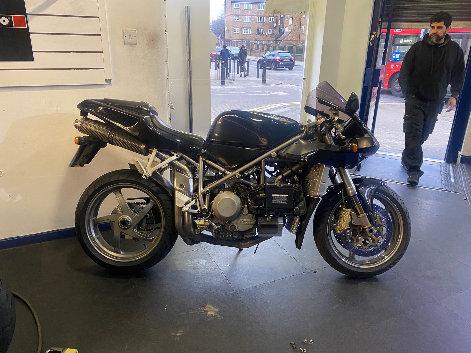

  8. Picked up the project 996 today, fresh from full service and MOT…
    Was expecting it to be difficult in London traffic and be uncomfortable, hot and have everything not work - but it was bloody brilliant.
    Clutch very biddable, seat quite low, throttle and sound sensational - wow what a bike! Love it!

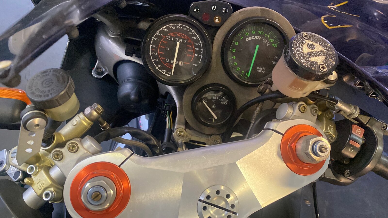

    Only a couple of wrinkles - the speedo doesn’t work, and an occasional misfire/fuelling chug at 4-5k rpm at mid throttle.
    Is there a common fault that leads to speedo non-function?
    The garage told me that the fuel filter I got (Mahle KL145) wasn’t the right one (didn’t fit). So it’s got the old one in it - perhaps this might be the cause of the fuelling chug / misfire?
    When the engine warmed up it seemed to be much better behaved - but still think there’s something here that needs sorting.
    Also - where’s the red line? First gear is long isn’t it - actually use it on the road for more than just pulling away, which is novel!
    I’m assuming super is the way to go with fuel - can’t imagine they like E10 much?

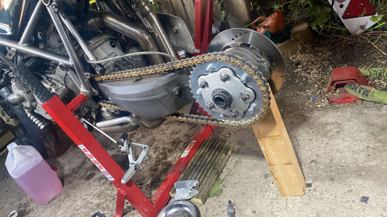

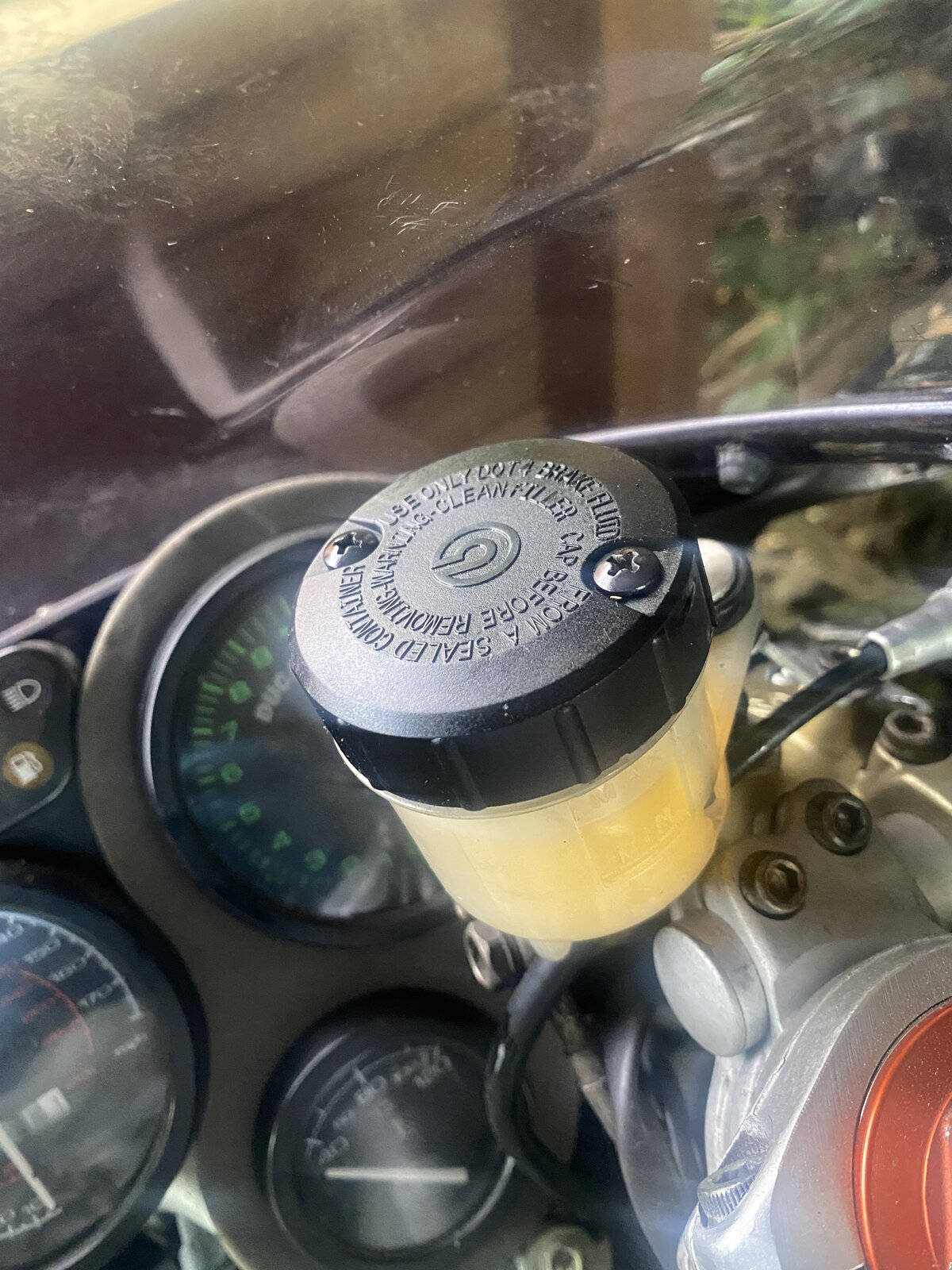

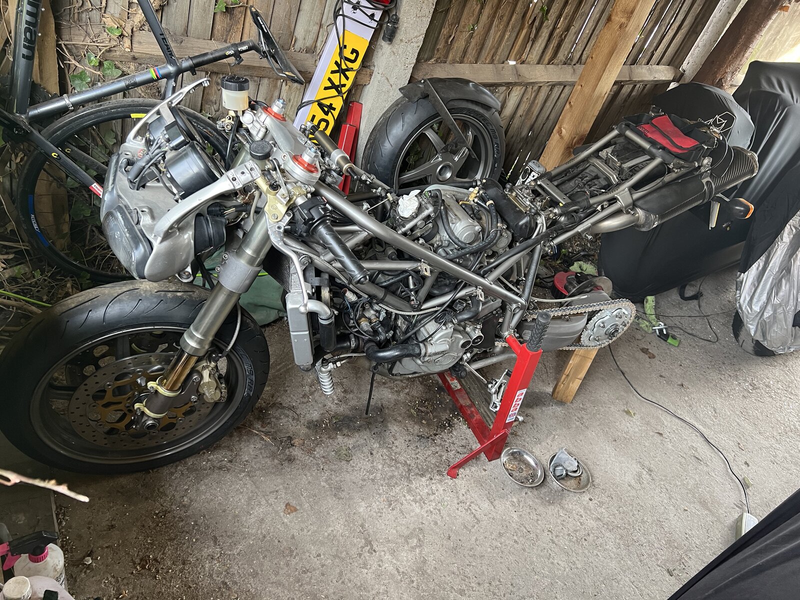

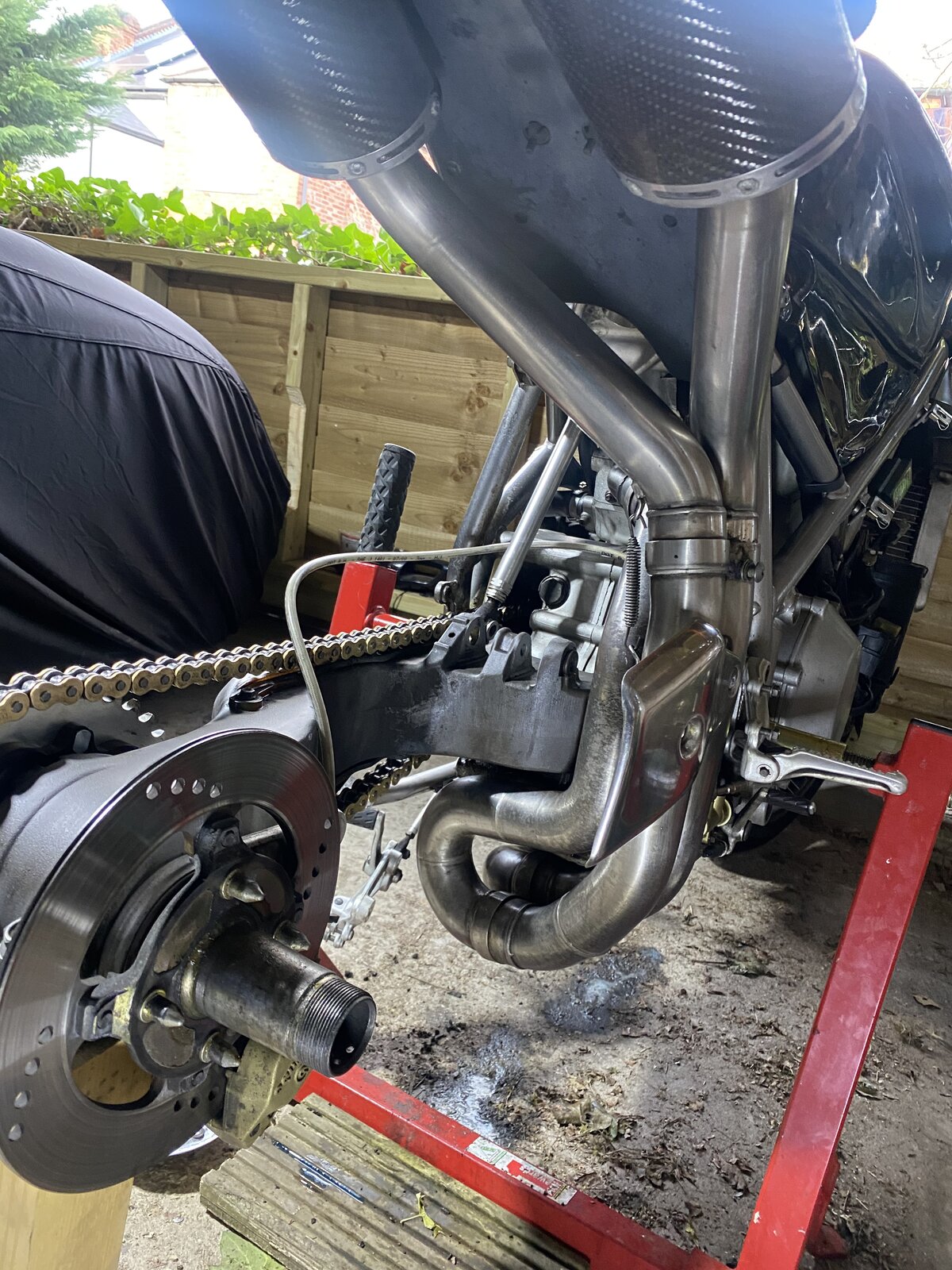

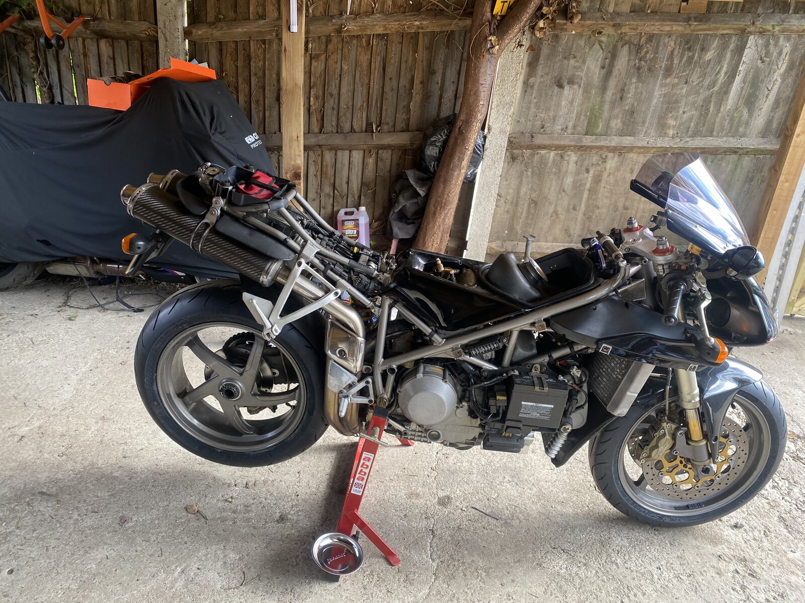

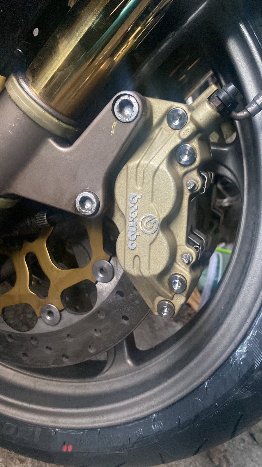

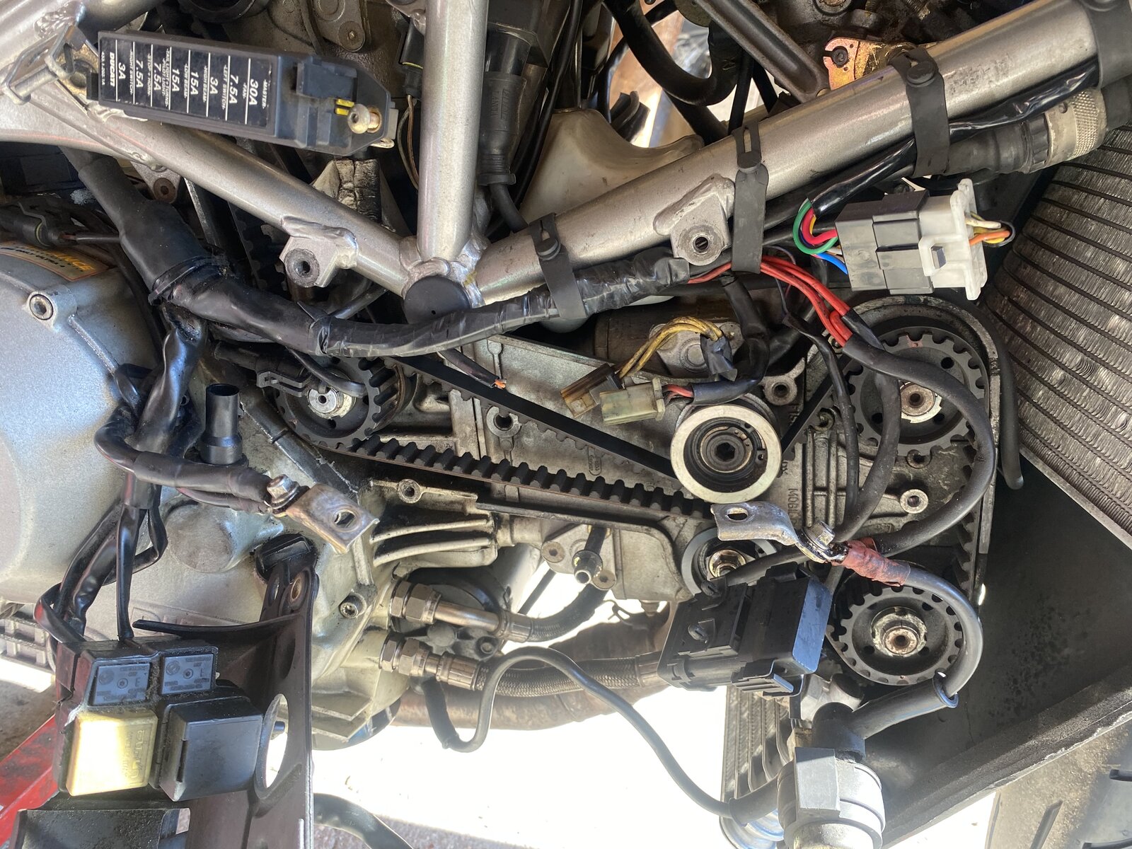

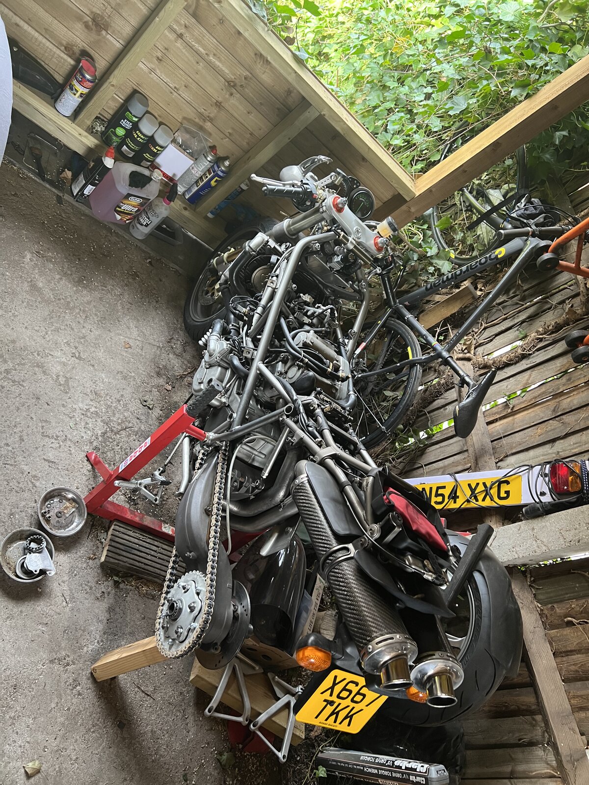

    Thought I’d post an update on progress.
    Done a number of jobs on the car now:
    Replaced fuel filter (that o-ring is a sod eh reinserting the pump unit!)
    Replaced belts - old ones were in good condition but massively slack, and timing was a bit out as a consequence!
    New chain and sprockets - went to a 39 tooth on the back.

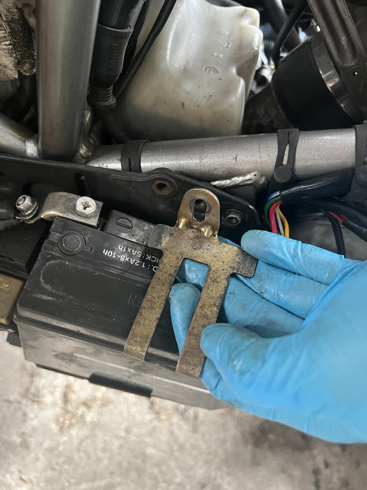

    Front calipers cleaned up (yes those attachment bolts need replacing ASAP!)
    Tired rear shock has come out.
    New brake master cap (a small but pleasing change from the rancid old one)
    And exhaust headers been Harpic’d and looking much better.

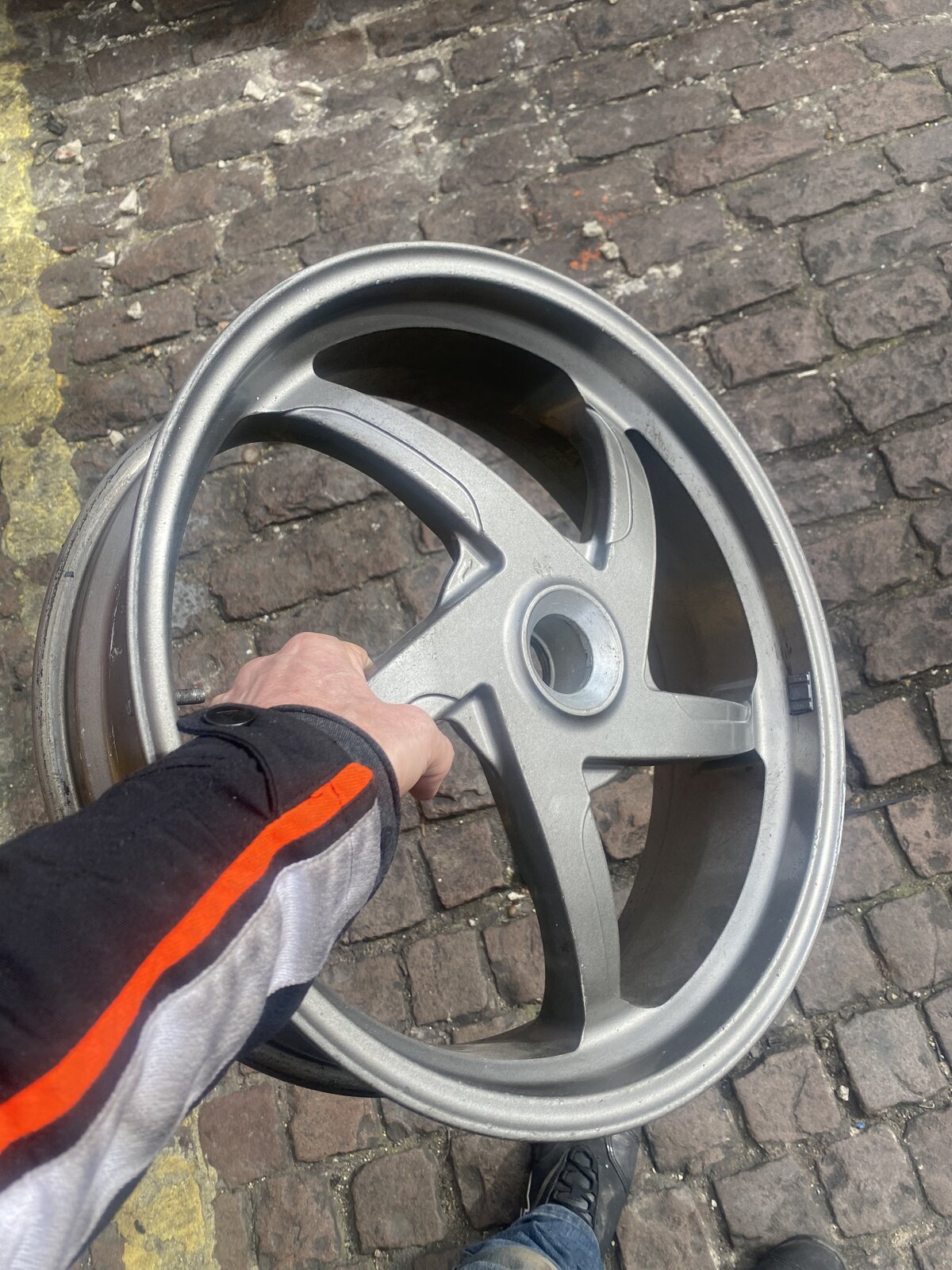

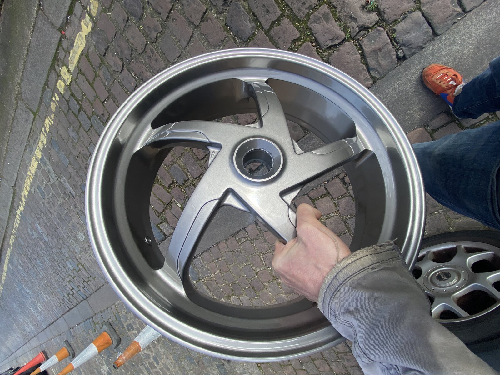

    Also taken the rear wheel off for refurb - that should be done tomorrow.
    Next big jobs are to strip the fairings and tank down to get those resprayed red and decal’d up and get some new dashboard bungs in as it wobbles about.
    Getting there!

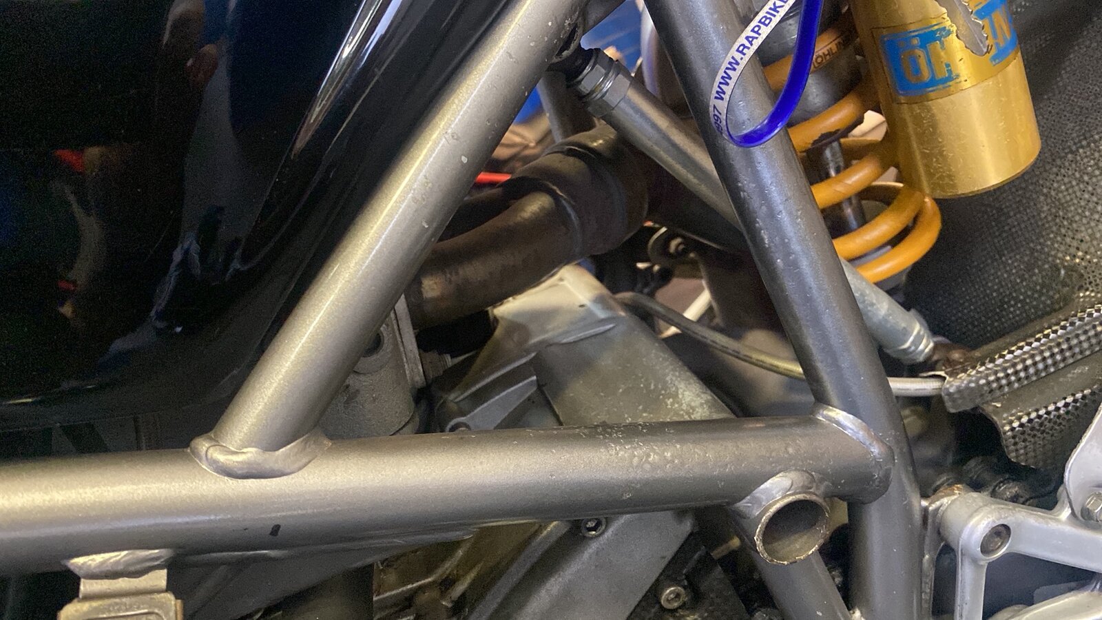

  16. Thanks for all the info! The frame on the LHS has a bit of rash from the PO using a chain to secure it every day - this is the original paintwork that has just got mashed up. I'll be looking to see if I can get it repainted without stripping the whole frame down.

    I'm slowly working my way round the bike pulling out all the old or rusty screws / jubilee clips etc and soaking them in solution to bring them up fresh. A number of other bolts I'm straight up replacing.
    I get the refurbed back wheel back today, and once the fairings are repainted it's going to come up pretty nicely I think!

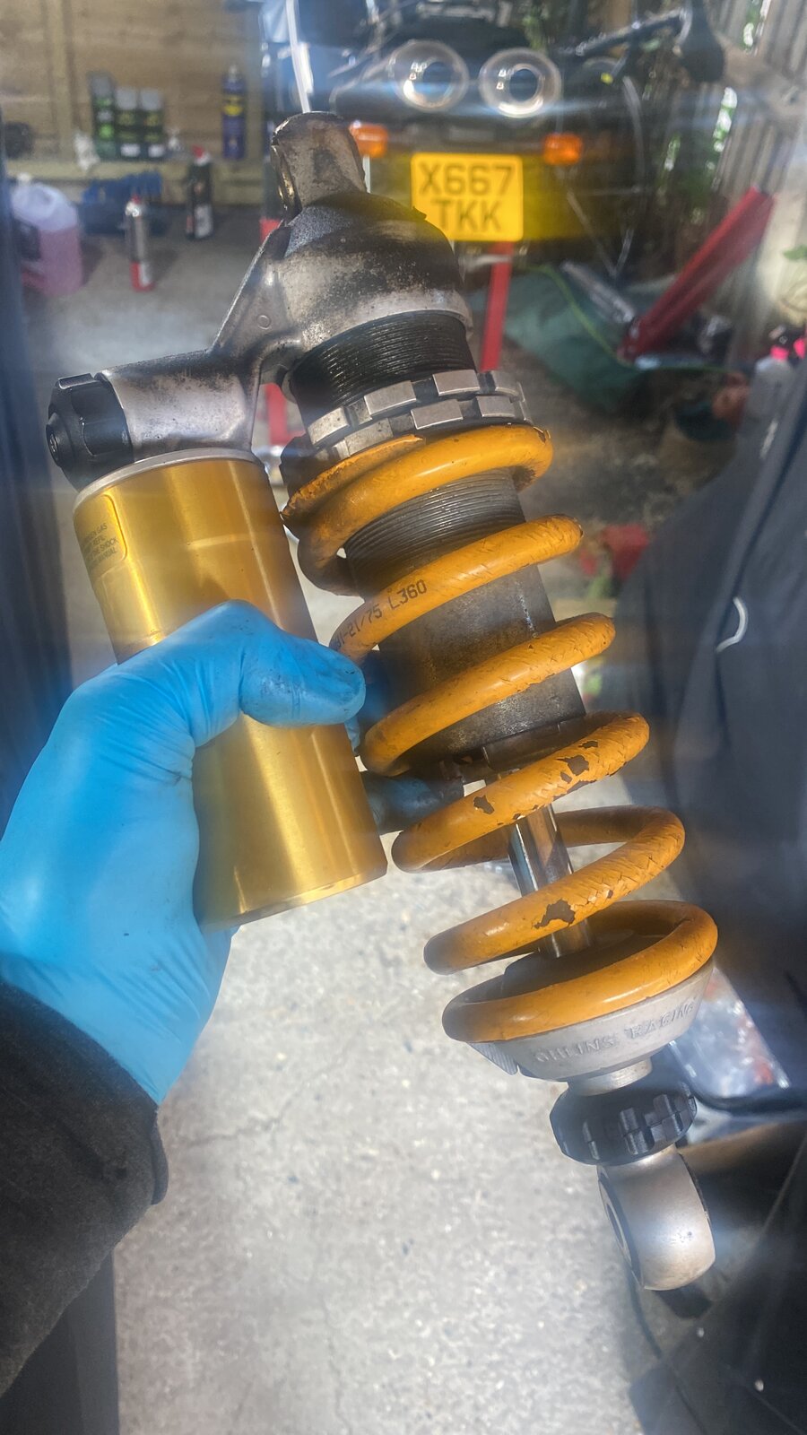

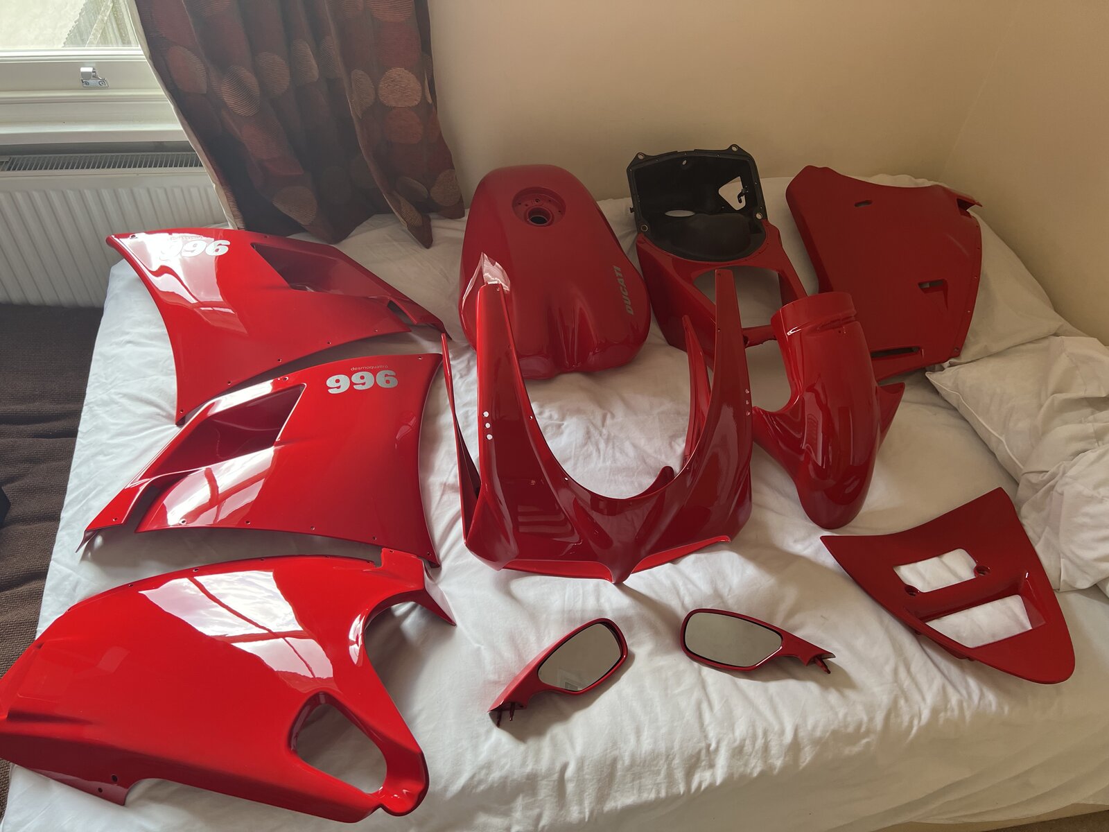

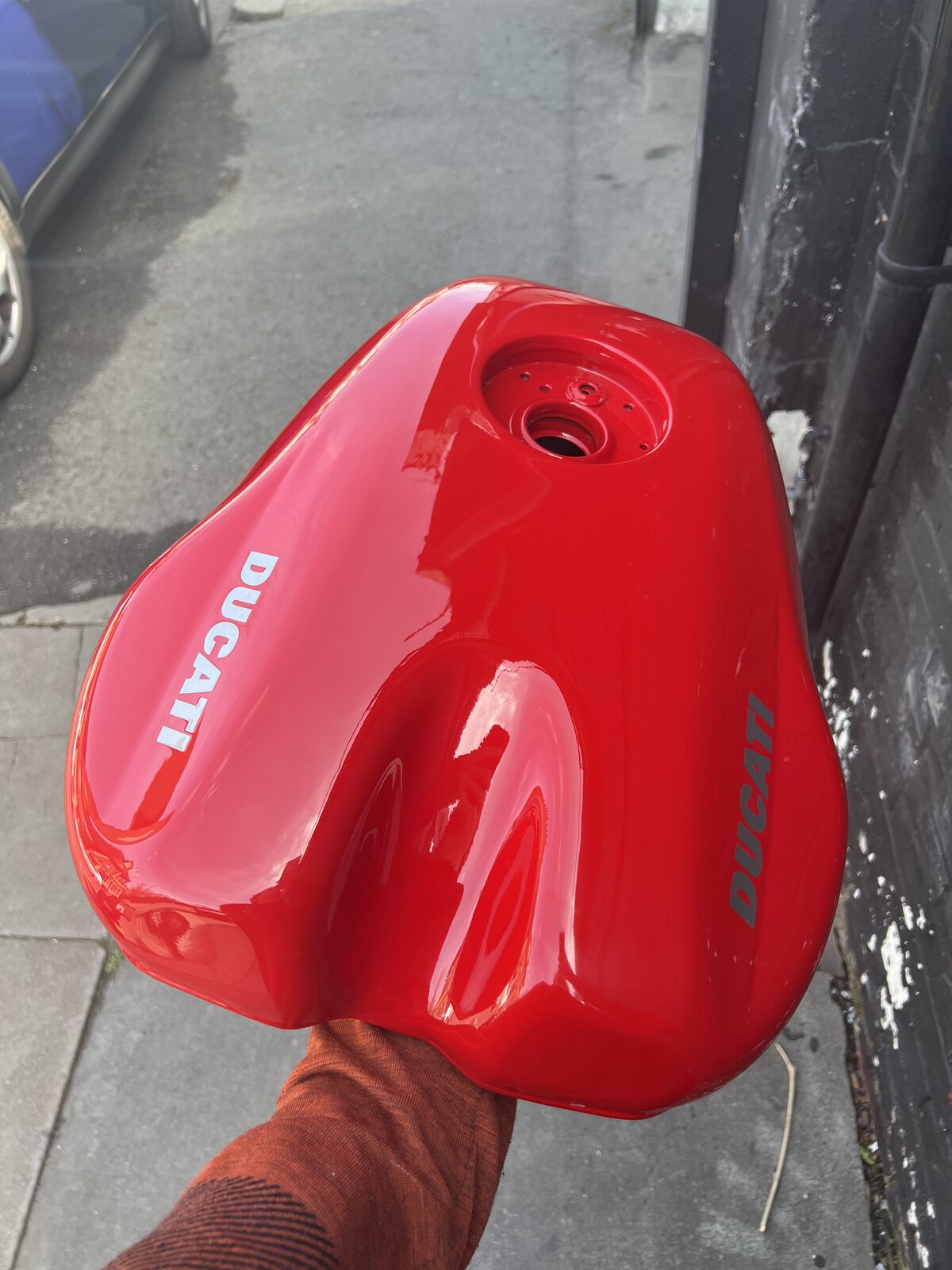

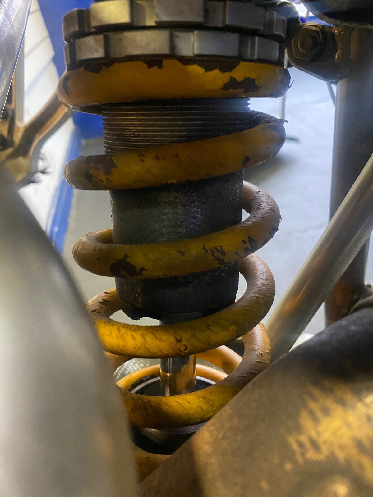

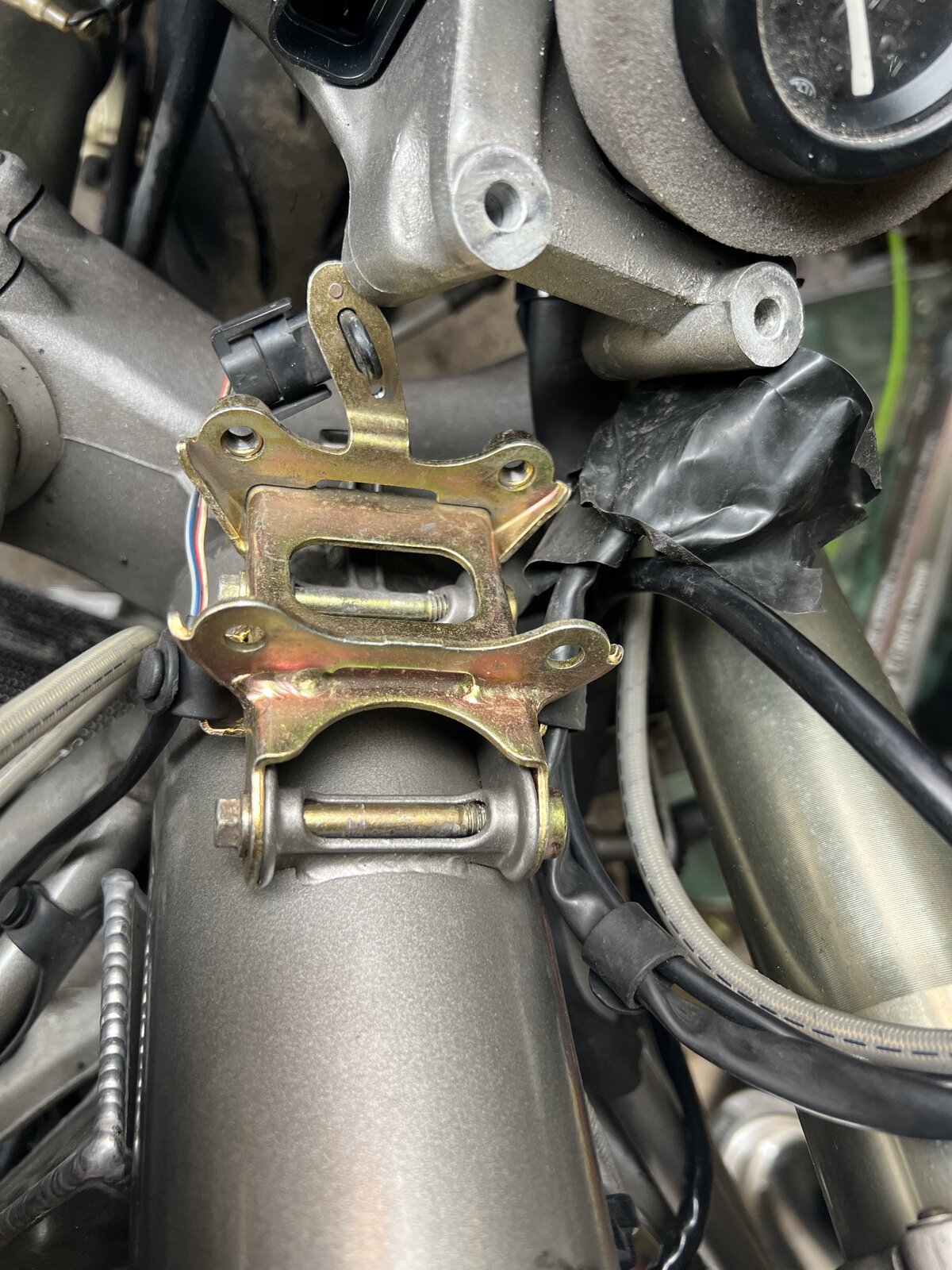

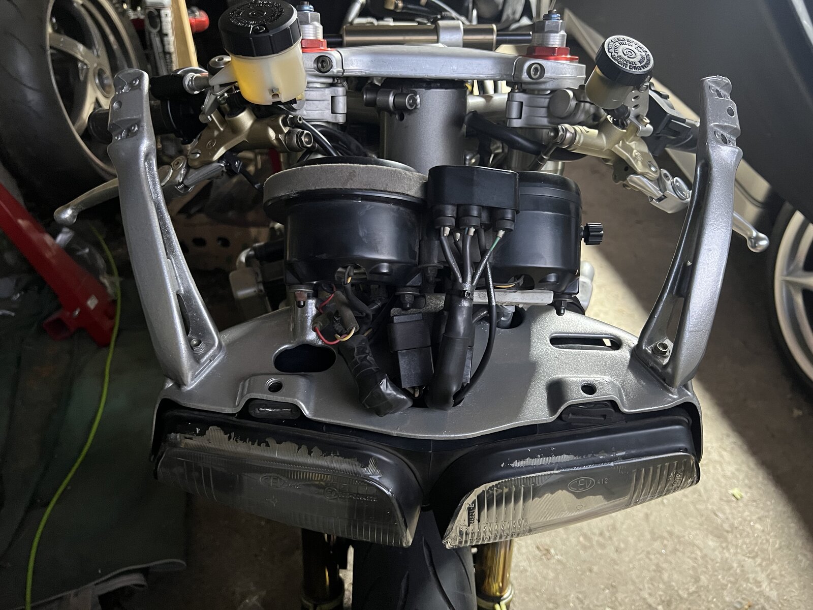

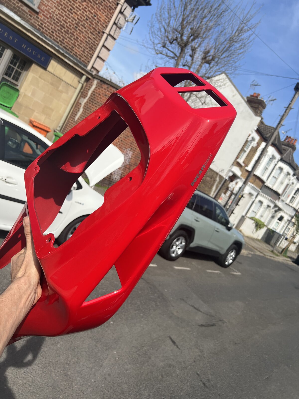

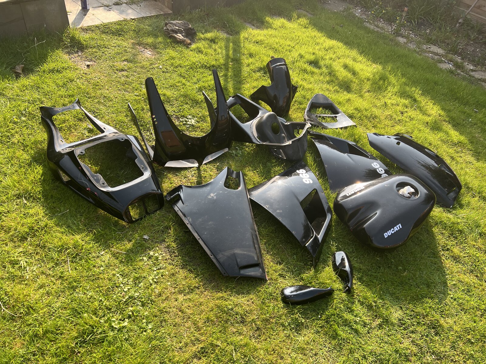

  17. Few updates on this front!

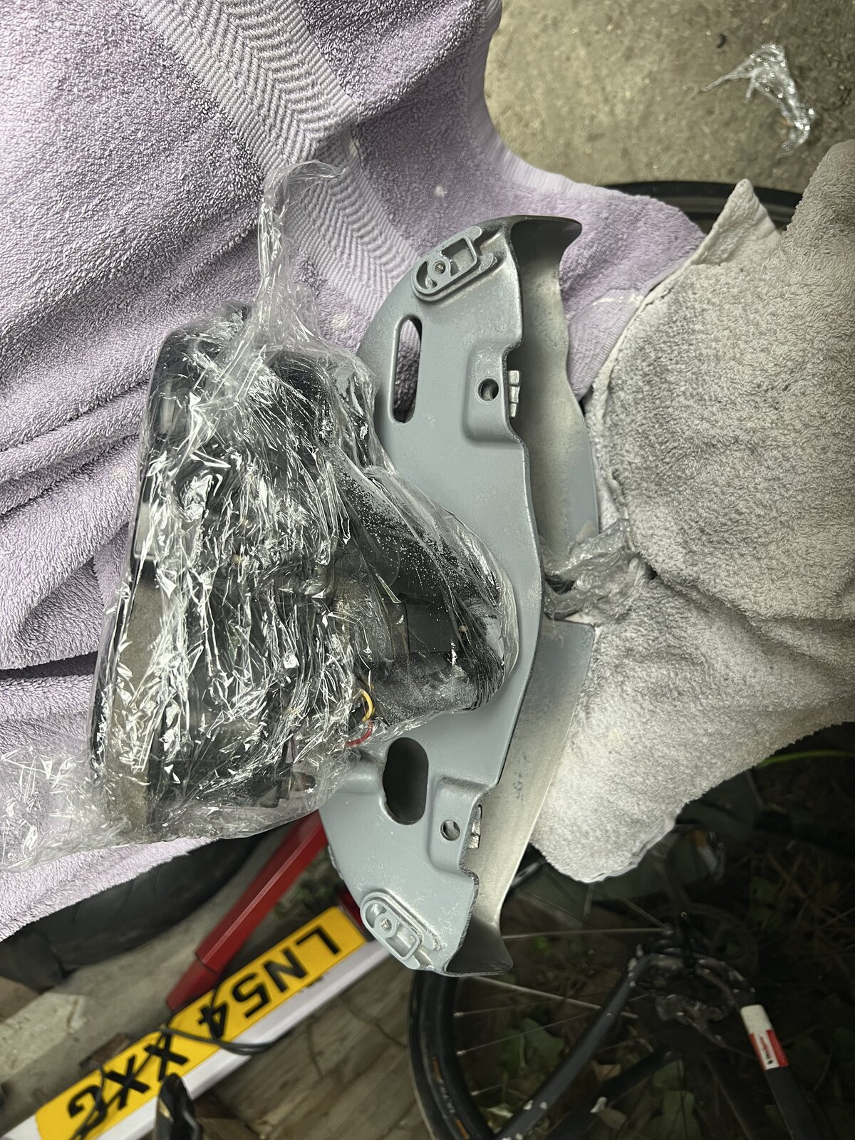

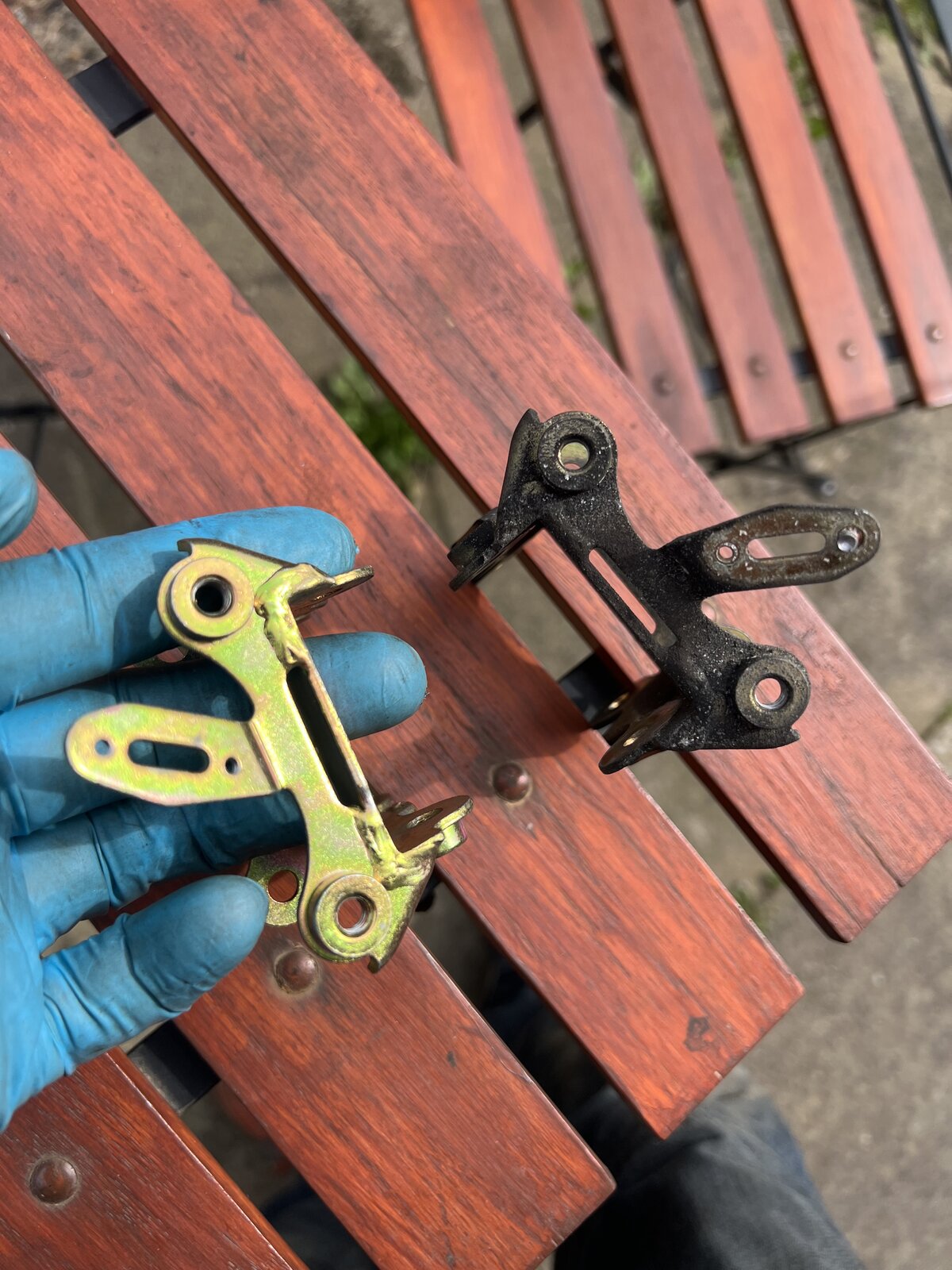

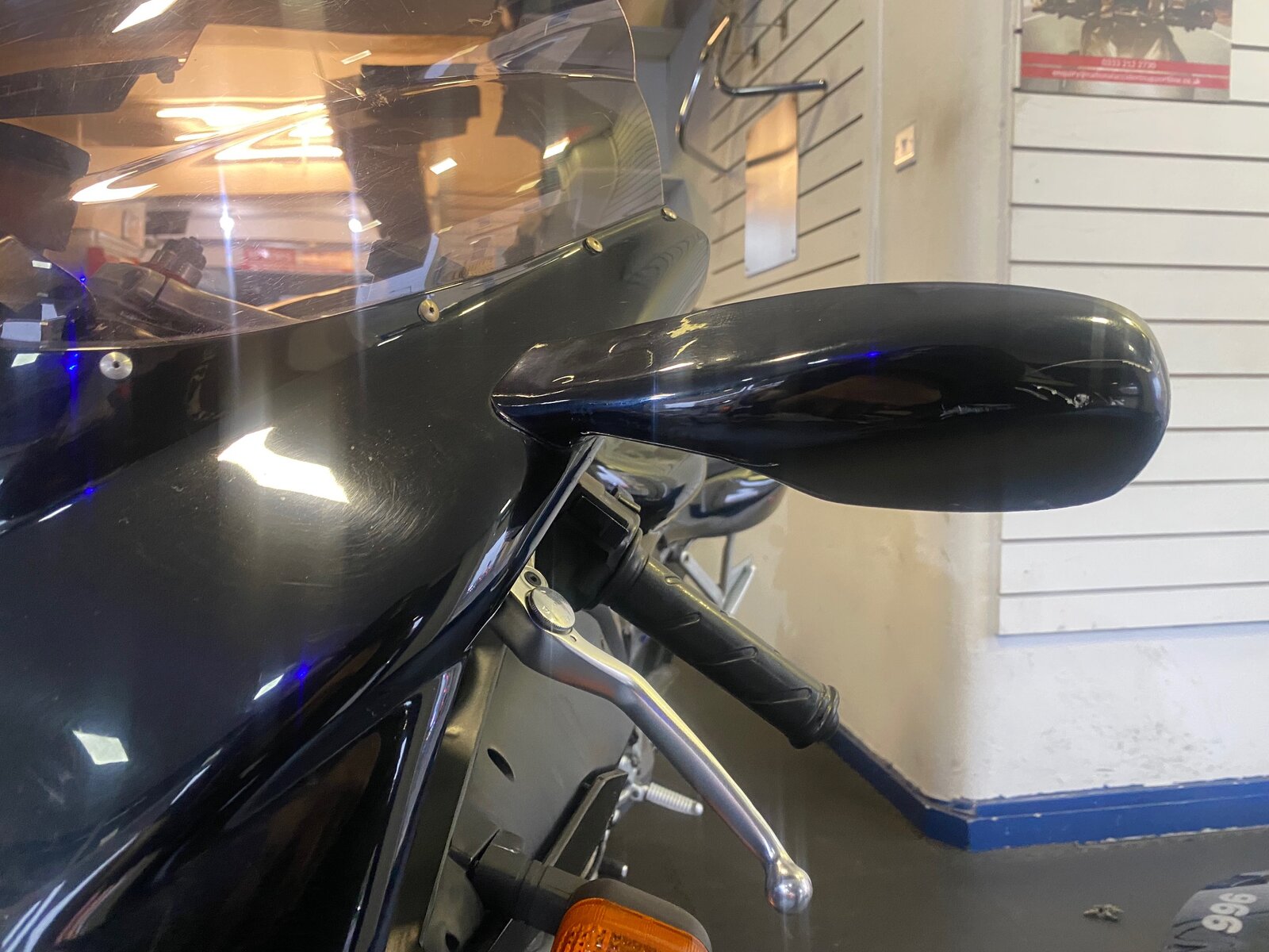

    Rear shock is off with MH Racing getting refurbed. I’ve resprayed the front headlight holder and mirror arms, a bunch of new stainless bolts have replaced the tired old rusty ones. New dashboard bracket to replace the old tarnished one. Exhaust system has been polished up.
    Got the fairings back today - getting close now! Just need the shock back and I can start to rebuild the bike, if I can remember how to put it back together!
