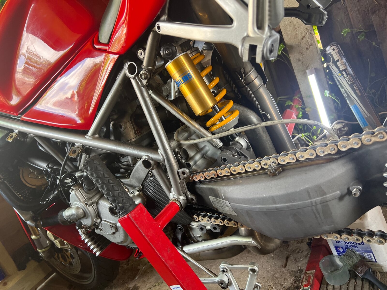

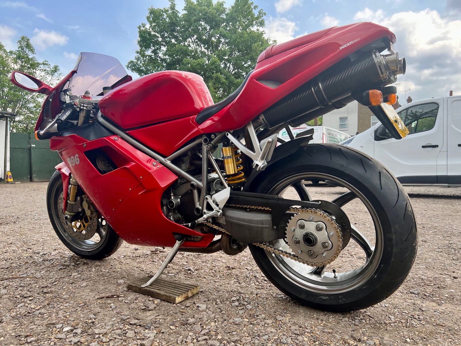

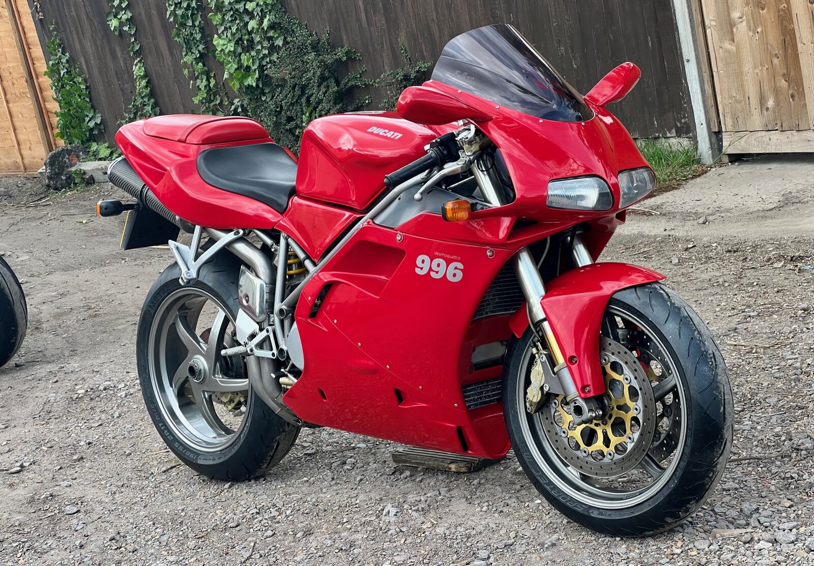

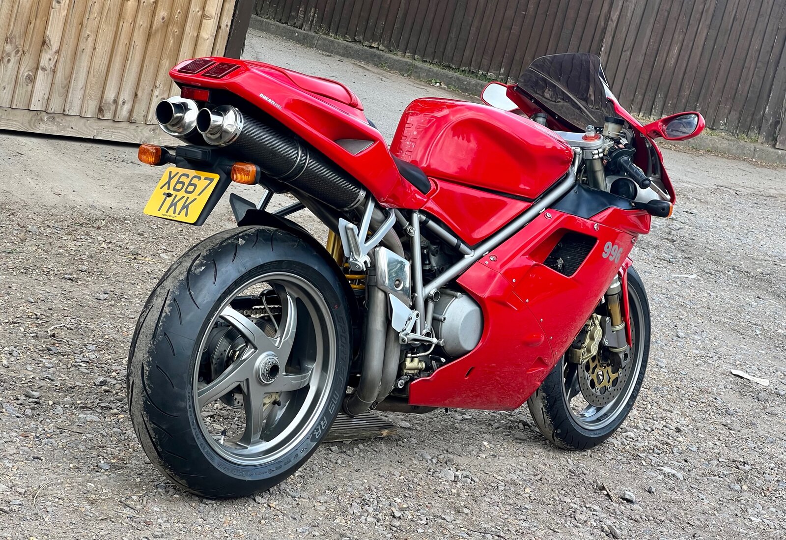

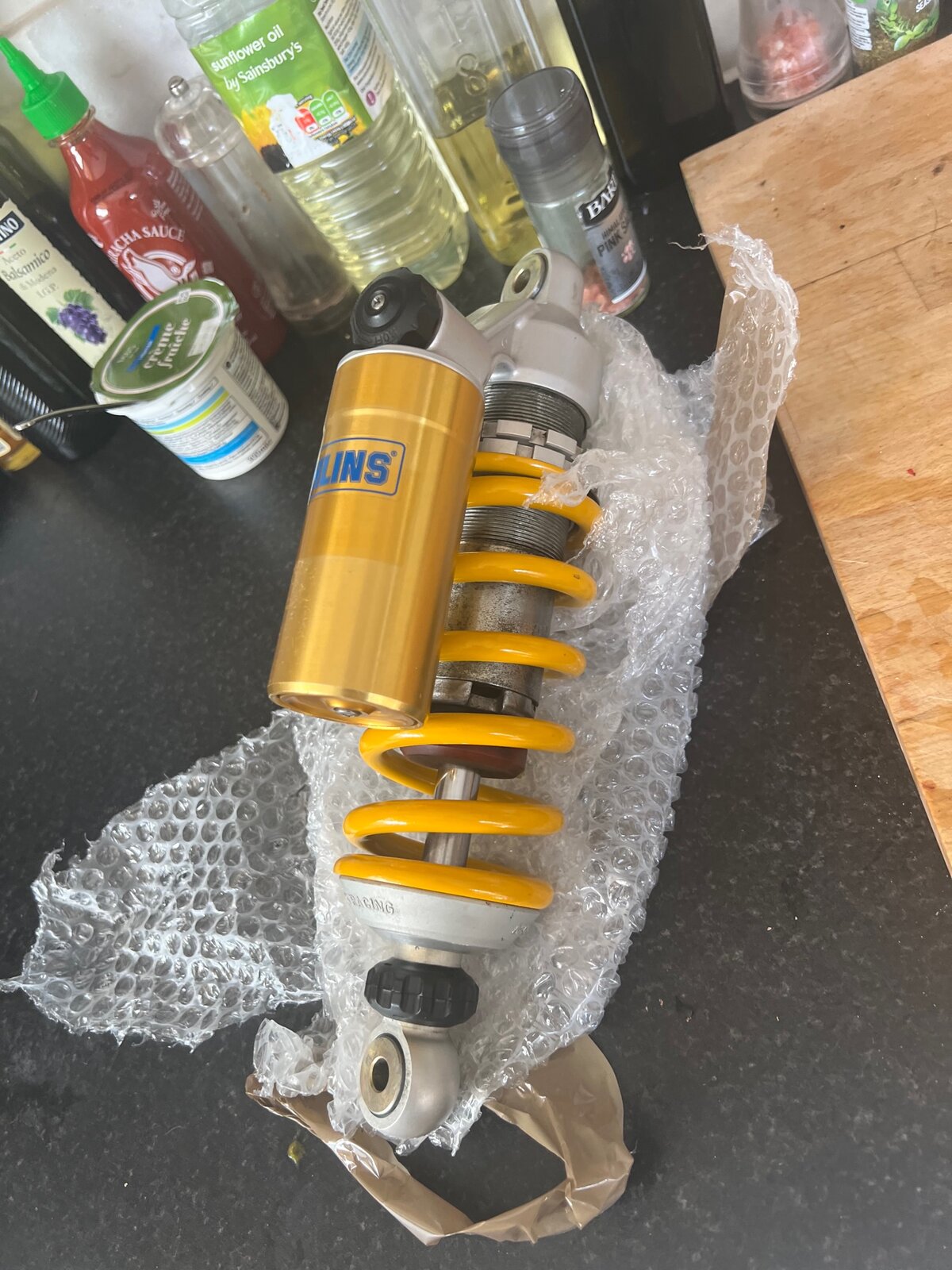

  3. Finally got the rear shock back from MH Racing and put the bike back together. Had a few issues with popping and banging from the exhaust but that's probably just the fuel reacting with the overspray inside the tank :laughing:
    Took it out for a ride and once warmed up she rode like a dream! Next job is painting clutch and water pump covers, and sorting out the rash on the frame. Going to get a suspension set up by Mint Customs too - guy there used to work for Ducati race teams for 11 years apparently!
    Forgot to mention - going up to a 39 tooth on the back makes a big difference too, it's probably still too long geared but so much better than before.

  6. That shock looks minty.

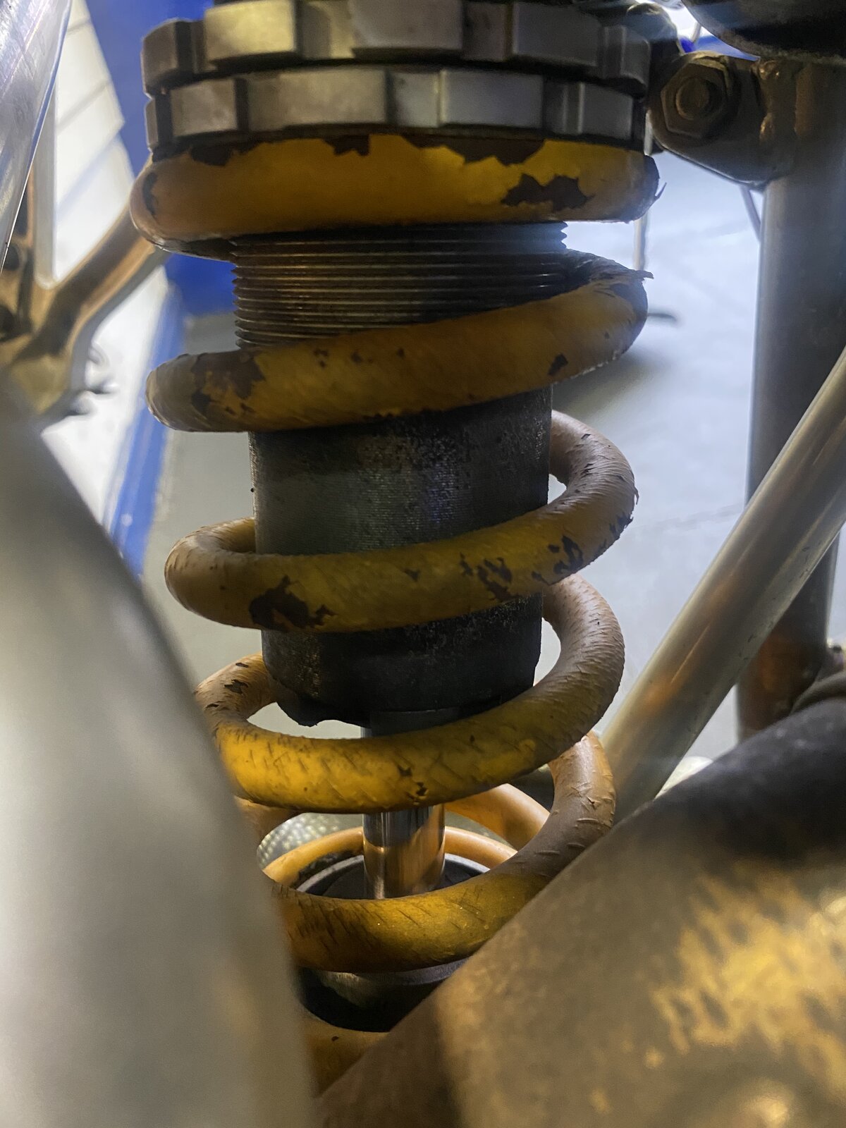

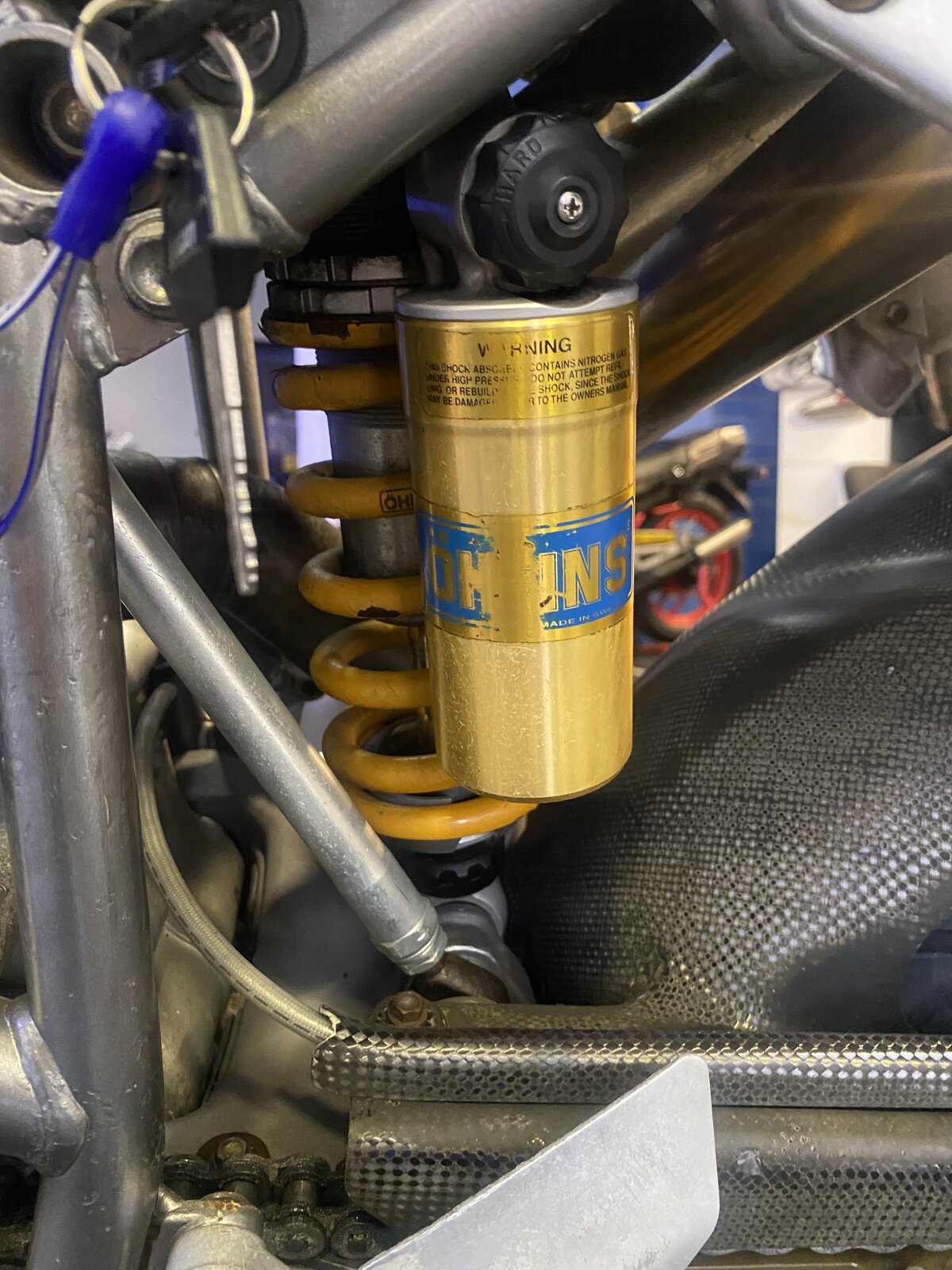

    Mine is also getting a full service with a new spring as we speak, so if it looks half as good as yours, I'll be happy.
  7. turns out mine needed quite a bit of work doing to it! Labour was only £110 but the total bill incl. spring respray was £350.
    It was a total horror show before though.

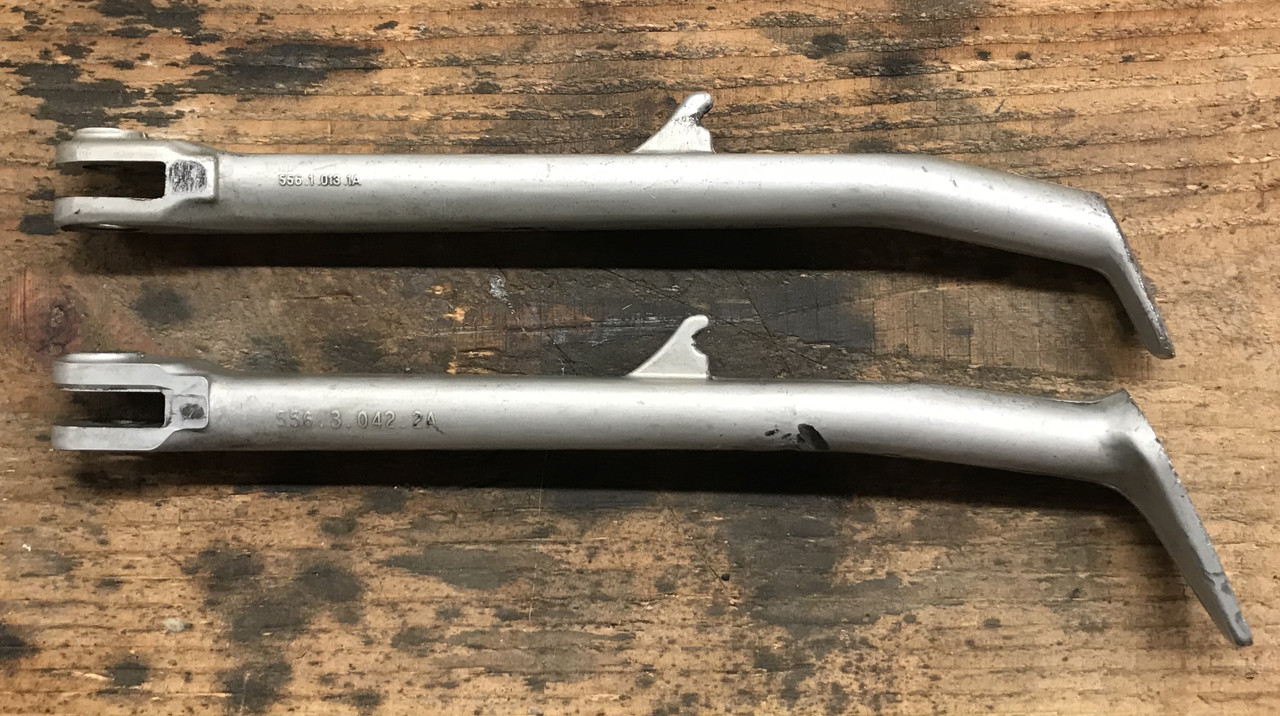

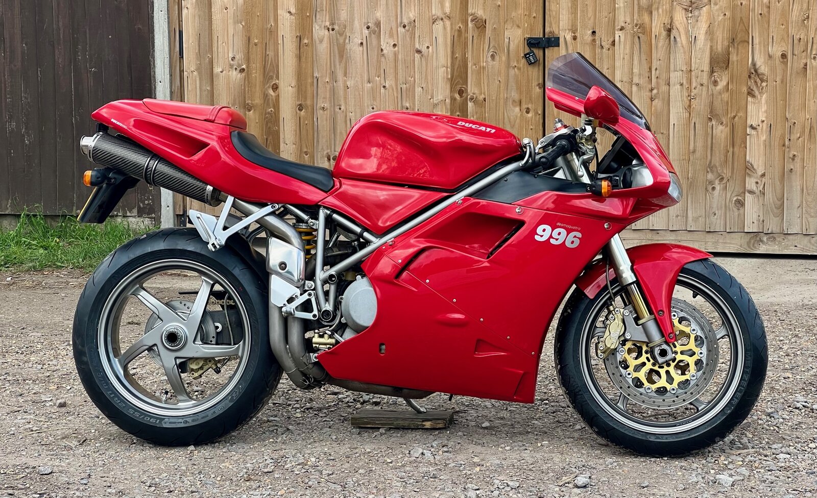

  9. Fantastic resurrection !! You definitely brought this bike to its former glory, congratulations. The Tamburini lovers community owes you! :upyeah::)
    Have you considered swapping the side stand for a longer/beefier 848/1098/1198 one? Plug and play, and a world of difference…
  10. Thanks!
    I didn’t know such a thing existed - but yes! You’ll have noticed I’ve got the wood under the side stand as otherwise it leans at about 45 degrees :D
    where’s the best place to find a 848/1098/1198 one?
  11. I did notice the wood block. ;)
    eBay is your friend. :upyeah: With a little patience, you can find very decent used ones on there.
    They come pretty pricey new from Ducati…

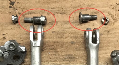

  12. Don't forget to change the mountain bolt too
  13. Aargh - what's the mountain bolt?!
  14. Mounting bolt? Autocorrect in action.:)

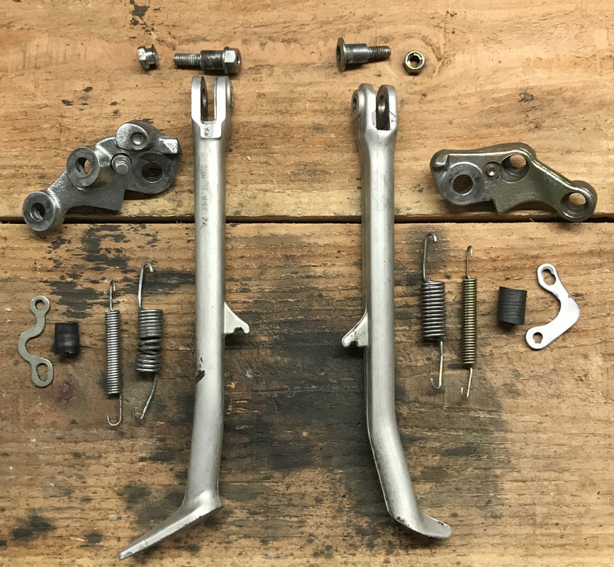

  15. Big bolt that holds the stand to the bracket, the shoulder length is different
    These guys are a bit different indeed.
    Also, and that is not specific to 748/916/996/998 or 848/1098/1198 set ups, note the nut shape that is very specific to allow full extension of the stand. A standard nut will interfere with the stand mechanism (S-shaped spring holding bracket) and the stand will never be able to lock in fully extended position. Which calls for disaster…
    GOOD
    NOT GOOD
