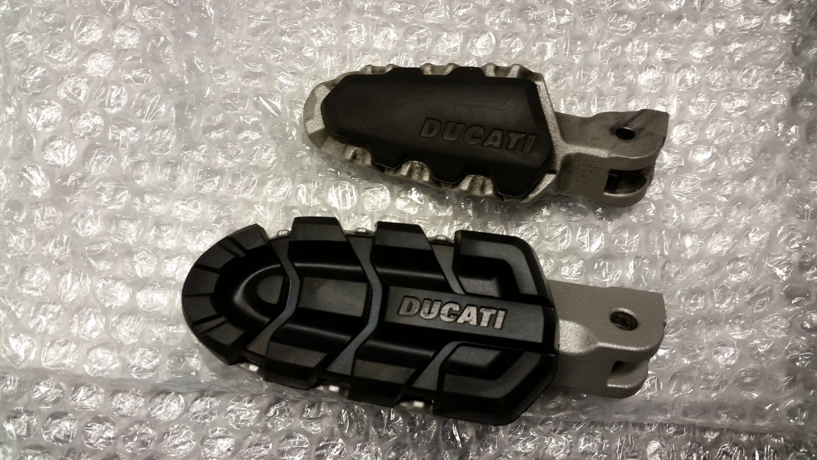

  16. Try replacing the standard Multi footrests (upper one) with the Enduro footrests (lower one). They are a genuine Ducati part, straight swap, and much more comfortable on the feet. So I have found.
    • Useful Useful x 3
  17. I also use the Enduro pegs.... but definately would suggest you try loosening and retightening the frame / engine bolts to correct torque and sequence.
