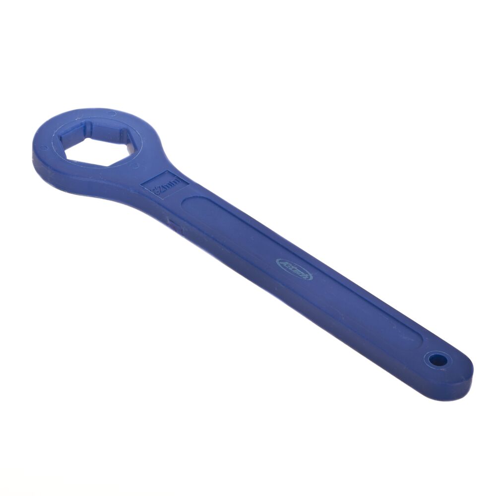

  1. FYI K-tech offer plastic front fork top cap spanner’s in various sizes, including 32mm (currently £13.79 plus shipping) if that’s any help.
    No experience with this tool myself, but K-tech usually good quality.

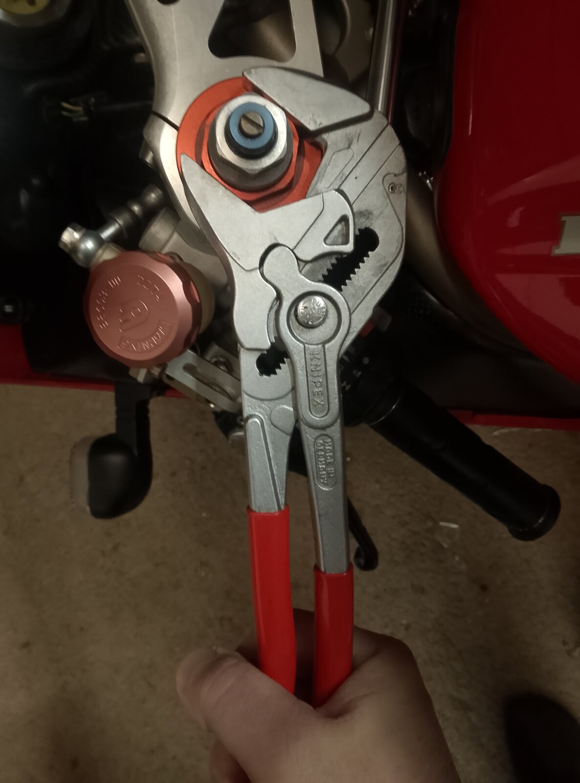

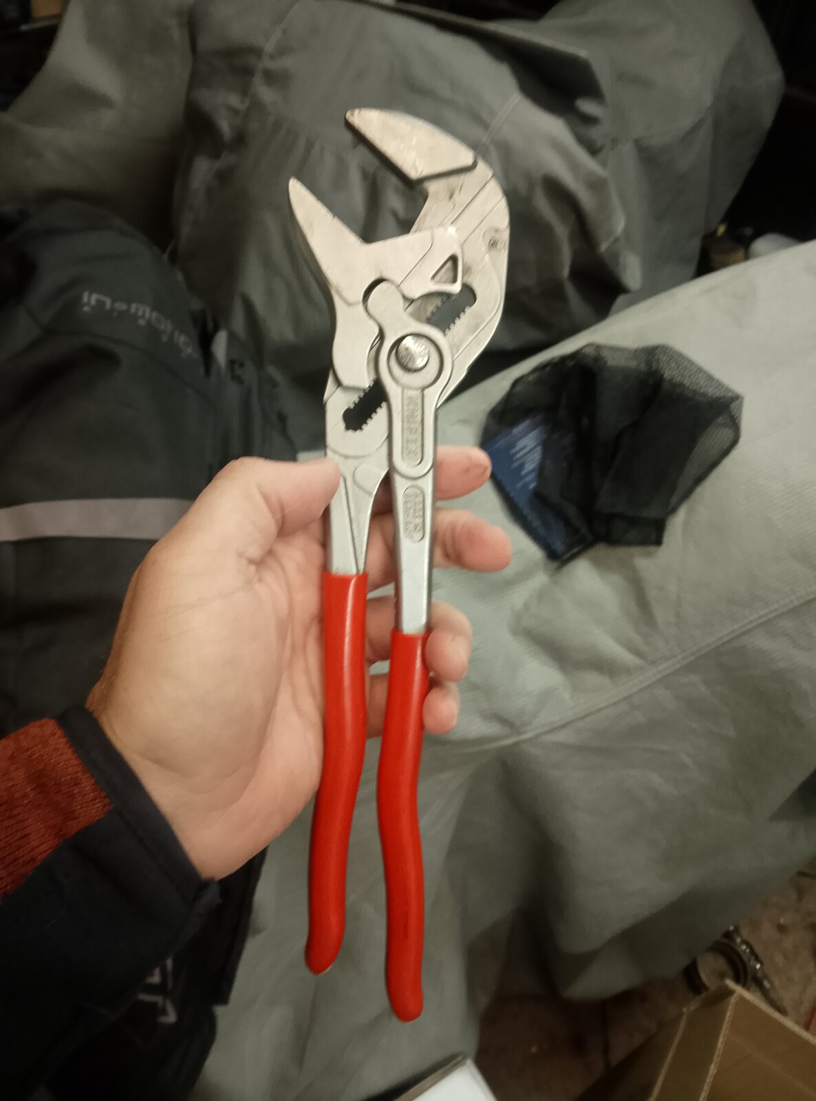

  5. I use these for my fork tops.
    The jaws are smooth and they move parallel to each other. They also have a finely incremented adjustment range.
    You can exert a good amount of force without any play or gap between the tool and nut. It minimises the risk of damage greatly.

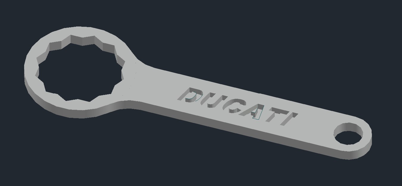

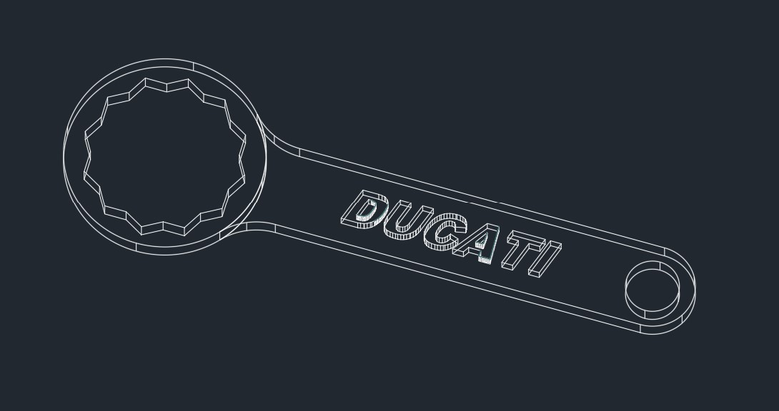

  6. if i have the right dimensions, i can printing with my 3d printer...

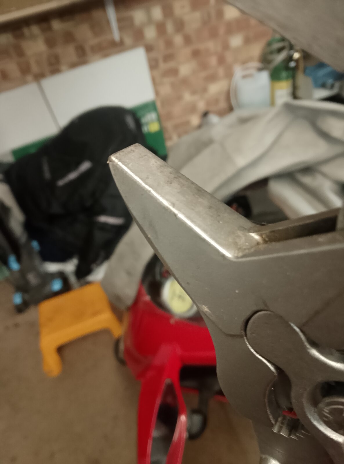

  7. Thx is for this tip, worked a treat, luckily I read that you need to undo the top clamp before trying to unscrew the caps......, but pricey with the postage but..
  8. ready to stamp 3d, resins abs like...high 5mm, diameter 32mm
  9. Can you do them in 6 point rather than 12 point.
  10. Of course
