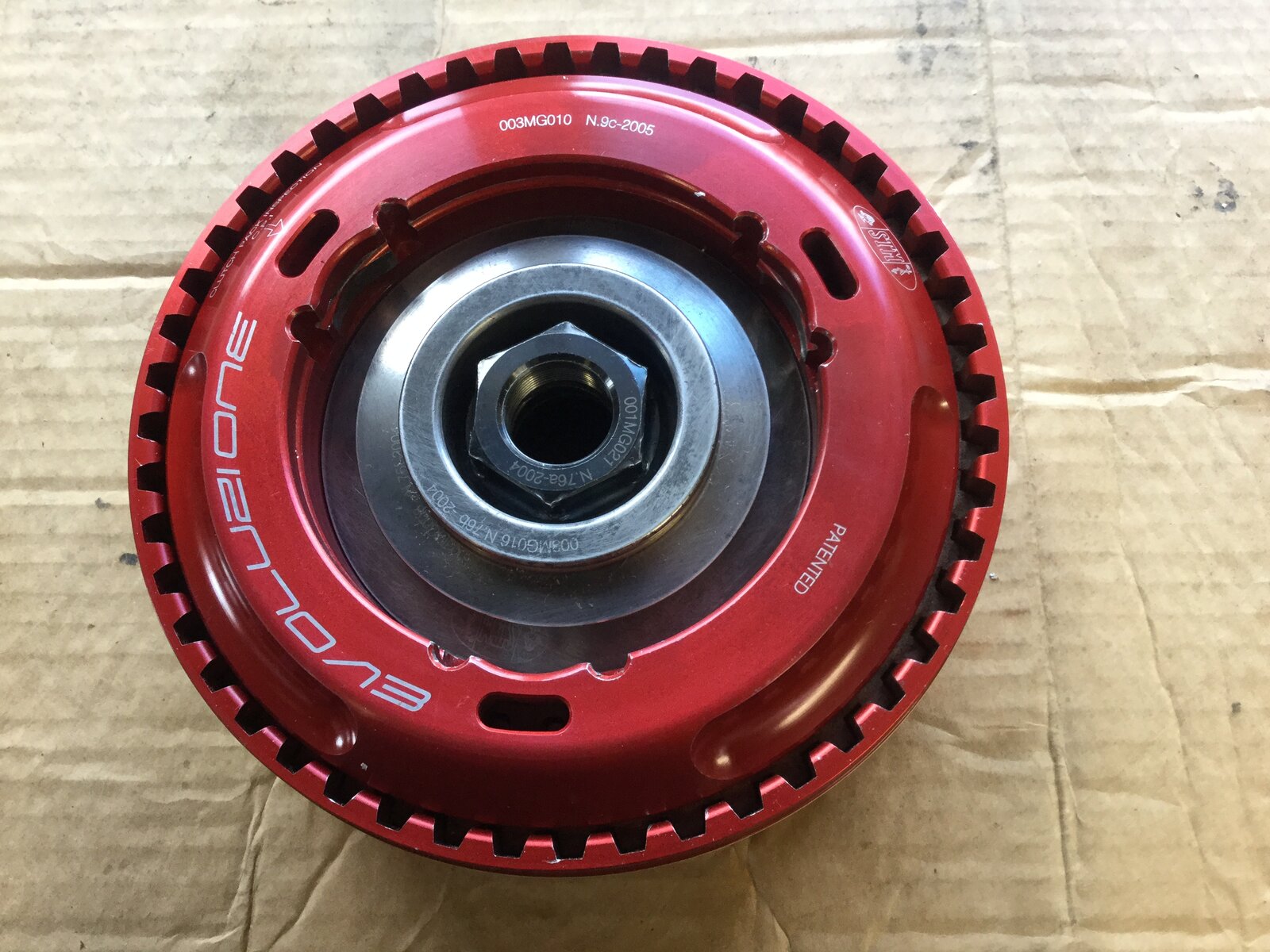

    First pic: the problem - how to prevent the pressure plate rotating - STM tool engages with the 6 semi circular recesses in the plate.

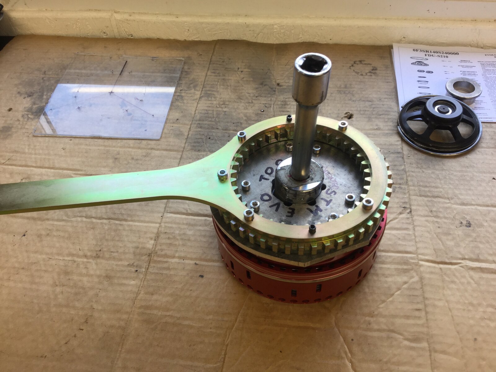

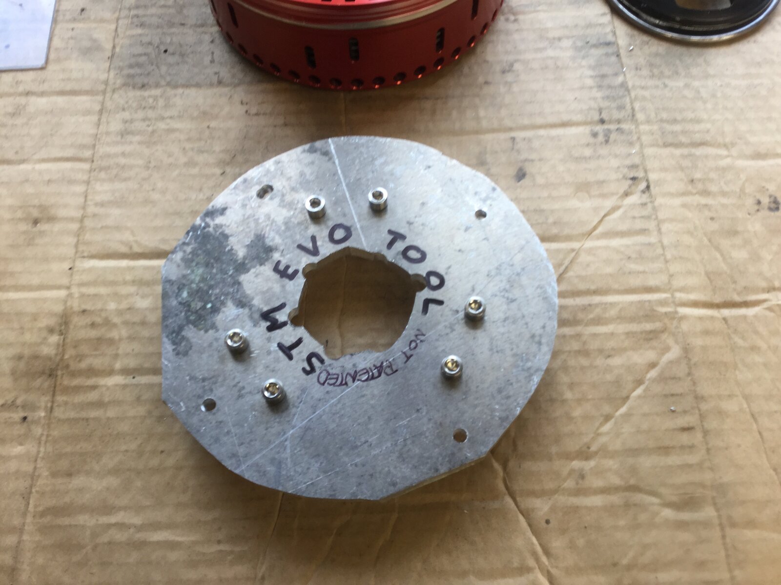

    Second pic: solution. Make a plate with bolts in it that align with the recesses. Gash chain drilled centre hole to allow 30mm socket to fit onto nut.

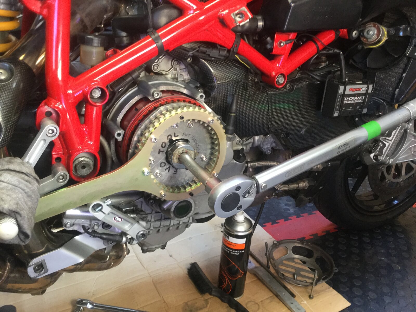

    Third pic: bolt plate to my 48t clutch holding tool

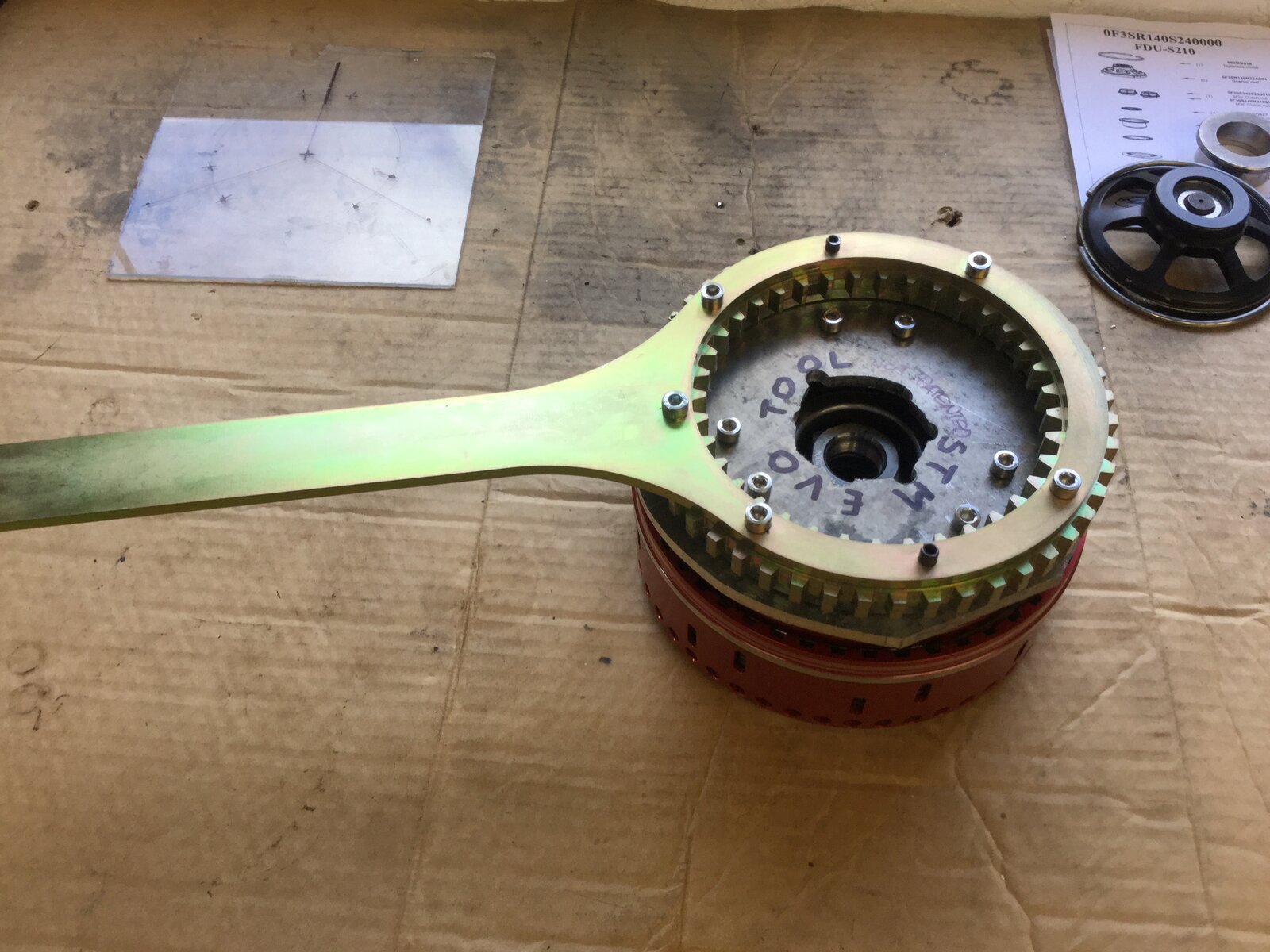

    Forth pic: viola!

  5. Finally got around to installing my STM Evo Clutch using my home made locking tool...it worked a treat , no slipping or anything up to 190Nm torque!
